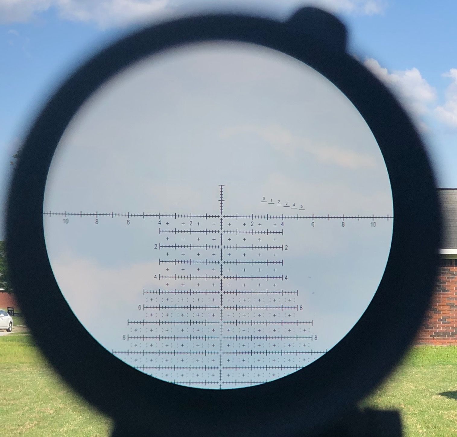

I assume quick holds are based off of the MV? If so, what MV are they using?
Is it based off of what they expect a 20” MRAD 308 barrel with M118LR?
There are somethings I would change,
That offset bracket to the left draws the eye away from the center, but most of it is pretty standard Horus
That asymmetry would seem to contradict everything I know about how the eye and brain work. But possibly I'm wrong.
Does this have any super-heavy stadia way outboard of the main reticle area (like many of the Nightforce reticles) so that we might have a chance of using it at low power, or will it simply disappear like the H59 when the power is turned way down?

meh. It’s a decent design. I’m just happy they didn’t give Horus the contract.
I'm curious about your comment; why the dislike for Horus? I'm not making accusations just curious. I bought the Horus Vision ballistic software(which you have to run on a Windows compact device) just before Horus sort of almost-but-not-quite disappeared. More recently they seem to be coming back. I'm curious about the history.
Thanks!
I've been pretty open about my general distaste for Horus style reticles. There are some grid type reticles I like (S&B's GR2ID, for example), but those are a lot smaller than this monstrosity.
For use under pressure, a reticle design has to have reasonable horizontal symmetry and a well defined primary aiming point. The eye has to be drawn to the primary aiming point. That is sorta how human vision works and how aiming works whether you are shooting or throwing a rock.
With all of the designs that have that huge grid the eye is drawn anywhere but where it is supposed to go. I think it less preposterous than Tremor3, kinda like H59, but that vertical line on the left is kinda weird.
Personally, I kida like abbreviated tree reticles. When I use the tree, I am usually within 5-6 mrad from the center. For further shots, I tend to dial and then do small corrections with the reticle.
Then again, I am not in the military, so it quite likely there are some deeper considerations there I do not understand.

I looked at the reticle about five separate times over the course of the last day and toady. Every time my eye went to the left.
I agree...I could see this being really tough to overcome in a fast muti target engagement on no sleep....

I have no idea how it wouldn't be ruled as Horusesque reticle lol
Why all the hate for Horus? Is it purely cost or is there more to it? It is nice to see a reticle design that's constant across company lines, so you can choose your scope based on the scope itself, not so much a compromise between a good reticle and a good scope design.
For me, and I'm far from alone in this, the H59 and Tremor 3 are way too busy for the shooting I do. There are three consequences of this:
1) People have talked about it getting in the way when spotting hits/misses etc.
2) Eye strain. If your eye is being drawn to different elements in your field of view, it is moving. Eye movement contributes to eye strain.
3) Fatigue. Years ago I did a fair amount of work in the usability arena. Core tenet: everything your eye is presented with has to be processed by your brain - and that takes resources. If all you have is a dot to concentrate on, it takes away most of the visual processing you need to do, which leaves more capacity for getting the job done. Of course, processing power isn't everything, and you need more info than just a dot, but every element you add, regardless of how small, adds to that processing requirement, thus diminishing resources available for accomplishing the task at hand. There will be times where a complex reticle helps, there will be times when it hurts.
The trick is picking a reticle that provides the necessary info for the work you need to do, but not too much.
Imagine having to look at that when you are dog ass tired.
This quote makes sense and exemplifies the usability statement I talk about above. When you are tired, you have less brain processing power available. There are some cool videos out there of brain scans taken of people doing tasks when they are fatigued (like driving in a simulator). They are noticeably darker (less activity) than alert brains, and what's really cool is that two areas normally connected (like logic centers and motor centers) will spontaneously disconnect for a period of time in fatigued brains, then just reconnect again. In the driving example, this was explained as those times where you zone out then suddenly "come back" and you're five miles farther down the road than you just were - and you don't remember getting there.

Reticle is almost non-existent in your sight picture below 8x, maybe a stretch to 6x. Why not shave the weight, mechanical complexity, and price by 30% by making this a compact 6-18x FFP with 30mm tube?
Ranging humanoid targets I believe. A quick reference so you can get a real quick SWAG on a person and then put the appropriate elevation on em to get close enough to score a probable hit.
im sorry, i still don’t get it. I must be an idiot....can someone try to explain?
As for the reticle, IMO, the reticle is for speed of engagement and fire adjustment. Am I gonna need 4 miles of wind or oops depending on these 2 scenarios?
My guess is some of these lines are to address a 500 yd zero by scope base to get to ELR, but what do I know. I’m thinking for the guys with this optic on a 338 Lapua or 50 bmg rifle....2mil base. Those upper plus marks allow me to swing this optic on to a 100 - 500 yd target an make quick hits...because wind effects are minimal on 338 Lapua. That’s the only way I can make sense of all that grid!

I guess I will have to learn how to use this type of reticle since I just ordered the Leupold.
It's for ranging targets at unknown distances.
Any stepped reticle feature like that is calibrated to some specific, consistent distance, often something like 16" vertically or 5-6'vertically. When looking at a target of that size you move the reticle across it until the target is within the upper and lower lines of one of those steps. Then you read the number associated with that step, say, '3'. That's 300 yards or 300 meters. Now you (supposedly) know the distance to the target and you either dial the drop for your round on your elevation turret, or more likely use one of the dots or hash marks below the crosshair (and the marks may also have a range mark on them so you know to use the '3' one in my example. So you hold over and fire and, allegedly, hit the target.
These kind of ranging reticles are neat looking, and might be useful in combat or hunting, but less so in precision shooting.
It can be hard to keep a moving target in each of the measuring steps long enough to get an accurate measurement. Plus what if they're taller or shorter than the calibration step? I've always wondered how the military 'mil's' human targets given the different heights of different peoples around the world.
I have a marvelous Steiner 6 x 30 bino with a similar ranging feature: there's flat baseline for the lower end of the target, and a line rising at an angle (visualize 2 sides of a triangle) At various spots on the upper angular line are the numbers, 100, 200, 250, etc. I've tried using this for practice and found it's very hard to range targets with it. For one thing I'm at a slightly higher altitude than the things I'm ranging. For another there's a lot of variation in size of the targets. And IIRC the calibrated vertical distance is something like 16", which is supposed to be the height of the vital area of a deer or something, and I'm not ranging deer.

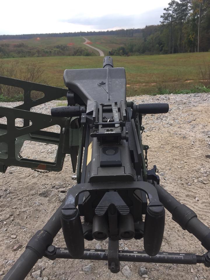

never seen a mk19 go more than 3 grenades at time before it jammed....
I never had a problem with mine.
And you have to love the unintended 'ramp up a round' feature where it magically shoots 1-2 with the same recoil/feeling and then a 3rd with way more velocity and at a different trajectory for no fucking reason.
Everybody told me I was making shit up, but it's true! TheGerman said it so it must be true, or we're both crazy.
