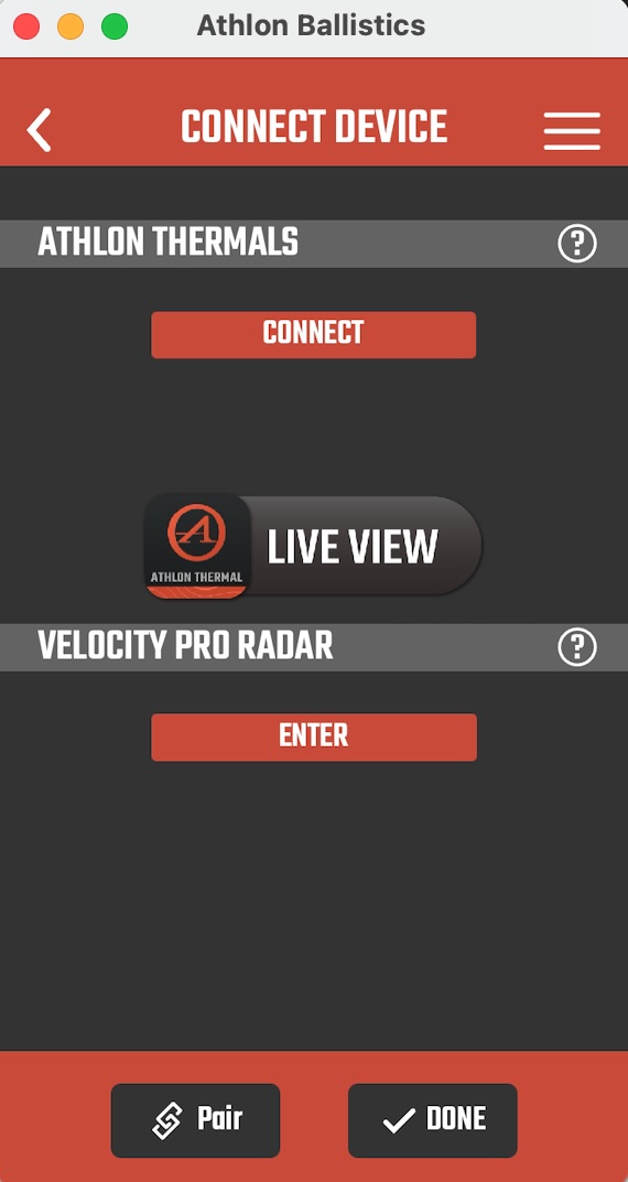

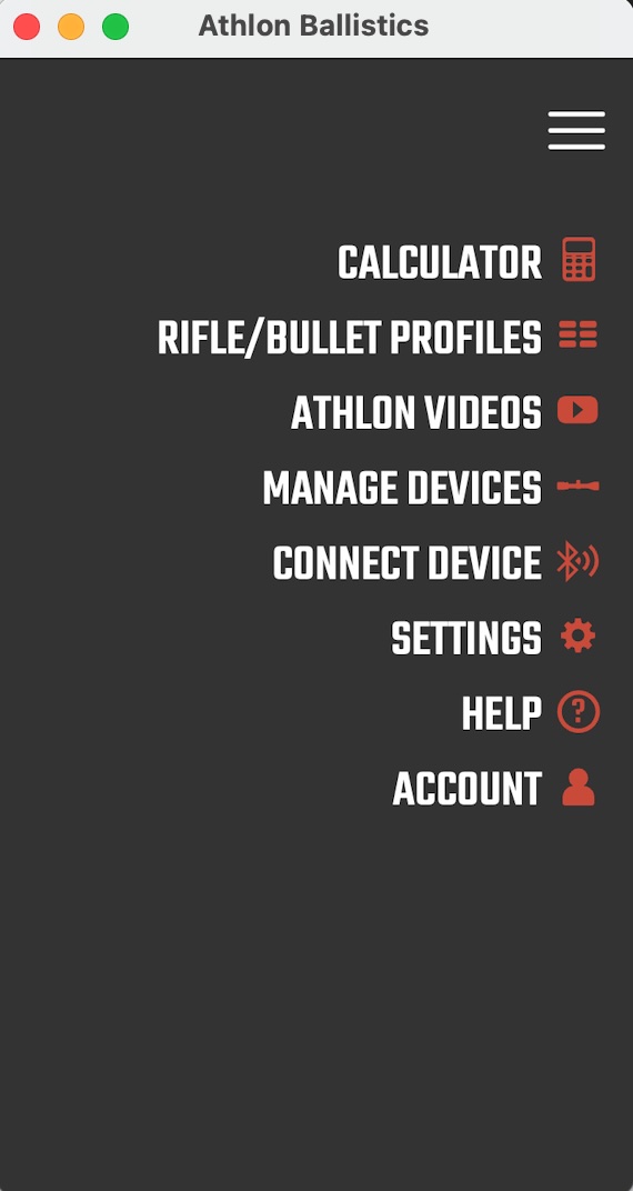

I have yet to get my phone to connect to the device.
The app is squirrely designed. Not sure if you figured that out yet.
Apologies in advance if this is all obvious to you. Not judging just detailing what works for me.
ETA: check in the settings on the radar if "connection" is "on" ... mine was on by default
The steps to connect from the app are
click the hamburger at the top right
select "connect device" - you should see two things "athlon thermals" with "connect" under it and "velocity pro radar" with "enter" under it
click "enter" under "velocity pro radar"
on mine there's a "reconnect" button that's darked out but yours should have a "connect" button IIRC
I have no idea why there are two different fkn connect buttons, I clicked the "connect" button under thermals like 3 times before I decided to see what was on the other side of "enter" under radar

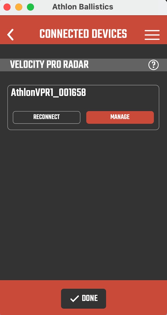

View attachment 8694065 View attachment 8694060 View attachment 8694066
Ok thanks. I think that’s what I was doing, however I was more concerned with actually shooting that day. I’ll mess with it more when I’m not actually trying to do something semi important. I do, however, believe I see how it’s slightly squirrelly.
Reactions: lash and doubloon

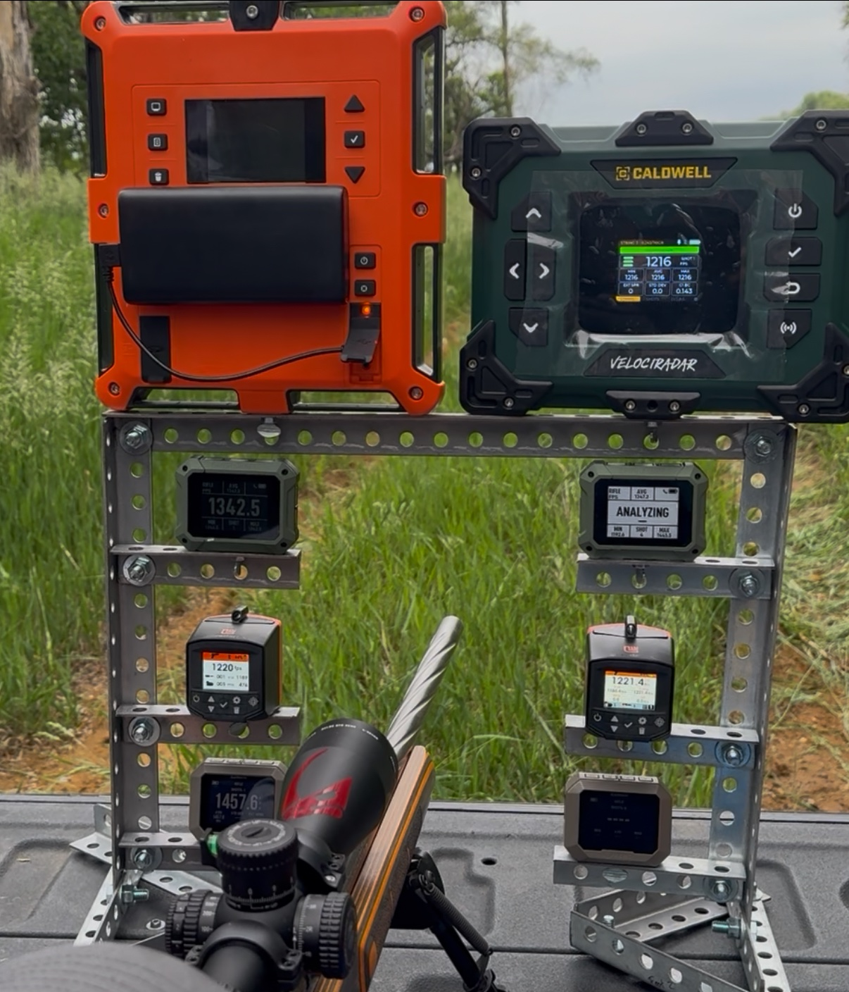

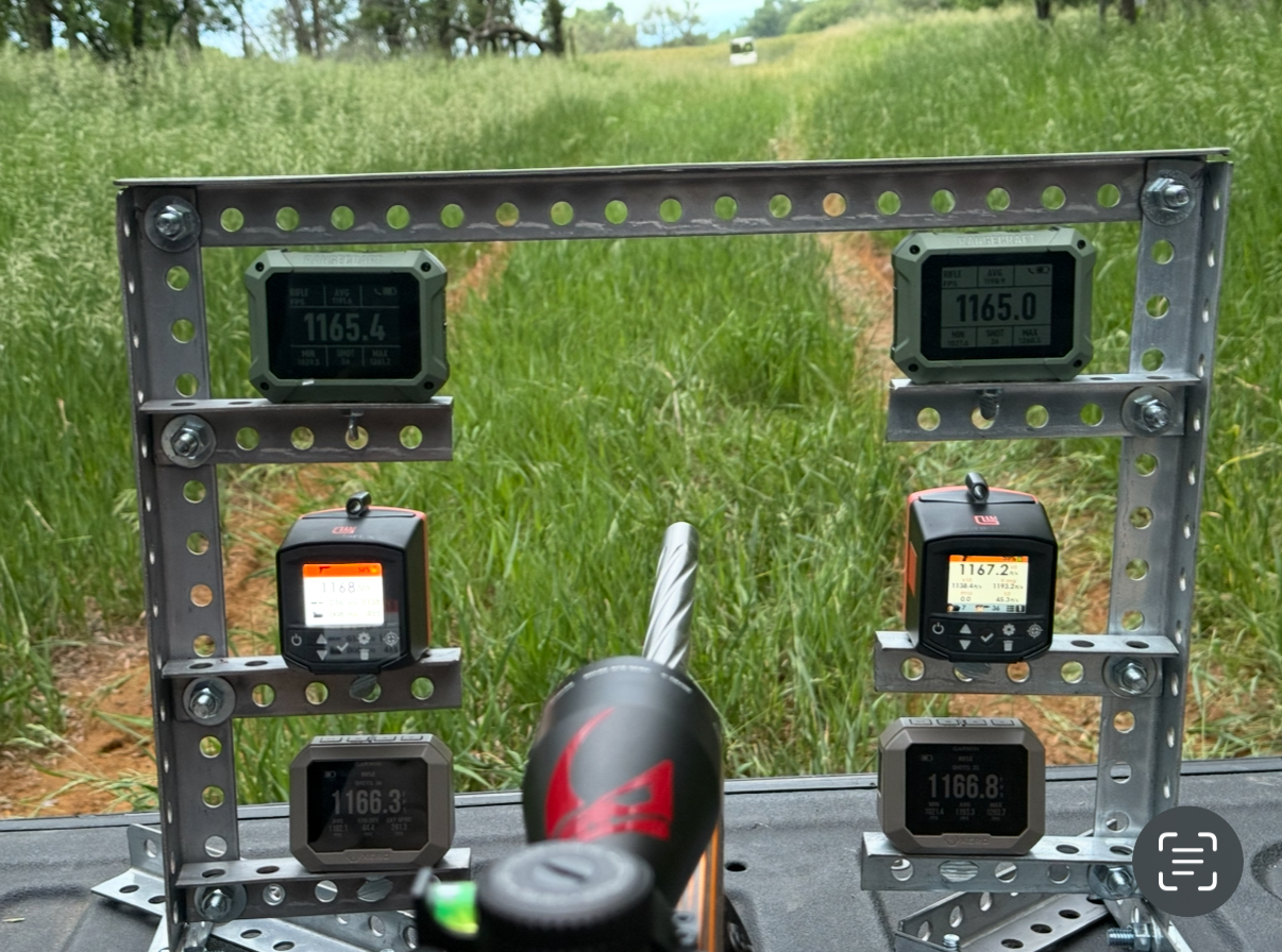

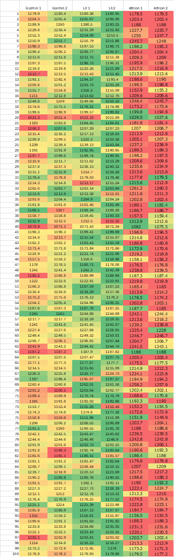

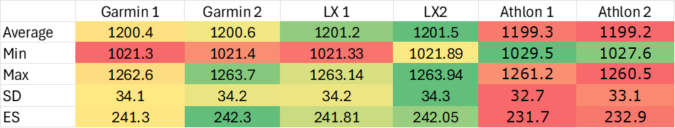

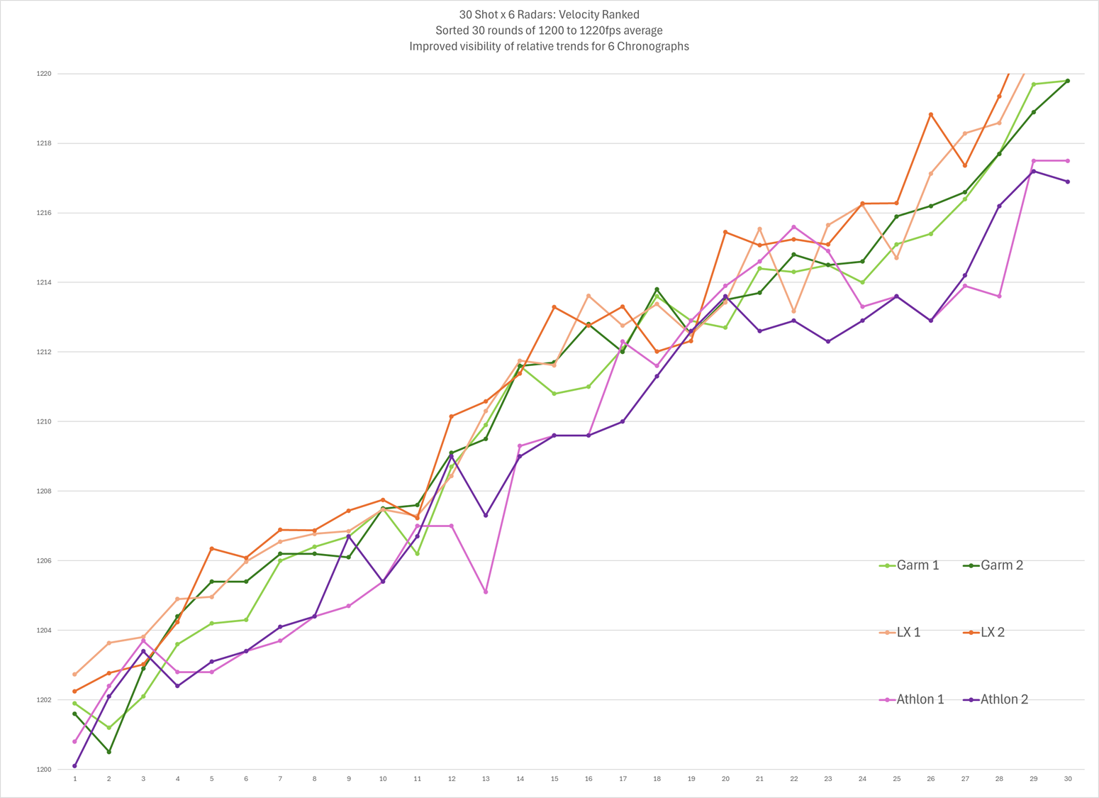

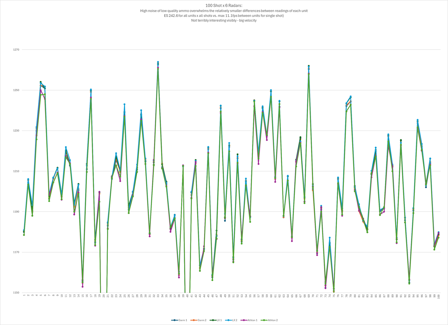

After many failed attempts over multiple days and system resets, one of my Athlons will connect, but simply will NOT sync sessions to my phone. That's been kind of frustrating for me - especially when I'm trying to compile data from several chronographs at the same time and have to do manual data entry for the simple fact that one unit will not sync. I've also experienced co-channel interference with all 3 of the Athlons I have used - I'm not sure if they're accepting NEAR-channel interference instead of co-channel, but it's strange that I've had such bad luck in getting 3 out of 3 to interfere, whereas I've not had that experience with Garmins or LabRadar LX's as pervasively as I do with the Athlons (you can see the 1400fps reading on the bottom left Garmin - that ONLY happens when I have co-channel interference). It CAN happen to any of them - the V1 and the VelociRadar pictured here interfere both directions with the 2 Athlons pictured (interfering 1 each), but acoustic triggers (which the V1 and VR are using) hide the interference better than radar triggered units (which the Athlons use). Eliminating the co-channel units, the Athlons operate perfectly fine and offer more consistent readings with the rest of the units.
I think you have officially gone too far.
Eh, folks wanna know stuff, and I like experimenting when I have time and ability. I kinda accidentally ended up with a bunch of chronos, 8 units of 7 different make/model, folks asked questions, so I designed some experiments for comparison - then the preliminary testing revealed additional testing to be done, especially with multiple units of the same brand, and someone had a VelociRadar I could borrow, so I actually have 11 chronos of 8 different models right now to do a lot of comparison.
But yeah, it's a rather large pain in the ass that I can't run all 8 radar units concurrently due to the near/co-channel interferences. So I have to pick and choose which can be concurrently operated and then design the tests around minimizing the round count (running 100 round strings across 11 units, even in pairs, is a LOT of rounds). But I'm trying to answer questions which different folks have had about them.
Apple or Android? Mostly just curious about this point.
I'm running the app on my macbook and it "syncs" between the chronograph and the app on the laptop if that's what you mean. All the sessions are visible in the app and I can rename them and mess with them to the limits of what the app allows. The new names haven't yet been synced back to the chrono that I have noticed.
Downloading the sessions to my laptop for use by something else like a spreadsheet app is not accomplished with "sync". Each file has to be saved to the device individually renaming each one in the process.
Yes. The video of the interview with Dustin Harding of Athlon linked by someone in a previous post addressed this but Dustin dodged the question. Basically, by not directly answering the question, Dustin confirmed the Rangecraft is not as good as other devices at filtering out competing signals from other radars. Maybe it will be addressed in a future update, maybe not.
Interesting you got this result. It seems to differ from some other results.
I'm having a hard time spotting the Magneto Speed. Is it wearing grass camo?
Reactions: lash
What are the units second from the bottom?
Apple or Android?
I use iOS.
When opening the "manage tab" of each Athlon Velocity Pro in the app - on iOS - the units generally automatically sync sessions into the phone. When this doesn't happen automatically, typically there is a "sync sessions" button at the bottom of the app interface page. One of my Athlons will readily do that transfer, or will accept the instruction to sync. My second unit cannot be made to sync - it spins the wheel of death for hours without syncing. I'm going to do another hard reboot and reinstall the updated firmware and hope it clears, now that I have extracted the data manually, but I have not had luck so far.
I can't speak to the mac based App, but once sessions are synced from the unit to the phone, they can be exported as .csv, at which point the iOS interface allows the destination of the export to be an email (or any of a dozen other options, such as opening with specific spreadsheet apps or saving as pdf, or opening with other apps), so I simply export to email and then open the .csv's in Excel. Other than the fact they all export as individual files without descriptive filenames, this works quickly and easily.
I'm not terribly certain at this point if the Athlon is actually worse than "other devices" or not. The "other devices" I have tested include 3 brand/models which are acoustic or recoil trigger only, which means they would only exhibit bad behavior AFTER a shot has been fired. The Athlons, alternatively, are radar triggered, so comparatively, their triggers are always open. So when I have known interfering units operating (such as my LabRadar V1 and my first Athlon, or the Caldwell VelociRadar I have and my second Athlon), the Athlon will trigger repeatedly, non-stop, as if it were constantly receiving shots, even if there is no gun on the firing line. However, the VelociRadar will SEEM as if it is not experiencing interference, but ONLY because it has not been actively triggered. However, once it "hears" a shot with the acoustic trigger, it will experience the same co-channel interference and remains at risk of reading a false echo (the echo from the OTHER co-channel unit rather than their own) and displaying a false velocity. Both LabRadar V1 and LabRadar LX work this same way - acoustic or recoil trigger only, so they too would also SEEM to be operating normally until the shot is fired, but then once triggered, they'd accept the false echo and report a false velocity.
I've seen false echo receipt a few times with Garmins - sometimes we'll see shots reporting over 4,000fps, which indicates they received a false echo from another unit, but I have NEVER seen the Garmins be triggered by Radar, AND it has been very rare to see Garmins interfering. We end up with a bunch of Garmins on the same firing line at PRS match zero boards, and it is exceedingly rare to see interference indicators, whereas 3 out of 3 of the Athlons I have used have fallen into constant feedback loops where they are being triggered and displaying "analyzing" and even reporting velocities for shots which did not happen.
So I'm suspicious but have not yet confirmed that Athlons are accepting NEAR-channel interference rather than simply accepting co-channel interference (which cannot be avoided by ANY of the radar units on the market).
BUT I WILL OFFER A WARNING TO VIEWERS - I believe it will be common for people to see video of folks using LabRadars or VelociRadars to show a lopsided and false representation that the Athlons are unilaterally accepting co-channel interference because we can make them spaz out by turning on the co-channel units. The Athlon will go into a continuous loop, whereas the LabRadar and VelociRadar will APPEAR to be fine... but ONLY because they have not yet been triggered to read, whereas the Athlon IS getting triggered by radar. The LabRadars and VelociRadar will still experience the false velocity output once they are triggered - but it's easy to make a video which seems very, very one sided. I have this kind of video myself, but I'm not yet sharing them until I can properly demonstrate the bi-directional interference instead of making the Athlon look like it is failing.
[Varminterror: "Eliminating the co-channel units, the Athlons operate perfectly fine and offer more consistent readings with the rest of the units.] Interesting you got this result. It seems to differ from some other results.
Not sure what to tell you, other than to describe that by the end of that preliminary interference test pictured above (a test conducted to evaluate the validity experimental design for future tests), I fired a 100 round string with 6 units operating, removing the LabRadar V1 and the Caldwell VelociRadar, which demonstrated to interfere with the 2 Athlons. I'm compiling that information to share in threads like this around the internet and in a forthcoming video (series of videos maybe), but here's an example of the alignment of results when the interferences are eliminated - all 6 units, 2 Athlons, 2 Garmins, and 2 LabRadar LX's agree within 3 fps 1165fps to 1168fps (left side LX was not updated for firmware and was displaying only whole integer velocities, rather than the updated LX on the right side which displays decimal value velocities.
This has been my consistent experience when interference is not happening - observationally, the units are reading within a few fps of each other overall, and within each brand, typically the variance is less than 1fps. As the rain subsides in the next days and weeks, I will share more data to confirm or correct this observation, knowing now which units can and cannot be operated concurrently.
The test pictured was a preliminary operability test to determine interferences for the Radar units to let me determine the volume of sampling I will have to do in order to capture the necessary dataset for this comparison. I want to be able to display data from concurrent operation, but I knew the opportunity for co-channel interference existed, so the test above was the opportunity to test which units can be concurrently operated and which units would interfere. I have to trade out the interfering units one at a time to enable the future testing. Not pictured there, as they were not included in the preliminary radar interference test, are my Magnetospeed V3, MacDonald 2 Box, and CE ProChrono Digital. Since these 3 units aren't radars, I did not include them in the radar interference test.
this video starting around 10:30 ... Dustin calls it an "analyzing loop" around 11:30 ... caused by interference
I might be picking nits here, but I don't really like "analyzing loop," to describe what we're seeing. Judd used the same language - "analyzing loop" - on the phone when I called after the first instance of interference on the first day with my Athlon, but I'm not terribly certain I'd agree with that particular language - I don't necessarily perceive that it's just "analyzing" and then picking a high velocity, but rather the units are in a re-triggering loop because of radar feedback from the interfering units.
In that Paramount video above, we can't really tell which unit is interfering with that visible Athlon, since we can only see 2 of the 5, but I would bet it was the LabRadar. The LabRadar would appear to be fine, since it wasn't yet triggered between shots, but it's quite likely that it was displaying false velocities when triggered. The Athlon is radar triggered, so it's being repeatedly triggered by the interference. The Garmin could exhibit the same issue - potentially - since it is also radar triggered, so the fact the Garmin screen isn't constantly recycling in the same way as the Athlon, I'm betting the co-channel interference was with the LabRadar and being hidden by the fact the LabRadar uses an acoustic trigger rather than Radar.
The high velocities being displayed are almost assuredly false-echo registrations. The signal from another unit comes back and the timing offset is just wrong, so then the unit displays an incorrect velocity. Alternatively, when the Athlons are showing the chronic "analyzing" on the screen, I believe that is multiple trigger events, rather than just persistent processing. You'll see the screen flash back and forth, indicating the analysis is ending, skipping some false echoes, registering others. As I mentioned, any radar triggered unit could exhibit that issue, it's just odd that we're seeing it so much more commonly from the Athlons than the Garmins, which makes me think the Athlon may be more susceptible to NEAR-channel interference rather than strict co-channel (this COULD also describe a potential difference for inequitable interference from Athlon to another unit brand, but that's pure speculation on my part at this time).
Reactions: doubloon

I'm working now to compile some data from one of my preliminary comparisons depicted above. I had to eliminate two units from the test to prevent co-channel interference, but while I was conducting the interference test, I shot a 100rnd string of 22LR ammo (rot gut stuff, just for preliminary evaluation of the method) across 3 pairs of LabRadar LX, Garmin Xero C1, and Athlon Rangecraft Velocity Pro's.
Overall, for 100rnds, after my first few outings with the Athlons, this dataset was much more compelling than I expected. We can see here, the ES and SD's are relatively similar, the ES's appear to vary more than they really are, since the numbers are so ridiculously big for this terrible ammo, but 231.7 vs. 242.3 is still only a ~4% spread, and 32.7SD vs. 34.3SD is only ~4.8% spread, and considering this ammo, I'm not terribly disappointed at this point. More rimfire and similar centerfire testing to come which may confirm or correct that observation.
I expected in the outset of designing this experiment that I would see relatively persistent offsets between units - meaning one unit would read higher than another, or lower, regularly. This persisted both within each brand (less so for the Athlons) as well as between the 3 brands. Reading the data itself isn't important, but I applied a heat map to the data for all 6 units over 100 rounds to reflect which units read the highest speed readings for each shot (highlighted green below) vs. the lowest speed (highlighted red below). The two left columns are Garmin units, two center columns are the readings from LabRadar LX's, and the right most two columns are the readings from my two Athlons. For an overwhelming majority of shots, the LabRadar LX's displayed the higher speed readings with the Athlons displaying the lower speed readings, with the Garmins floating in the middle:
--> One or both of the LabRadar LX's represented 90 of the fastest shots out of 100, and only ONE out of 100 shots did a LabRadar LX represent the slowest reading for any shot (including ties).
--> One or both of the Athlon untis represented the SLOWEST velocity reading for 89 out of 100 shots, and only represented 10 of the fastest readings (including ties).
--> One or both of the Garmins represented mid-range readings between the other brands 85 out of 100 shots, only representing the fastest shots for 5 out of 100 (including ties), and only represented the slowest readings 10 times out of 100 shots.
So 90% of the time, the LX was faster than the other two brands, and 89% of the time the Athlon was slower than the other two brands. The LX's averaged 0.8fps faster than the Garmins, which averaged 1.2fps faster than the Athlons.
***Note: Reading the specific data here isn't so important as the heat mapping - majority red in a column shows that unit reads slower more often, majority green shows that unit reads faster more often.***
Comparing each brand to itself, there was also an offset between the units, although less decisive. One of my Garmins read faster than the other for 62 of the 100 shots and only slower for 29 of the 100, with the two units matching the displayed speed for 9 shots - meaning one unit read faster than the other more than twice as often. The two Athlons agreed 21 times, then one unit displayed faster on 47 shots and only slower for 32 shots, reading faster than the other roughly 50% more often. The LabRadar LX's display to 0.01fps rather than 0.1fps, which makes it less common to see perfect agreement (and on that date, they were not operating on the same firmware version), so there were no shots for which they displayed the exact same speed, but one unit displayed higher speed 63 times and only displayed slower 37 times, so one unit read faster about 70% more often than the other.
The readings between each of the same brand were very close together. The worst spread displayed for ALL chronographs was 11.1fps, but 80% of the shots were less than 4.2fps separated. The 2 LabRadars were, on average, 2.1fps faster than the 2 Athlons and 0.8fps faster than the 2 Garmins. But within brands:
--> The 2 Garmins read within 0.54fps average from one another, never more than 1.9fps apart.
--> The 2 LX's averaged within 0.83fps of one another, never more than 3.9fps apart.
--> The Athlons averaged 1.1fps apart, never more than 6.5fps.
So this suggests, at least in this test, the Garmins are closer together than the LabRadars by ~50% tighter, while the Garmins are about 96% closer together on average than the Athlons. But overall, whether the average is within +/-0.5fps or +/-1.1fps, eh, not a huge difference in practical application performance.
Unfortunately, the ammo I chose was just terrible, so the noise from one shot to the next really drowns out the difference between each chronograph reading for each respective shot. Really difficult to display the dataset with only ~3.5fps average spread between each chronograph, but 242fps spread between the fastest and slowest shot registered. This is all 6 trends depicted together, you can see they track very well up and down for the macro result, but there's slight feathering and a few crossing of the trends at the peaks and valleys where the few fps between the readings are revealed:
In an attempt to better visualize the differences between units, and the prevailing offset trends, I ranked the shots by average velocity across the units, then charted the trendlines for a smaller velocity window, choosing 1200-1220 relatively randomly - it's a small enough velocity window to let the ~3.5fps spread between shots reveal itself in the ~20fps window, but still have ~25-30 shots for comparison. So here is a ranked velocity depiction (by average velocity) of 30 rounds.
--> The pink and purple trends floating typically near the bottom edge are the Athlon units
--> The light and dark green trends floating typically in the middle are the Garmin units
--> The peach & orange trends riding predominantly on the top are the LX units
We can see the relative noise, but also see the prevailing offset trends, and the near-parallel tracking together of all of units as the ranked velocity increased up and up. Tighter together in some spots, looser and noisier in some spots, but just randomly so, since this represents a non-chronological series of shots.
Overall, the results were very consistent for all 3 brands, all 6 units, and the expected behavior was demonstrated. Without yet going into volatility evaluation, I'm glad to have this info as I move this weekend and next week into further exploration.

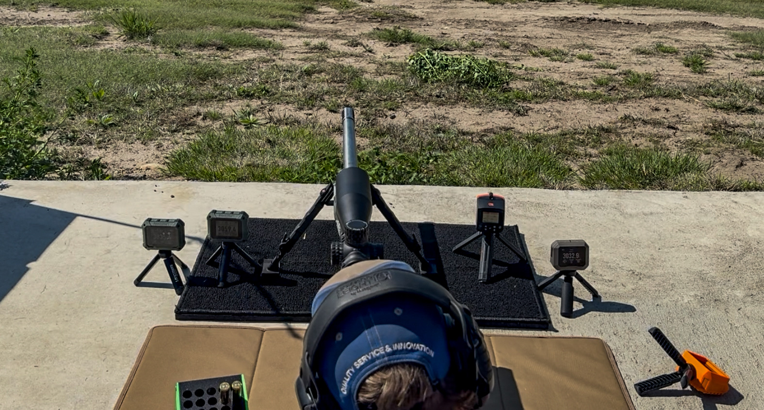

Yes, I have tested some side by side data capture, rather than the vertical orientation I have pictured above. I will also offer more and more testing of this nature in the near future (big plans this week and weekend) so I can better demonstrate the sensitivities. Having the units farther spread apart will achieve 2 limits as the beams are peeled farther and farther apart 1) the Athlons are less persistently retriggered as they receive less concentrated radar false echo, 2) the units are better able to determine what is false echo vs. their own signal (report a bad reading vs. recording an incorrect velocity), and 3) eventually, moving sufficiently far apart, the beams will not false-echo back to each other and the false echoes and interference will be eliminated. On this particular day, the farthest outside Athlon did not appear to be interfering with any of the other 4 depicted (and has never interfered by 2 of those other units in subsequent testing), but did repeat 4150-60 fps readings, indicating reception of a false echo from another unit, when one of the other shooters was on the line in the bay beside us (I wanna say these are 11ft bays?).
I CAN state, in my experience so far, I do NOT believe that the chronic, persisting re-triggering loop will happen for any "real world" shooter on a 100yrd zero board or competition firing line, and only happens to those of us concentrating multiple units onto one rifle, BUT, I can also directly state experience in false-echo reception where ANY of these units have displayed a false velocity reading due to nearby radar interference - RARE, exceptionally rare, and extremely obvious, but it remains to be a reality for this kind of device. Not so different than finding out that someone put a shot or two on the wrong target when scoring after a match, just a reality of the practice.

I went out on Saturday morning, garmin on one side Athlon on the other. Athlon was consistently 5-15 FPS faster than the garmin. No wild readings, they tracked. but the Athlon was consistently slightly higher.
