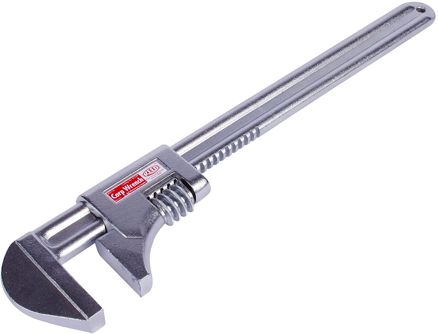

The simplest answer is yes you can certainly rebarrel that firearm to any caliber that has a 308 standard size case head as far as doing it by yourself there are several things to consider Tikka's traditionally are very tightly torqued and therefore having a barrel Vise that can grip the barrel tight enough to prevent slippage is very important there are various methods for this whether you use a custom fit bushing or some sort of sandpaper, grit powder etc. the important thing is that the barrel does not slip as you are turning the action unlike the T3 which is very lightly built and is both round and Square the 595 is solid and has Square sides so something like a smooth jaw pipe wrench for brass fittings that does not squeeze as you apply pressure probably is your best friend for this application at home if you wish to save the barrel . Avoid inside the action type branches as you have high probability of twisting the wrench or the action rails with the amount of torque you will apply also it is Hard to get a consistent hit if you're going to apply the hammer technique. it's easy enough to experiment with cold or hot as to the best effect on the steel to reduce the grip of the threads, penetrating oil such as kroil oil or similar products maybe effective as well. In regards to pre fits I have a PVA Tikka prefit that is on a 695, the thread pattern is the same between the T3 series and the 595/695 although I believe the tenon length different so make sure that you get the barrel nut version instead of the shoulder version as you can set your headspace appropriately to the action here's a picture of the wrench type that I was talking about hope this helps.
I’m expecting a shouldered prefit to arrive this Wednesday for my Tikka M595 Master Sporter. Coming from PVA, chambered in 6.5 Addiction... Let me qualify that PVA had my action in-hand previously for the first rebarrel from factory 308, so I can’t say that they necessarily sell shouldered prefits for Tikka M595, but worth making a call to ask if you’re interested...
I’ve heard that a Tikka T3 internal action wrench will work on the M595 action, but I sourced a dedicated M595 action wrench from someone who makes and sells them through the Accurate Shooter site. I’ve also read that a universal action wrench or even a 31mm (I think that was the size) open end wrench will work on the flats on the outside of the action for barrel installation/removal.
