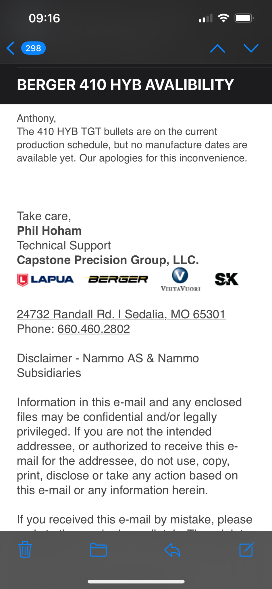

New Berger 375 bullet 410 hybrid
I guess on the schedule but no dates which is confusing

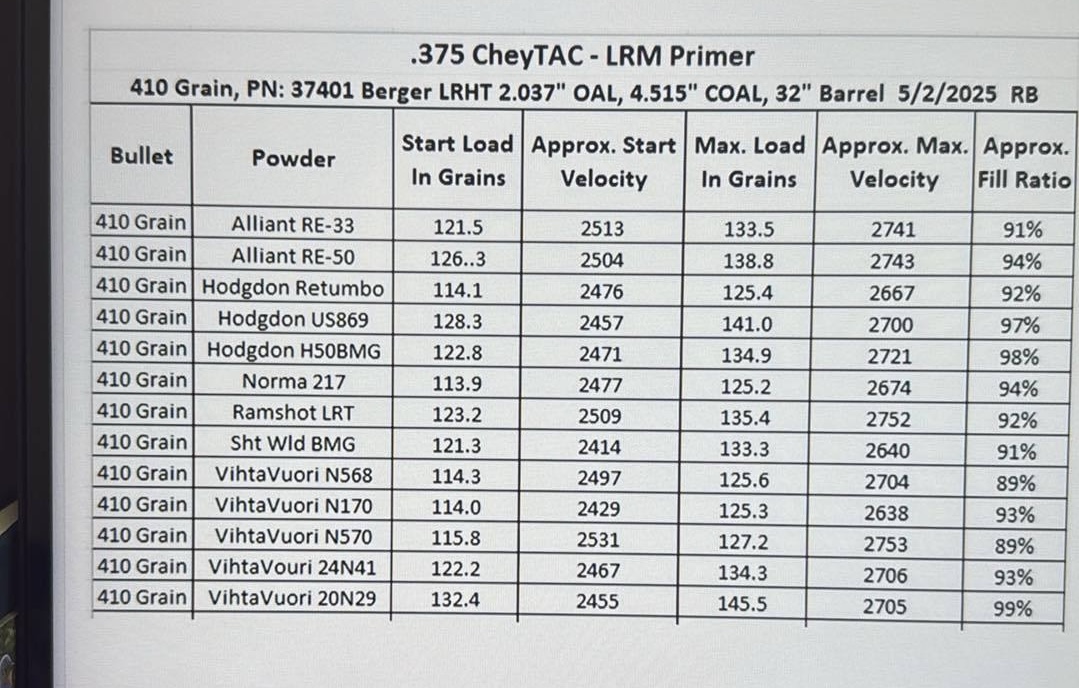

where is this data sheet from?
My most recent QL update is only a year old and the 410 was not part of it
