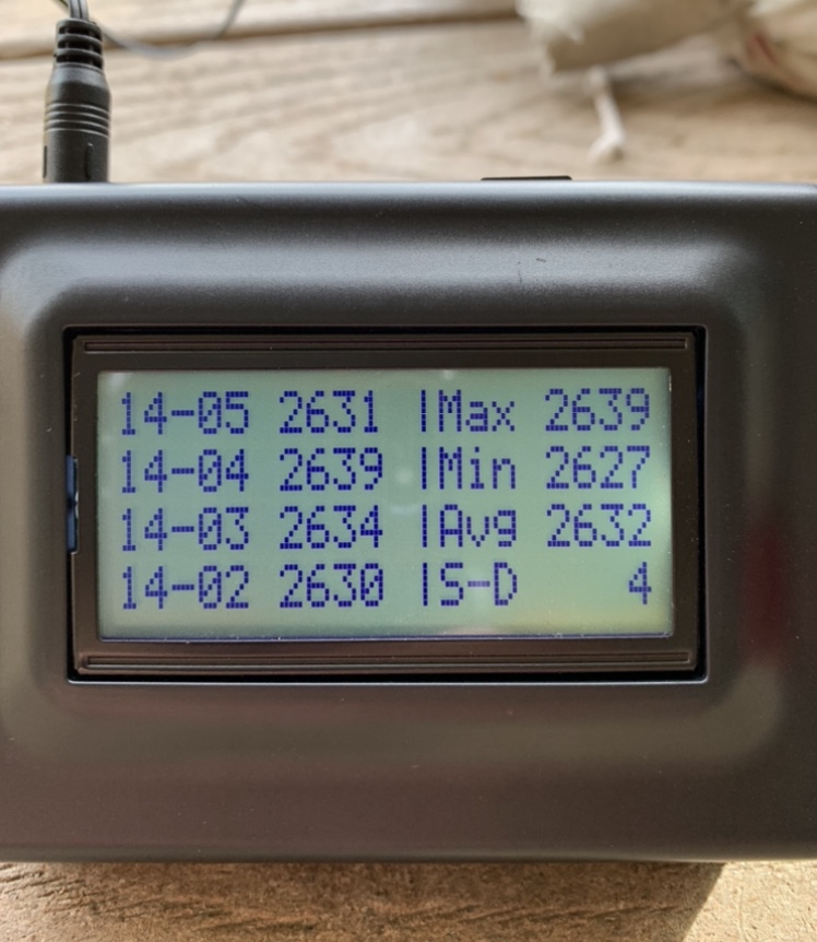

Anyone making more headway with these? I went to the range today with a brand new setup and left kinda scratching my head. 6.5x47, 144 LRHT, Varget, CCI 450’s, virgin brass. 4 different charge weights from 36.2-37.1 grains. Set them .020 off and all of my runout was under 5 thou. Brand new AXSA. SD’s look awesome but pretty ugly on paper. I have some figuring out to do.

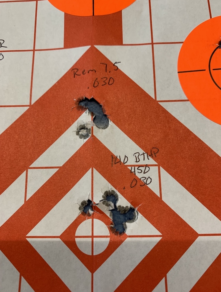

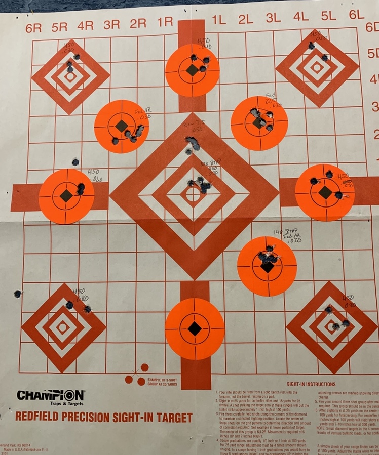

Sorted out my junk and got back to the range. They shot well and seemed to prefer being closer than farther from the lands. I’m not complaining for the 30mph gusts we had this weekend.
6.5x47, 36.8g Varget, CCI 450’s, Fed 205’s, Rem 7 1/2’s, and Fed 205MAR’s. Had some good SD’s with both 205MAR’s and CCI’s despite the 450’s being 40+ years old. Threw some 140 Hornady’s in the mix just in case the Berger 144’s didn’t pan out.
View attachment 7224065View attachment 7224061View attachment 7224062View attachment 7224063View attachment 7224064

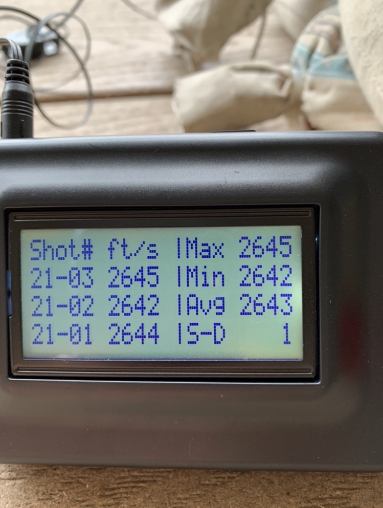

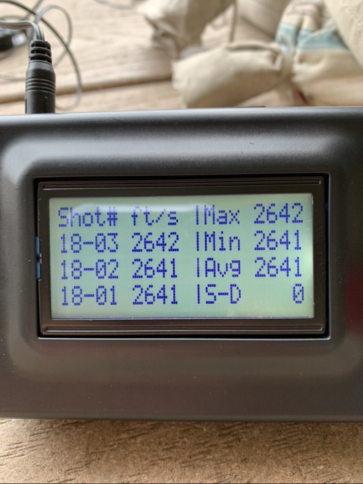

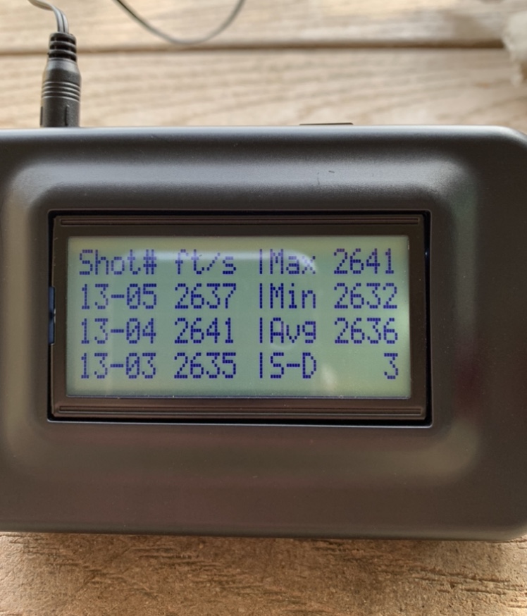

How the hell does someone get an SD of 0? What do you attribute being able to achieve that? Obviously it’s many factors but any big ones that come to mind?
Some low numbers are common during small batch tests of well made bullets, basically the the standard deviation calculation says there is little to no variance. Larger testing or 5 or more rounds will absolutely be more true and I have yet to see a 0 on 5 or more rounds. Well sorted bullets, repeatable seating depth and a precise charge measurement .... mix that with finding a load that your gun setup likes.
Like you said, lots of factors. I can’t say any one thing in particular because about the time I think I have things figured out shit goes sideways. I’d say a good scale and consistent neck tension are the two factors that’s have shown repeatable improvement. This was in virgin Lapua brass but I anneal every firing, trim every firing, and I seat bullets in a lubricated neck.

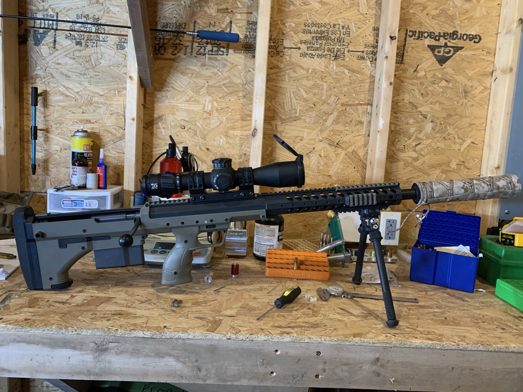

No pictures, but I just started playing with these. Peterson LRP brass, Fed 210m primers, RL16, seated at .030 off lands. Rifle is a custom Savage 6.5 CM with 28" bartlein 1-8 twist. I found a couple nodes, one is near max around 43 grains and produced 2925 with an ES of 13 for 5 shot group. 4 rounds are basically through the same hole and 1 quasi flier, could have be me. The other node is going to be around 41.5-41.7 and should produce a 2860-2870ish velocity. (I built at custom profile in QL for it) I started at 41.9 which had good numbers and decent group. Velocity was around 2885 with ES of 12. All rounds touching, nice ragged hole. This is a new barrel and only has about 175 rounds on it. (first 75 rounds were with 140s prior to getting the 144s) I hope to shoot the lower end this week end. I did get to shoot some at distance (1083) and they out perform anything I have run so far. I think the lower node will be better, the upper node is a bit hard on components and very near max. The 109s in the 6 CM are fantastic too and seem to like about a 1/2 grain less than what I was shooting before (39.9 3045 with 108 BT and 39.3 with 109s 3030 in 26" PVA), which is similar to what I am seeing with these. I have not been a Berger fan in the past, but I like these new long range hybrids.

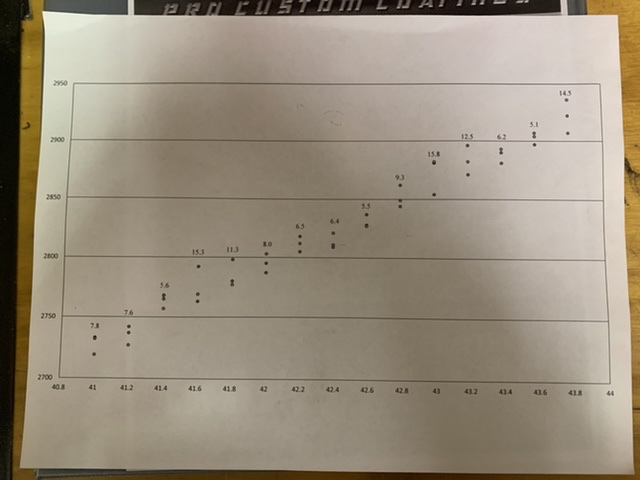

Krieger 1:7 M40 23”
Peterson LRP
RL16
CCI BR-2
Loaded second MV test
3 rounds per load
Grains MV SD
41.0 2728 7.8
41.2 2735 7.6
41.4 2763 5.6
41.6 2774 15.3
41.8 2785 11.3
42.0 2795 8.0
42.2 2811 6.5
42.4 2813 6.4
42.6 2830 5.5
42.8 2851 9.3
43.0 2872 15.8
43.2 2883 12.5
43.4 2888 6.2
43.6 2902 5.1
43.8 2921 14.5
I ran a seating depth test at 42.3 grains...

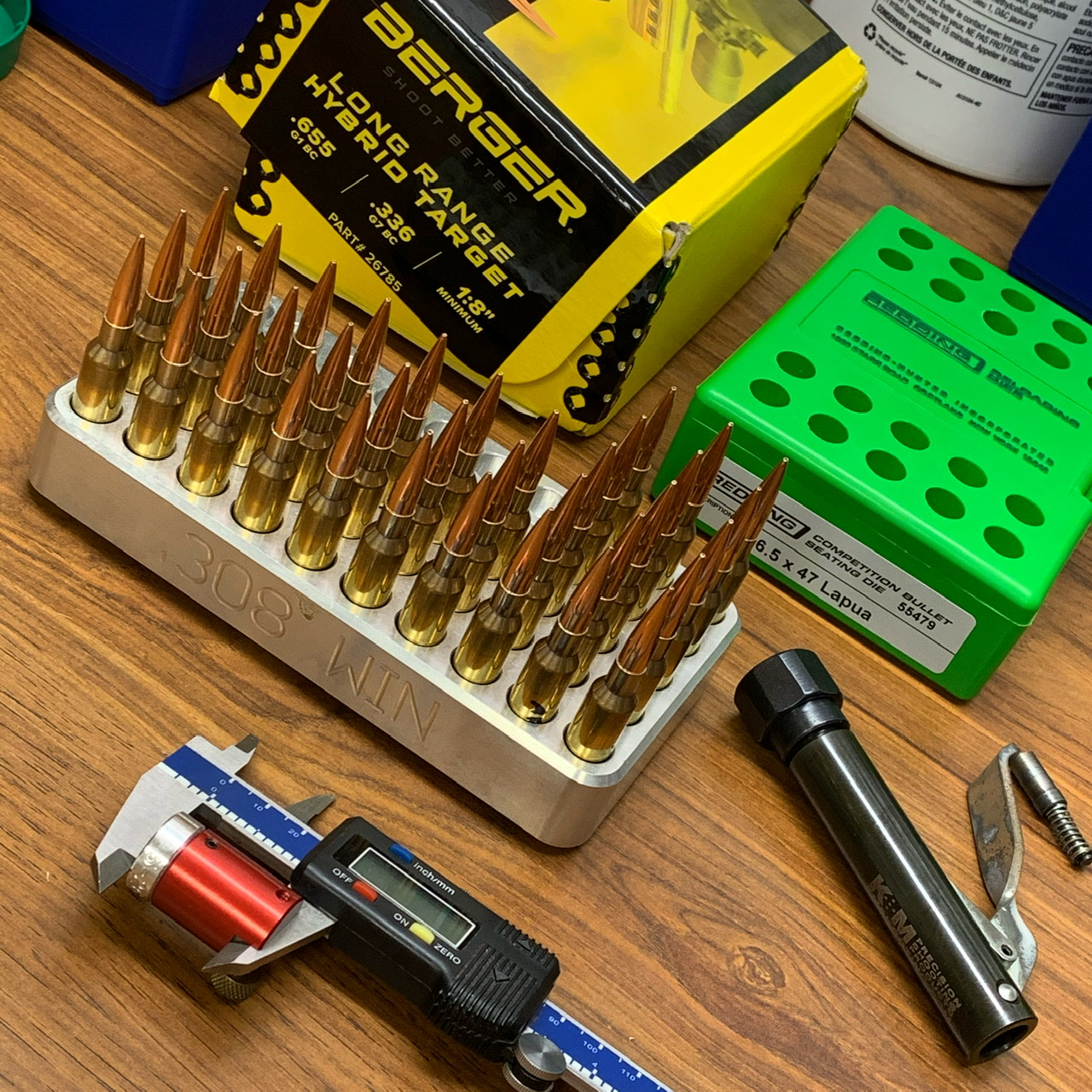

definitely using magazines without binder plates because these suckers are getting long, I am looking at .050 jump after all said and done. Pretty happy with the results thus far.

42.6 2830 5.5
42.8 2851 9.3
43.0 2872 15.8
43.2 2883 12.5
43.4 2888 6.2
43.6 2902 5.1
43.8 2921 14.5
That’s a lot of data. It’s interesting how linear the velocities are. I think a lot of people do ladder tests over chronographs with one round per charge, and then see flat spots on the graph that they think are nodes but are really just random fluctuations.
