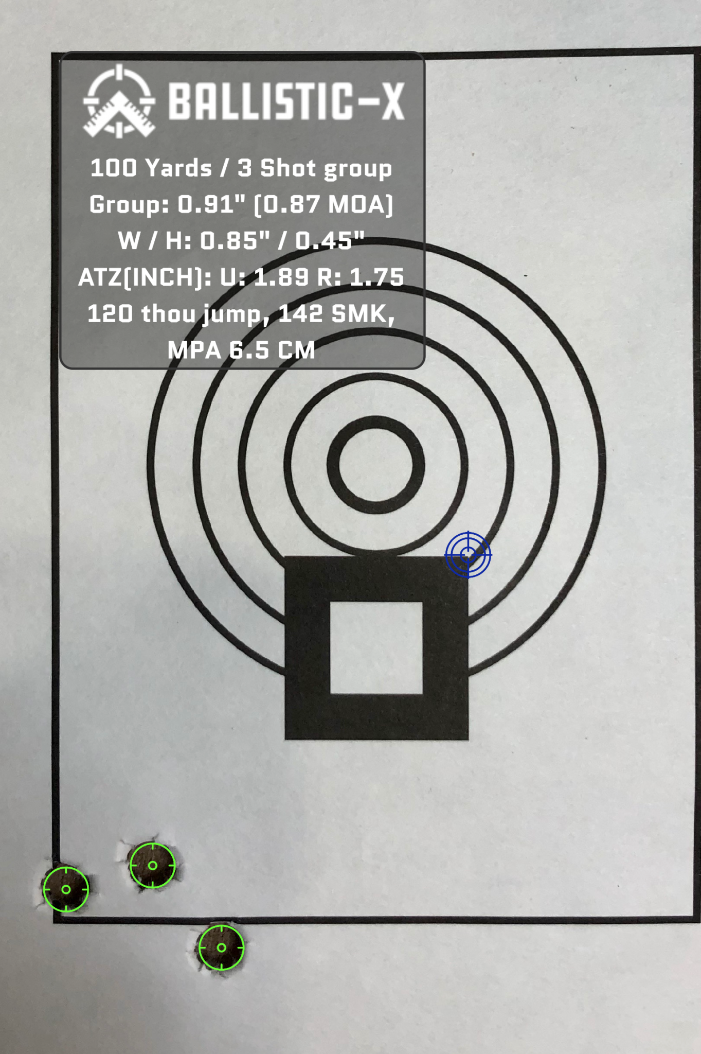

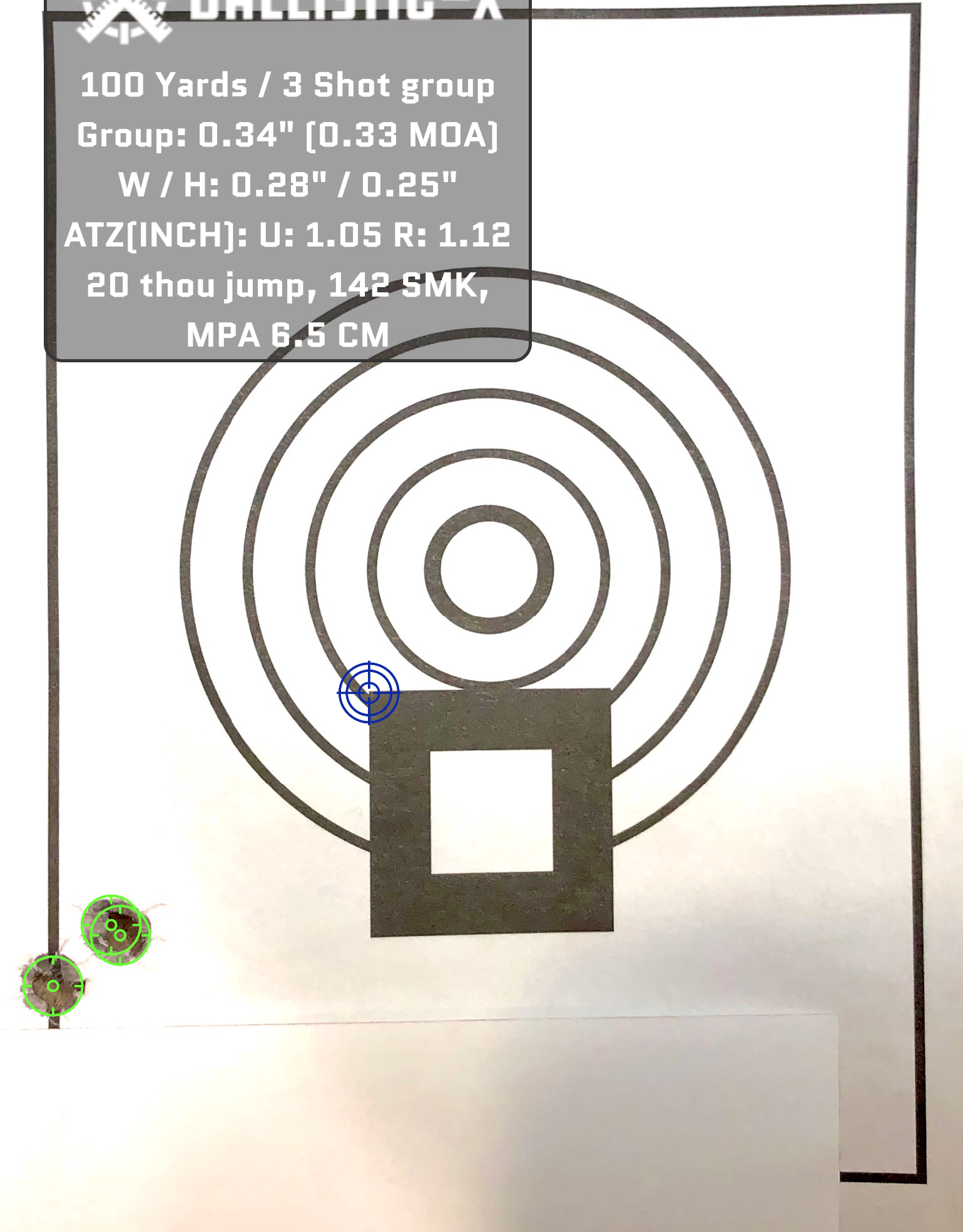

Some jump testing with the 142 SMK (just trying to learn something new, and using up old bullets that have been sitting on the shelf for years):
Not bad, and if i had more time I’m sure I could have optimized seating depth to get a 0.2” group, probably with a smaller jump, like i have seen before.
But I was aiming for a very long jump, so tried 120 thou (0.120”) next:
No good. A 0.9” group is terrible for this rifle, which routinely gets 0.35-0.4” with factory Berger ammo, and 0.25” or better with optimized hand loads. So let’s go deeper:

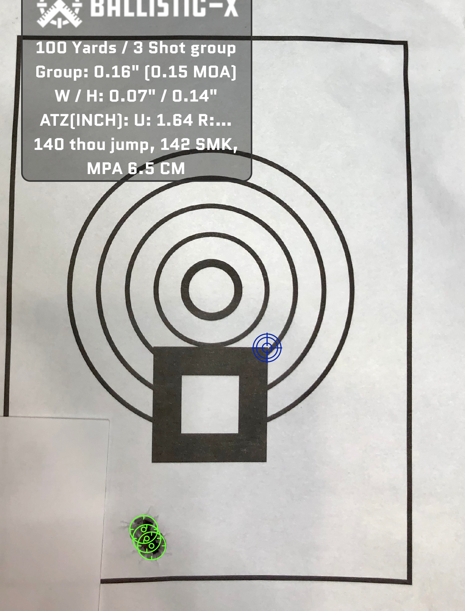

Very happy with that 0.15” group! Unfortunately i ran out of range time and had to abandon the seating experiment for a while. Will try to verify via a set of 5 shot groups later on. I would hope the window is at least 20-30 thou wide. We shall see.
My conclusion is that some (perhaps many?) bullets can shoot well at very long jump.

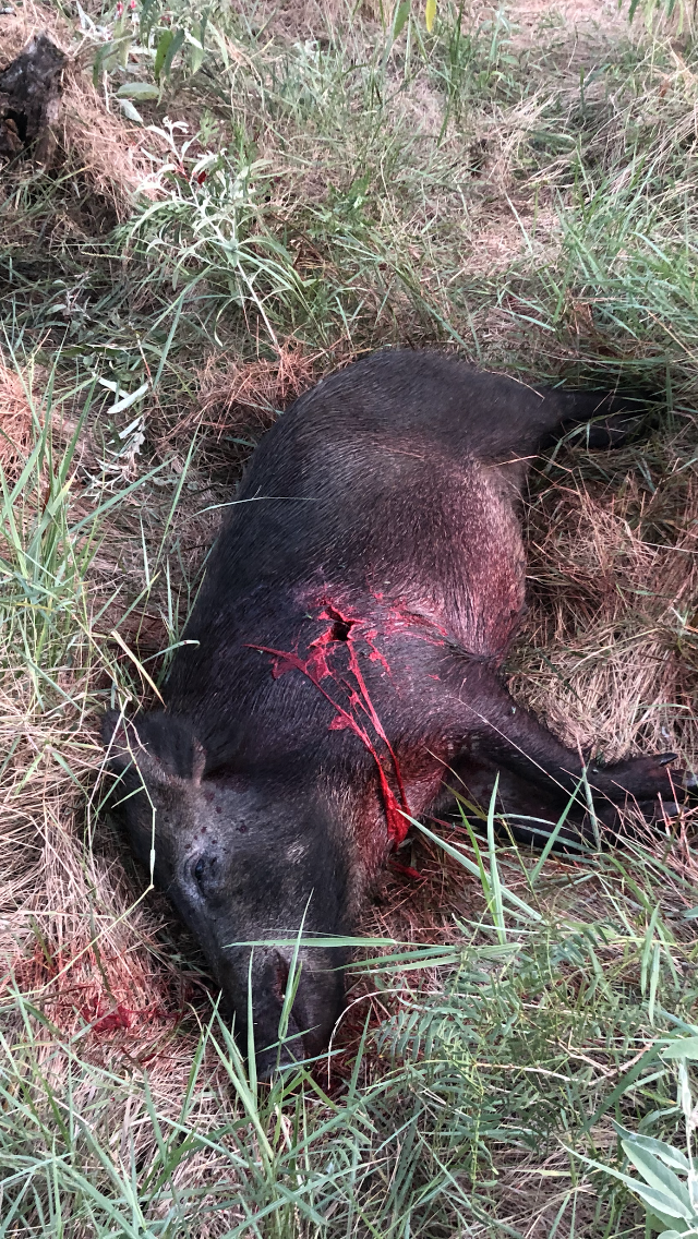

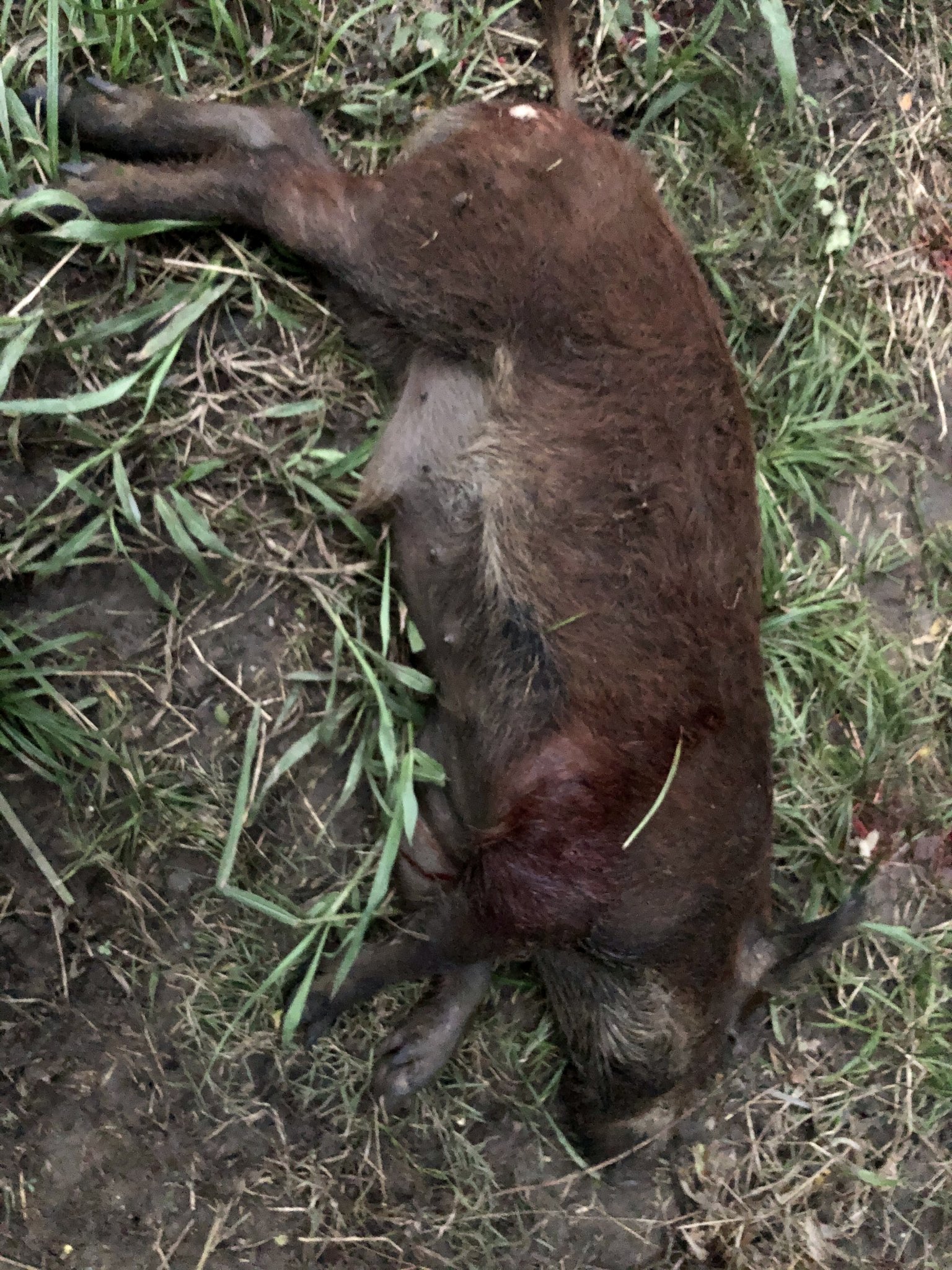

Have used a very accurate PRS rifle (MPA) from a Texas blind to hunt hogs coming into a deer feeder.... got the big sow, using the 156 EOL Berger, which is a very heavy bullet for a 6.5 Creedmoor. That bullet is designed to blow up inside the animal. Launched at around 2680 fps. Very high BC bullet intended for ELR hunting.
But the MPA target gun turned out to be very impractical, and i will not use it again for hunting. Rifle has a 26” straight taper heavy contour barrel and a 4-port MPA brake that adds probably another 3”. Very front heavy. Also 20 lbs total weight with the big Nightforce ATACR scope. Too easy to bump it against the roof of the hide and scare off the animals. And you are rarely stable enough in the typical hunting situations to exploit the 0.3” accuracy of a target rifle shooting a high BC bullet and do head shots, aiming behind the ear of the animal. And i scratched the aluminum stock in multiple places!
The next opportunity i took a lightweight 30-06 with an adjustable AR type stock, so easy to shorten it when setting up. It is a cheap Howa 1500 ($450) that is surprisingly accurate, upgraded to the Blackhawk recoil reduction stock and that makes a lightweight 30-06 very pleasant to shoot. Can do 40 rounds during practice without having a blue shoulder the next day. I would recommend it. Plastic fore end is also quieter compared to an aluminum chassis.
Several hogs came out, and i could quickly move the rifle from one window to another without making a noise. Took the shot at the chest of the mature boar as he won’t stand still. He dropped and i could quickly reposition, cycle the bolt and take another shot at a piglet that ran and stopped, at only 20 yards.
IMHO bullet selection is more important than group size when hunting: Shot the big boar through the front shoulder bone and hit the top of the heart where the arteries join the heart, and the bullet passed through both lungs as well. Used a Barnes 180 TTSX at 2700 fps plus. A target bullet would likely have blown up on that heavy leg bone. The Barnes has devastating performance at short range, and penetrates well if you hit heavy bone, far better than any target bullet with a thin jacket.

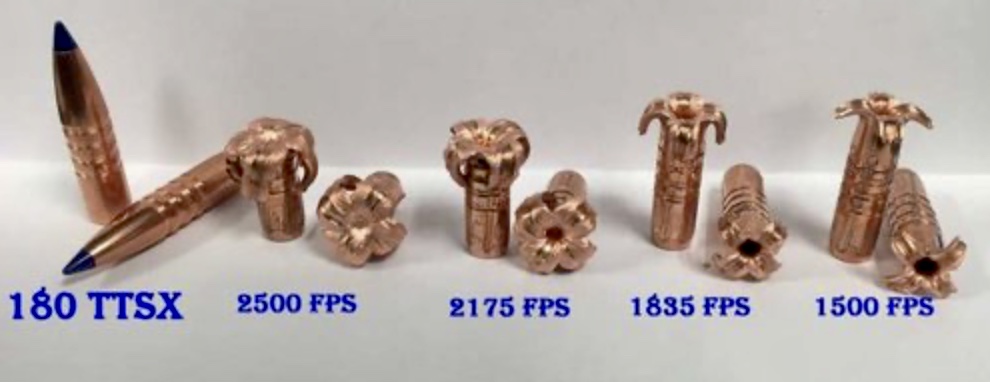

Btw: According to Barnes, the minimum expansion velocity of the older Barnes Tipped TSX is claimed to be 2,000 fps. I feel more comfortable with 2,200 fps as the lower limit (with some safety margin).
The new and improved LRX long range hunting bullet is claimed to expand down to 1,600 fps. [Would suggest a more conservative 2,000 fps as the minimum limit.]
