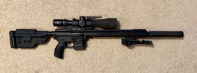

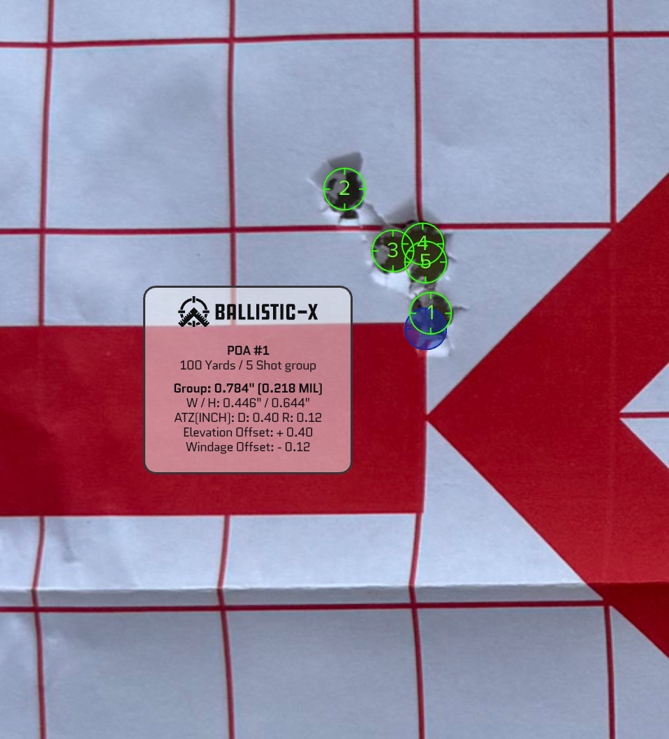

I’ve been playing around with two of these uppers because they’re so cheap, around $600 for two which is half the price of a UP upper. You can swap barrels and handguards. So far accuracy is about what you would expect, not great but you can swap barrels for a better quality barrel. The 556 upper is reasonable with the factory BCA barrel, best group I got was around .8” at 100 with black hills 77gr. The issue I’m fighting with is the sleeve that covers the gas port doesn’t seal the gas off well. I used SS shim stock to get a tighter seal after that range today to try and seal it off which I think should stabilize the MV and hopefully tighten groups up a little.
As you would expect they aren’t super accurate or high quality but they are fun to shoot and my kids enjoy plinking with them which is half the reason I got the uppers. If you get one and want to swap handguards make sure you get a handguard without the tabs that go over the receiver as the BCA is wider than a standard AR upper.
The shorty is a 300BO I played around with. Super quiet and fun to shoot. I’ll probably get rid of one of these uppers and just keep one in 556 for shooting ground squirrels, coyotes, and target plinking for the kids.

Threw a WOA barrel I had lying around the shop on and now this thing is stacking them. Was consistently getting .3-.7” groups. The one group was just over an inch but I was fighting mirage bad and threw that shot being impatient so I put two more in that group after the flyer.
I’m gonna swap the handguard out and see if I can’t make it look a little less ugly.
