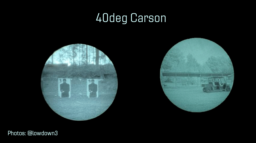

First up is the PVS14 with standard PVS14 "Carson" glass-
Next is the PVS14 with the Boomslang 50 degree FOV lenses-
Next we moved the PVS14 with the Boomsland 50 degree FOV lenses to the tripod that held the regular 14- which previously was centered on targets marked 3 and 4
The above pic is a better representation than the first pic, again due to ME holding the camera adapter up to the eyepiece.
We then placed each unit on the same tripod individually. Looking back towards the back of the square range area, I tried to place the right edge of the FOV of each lens on the front tire of the Ranger for a better idea of how the view opens up at a little more distance. This is roughly 25 yards.
First the PVS14 with standard lenses-
Next the PVS14 with the Boomslang lenses with the same angle, same tripod facing the Ranger

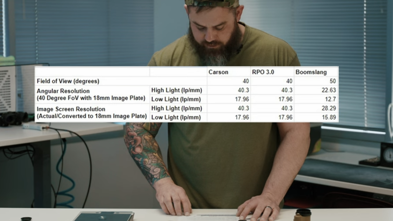

It's difficult for me to tell from the photos but it does seem like the boomslang images aren't quite as sharp as the Carson glass.
A few other vendors that have been reviewing these lenses indicate a drop in sharpness/resolution. Are you finding that to be the case?
Photonis commented here about resolution on a NocturnalityGear Instagram post.
The pics show two different 14s with almost identical tubes, at the same measured distance from the same size objects, measured to be sure they are the same distance apart.
Taken with a crappy Iphone with a broken camera adapter just held up against the eyepiece of each unit.
What do you think? I can't see enough of a supposed decrease to outweigh the greatly increased FOV.

The eye relief is a bit better than 17mm. Cold Harbour Supply did a very nice review of the optics on You Tube. And as we reported (commented) on their site, the Boomslangs are designed specifically for the PVS-14. That particular standard housing size (the internal dimensions of the housing) limits what optic designers can do in terms of wider FOV optics. We can design 50 degrees with 25mm eye relief, it just requires a different internal housing design. Therefore, the Boomslangs were designed to provide 50 degrees FOV capability that is backward compatible to almost all PVS-14 type night vision goggles currently in use. There were optical tradeoffs, as noted in the You Tube review, but the end goal was to minimize fisheye distortion, increase light transmissibility, reduce weight, and maintain edge to edge resolution while preserving as much clarity as possible while drastically increasing situational awareness. In terms of eye box sensitivity, a lot depends on your setup and road conditions, however generally speaking the eye relief is comfortable enough for uses such as riding a bike or ATV off road.
Reactions: Magsz18 and st1650
Had mine for a month … Pretty sure I’ll be going back to regular Carson 40deg lense. The short eye relief wasn’t the issue it’s the loss of clarity and how unforgiving it is when moving around. It’s weird to explain but it feels like you’re always out of focus or your diopter is set wrong. Also doesn’t handle the halos as well and there’s more blooming of IR laser and illum. Also makes the tube blems way more noticeable.
Maybe they work better with super duper clean supergain 3000+ FOM tubes or whatever but then I’d probably not be thrilled of loosing that resolution and crispness. Probably be better used for indoor/urban environment where the bigger fov/SA is more important than resolution but then … why not just run binos
