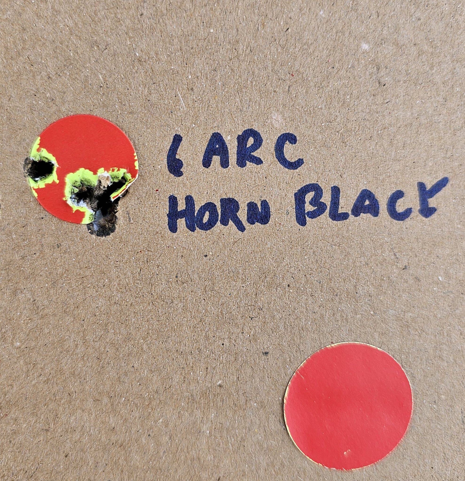

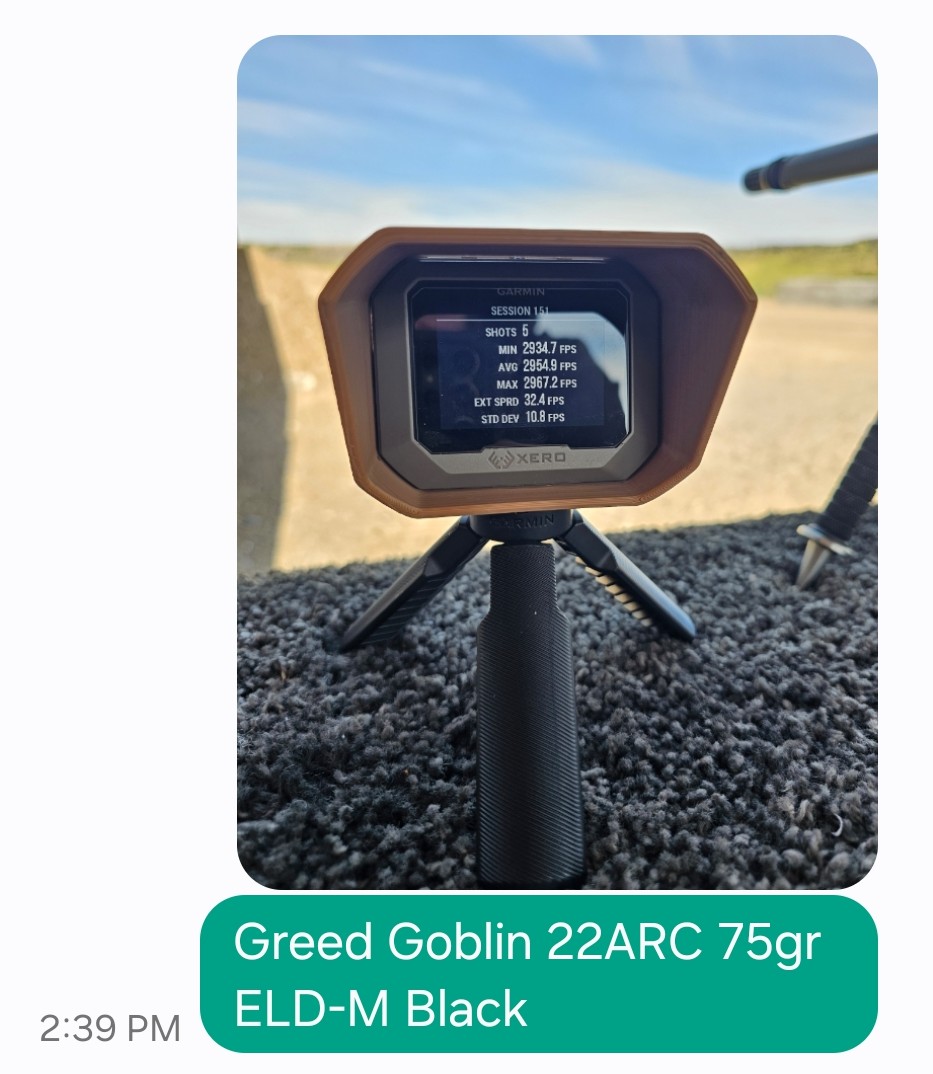

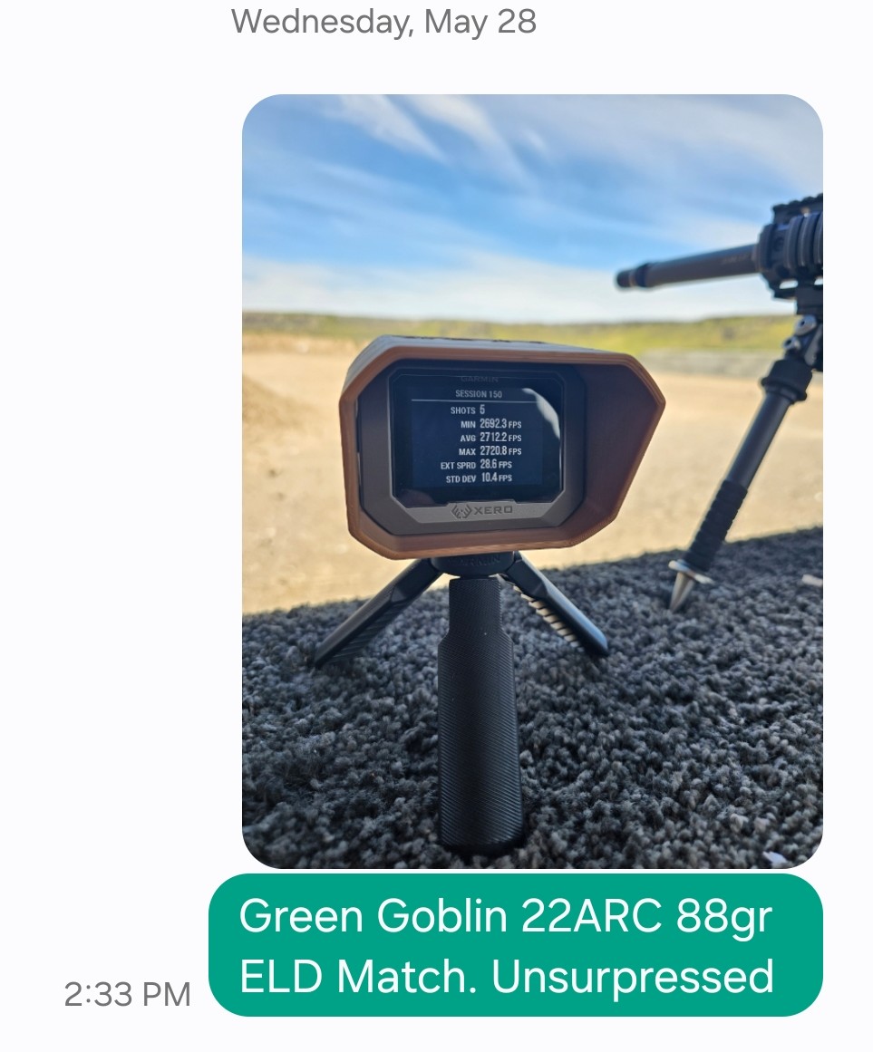

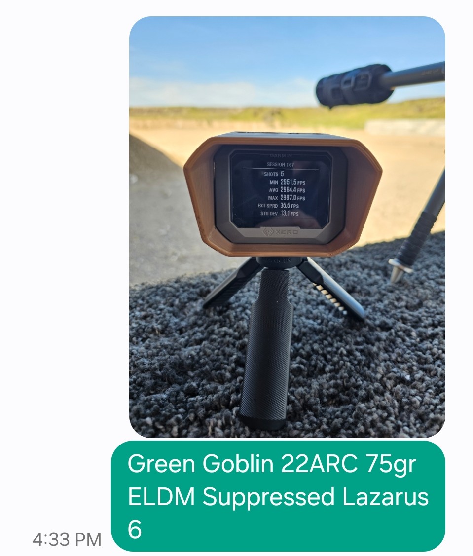

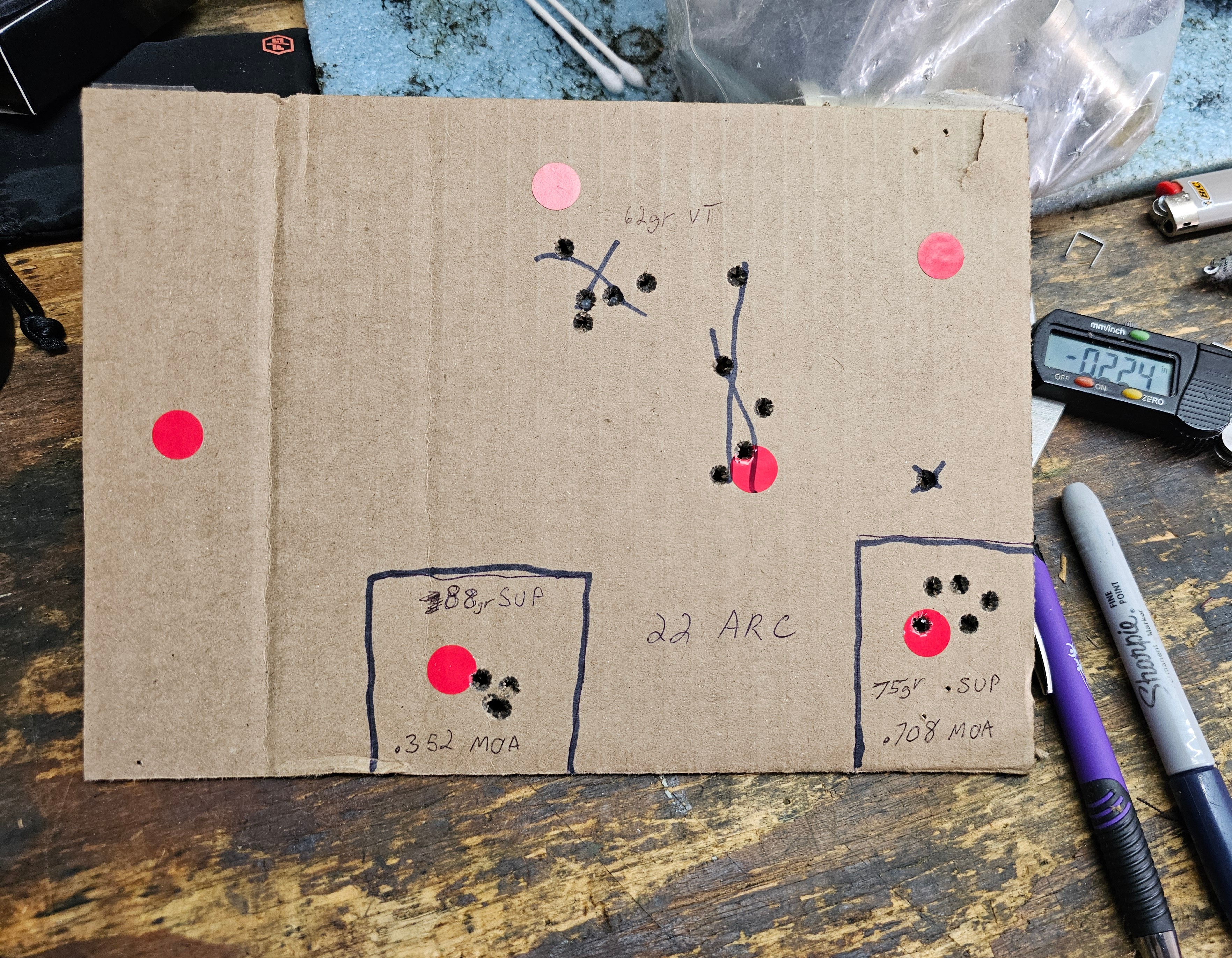

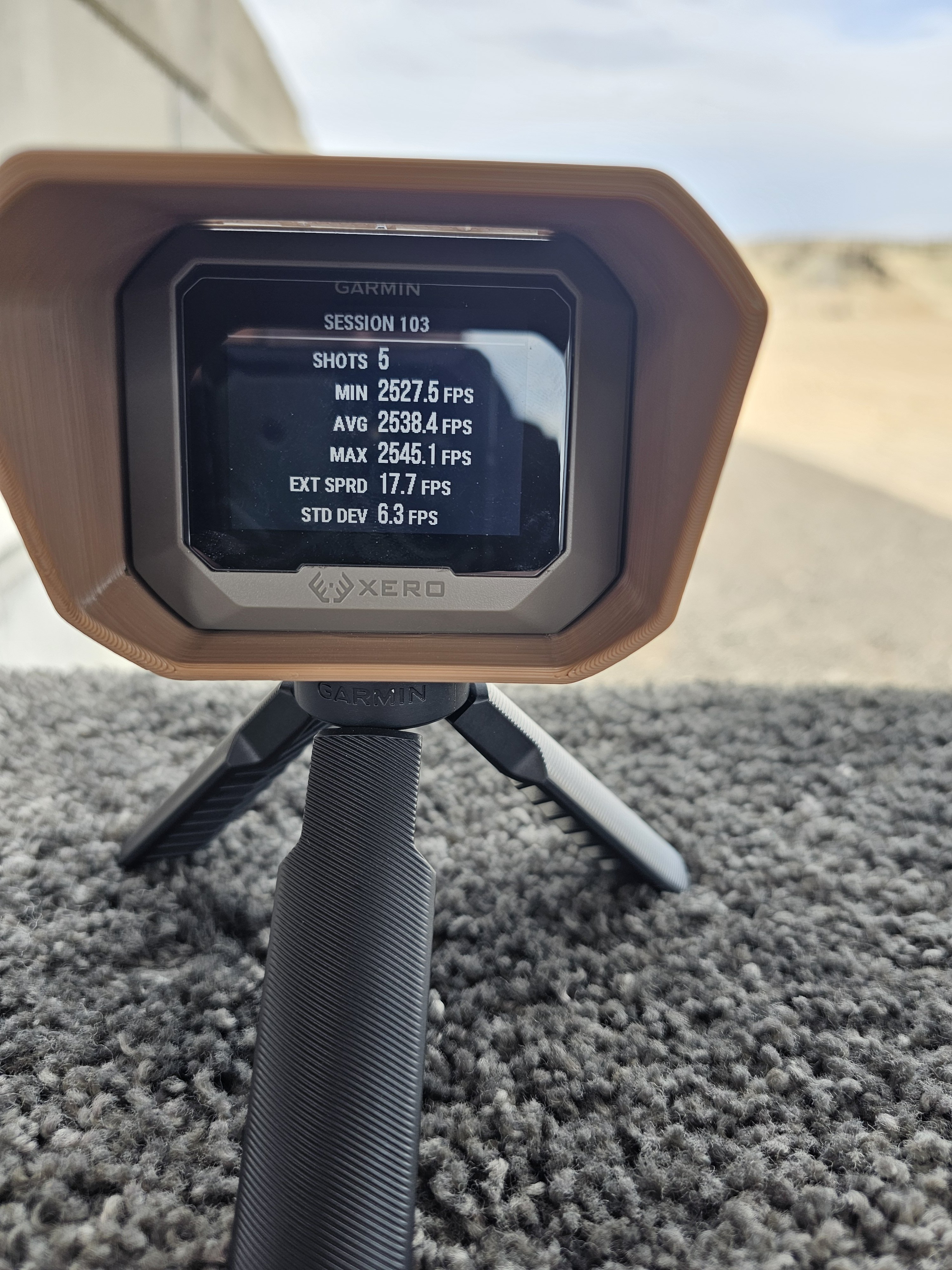

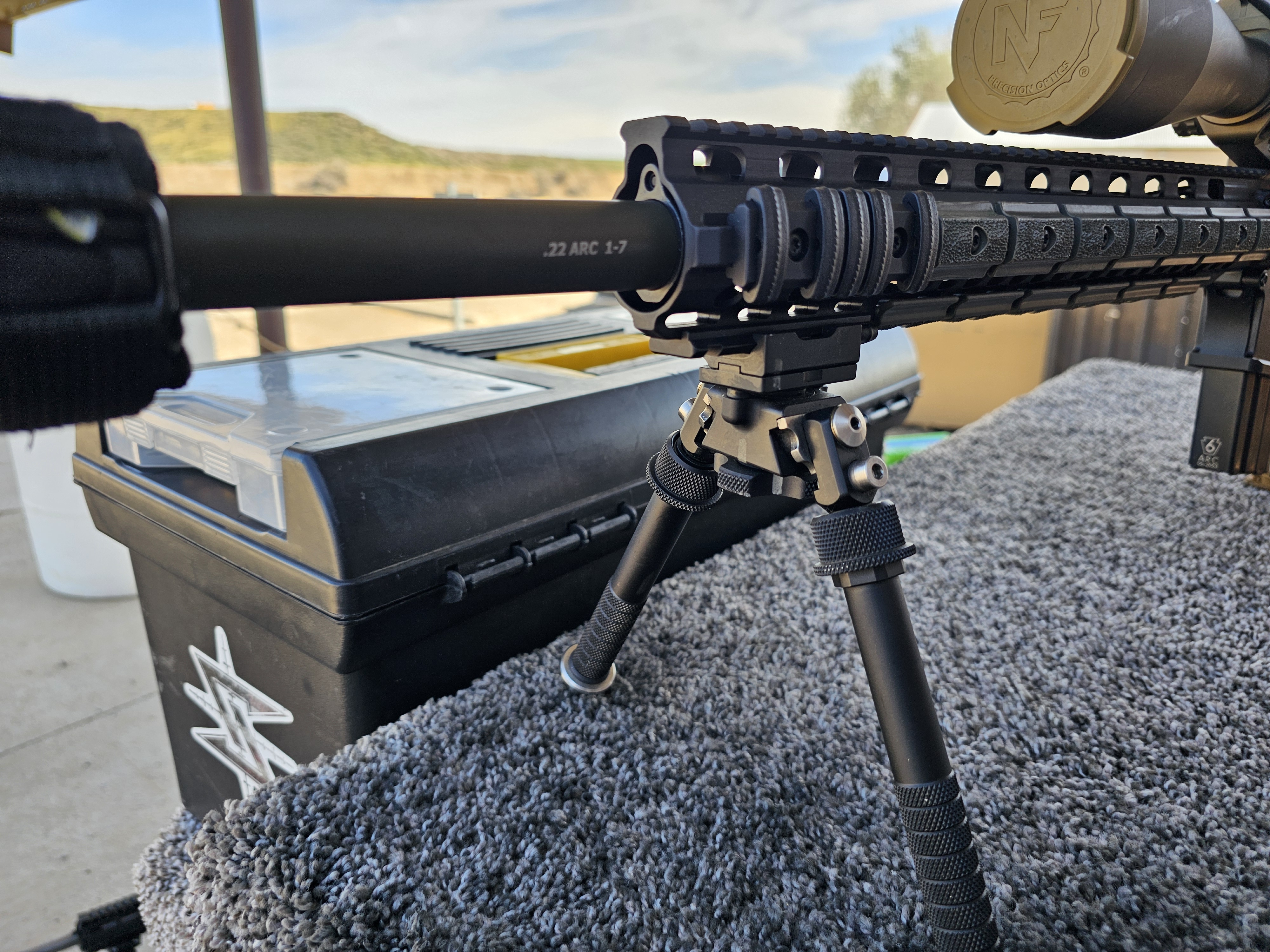

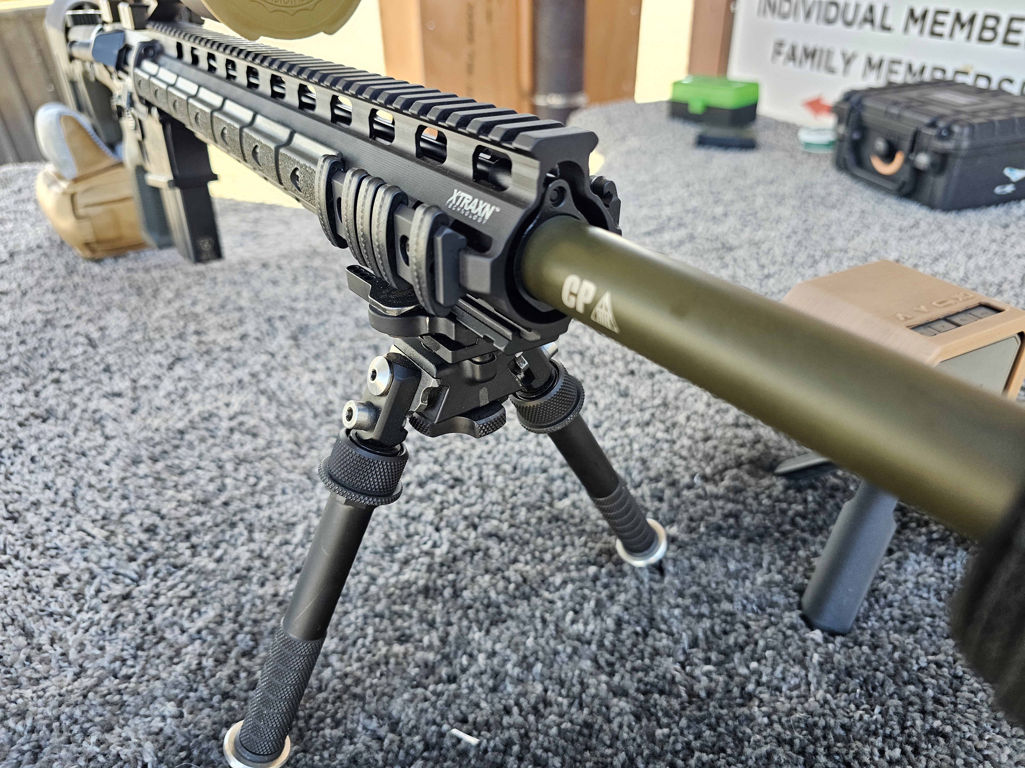

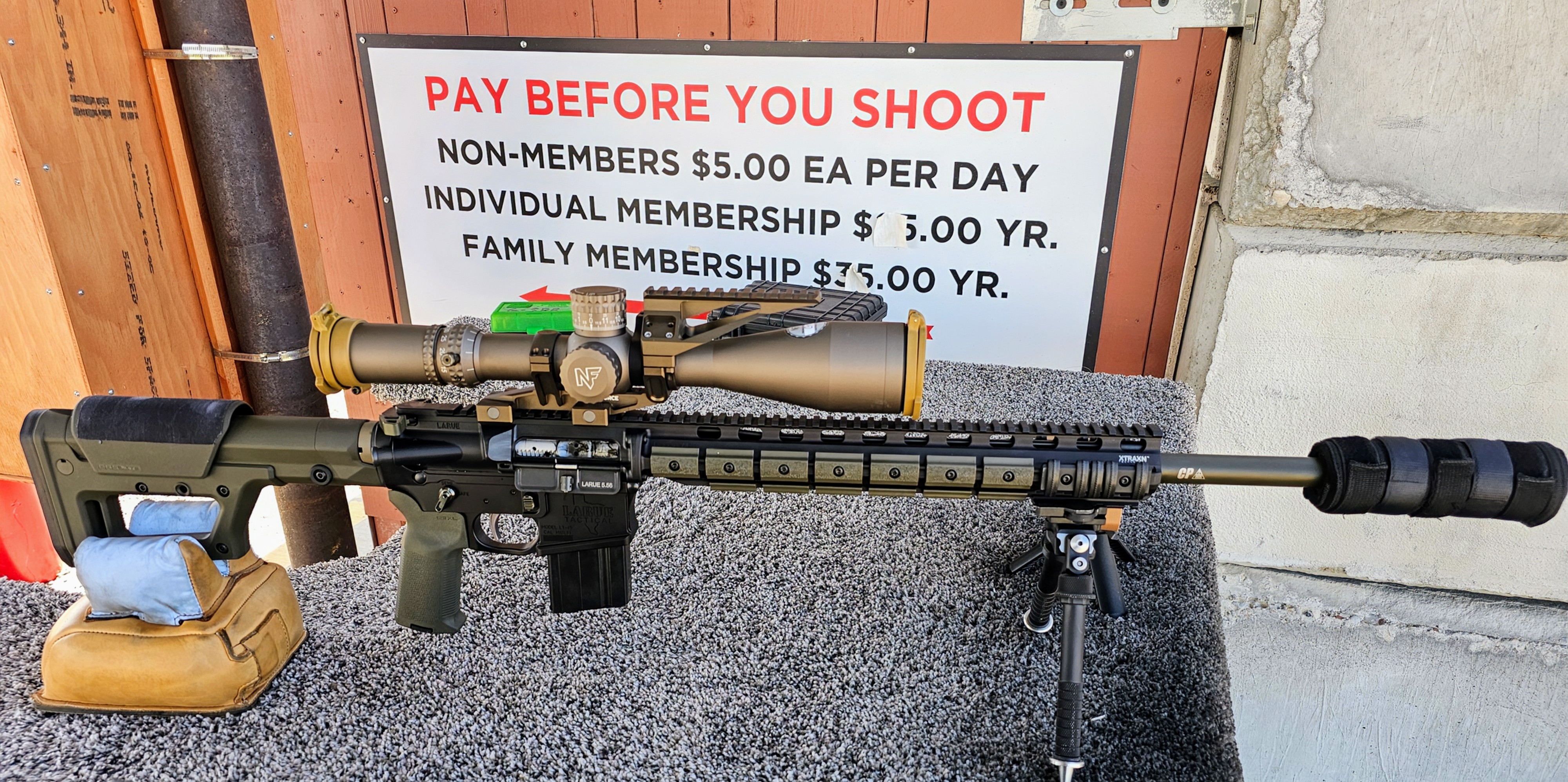

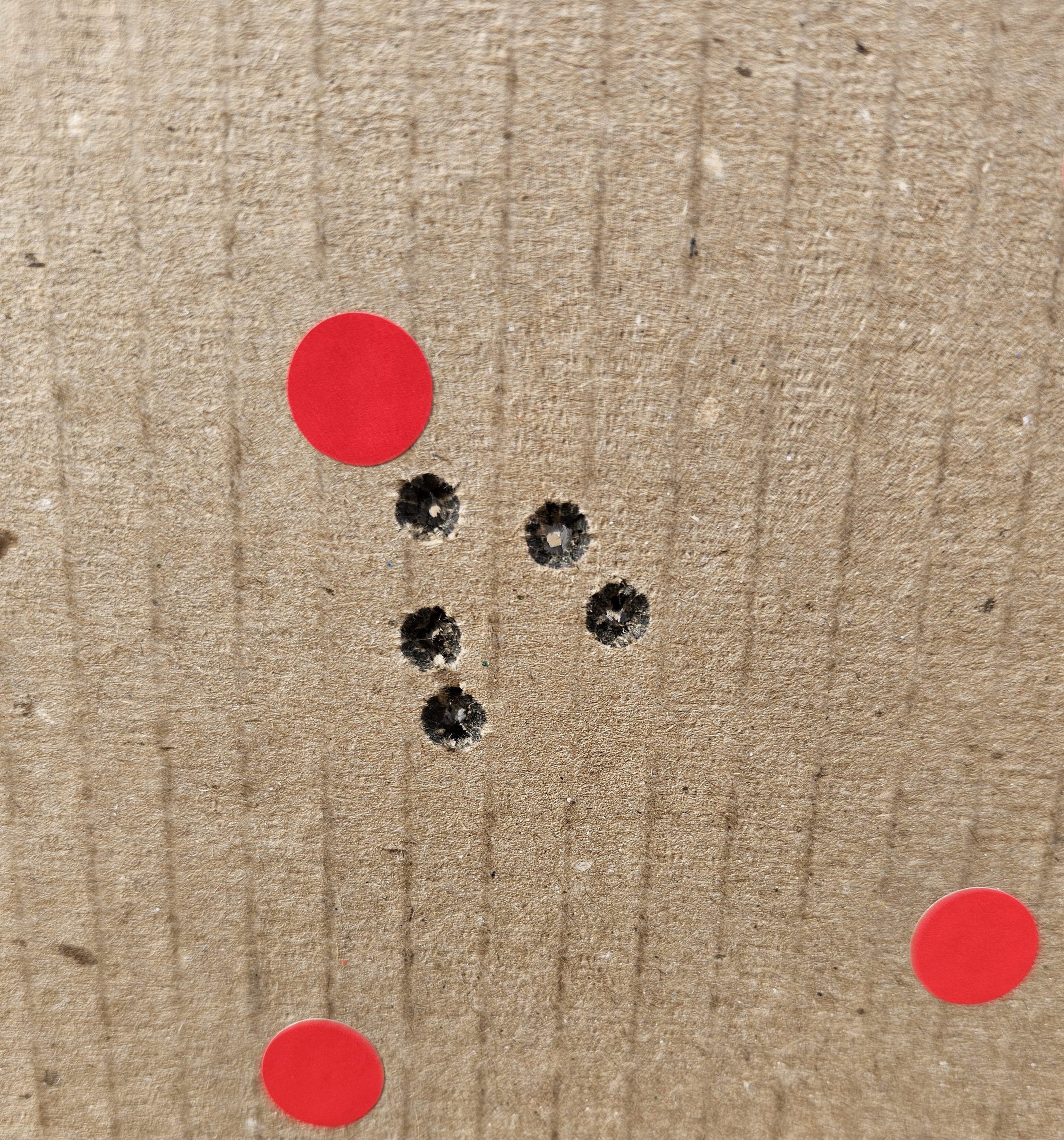

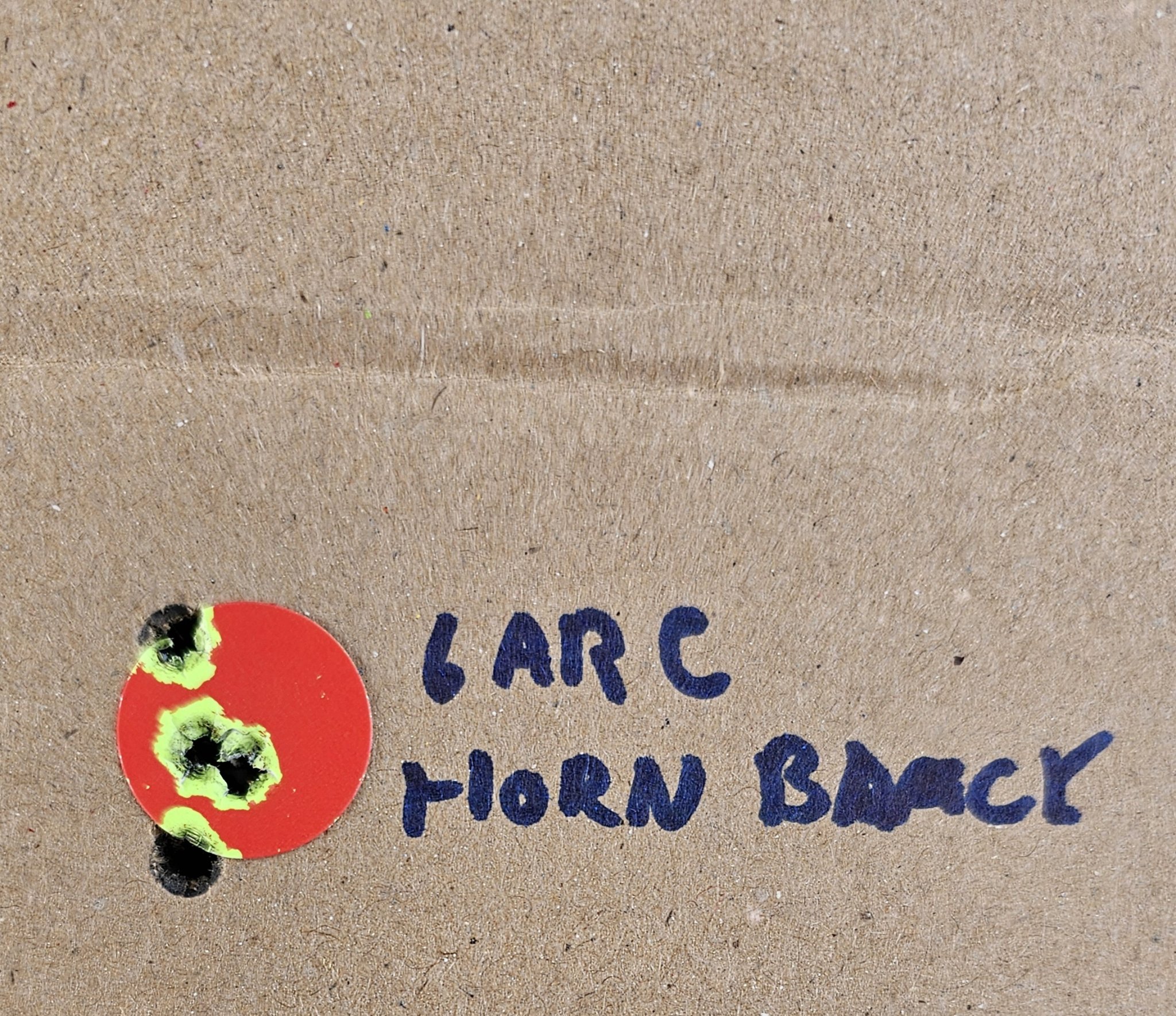

    Just took this girl out for her initial range session today to dial in the gas system.
    All five round groups shot with Hornady Factory 105 black ammo.

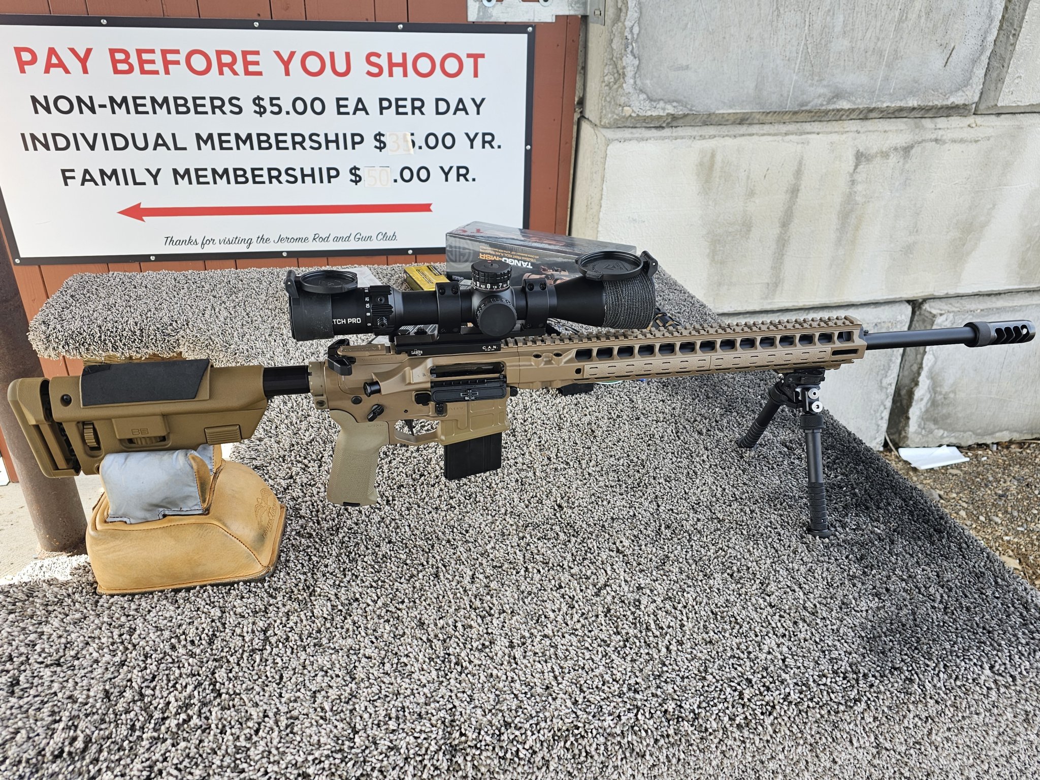

    Raidin Build Kit.
    Geissele SSA-E X Trigger.
    Vlotor A5 H2 Buffer system with Dark Hour 13 position receiver extension.
    Paul Ross 22" Bartlein Barrel 4 Groove / .800 Gas Block Journal +2 gas system / 5/8x24 threads.
    Young Manufacturing Chromed 6ARC HMB Bolt, in Radian Enhance Carrier.

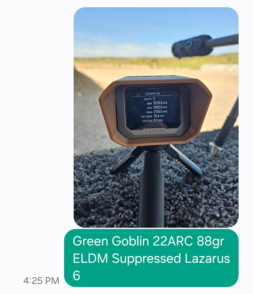

    I haven’t tried TAC but it could work, Staball match too. They’re a bit on the faster side so probably be a better match with a shorter/lighter bullet or a mono.

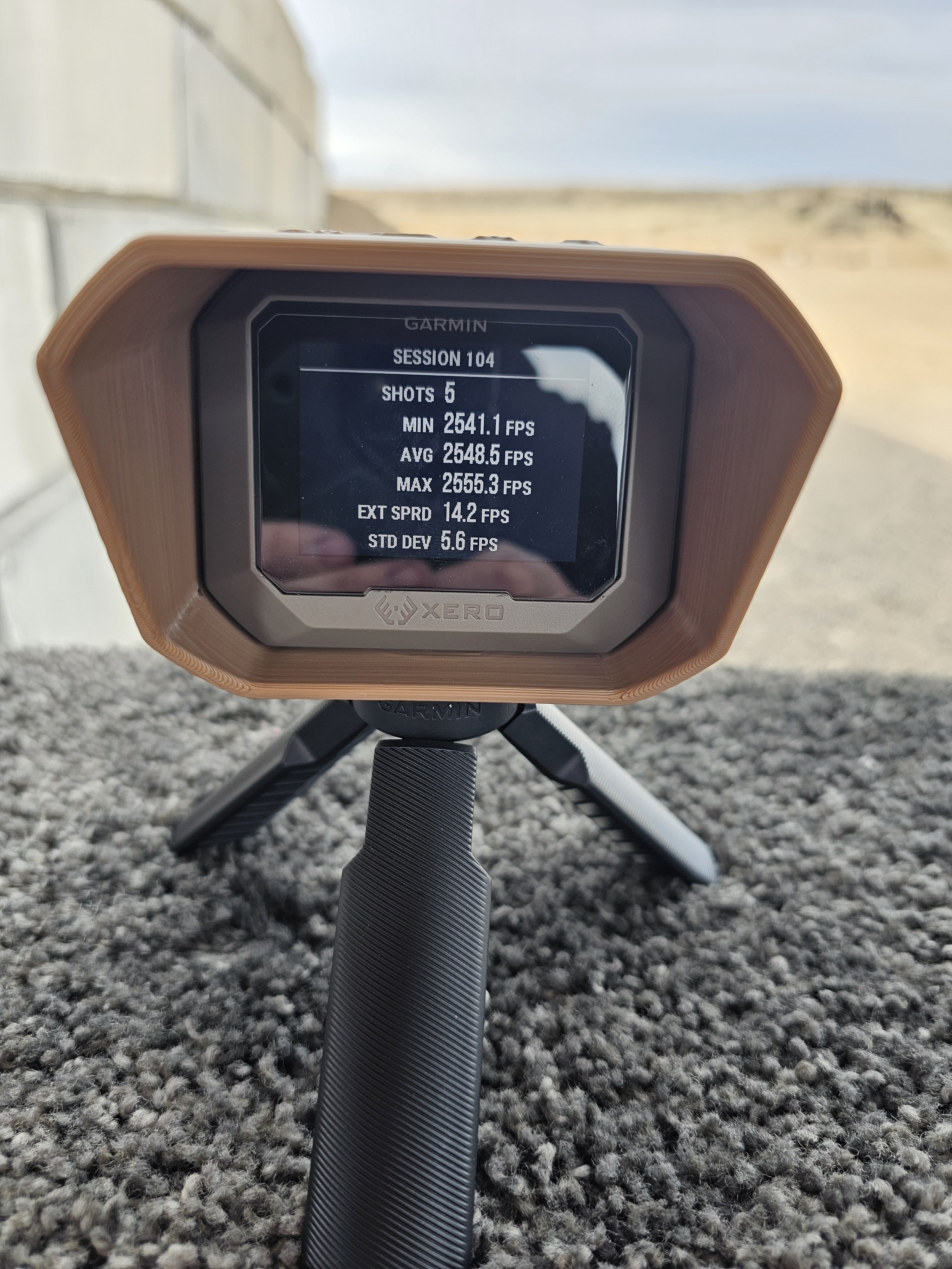

    With the Factory Hornady Black 105's I average 2656 FPS and a SD of 14 out of the 22" 4 Groove Bartlein, I only shot one box today so im sure it's a safe bet to say she might speed up. Next outing I'll throw a can on as well.

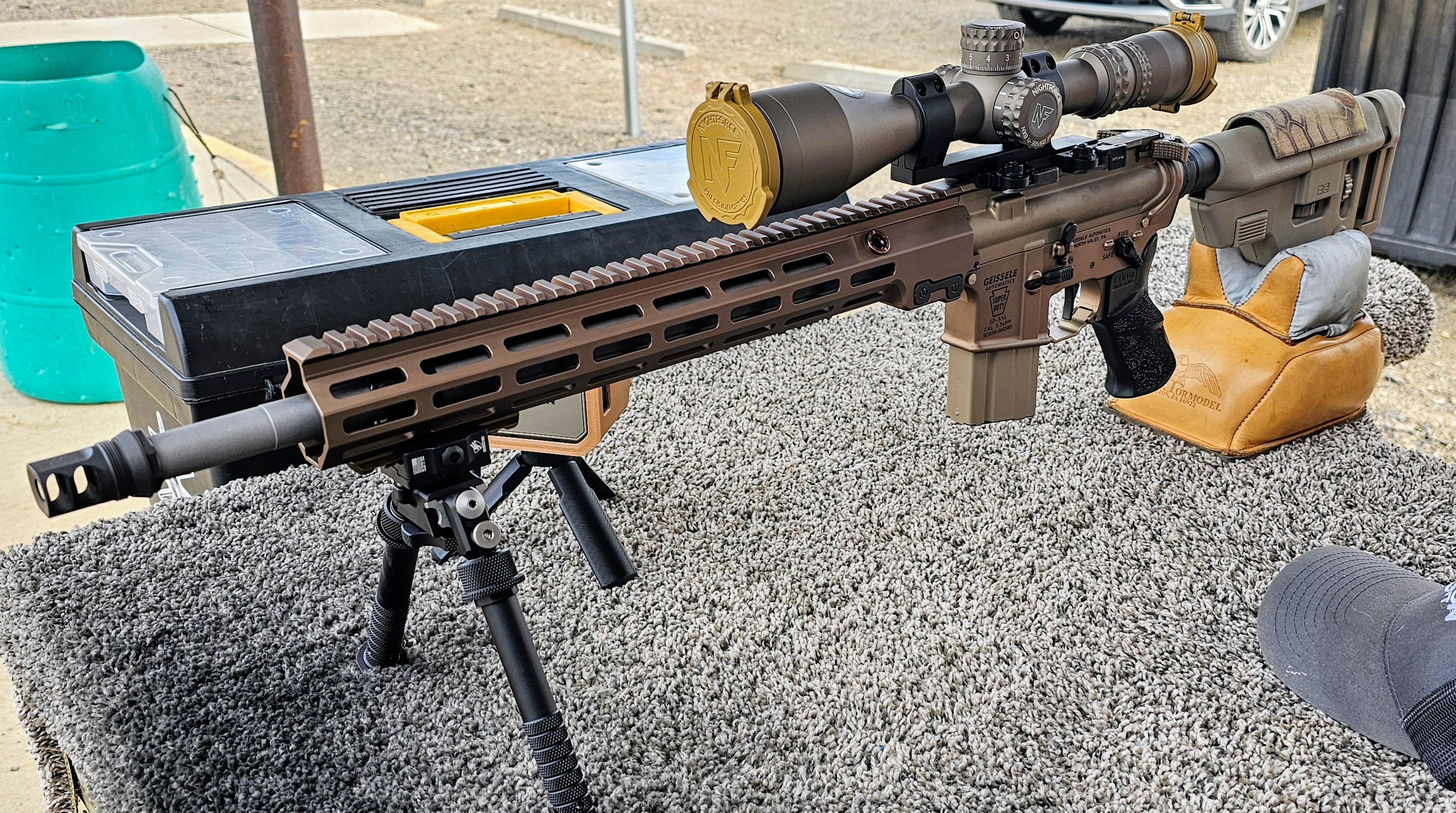

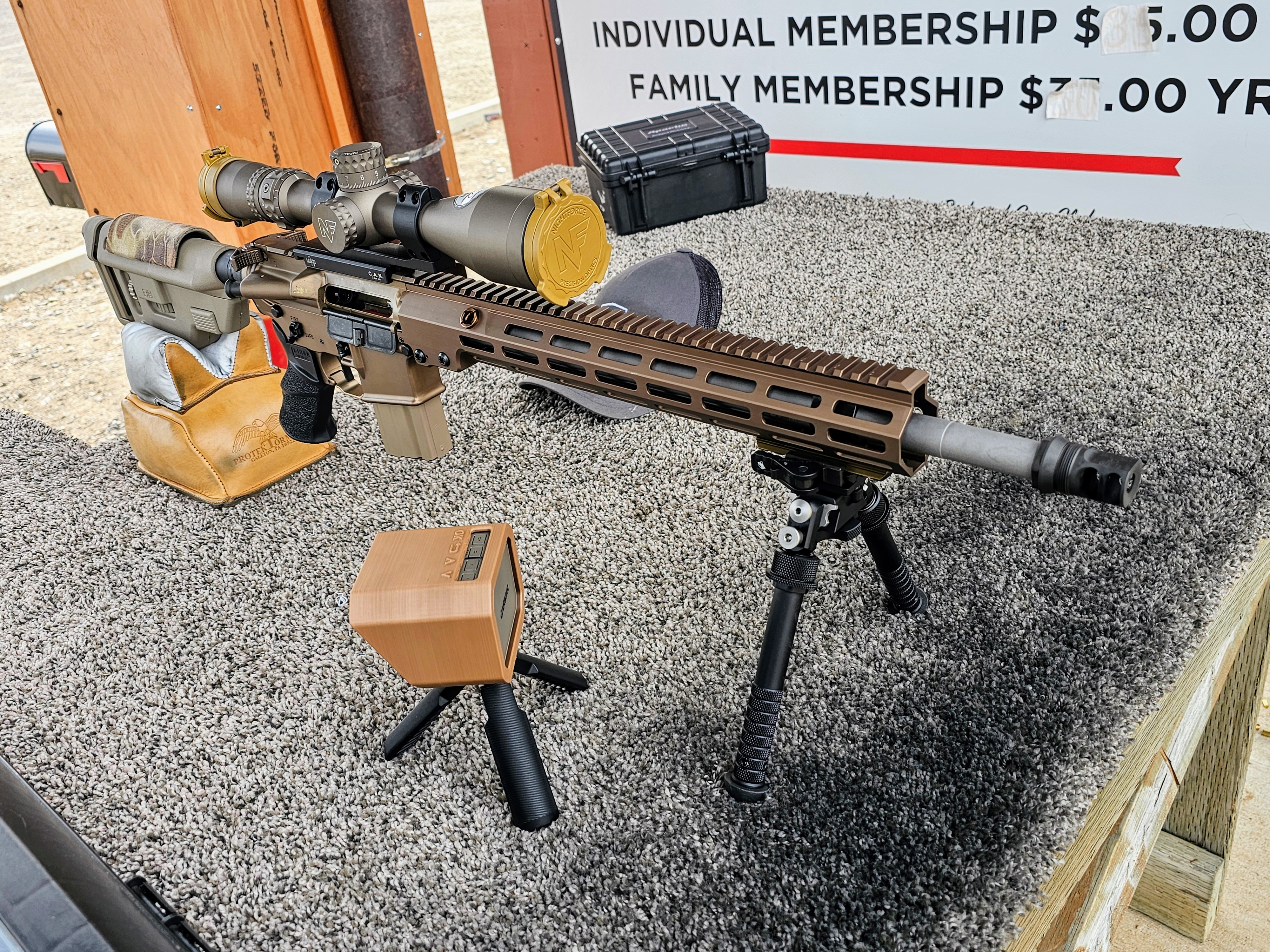

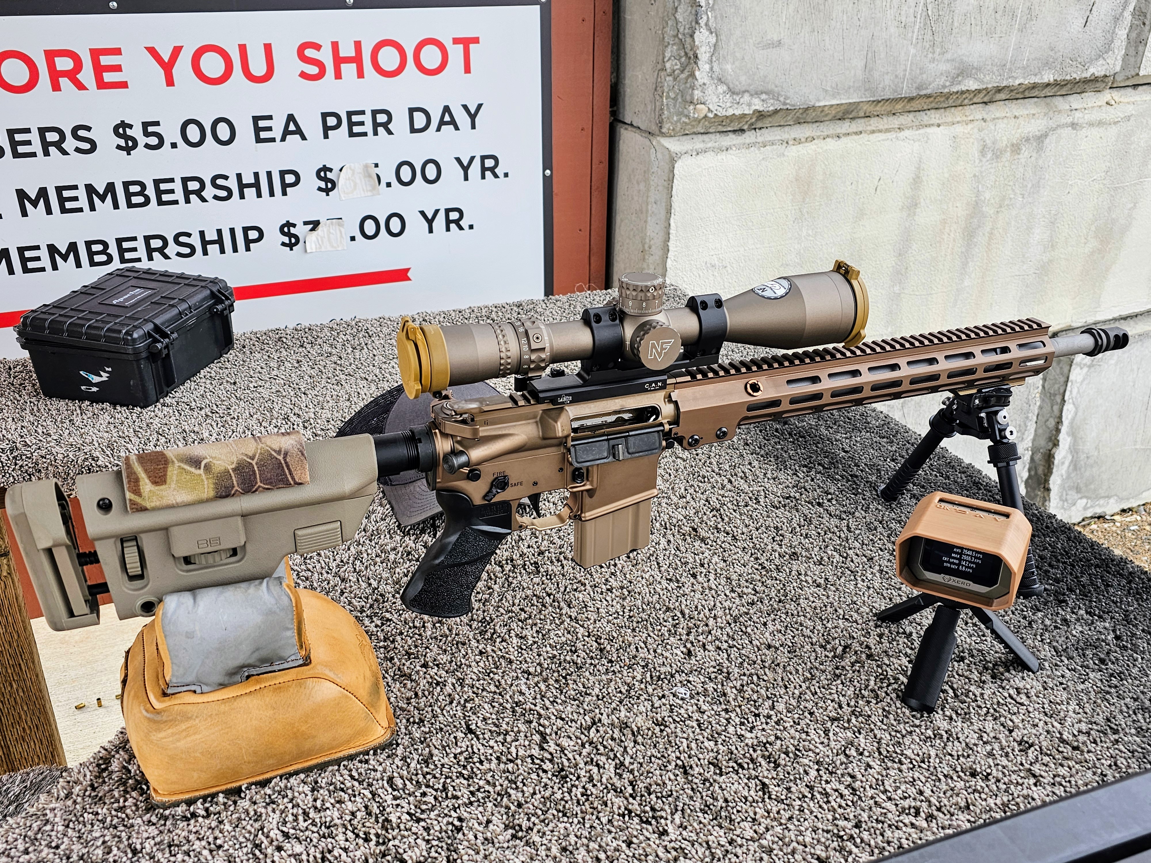

    Just put this together yesterday, Looks like she has potential 😁
    (1) Geissele Receiver Build Kit.
    (2) VLTOR A5 H2 Buffer System.
    (3) Superlative Arms Carrier and AGB.
    (4) Craddock Precision RTR 6MM ARC 18" Mk12 MOD1 Barrel and Bolt.
    (5) B5 Precision Stock.
    (6) Geissele SSA-E X Trigger, tuned to 2.5lbs
    (7) Geissele Ambi ChargingHandle.
    (8) Ambi Safety, Mag release.
    (9) Larue C.A.N 34MM Scope mount.
    (10) Nightforce FDE NX8 4-32x50 FFP Mil-XT
    (11) Atlas PSR Bipod.

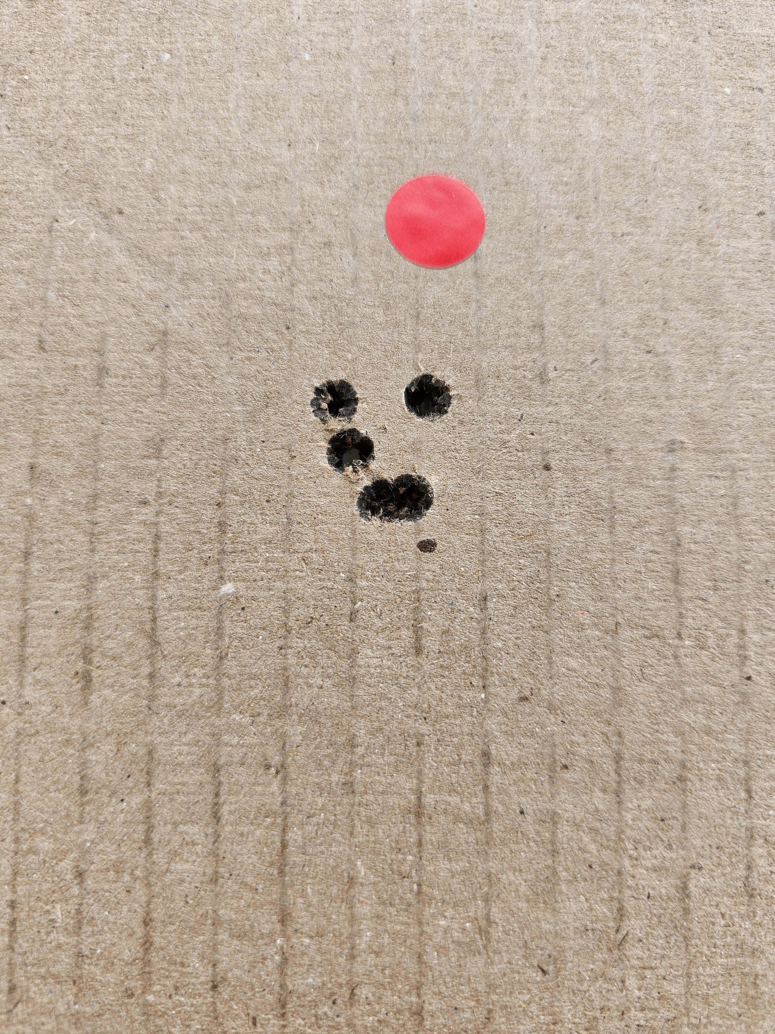

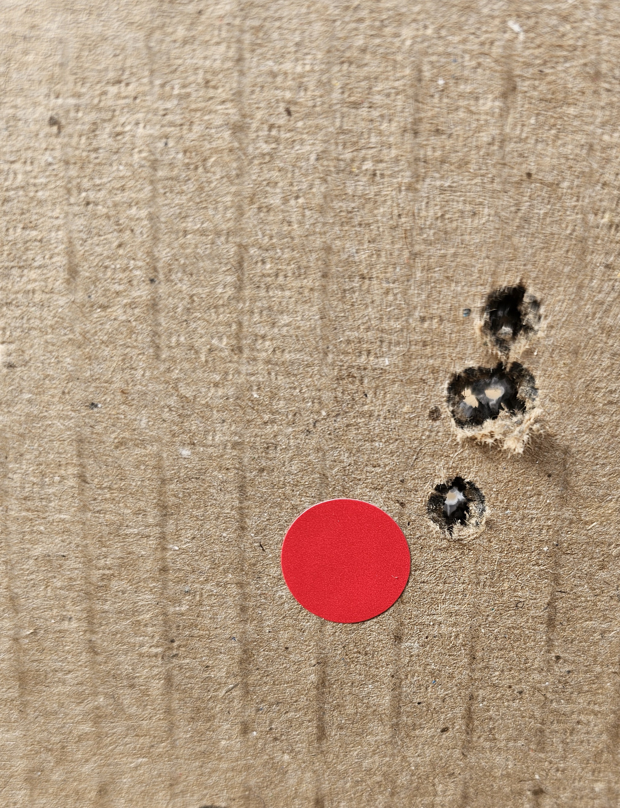

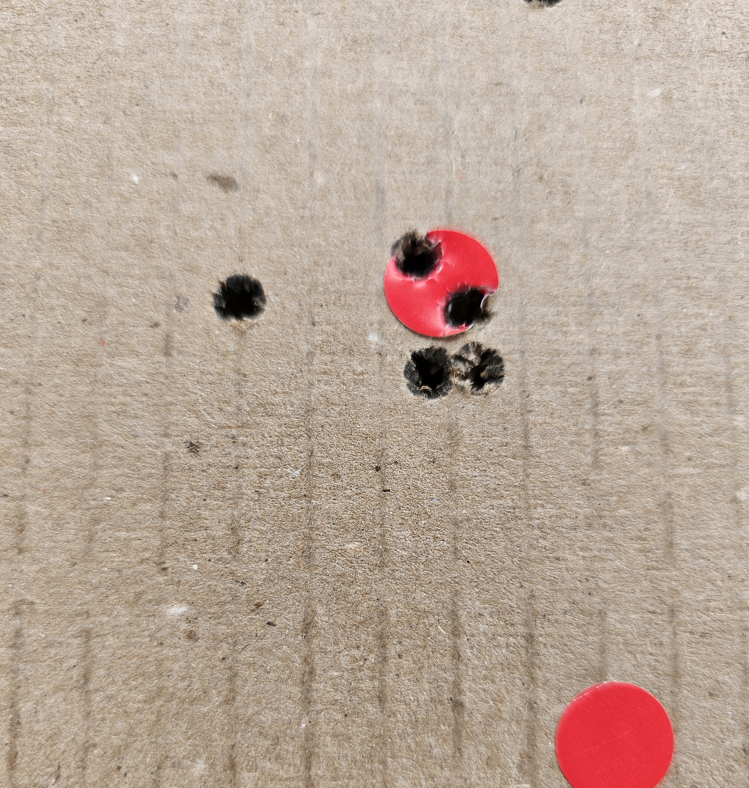

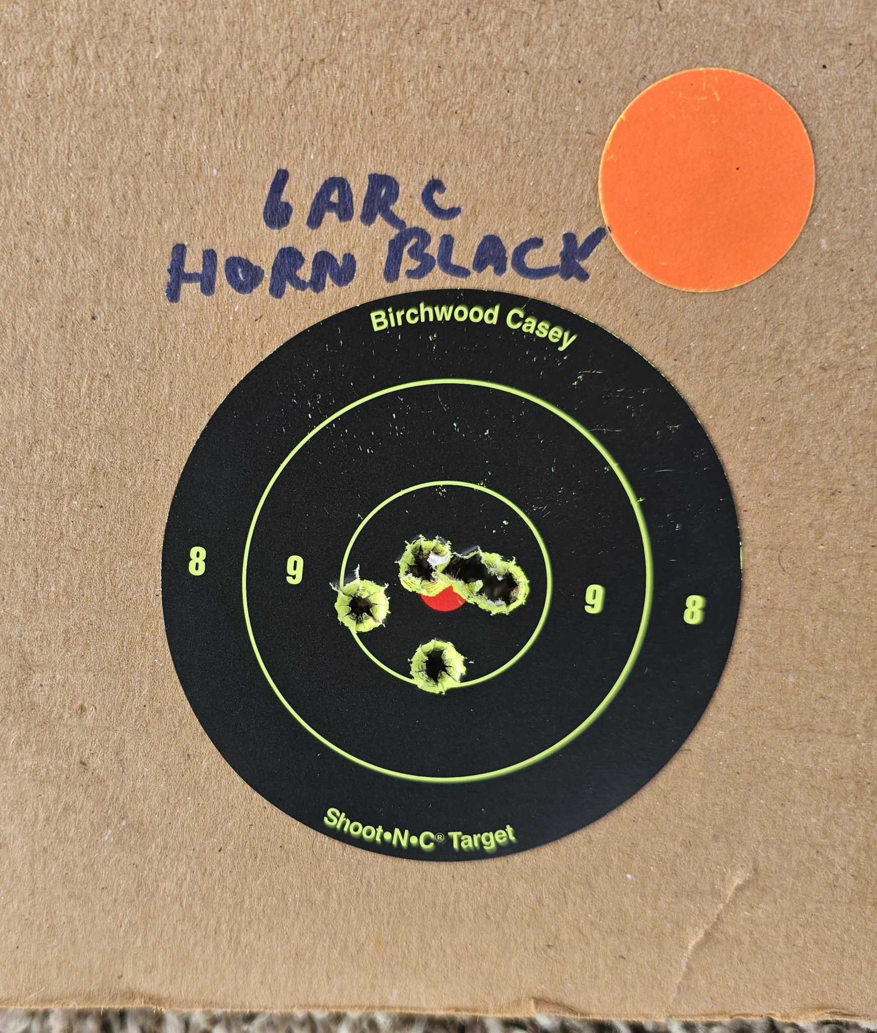

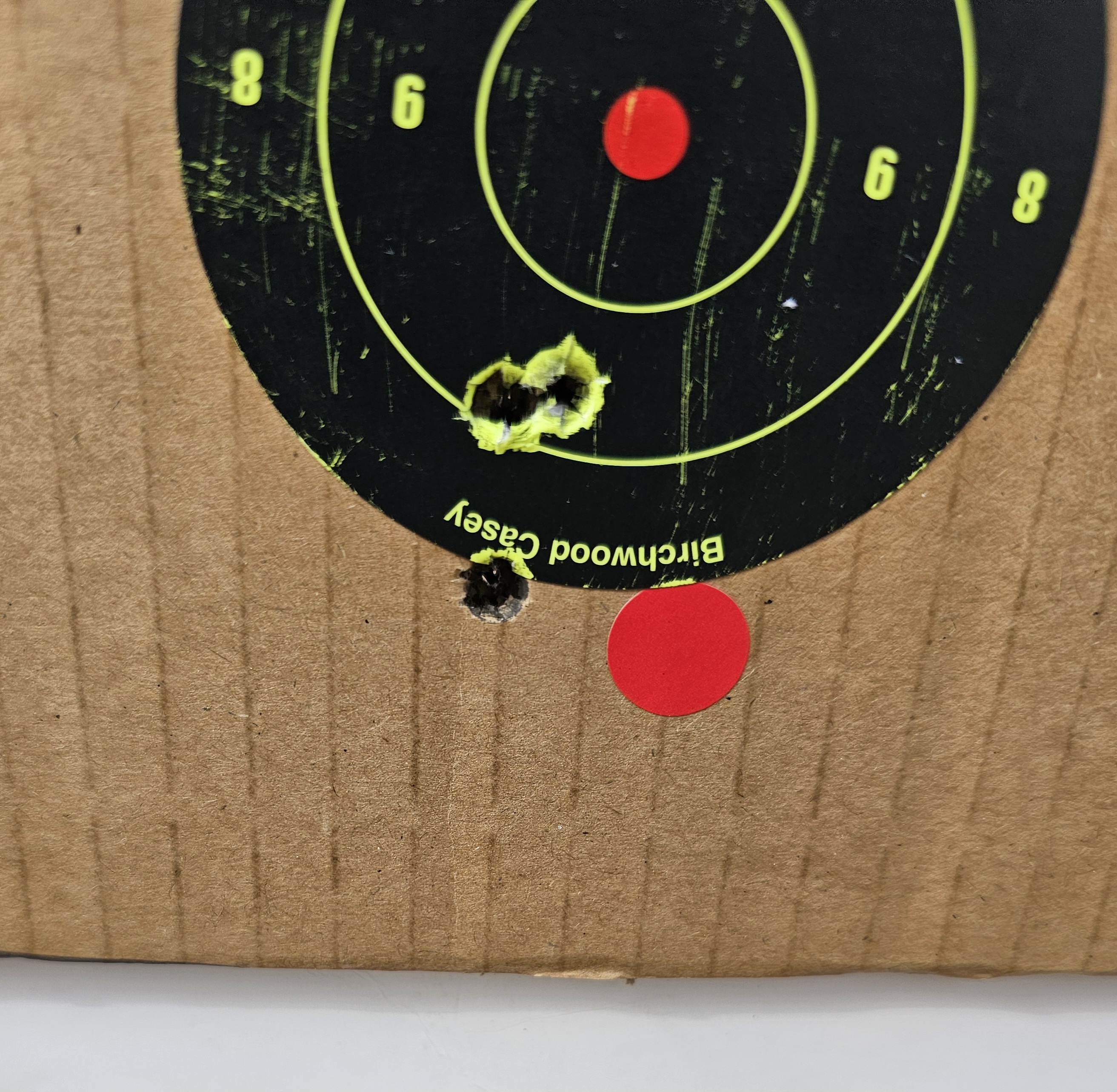

    She definitely prefers the Hornady 108 ELD Match Factory Ammo, first (4) 5rd groups average Sub 3/4 MOA.
    First 3 rounds out of the barrel during AGB Adjustment, shooting 1rd at a time just over 1/2 MOA.
    Next outing we'll see how she shoots with the .30 Cal Banish attached.
    Man you’ve got fantastic taste! How do you like the NX8 4-32? Ive heen debating grabbing one for an M82. Obviously a gun like that doesn’t need ATACR glass, but more mag would be nice.
