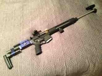

Here's a pic of mine:
Thanks, I'm still getting the feel for this round. My current FF load with the 105 Hybrid is 31 grains of CFE223 which is giving around 2815 in warm weather from my 28". I didn't really intend to have a FF load that "full power" but it shot so well I didn't feel like changing it. CFE223 is compact and fits in the case well. I had tried 32 grains in cooler weather for a full power load (with fireformed cases) and they shot well, but now I'm thinking they'd probably be well over 2900 in August temps which is probably too hot.

Got a chance to hit the 100 yard indoor range today and get the gas system adjusted and adjust the zero for the load I decided on for the remainder of the Nosler bullets. Ended up with 29.4gr of Reloader 15 with the 105gr Nosler BTHP at 2.29 which is a huge jump to the lands at 2.365 for the last 200 of the Nosler bullets. Went to the range and started shooting with a 10 shot group without adjusting the zero. The big hole you see high in the target is the very first 10 rounds shot. Then I messed with the zero till I had a dead center hit and was done for the day. As other's have stated, even the fire forming loads are pretty good. I'll hit the outdoor range and get dope to 550 yards on Monday.
Untitled by FriedChickenBlowout, on Flickr
Oooh... That must mean he has bolts heads back in stock. I'm suppose to be getting a backup bolt head when they arrived.
