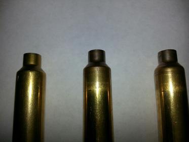

I've had some of my initial fire form loads not have crisp shoulders here are 3 all shot with same load where one case has the rounded corners. Follow-on shooting squares off the shoulder.
28.5g Varget CCI400 primer and 105 berger hybrids

I load EVERYTHING at mag length. I have no interest in single loading. Unfortunately the chamber is not throated for mag length. I have a significant jump and there is a big difference between the two bullets I've used. The Nosler 105gr can't hold the same sub-1/2" group that the Berger Hybrids do so I'm assuming that's due to the Hybrids flexibility with the jump. I had stated that the Bergers could touch the lands at mag length early in the thread but I screwed up the measurement some how and that's not the case. The current jump to the lands of my load is 0.094" which is actually father than the Noslers that I had loaded but the Noslers didn't do as well. My current load COL is an average of 2.287" The mags measure just over 2.30 but that's not consistent between mags and if I let the average COL drift out much longer than 2.287" I end up with some meplats that are longer than others and they drag on the front of the mag. At this average I think my longest bullets are right at 2.294" and fit without issue. Lee made the suggestion to cut out the front of the mags to get more length which may be needed if I have the need to chase the lands. I might also be able to bend out of the front section of the mag some if I can do it in a clean way without breaking the welds. I've got the 20 round .223 body mags and I'm only using 11 rounds in them so cutting out the front of the top half of the mags might work since that area is supported by the lower receiver, but I might end up with a mag that blows all my ammo out all over the place if I drop it and that's not gonna work.
It sounds like the chamber is throated to so that when the Berger 105s are touching the lands, COAL is right at max mag length.
Sorry for the confusing info early on. I'll go back and edit that post at some point. See my reply above. Thanks!
I wonder if you might do me a favor. Im going to build myself a FatRat when I get home and am trying to figure out my reamer specs and free bore. Could I ask you to take a base to ogive measurement for me at mag length for the 105 Hybrids? Like you, it does me no good to single load, so I want to keep the lands as close to the chamber as I can for minimal jump at mag length. Thanks in advance.
Here you go...
Berger 6mm 105gr Hybrid - Lot 5496
Lapua 6.5 Grendel case necked down to 6mm - Lot PH6020
COL - 2.285"
Base to Ogive with Hornady Bullet Comparator Inset 3-24 - 1.692"
What you will notice in my COL is that its much shorter than mag length. I've measured several mags and most measure 2.30 - 2.31 OAL just below the feed lips. But there are inconsistencies in the pinch weld that really make that unreliable as you load the mag. When I loaded out to a max of 2.30 I ended up being able to only load about 5 rounds before one of the bullets would drag. So I bumped them back to a MAX of 2.294 which gives me enough clearance that none of the rounds hang. The 3 rounds I pulled out of the box to measure were 2.285, 2.286 and 2.288 in COL the base to ogive of those three I measured were all within 0.001" of each other with the one I quoted above being in the middle. If I went through long enough and checked more I would find the ones that are 2.294 due to the inconstancy in the meplat. So while you could load longer you'll end up with mag issue. If anyone has advice on how to uniform the front of the mags so I can load out to 2.230 let me know.
My next purchase before i load the next batch on formed brass will be a bullet pointing and trimming system. This will totally uniform the meplats and resolve some of the inconsistency issue and allow the seating to be about 0.005" = 0.010" longer in theory.
If you want them measured with a different insert or need any other information please let me know. Also please pass along all the specs on the reamer and were we can order one "off the shelf" if we all so desired please.
