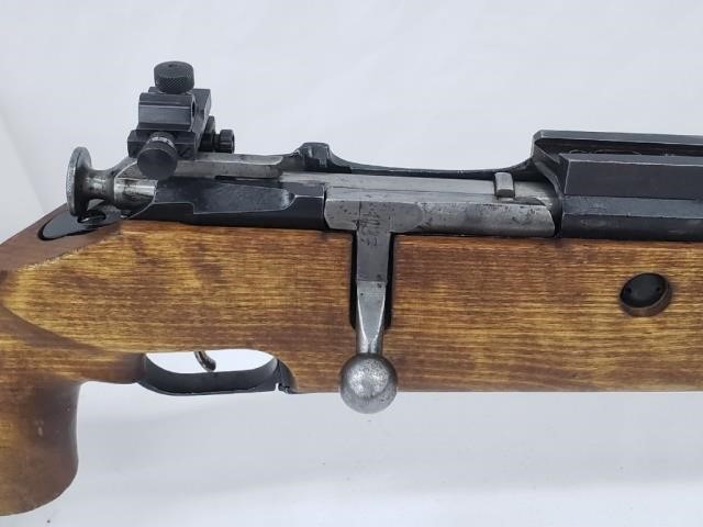

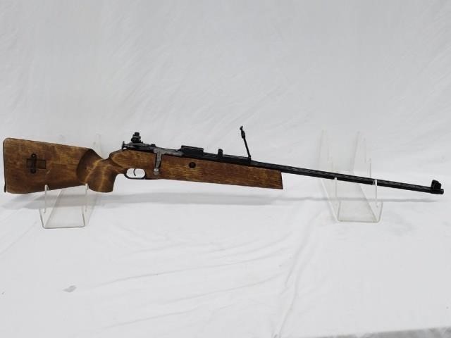

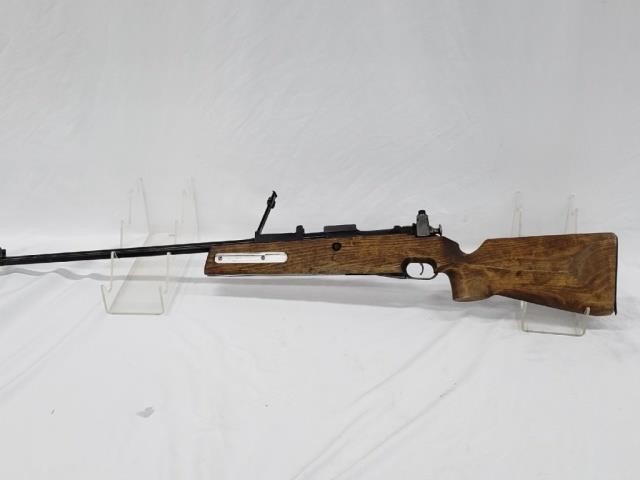

I haven't seen many of these lately and grabbed it at auction when I saw this one.
Only have the auction pics now
My local shop got a couple in a while ago.
Inspect the wrist area good and check it for cracks.
I was told they are great guns but the weakness was the area at the pistol grip wrist was prone to cracking.
Reactions: Calfed
Yours has the scope mount base on it (lots were removed), so now go find the correct scope and mount then you have a really uncommon bird. Mine shoots 1 MOA with the scope. I have not replaced the diopters to test it on that regard.
Reactions: Calfed
First, determine if it is 7.62x54R or 7.62x53R - because it can be either. My wife and I still own a pair - both are single stack diopters, no scope bases and are x54R and shoot best with D166 (.3095) bullets.
In short, slug or better do a chamber cast of your rifle to make sure you are using correct brass (53.5 for x53R and over 53.70= 54R) and if you have a .308 bore or .311 bore...
You will LOVE IT and congratulations. Between damaged in shipping and broken from Finland and “for parts”- estimate is that there are less than 640 complete intact of these outside of Finland or in United States - rare bird in my book.
Reactions: Calfed

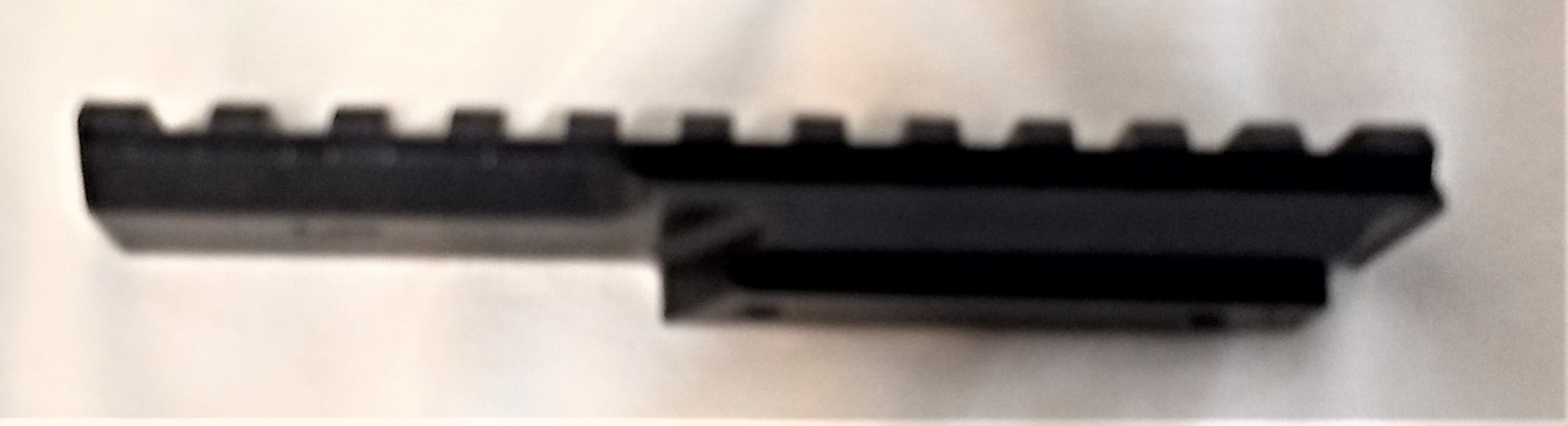

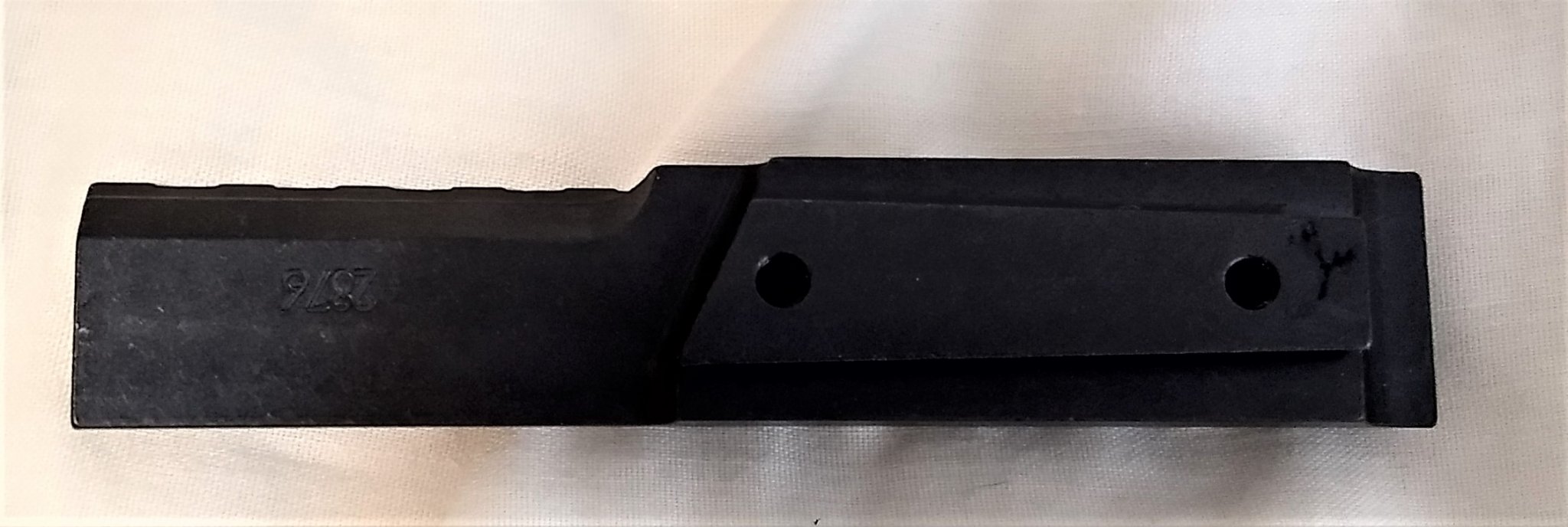

I haven't had any luck finding the correct scope mount for this, but did find one made by S&K scope mounts. It has a dovetail that slides into the base and locks down with set screws. it has a Picatiiny rail on top of the dovetail.
I can not find a correct mount, but did find that S&K makes a mount for the 28/76. It arrived about the same time as the 28/76 got to my dealer

I just picked done of these up from a member on here. picked it up at my FFL yesterday. Not in as good of condition as yours but still nice. Mine needed to have an arsenal stock repair re-glued into the stock as well as need some other cracks repaired. Mine is also missing the front sight globe and rear sight aperture (if anyone has these parts, please PM me!). Im looking at picking up a s&k mount for mine as well. Once you get yours on, please let me know how it works out.

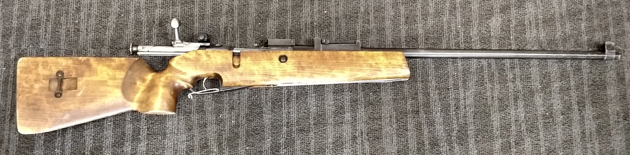

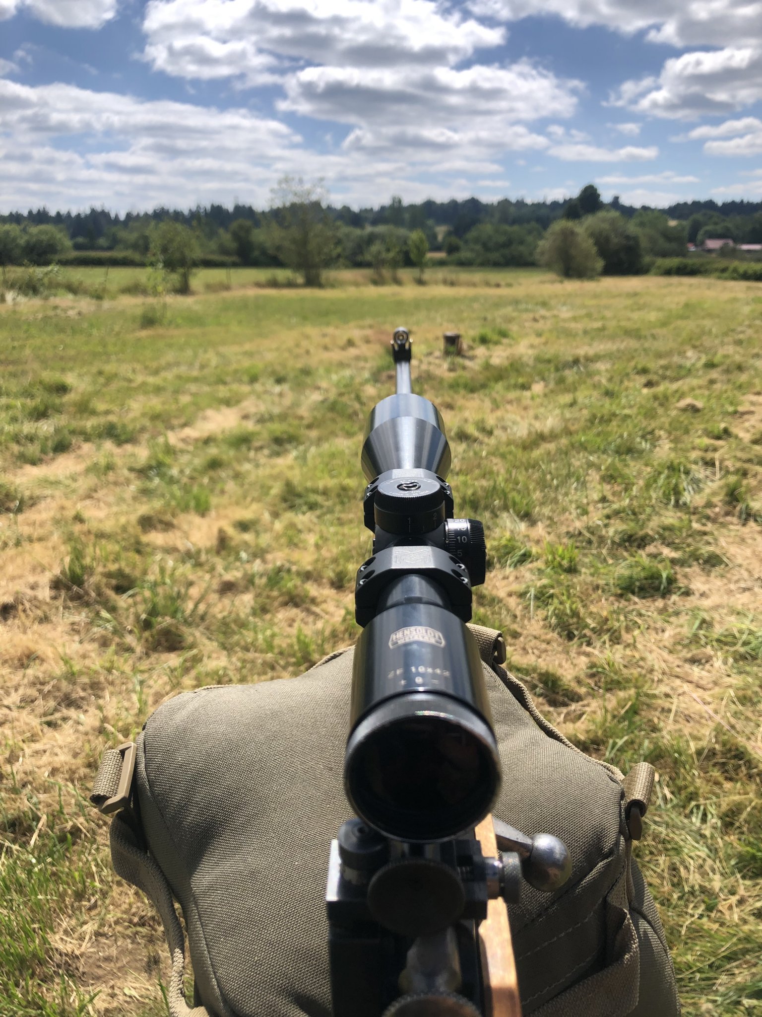

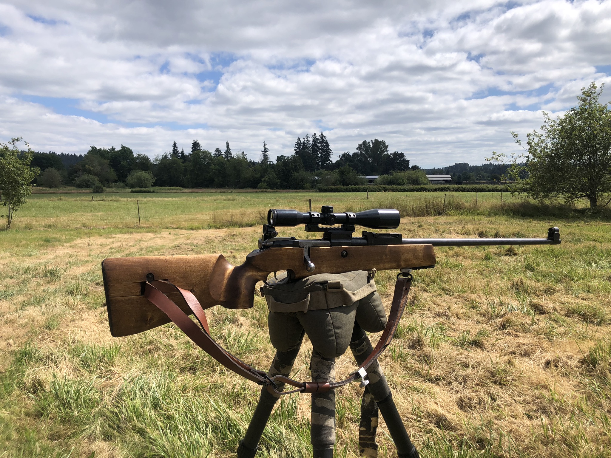

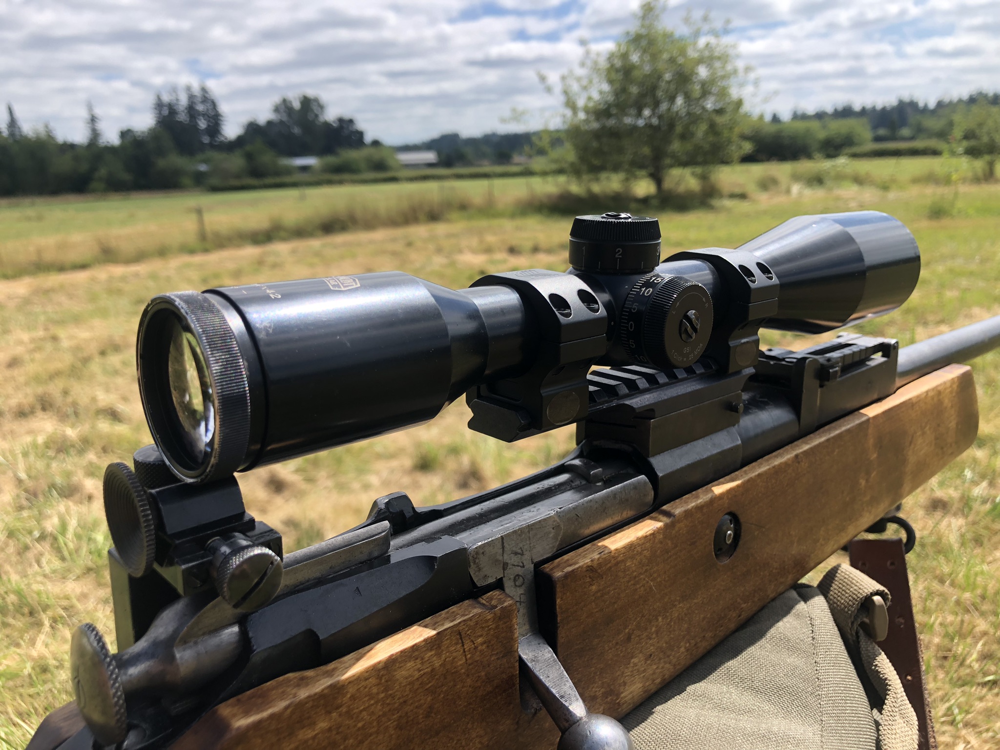

This is my 28-76 now after several years. I bought the rifle from JWsubmoa several years ago. I repaired the stock, epoxy bedded it with the arsenal shims in place, found the correct rear sight aperture and front globe sight and inserts. I am still missing the threaded locking ring for the front sight inserts but what I did was drill and tap a small hole at the rear of the globe and I use the head of a small screw to hold in the inserts. I could not find the correct scope and mount so I went with the s&b mount and a hensold zf 800 scope. I slugged the chamber and it’s a .310-.311 bore. I made some hand loads with S&B brass and Sierra 174gr matchkings that shoots 3/4 MOA regularly.
