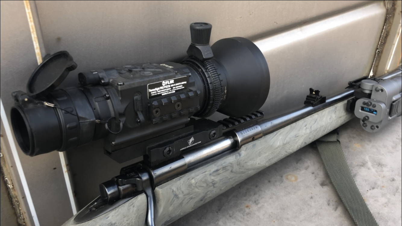

So the Triji BAE Core is 640 x 480 and the PTS 736 is running a Boson 320 x 256. I have a friend that has the Triji Hunter 60 mm big bad boy and I can also report that the PTS 736 shows more detail at longer distance.
BLM for the win. BIG LENS MATTERS. :LOL:
If I have to do the long range thang, here is what I do it with. Put the thing on the thing and pull the dam thing.
Flat shooting 270 Win with PTS 736.
