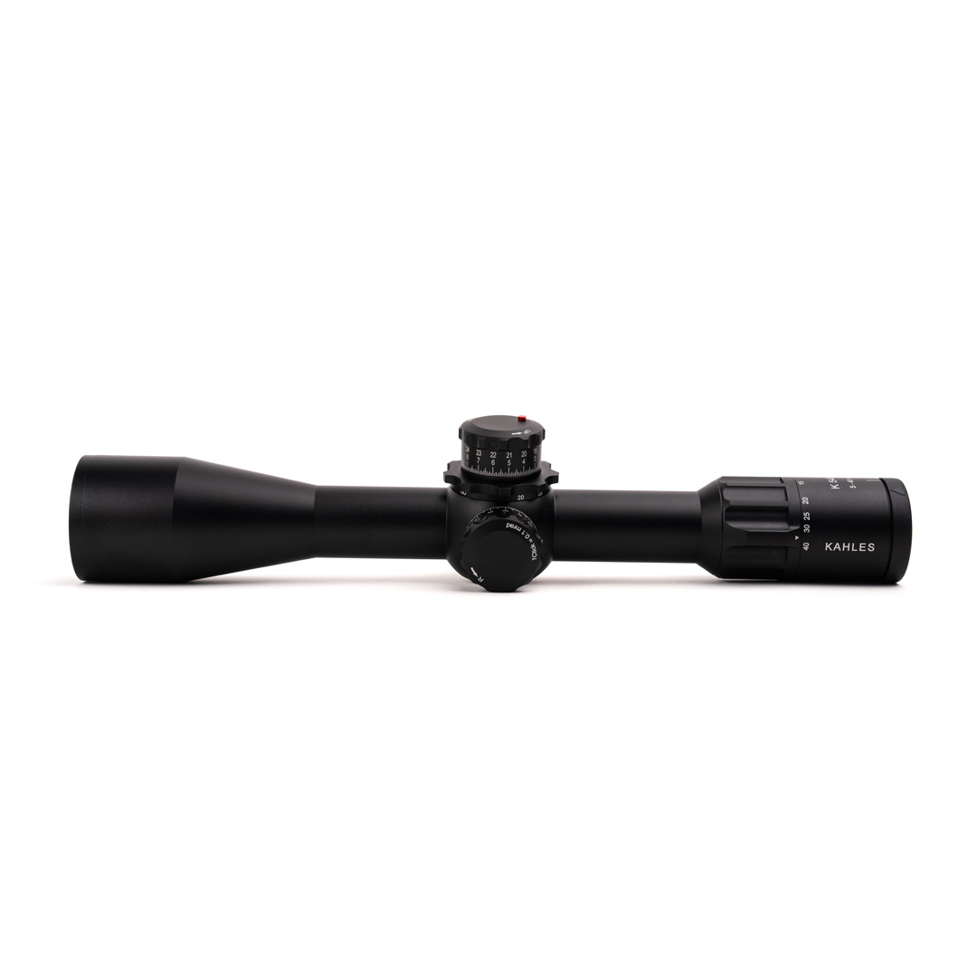

    Update 02/12/25: We have a few more shipping in that are available! Kahles K540i 5-40x56 DLR CCW SKMR4+ w-left Windage https://cstactical.com/kahles-k540i-5-40x56-dlr-ccw-skmr4-10721/
    01/13/25: We have a handful of Kahles K540i DLR CCW 5-40x56 SKMR4+ LSW KLS-10721 ($4,599.00) shipping in! They are not on our site so PM, call us at 916-628-3490 or email [email protected] to grab one
    Information is limited, but here’s a sneak peak…
    MAP is $4,599.00

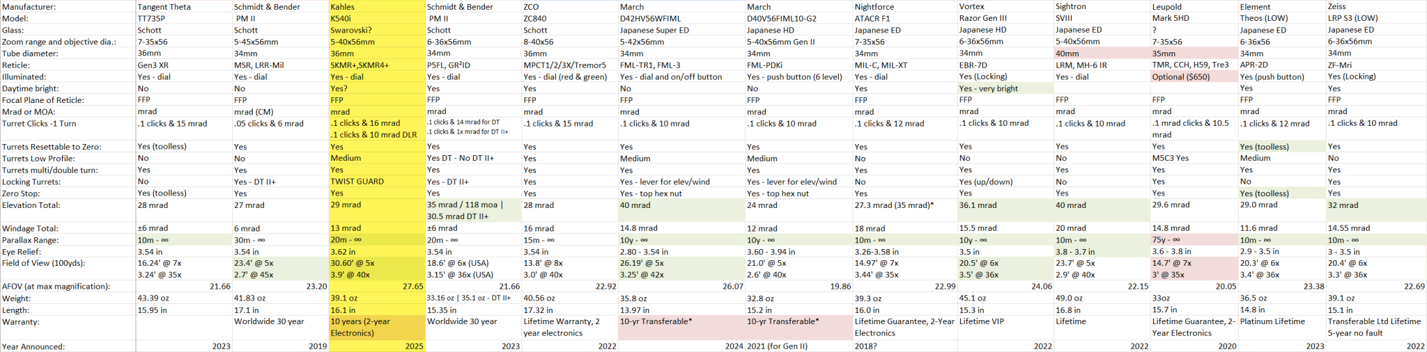

    I threw the specs into my spreadsheet and this is how the Kahles stacks up spec wise to other scopes with >30x at the top end. (My AFOV numbers come from using the top magnification FOV value as provided from the manufacturer, keep in mind some mfr numbers are not always correct.)
    * Let me know if you see anything incorrect in the above specs.

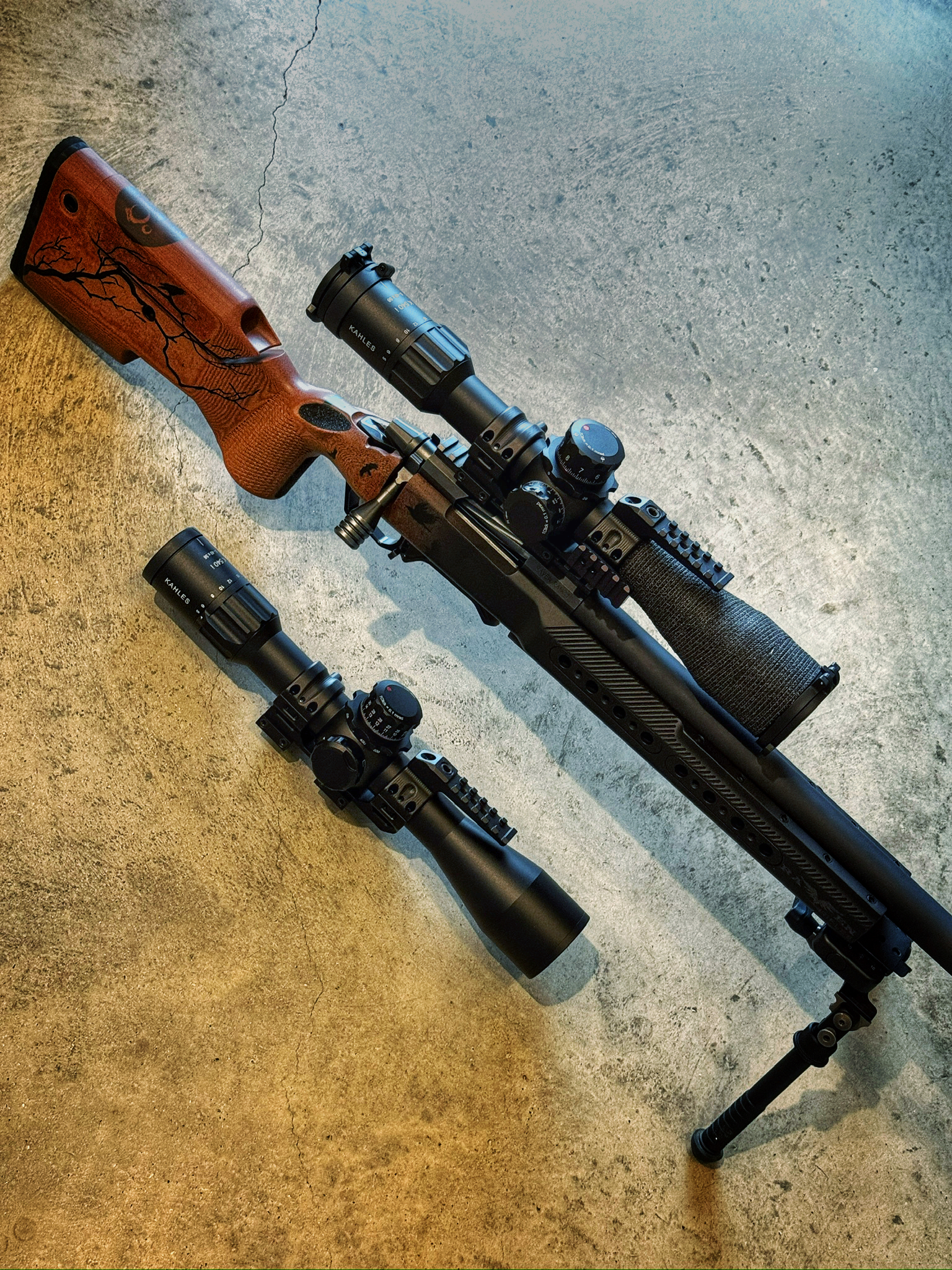

    I have a Kahles K540i DLR since about 2 months. I think I was the only international reviewer to get it in advance, but I could be wrong.
    I have all the options with it, and took plenty of photos so that potential buyers can get an idea before ordering.
    I think the throw lever is a must, unless you’re going to use it at a fixed magni all the time.
    Tell me, do the European K540i's have even wider FOV than US version... (I am totally kidding here o_O:ROFLMAO:)
    Why do you say that, is the mag ring super stiff? Were you testing this at -50° in Norway???
    Here is my review:
    Really enjoyed your article, writing style, humor and honest information and feedback!
