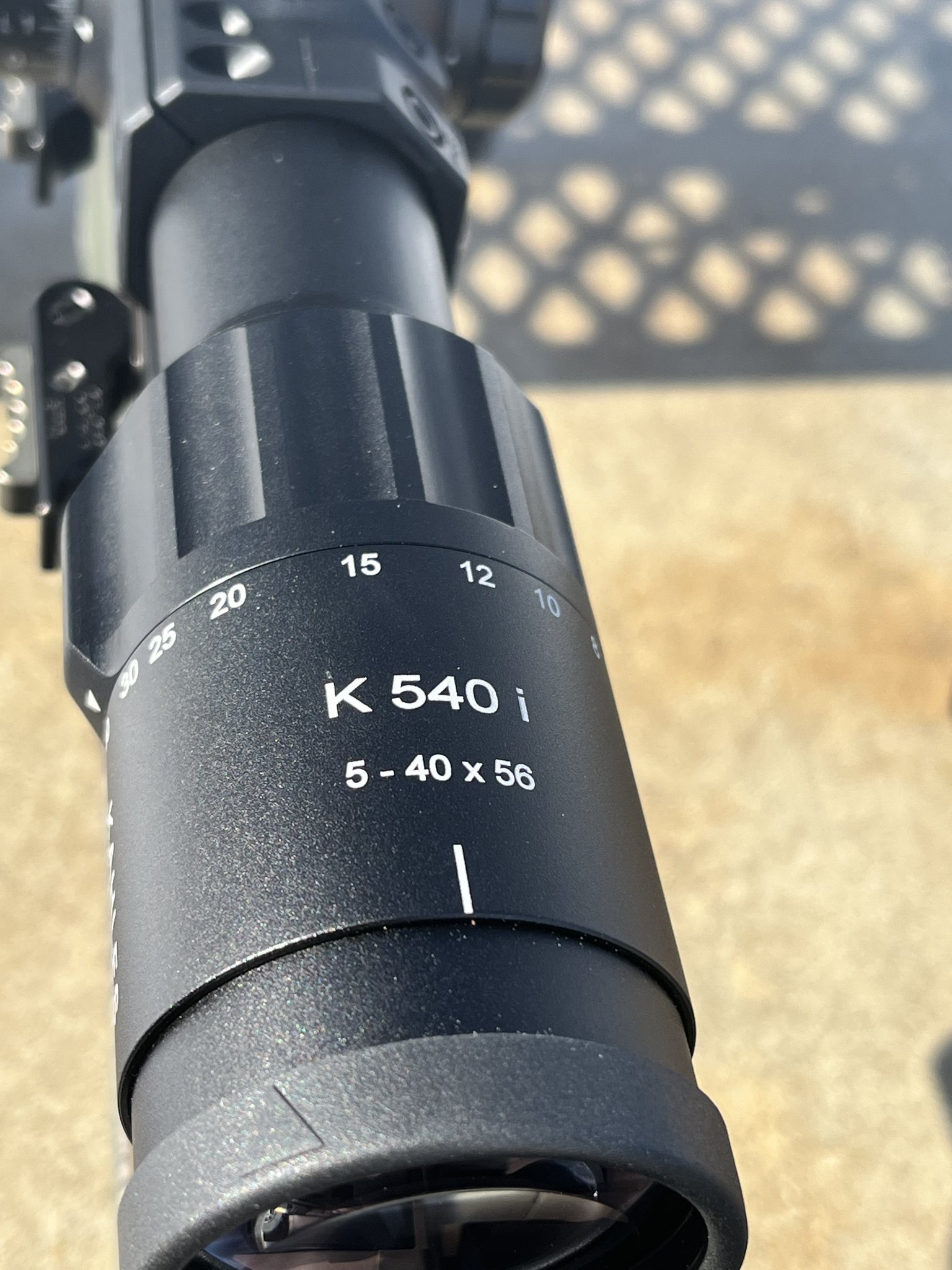

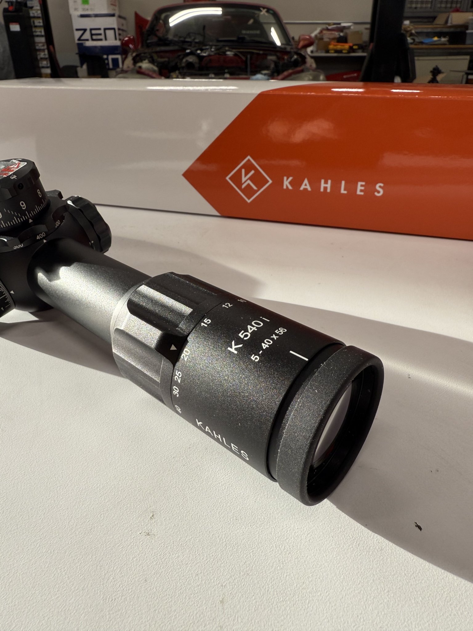

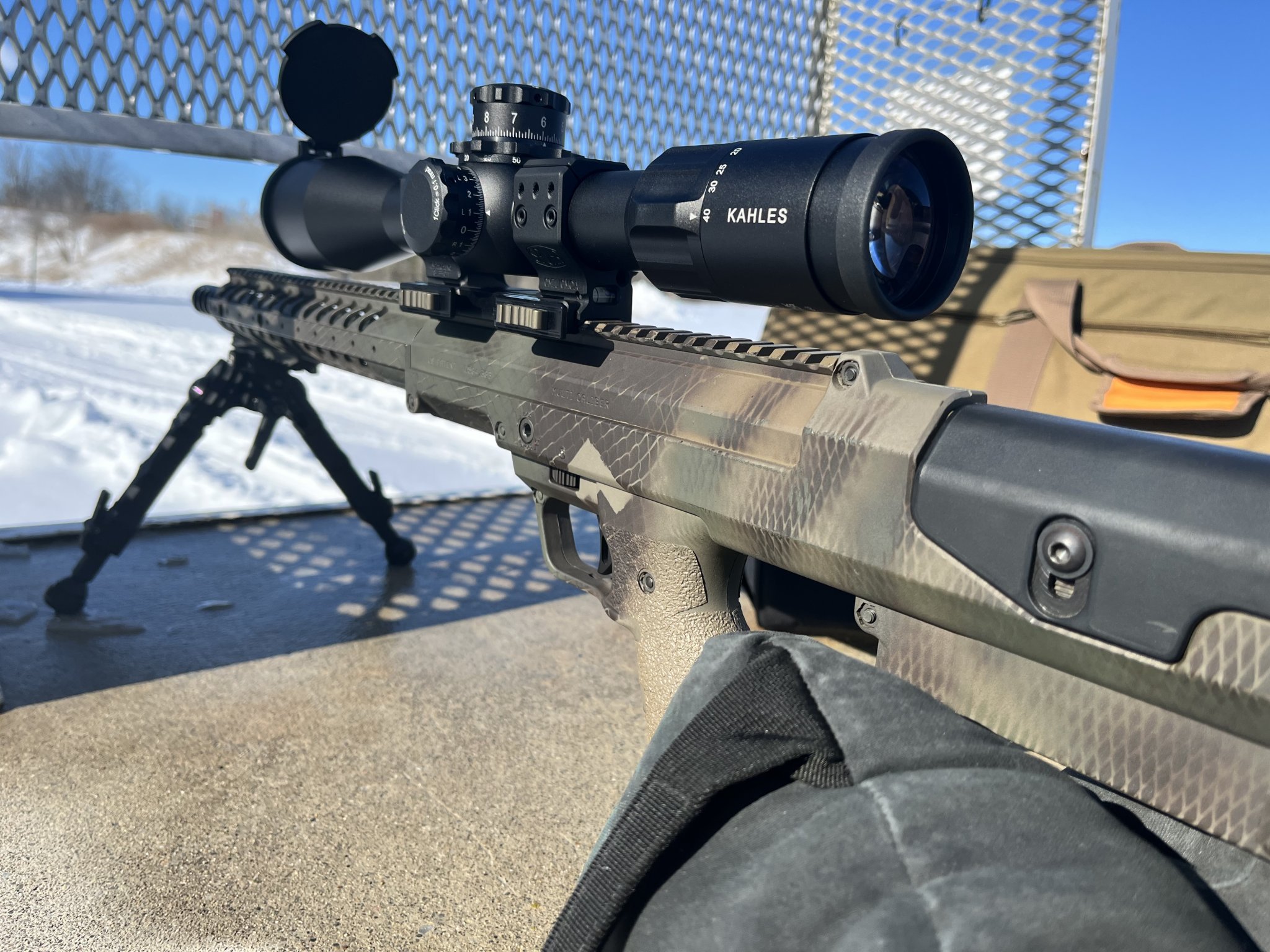

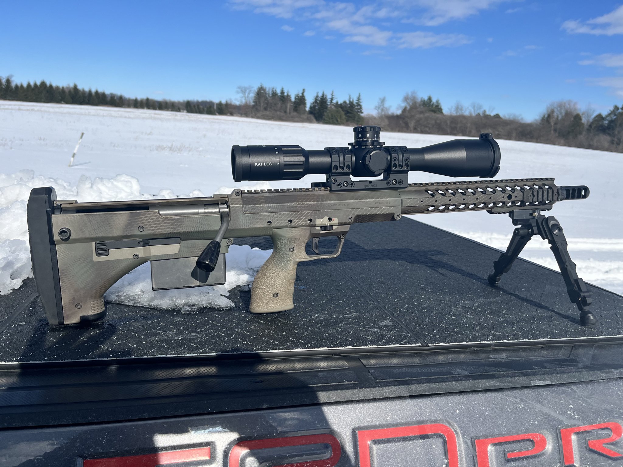

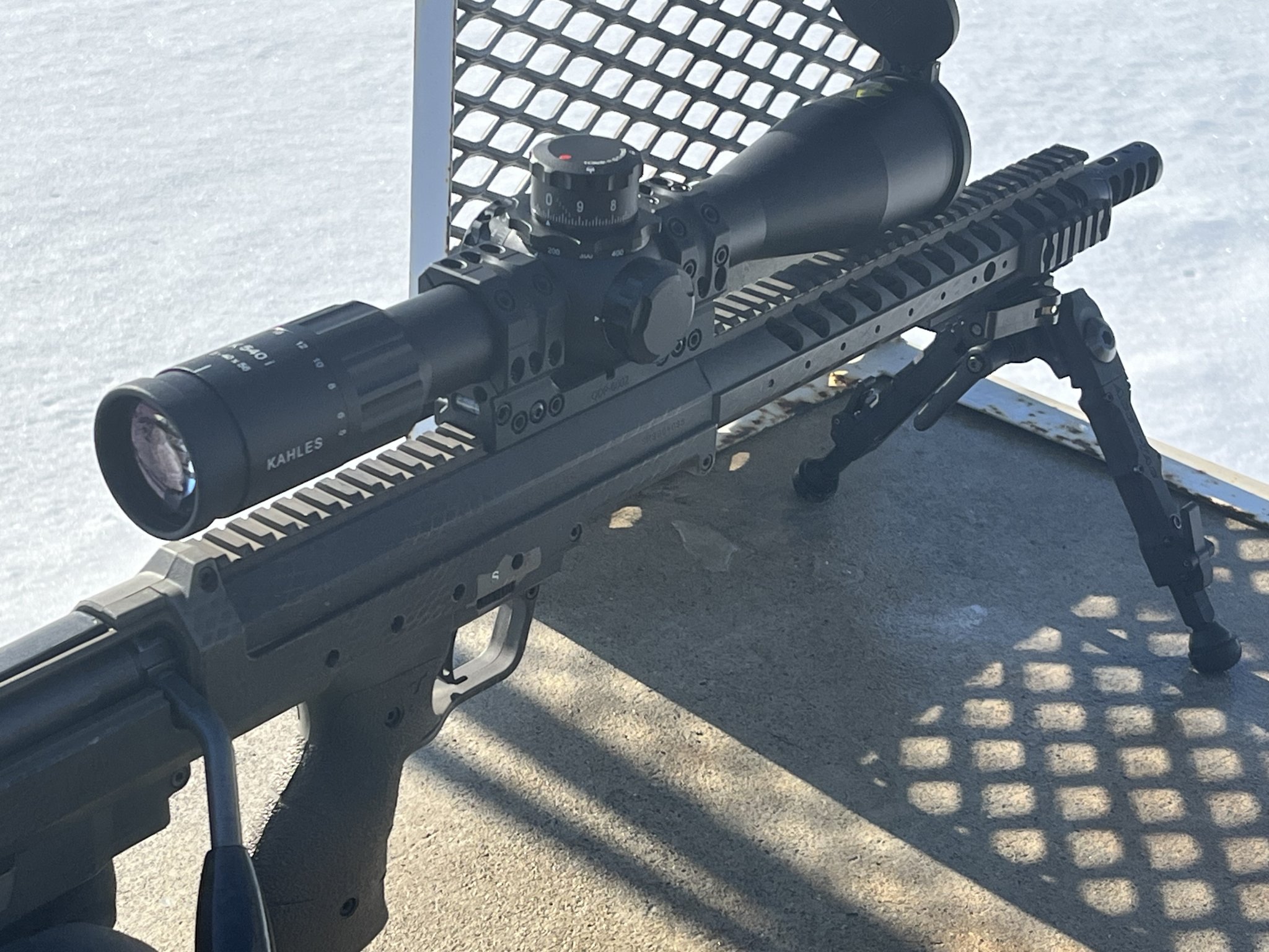

I just received mine yesterday. I will take her out to the range this weekend and report back with first impressions.

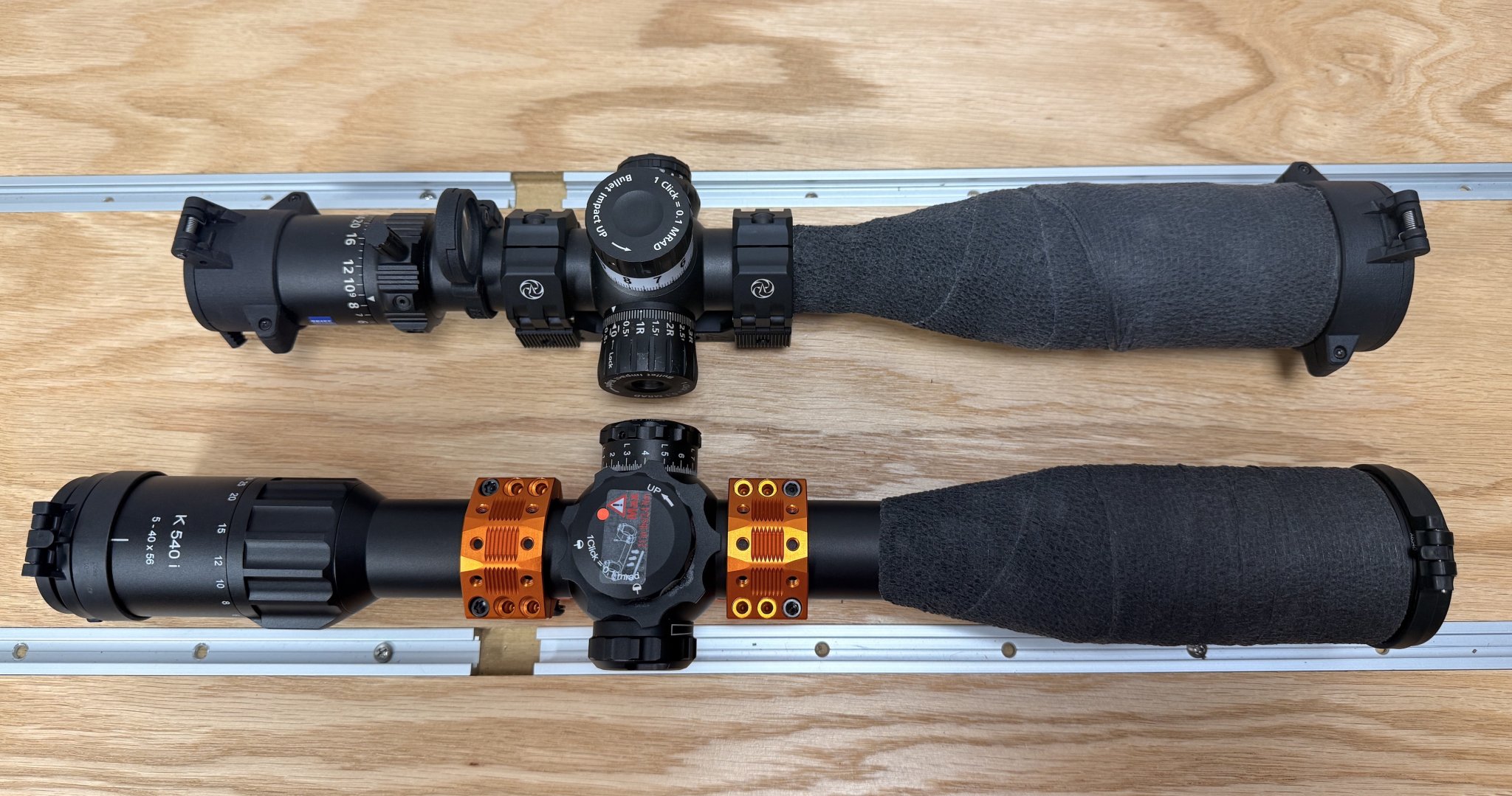

For size comparison, this is next to the Zeiss S3 6-36, previously mounted on the Vudoo. Both scopes have OEM Sunshades.

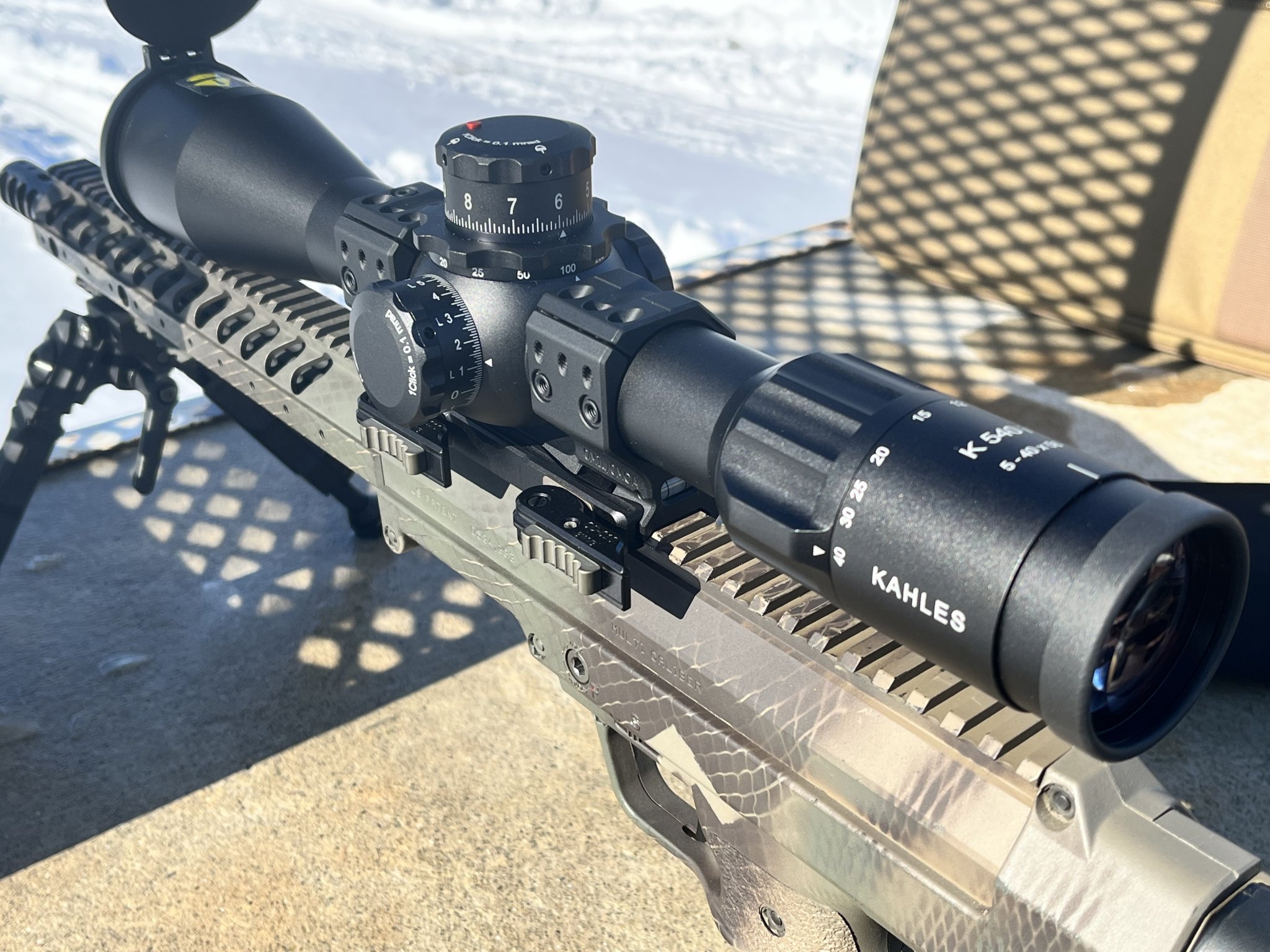

This is the scope mounted and bore-sighted on the Vudoo. I am using a 30 moa rail and a 20 moa Grayops mount. I get about 25.5 mils of elevation from 50-yard zero in that configuration.

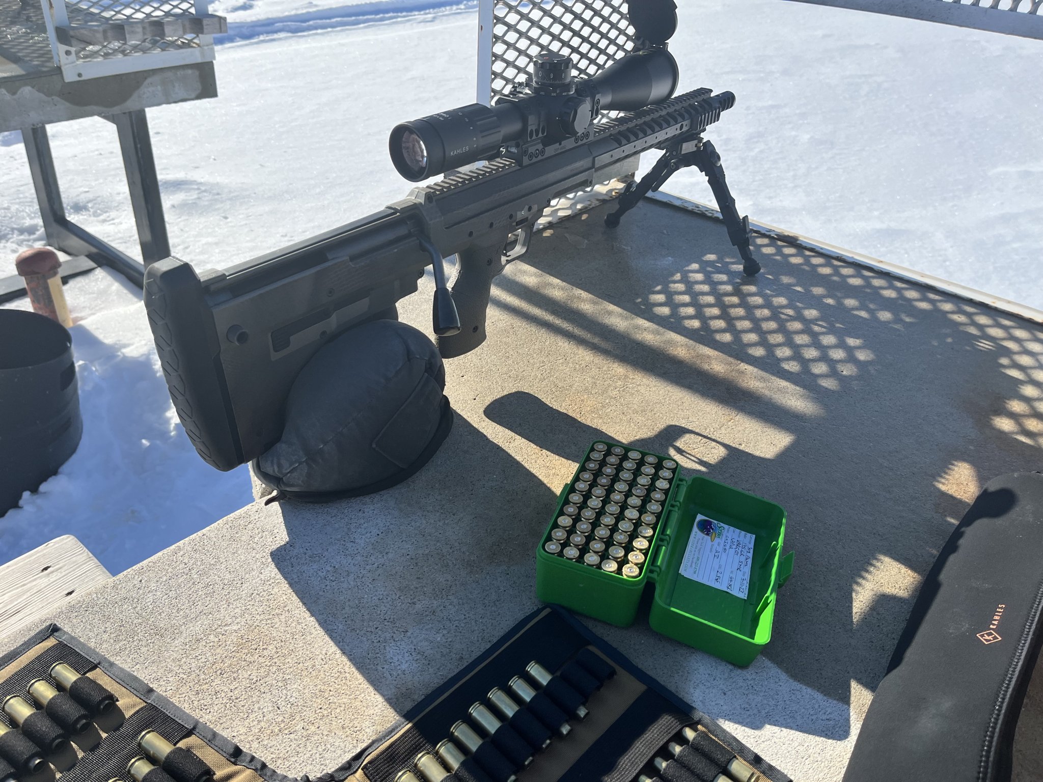

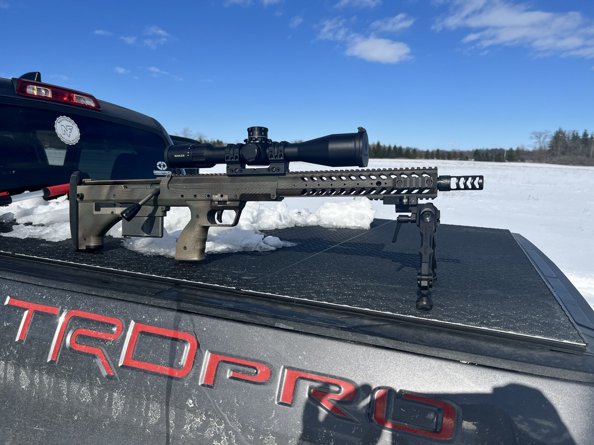

I tested the Kahles K540i at a distance of 500 yards using my Vudoo rifle.
The field of view is fantastic. I will be shooting this optic at magnifications between 20x and 30x during a competition. The clarity remains excellent throughout the entire magnification range.
However, I did notice a couple of things. There is a small area at the edge of the glass where distortion occurs, which I would describe as a "fisheye" effect. This is not noticeable unless you are specifically looking for it. Additionally, the parallax is less forgiving compared to the ZCO.
Reactions: Islas82
At what magnification does that distortion occur?
The distortion is visible throughout the entire magnification range. It is a tiny area around the outer circumference, maybe 1/64th of an inch wide.
Using the reticle as a reference, does that translate into the thickness of the reticle? 1/10 of a mil? 1/64” is .015” so I don’t see how anyone would perceive a fisheye effect in that small amount of real estate.
This was also present in a k328i I had. Kahles needs to put in a field stop to hide that portion of the lens as the distortion is distracting and not really useful optic real estate.
