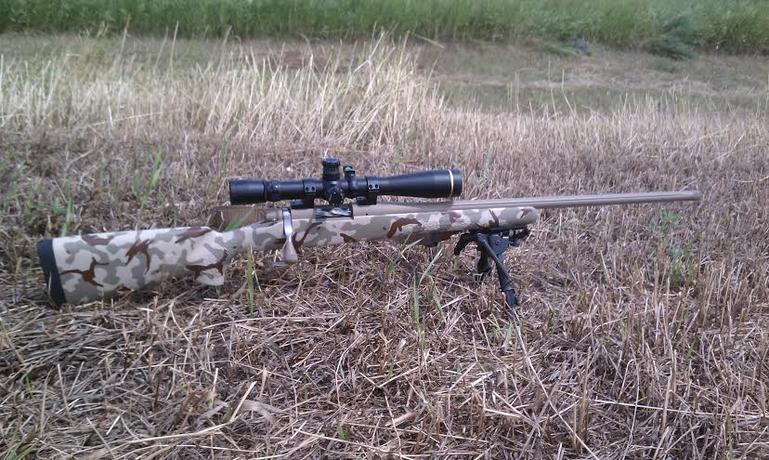

Here is one we produced at GAP:
This has been test fired only once for function. It is RB/LP/LE on a Templar Long Action single shot with a Jewell trigger. The barrel is 28" plus the brake although there is just a thread protector currently to allow the new owner the choice.
Regards.
Quickoz,
Regards.

That's definitely nice looking! How much did it sell for?
Actually it's still for sale. I posted it on another site which caters to this type of rifle and got a lot of attention. I have the complete listing saved to my desktop and I'll post it here in the classified if that will answer some questions or garner a buyer. I'm away from that computer right now but I'll get back to it Tuesday so I can post it then. I'll also get Ken to post it on our website.
It's light enough to be able to add a significantly heavy scope and rings combinations without compromising the weight rules for F-Class.
