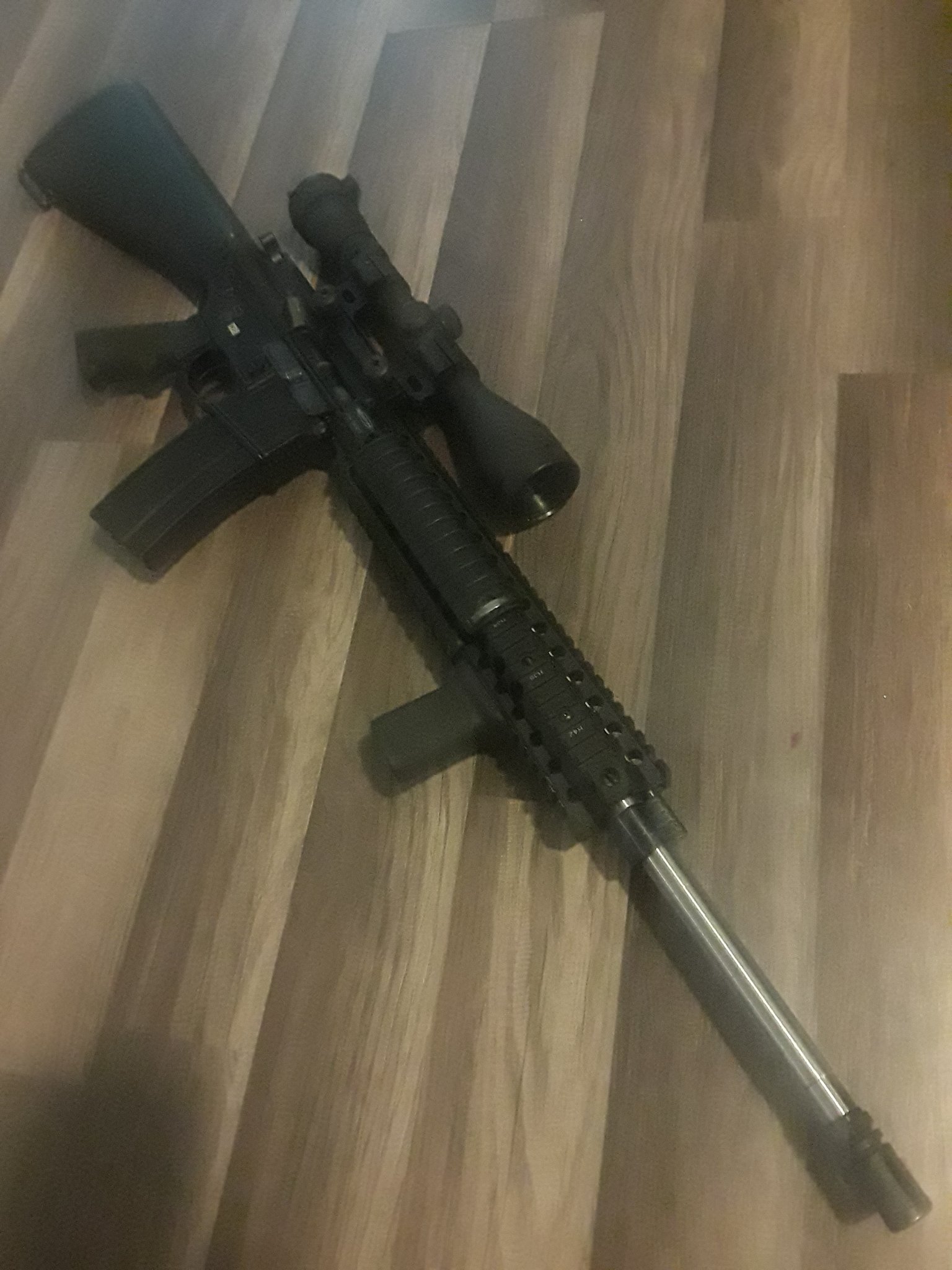

Basically boils down to handling. The 24" did shoot good with 88eld and 77smk. Barnes 69gr match burners did really good too. But it was too unwieldy and heavy for what I use it for. So I went down to a 20", standard profile barrel. It's also a 1:6.5 twist, which is handling the 90smk and Fusion 90gr factory ammo great so far. I'm still breaking it in though, but it shoots great so far. The scope is just an old 2-10x hunting scope.
Pardon the crappy cell phone pic. This set up is perfect for coyote hunting and if I want I can throw on a bipod and it punches paper just fine. It just handles much better than the heavy 24" barrel, it was a bit of a pig. Would have been fine for a dedicated bench/match rifle though.
