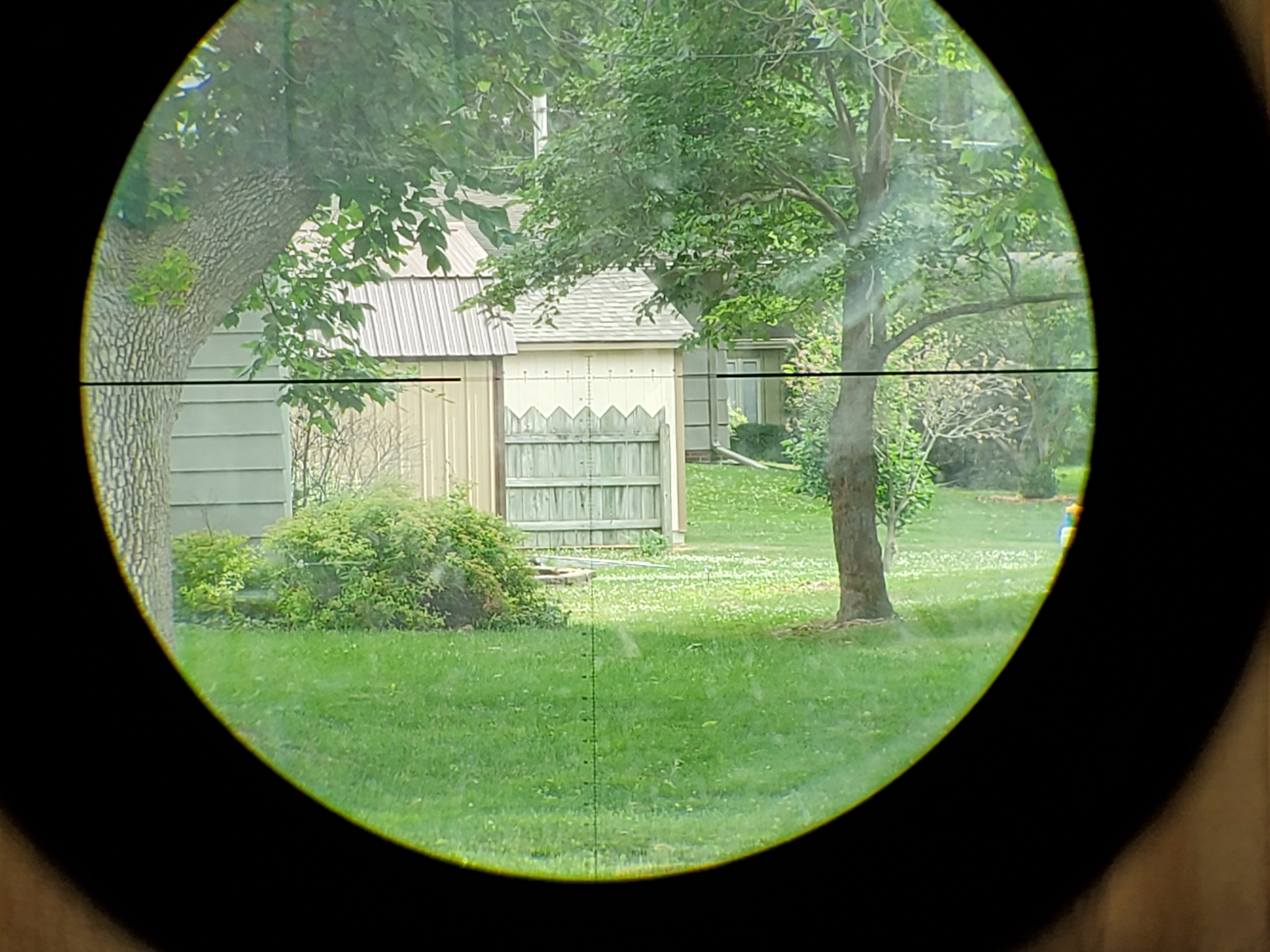

To address a long post above: the reticle is very unlikely to be blurry on low power. The blurriness you see is an artefact of taking a picture through the scope.

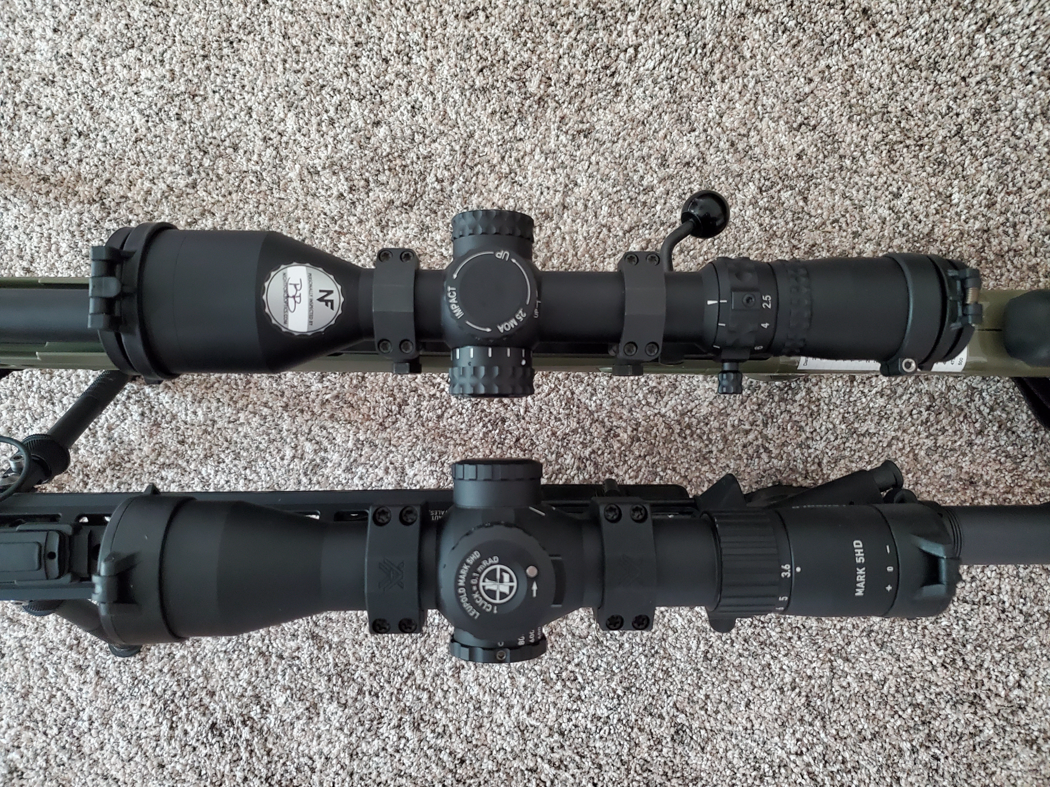

Currently have both sitting in front of me, what would you like to know?Has anybody had an opportunity to compare the 2.5-20 side by side to a Leupold MK5HD 3-18? Really considering the 2.5-20 for a crossover optic.

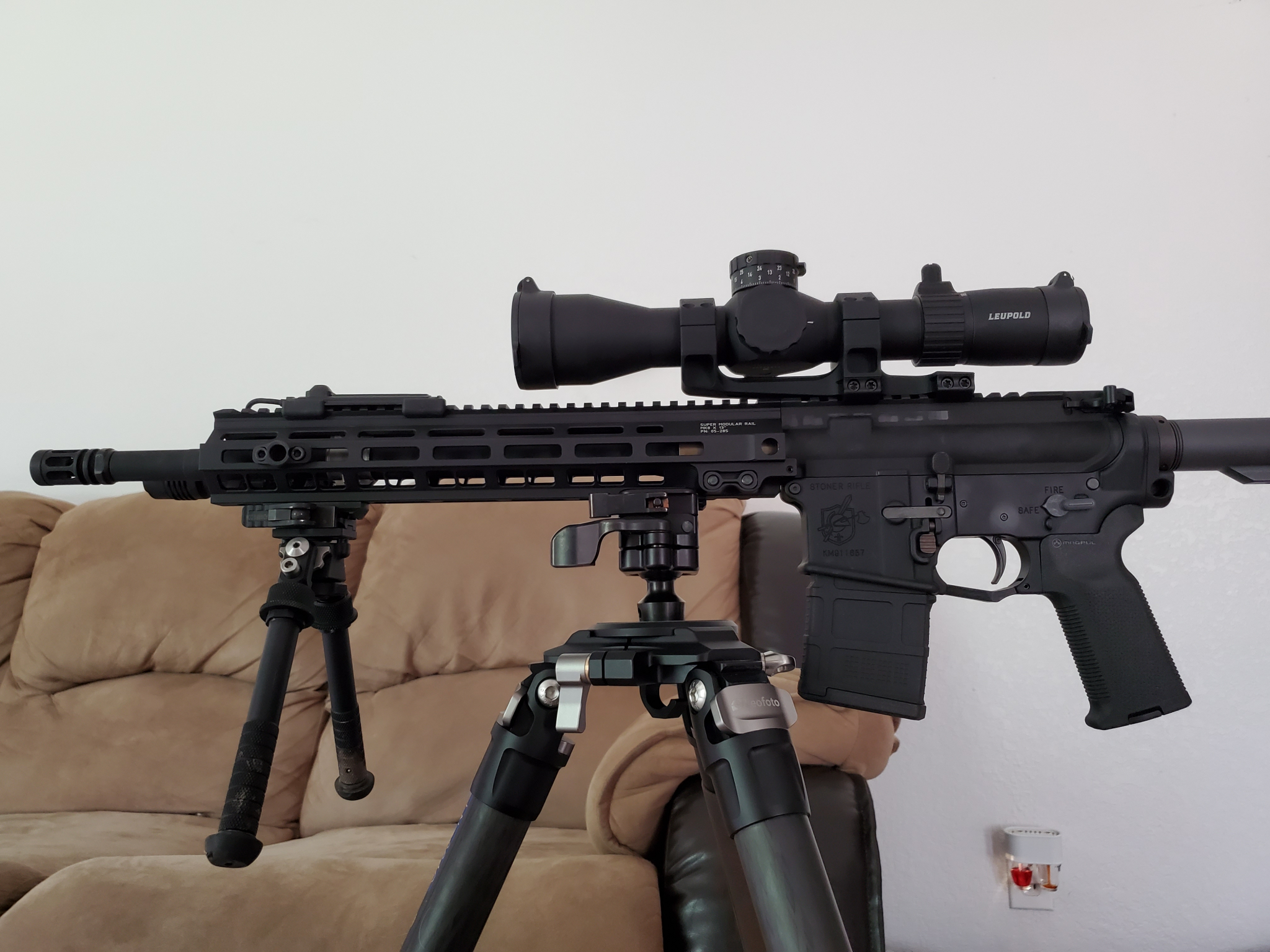

Thank you Vegas. I'm looking hard at this NF for a recently acquired Colt CLT CM6518S.I spent quite a bit of time with mine yesterday. I had it mounted on my KAC LPR. I did a 5X5 with it using Speer 75gr Gold Dots. That’s our duty ammo.
I have spent a couple hundred rounds of time with the scope, and I really like it.
I’ll say the parallax is a bit picky. I just think that’s a by product of an 8X erector in such a short bodied scope. It’s easy to adjust, and brings things in razor sharp, but know it is touchy with parallax.
The scope is so nice, I really struggled with what gun to permanently house it on. I settled on a Aero 6.5CM, as all my KAC’s, and my match rifle (AI) wear ATACR ‘s.
Besides the picky parallax, and as has been mentioned, the somewhat shallow DOF, I find this scope amazing. It’s a FFP US NF. The color, contrast is great. I don’t see any CA. The worst scope I’ve ever seen with CA has been the EoTech Vudu 5-35 US design. It exhibits it badly.
So much that my buddy (a dealer) sent his back to EoTech.
I think this scope shines as a medium to long range semi auto scope. Sure, you could put it on a bolt gun, but I love the short length on a gasser.
That’s where mine is..... for now.

Have you played with it any in low light say dusk and dawn. My buddy has the NX8 4-32 and we got his side by side with my S&B 5-20 Ultra Short to compare. With both set on 20x I felt like there wasn’t much difference in clarity and color maybe just a slight edge to my Ultra Short. But then we took them out again in the evening and waited for what would be well past legal shooting hours and put both scopes on 10x and was looking them at various objects to see how they the compare. To me and my eyes the NX8 Definitely had the upper hand over low light situations compared to my S&B ultra short and at lest the ones I’ve owned have always excelled in this category. I think Nightforce has a sure winner in both these scope. So much so I’m now contemplating selling my Ultra Short and buying 2 of the NX8’s.Nightforce Nx8 2.5-20x50 at the range. Rams at 550 yards on 20x, 10x and 2.5x through cellphone. Going to hookup the phoneskope this weekend.

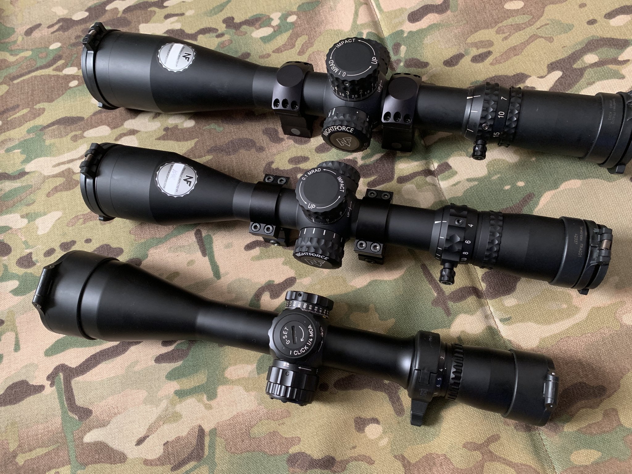

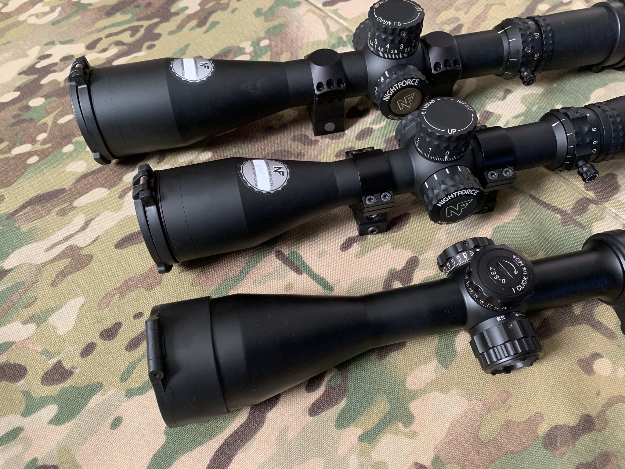

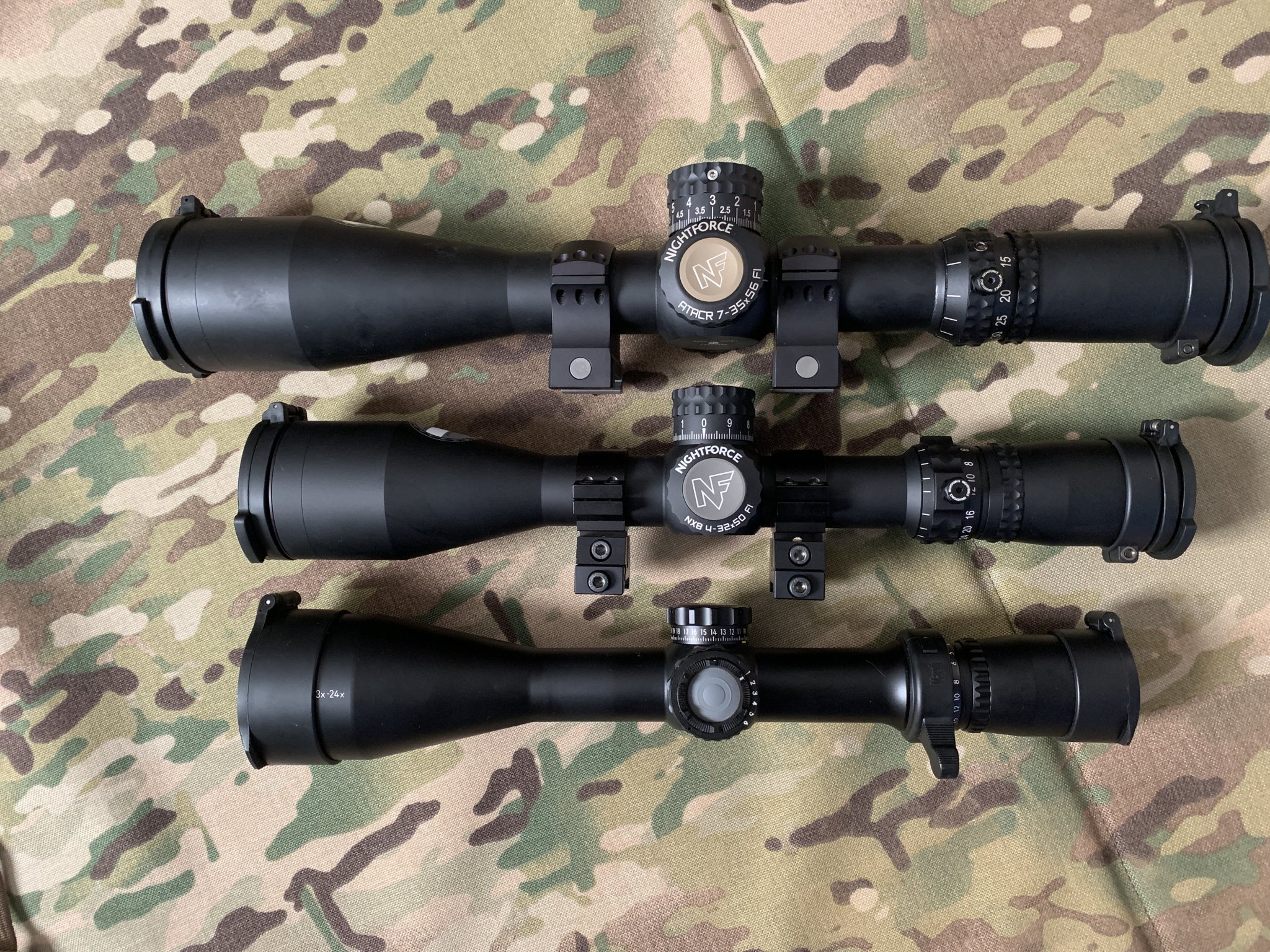

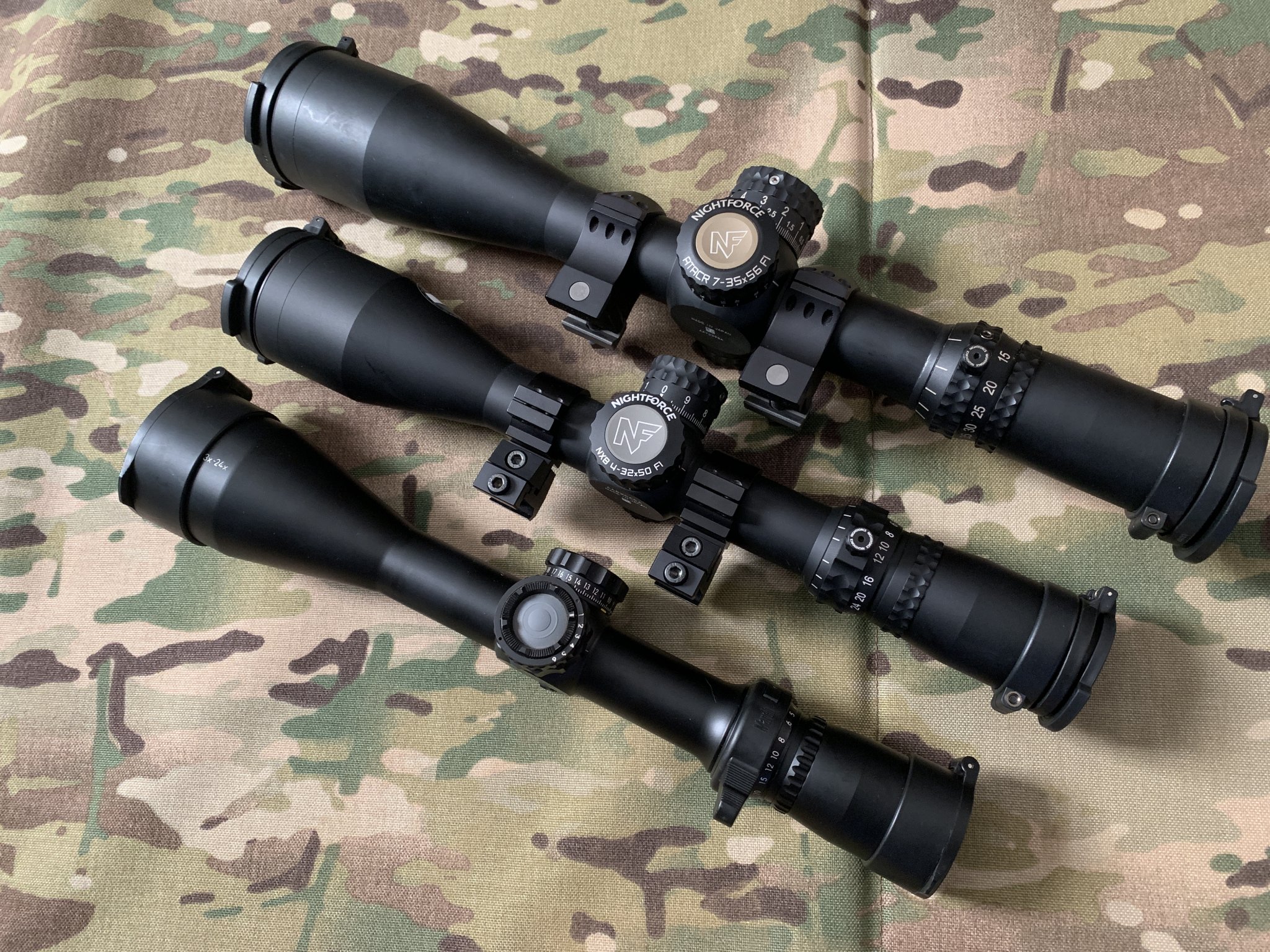

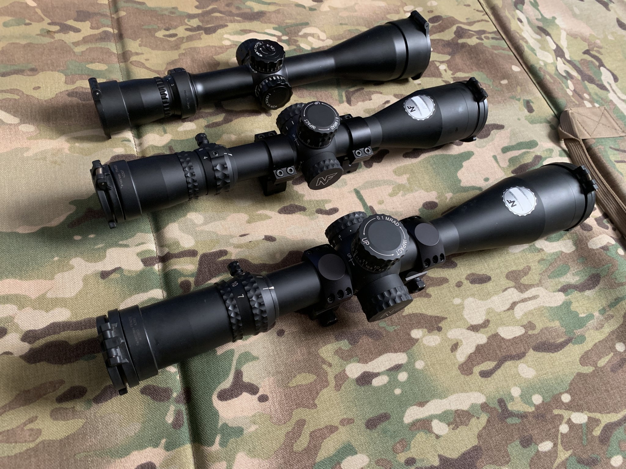

Here's some family photos of my new 4-32 with mom and dad...
i was not expecting the size difference between the twoThats awesome and quite the family you have going there. What are your initial impressions of the NX8 and the ATACR now that you have both?
