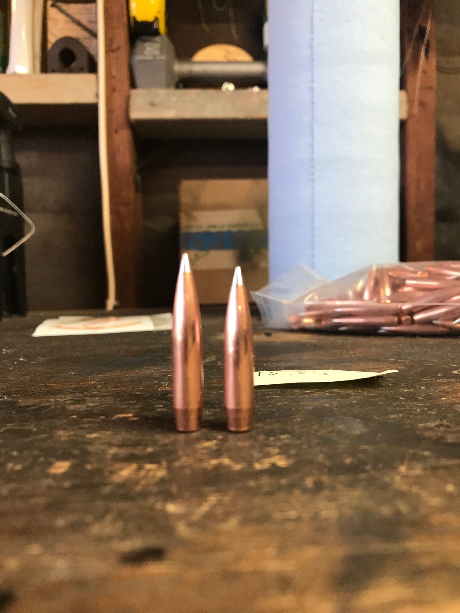

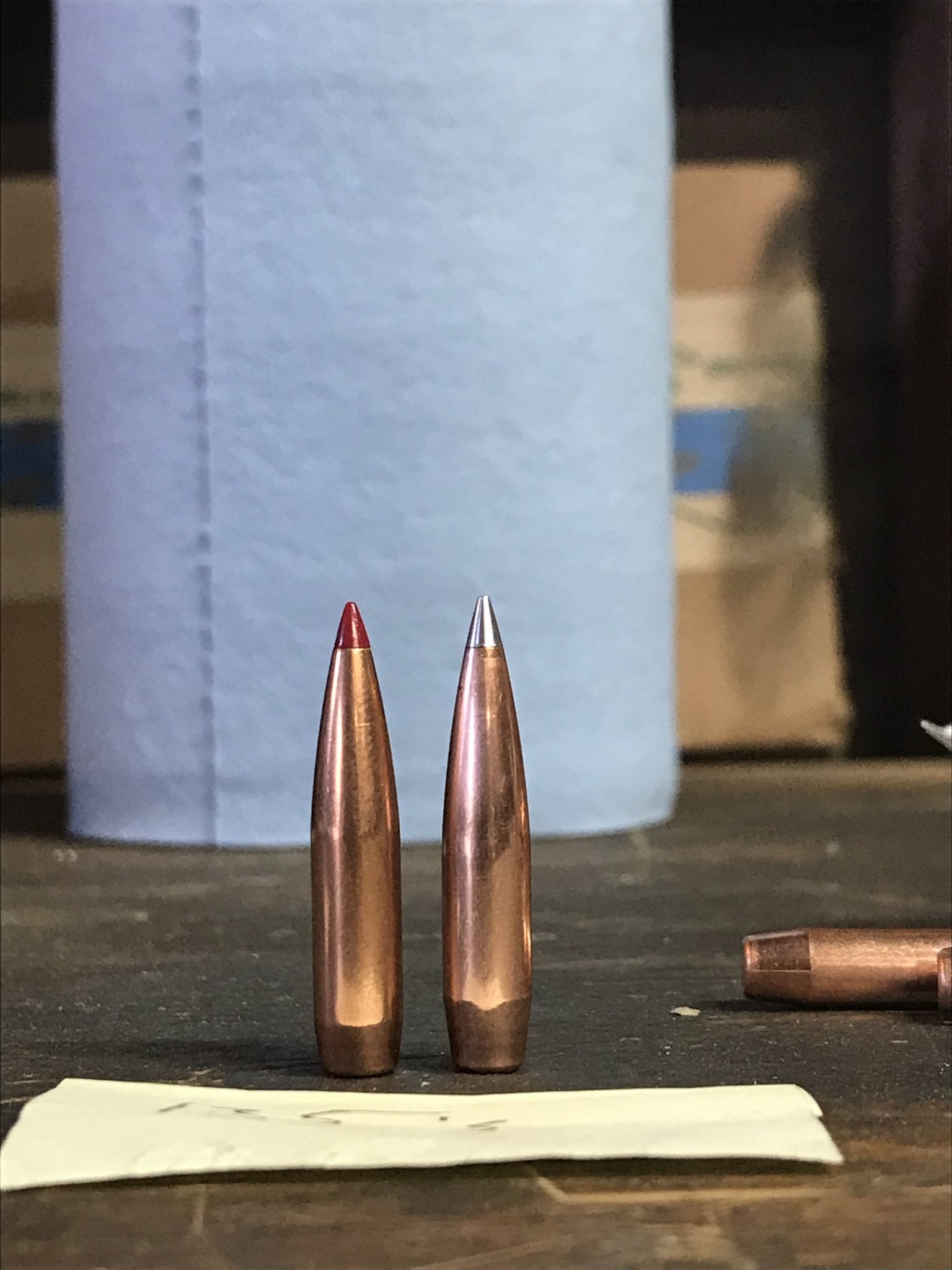

I received some of the 153 and 135 A Tips in 6.5. Here is a pic of the 135 next to a 140 ELD-M. You can see there are some differences int he shape and the length of the bearing surface as well. Mine came direct from the show I believe. They did not come in the new packaging. They were shipped loose in plastic bags.

I have some measurements for you guys also. I just got them yesterday and haven't had a chance to load or shoot them yet. Work is getting in the way of that right now. Hopefully these work well. I measured about 25 of each and they were all exactly the same in the measurements below. I saw maybe .0005" variance but that could be me. All measured with a calibrated Fowler digital caliper.
135
Base to Ogive using a Hornady Comparator
.727
Length
1.384
153
Base To Ogive
.839
Length
1.501
Sorry for the blurry pic. Here is the 153 next to a 135
7070302
135
.727
Length
1.384
153
Base To Ogive
.839
Length
1.501
How do those measurements compare the the 140 ELD in the photo?

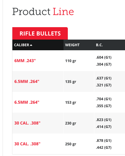

6.5 135gr going 3000fps at a .637 g1 is going really something.. Getting Solids performance with out the terrible frag signature!

With my calipers and Harnady comparator:
140 ELD-M
Base to Ogive .768"
Length 1.375"
I could not find my 147 ELD-M to check the lengths on. I moved recently and my shit is piled up in the garage with some stuff scattered. Once I find them I will add the numbers I have so there is consistency.
So these are marketed toward the ELR crowd right? Many in ELR are using solids, so the A-TIPS would be cheaper than the solids right? So while these might be more expensive than what existing Hornady users are used to paying, they are still cheaper than the solid competition which Hornady is hoping to compete with. Are they just saying the A-TIP has a higher BC and therefore will be better for long range vs the ELD-M?
