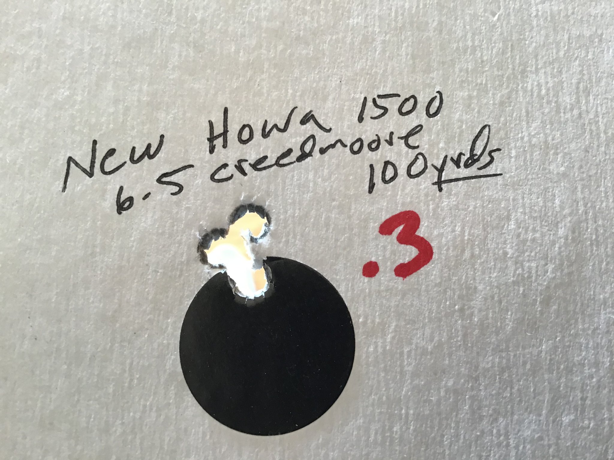

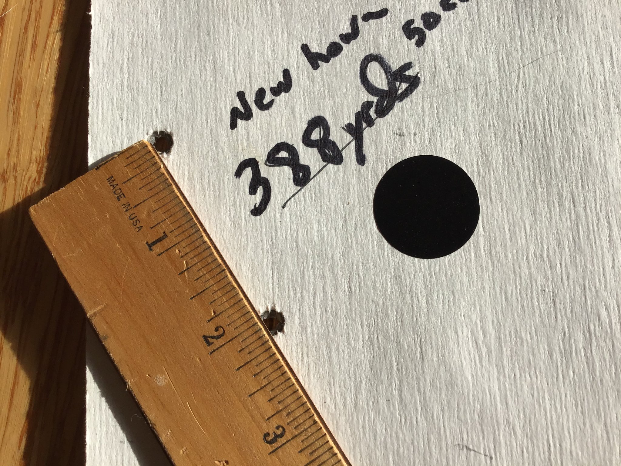

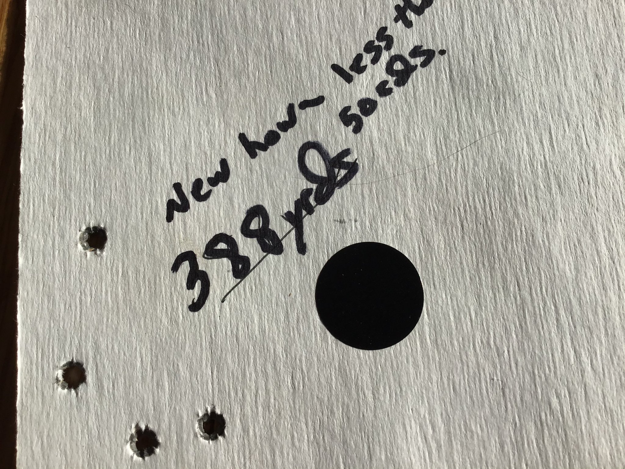

Howa 1500 in 6.5 Creedmoor 24 inch barrel with Hellfire muzzle brake and timney trigger
Atacr 5x26,MPA chassis
loaded a bunch of 140gr eld at 41.5 GR of h4350 just to break in barrel ,sight in and just get a feel for the rifle.
Big thank you out to Subwrx300 for helping out.
The gun shoots Awesome!
The velocity is at 2590 which is ok with the load I’m using, after I get 100rds through it will do load testing expecting load will be around 43grs.
wind was right to left on the 388 yard target.

load testing found node from 42 -42.5 h4350 140gr eld coal 2820
went with 42.2 mv 2760 sd of 9 (around 32 F) for now want to put more rounds down barrel assumping the barrel will speed a bit.
going to try 42.4 later.
