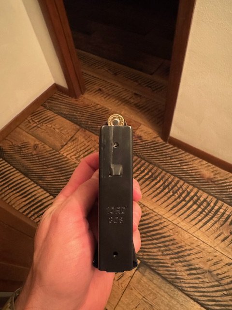

I have the primer about 3/4 or more showing on the back of the mag. Seems like if i go more than that, the rounds will puke out. I figured once i was able to get rounds to feed, all of them would feed since I had the front lips opened slightly, but it seems like that isn't the case. I get about 50-60% success rate. I will add pics of what a loaded mag looks like when i get home. Any insight is appreciated. I have also ordered an AI AICS mag as well as an AW mag to try. No clue if it'll make a bit of difference, but figured it was worth a try.

Here is a few pics of how i have the mag adjusted. I could probably lower the front on the round down a little bit, but not very much. Any more than a few thousandths of width on the front lips and the round will ram the case mouth into the feed ramp.

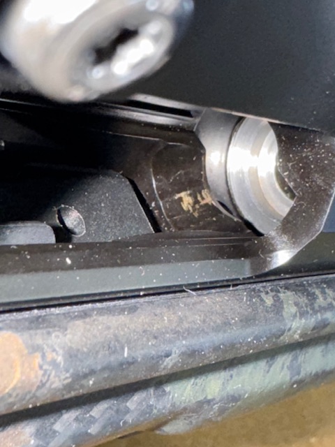

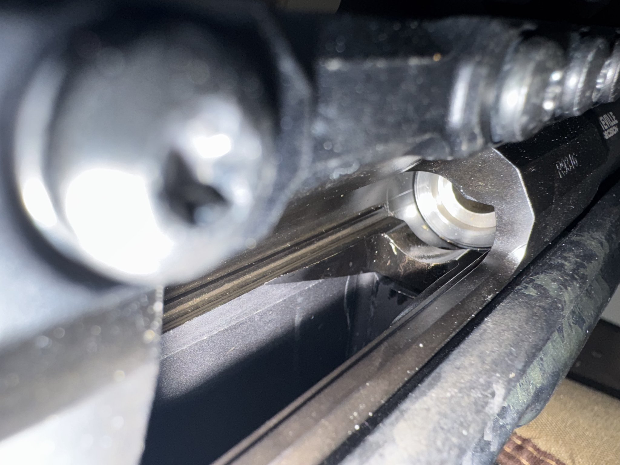

Why is the feed ramp not notched like the many other rifles I’ve got? That would solve this issues pretty easily. If the rounds aren’t angled that way, like they are in the picture above, there is absolutely no way possible that they’ll feed. It either slaps the nose of the bullet into the flat feed ramp, or the case mouth catches, everytime.

Spoke with Impact today. Greg was really helpful. Getting them more pics tonight, but it sounds like the feed ramp is suppose to have an angle machined into it. Mine is basically just a flat wall. They are going to confirm and if that’s the case they’re going to get me a replacement.

Yep, Impact is going to send a replacement.
Surprised no one caught it, especially when putting the barrel on, but oh well. At least they are good people there.

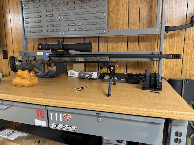

Excited to get it back. It was shooting phenomenal.
Reactions: ma smith

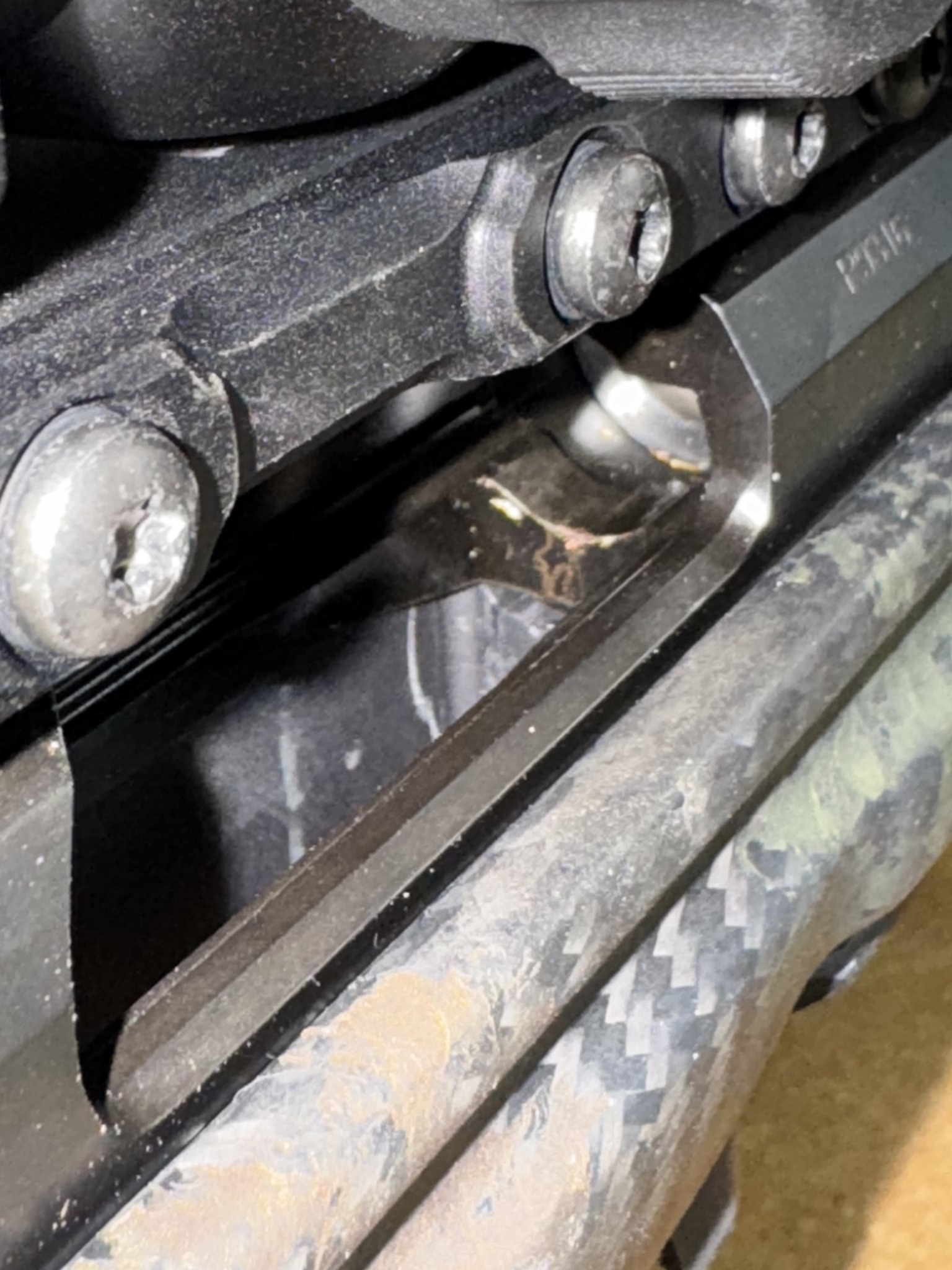

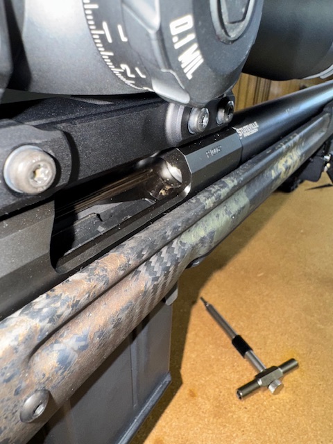

Got it back from impact. Works flawlessly now. The way it should. Greg and Tate were awesome to deal with. Replaced it and put the barrel back onto the new action and shipped it back.
You can clearly see in the pictures prior that the feed ramp totally got missed in the machining process. Odd, but stuff happens. Guess I was the unlucky duck.
I tightened the feed lips back up on all my mags, and I can’t get a single one to malfunction now. It works perfect with everything from an 80gr vmax to a 109 Berger, feeds every round from 10 down to 0 flawless.
