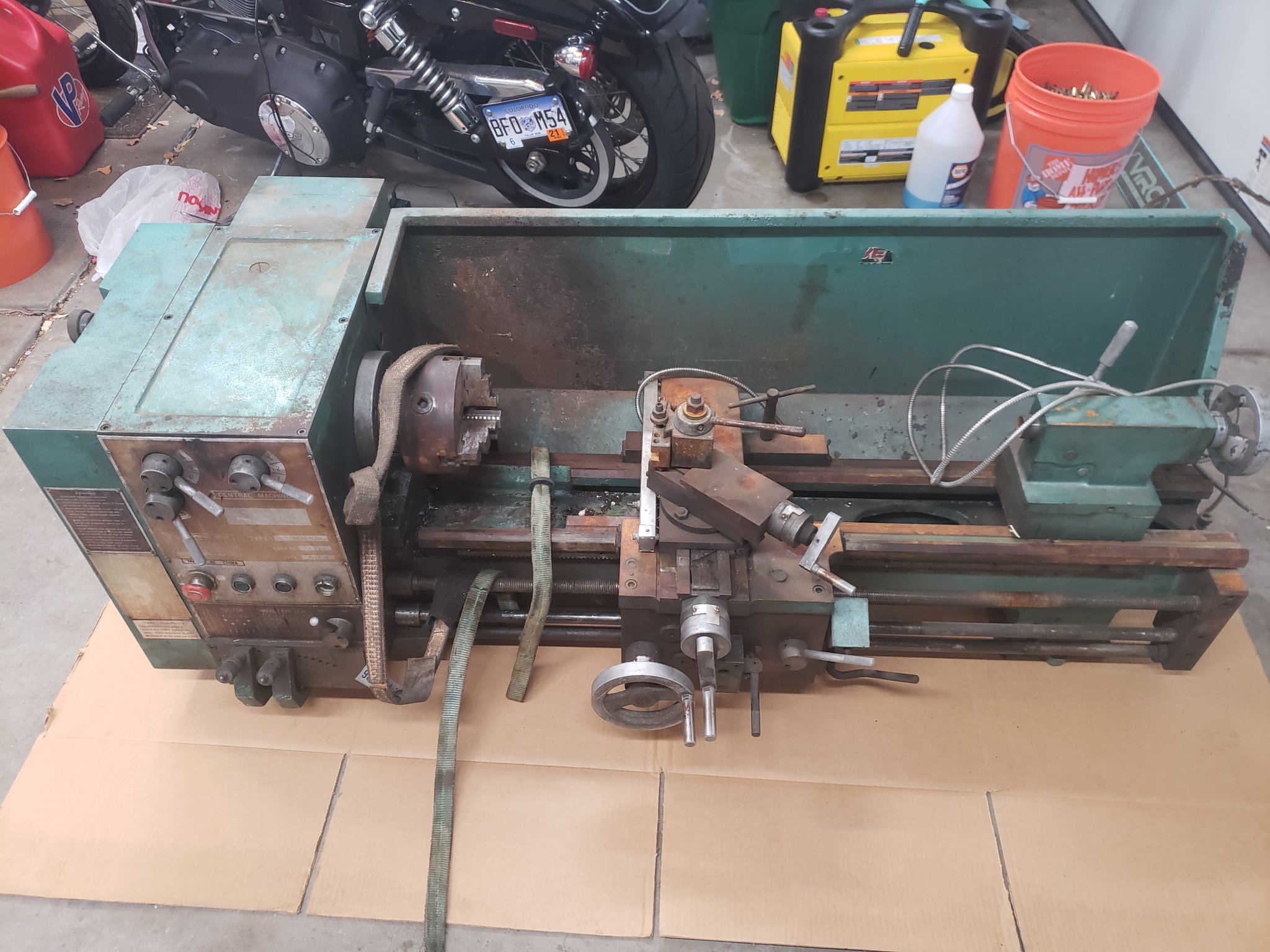

I have wanted a lathe forever. Never had enough of a need to buy what I really wanted so I have always put it off.
This weekend I scored myself an awesome project. The guy wanted to give it to me for free but I threw him 100 bucks. Basically paid scrap metal price for it. It was involved in a house fire and it needs plenty of love. I was actually the officer that responded to the original house fire call when it happened.
I have never run a lathe before so I figure the rebuild process will teach me a good bit about it. Everything still moves smoothly and it was well cared for before the fire. Some rust doctor, wiring, lube, and paint should have it up and running again soon.

Nice Score should'nt take much to get that one up and running heres a good site for information https://www.hobby-machinist.com/forums/

That's a nice one. Clean it up, replace anything that out of spec. Read about the process, get a few pieces of metal and have at it. You'll make mistakes, but that's how you learn.
You made a great score, now make the Hide proud!

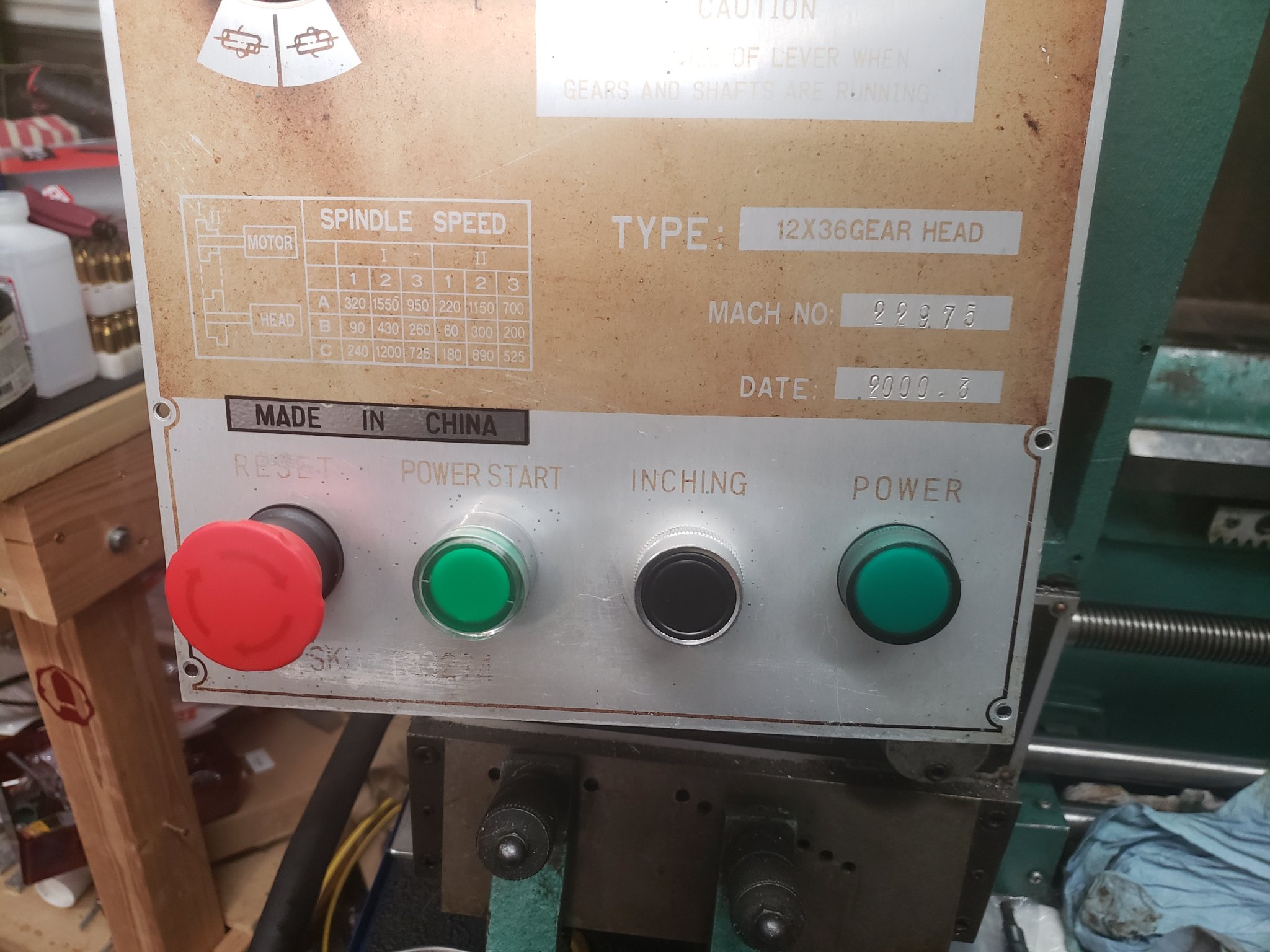

That's the Harbor Freight/Central Machinery version of the Zhejiang Kaida 12x36. They have been imported by Grizzly, Enco, Precision Mathews and many others for a couple decades.
The spindle bore should be about 1.47" . The backside of the spindle has a 1.5mm thread. Very easy to make a thread on cathead for working barrels through the spindle bore.
I used to have the Smithy version of that lathe. The cathead I made for that Smithy also fits by Birmingham 13x40.
I believe that is the same lathe as the old Grizzly G4002. Most of the parts from the current Grizzly G4003 will fit it. The G4003 has a slightly different headstock casting, but is otherwise the same.
For parts, get the PN# from the manual here: https://www.google.com/url?sa=t&sou...FjAAegQIAxAC&usg=AOvVaw1_HNQ4WToi7cxq8moPPQcU
Type the part# into the search field on Grizzlys website, and it should come up.

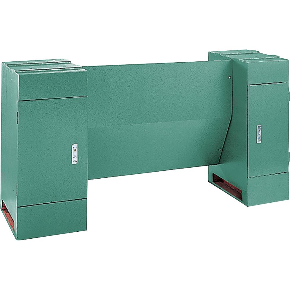

Grizzly still sells the G4002 stand, which should fit that lathe perfectly.
I doesn't come with the chip pan, but you can make one, or order one from grizzly.
The G4002 is the 12x24 version of that lathe. The pedestals will fit, but the center divider will be too short. You can get that part seperately from the G4003 catalog.
Or, you could order the G4003 stand, which would all fit, but be much more $$. For some reason, they've been selling the 4002 stands cheap for a long time. Grizzly is a few miles from my house, so I'm in there all the time.
If it needs spindle bearings, it should take 30212 front and 30211 rear. Grizzlies manual lists 7xxx part#s, which is some kind of misprint. Those part#s are for angular contact bearings. Stick with 30xxx tapered rollers for a lathe.
123Bearing stocks Timken P5 rated bearings in those sizes. You can also find ZVL and FAG P5 bearings in those sizes from Amazon. I recently put a set of the Timkens in my Birmingham:

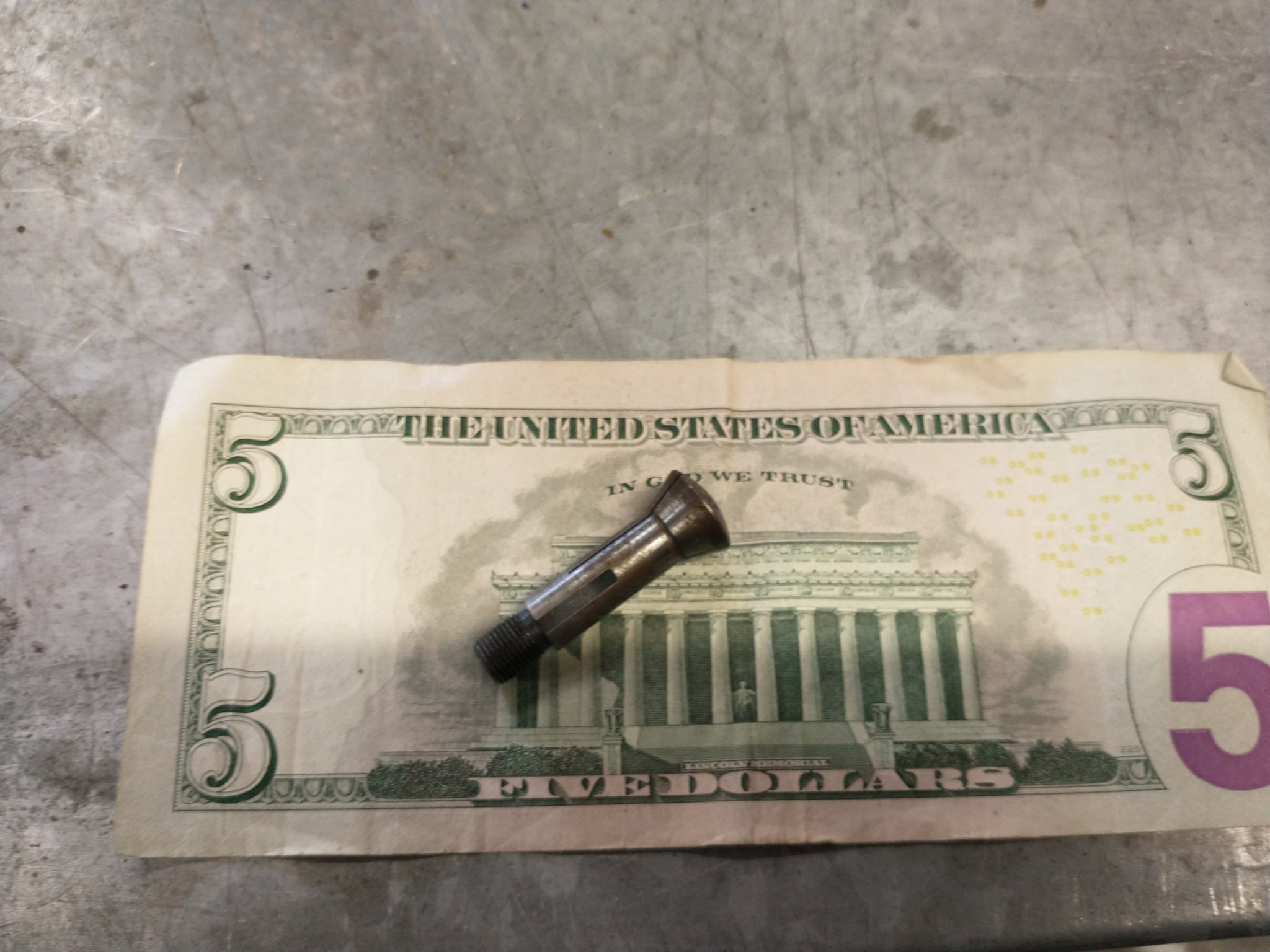

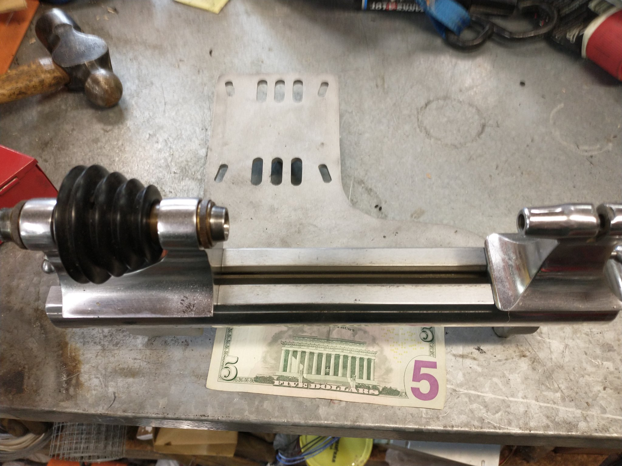

My latest lathe project. I use mine at work regularly and someone gave me this one. I need to get a new dc motor for it. It was ac but dc has more torque for the size.
Mine at work has a cross slide and I am currently working on an attachment to allow me to cut threads with it.
It is a watchmakers lathe. The collet is a 3.6 mm 8mm we pattern wire collet.

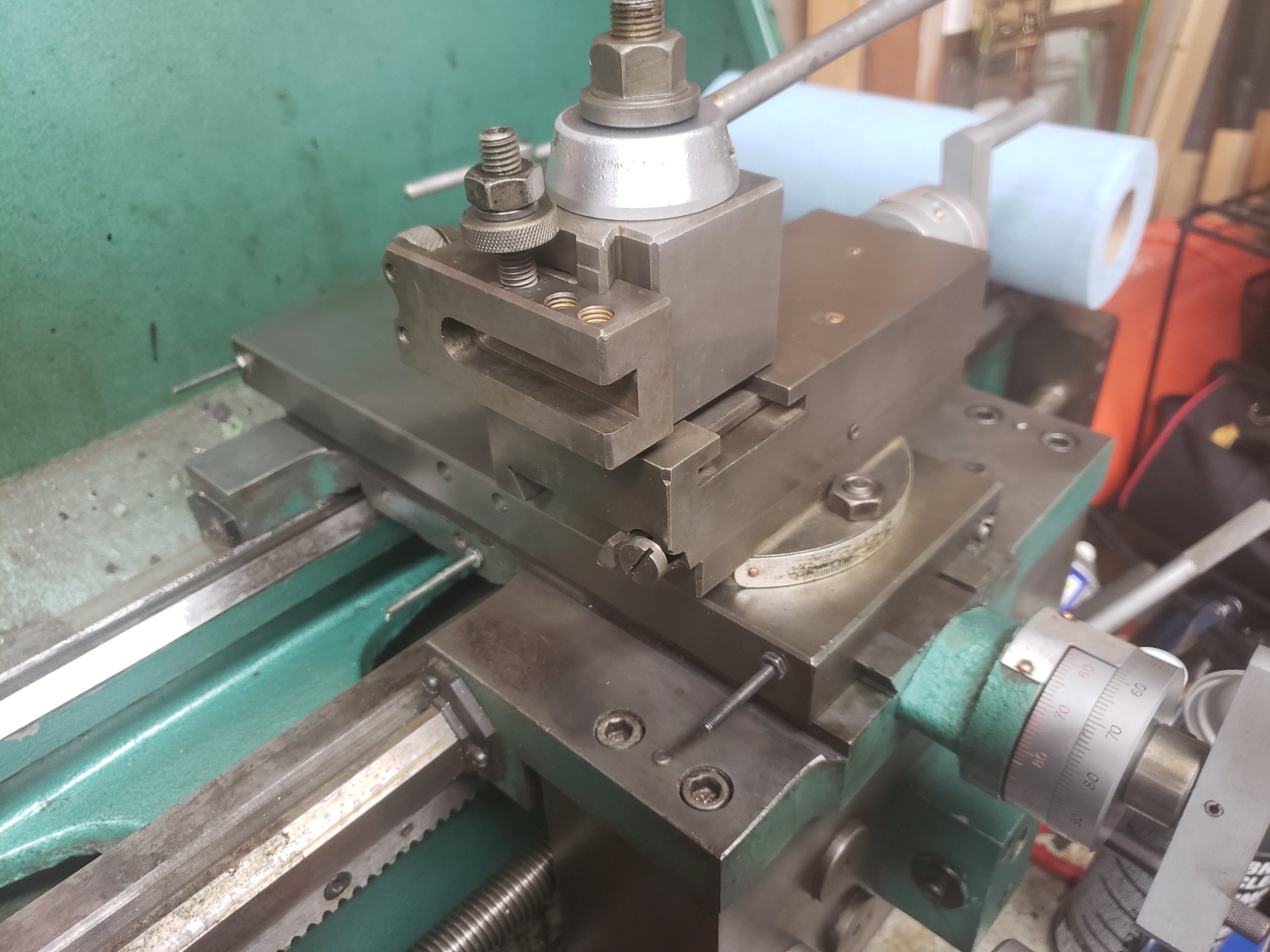

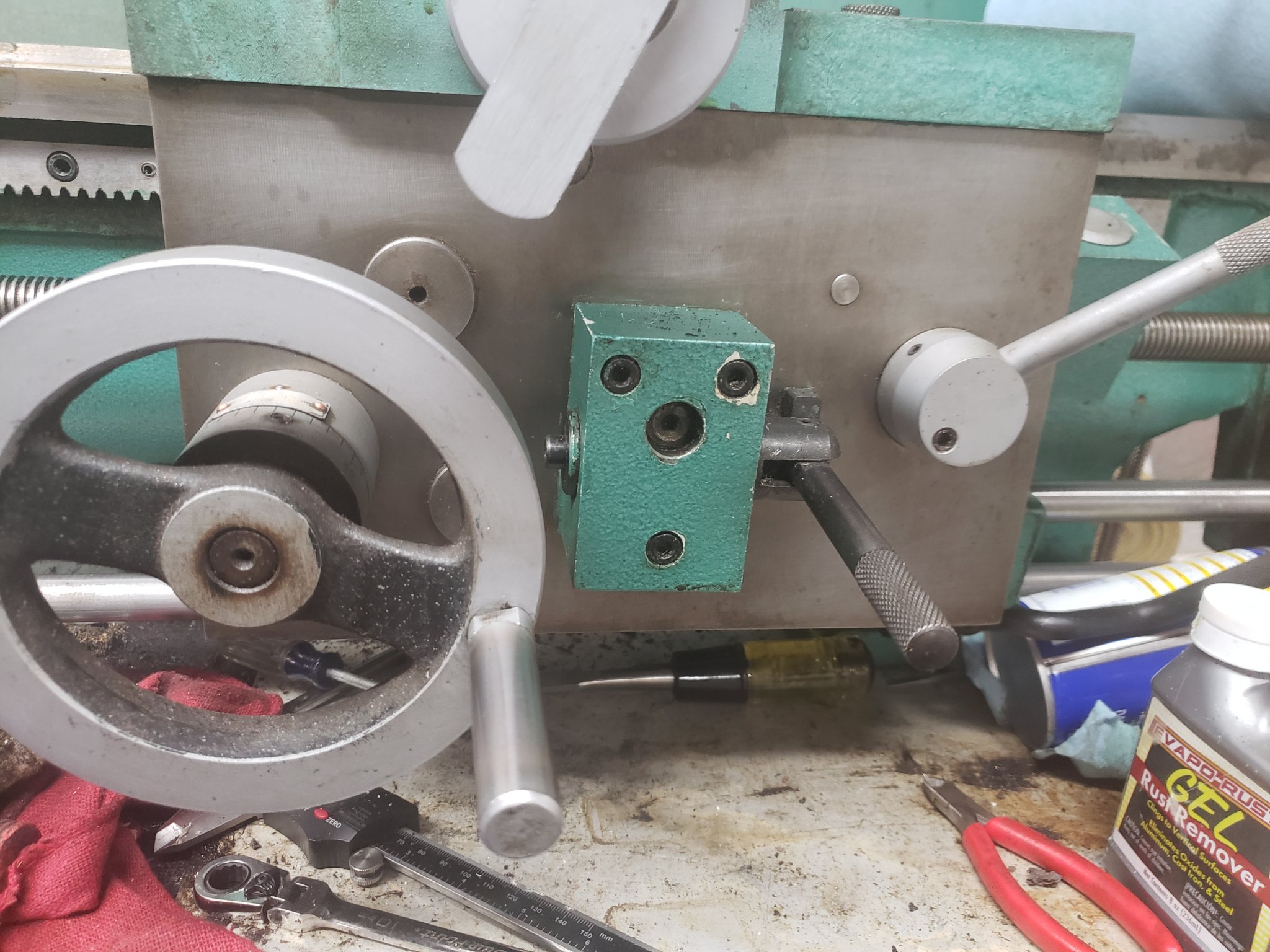

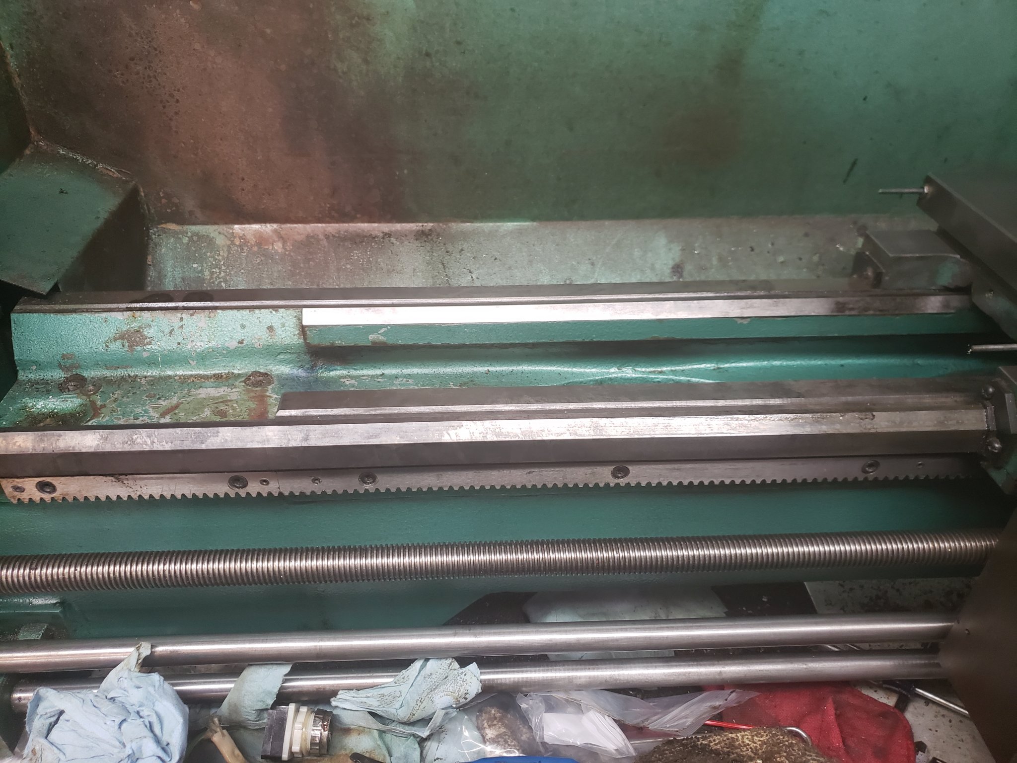

Got a lot put back together after cleaning and rust removal. Evaporust worked really well. The ways cleaned up very nice. The Evaporust did leave some black discoloration in spots but the surface is smooth as glass. I replaced all the melted front switches but one of them is wired very different than the original and I hope I got it right. No instructions or pin out on the new switch. Thats the price you pay for cheap parts. I really wanted to try and start it tonight after I finished wiring the new outlet but... of course I grabbed a 20a 120v plug instead of a 240v one so it will have to wait for tomorrow 🙄

It powers on and runs fine. I only ran it for about a minute because I have not changed the fluids yet. All of the power feeds run in all directions as well. The motor may still fail in the future or even the near future but I can deal with that if and when it happens. I think if it does, I may do a VFD conversion instead of just replacing it. Spindle seems to have right at or maybe just a bit less than .001 runout from what I measure but I don't have a tenths indicator.
Very cool. Pick up one of these - https://www.amazon.com/gp/product/B0006J4U2O/ref=ppx_yo_dt_b_search_asin_title?ie=UTF8&psc=1 as your first sub thou indicator. graduations are .0005 but it resolves better than that and if you want to indicate into the bore (most do these days) it is the "standard" that almost everyone uses. You can pick up a short arm tenth later.
Have you already tried to adjust spindle bearings or was this just power on and see what it does? .001 isn't going to make you happy for gun work, but after oil change, warming it up, and adjusting bearings it might be better than you measure currently. or it might not be :ROFLMAO:

I have not adjusted anything yet. That was just what I measured out the gate. I do intend to adjust the bearing. My indicator setup was probably less than ideal as well. I need to sit down and take some time to check it a little better later.
