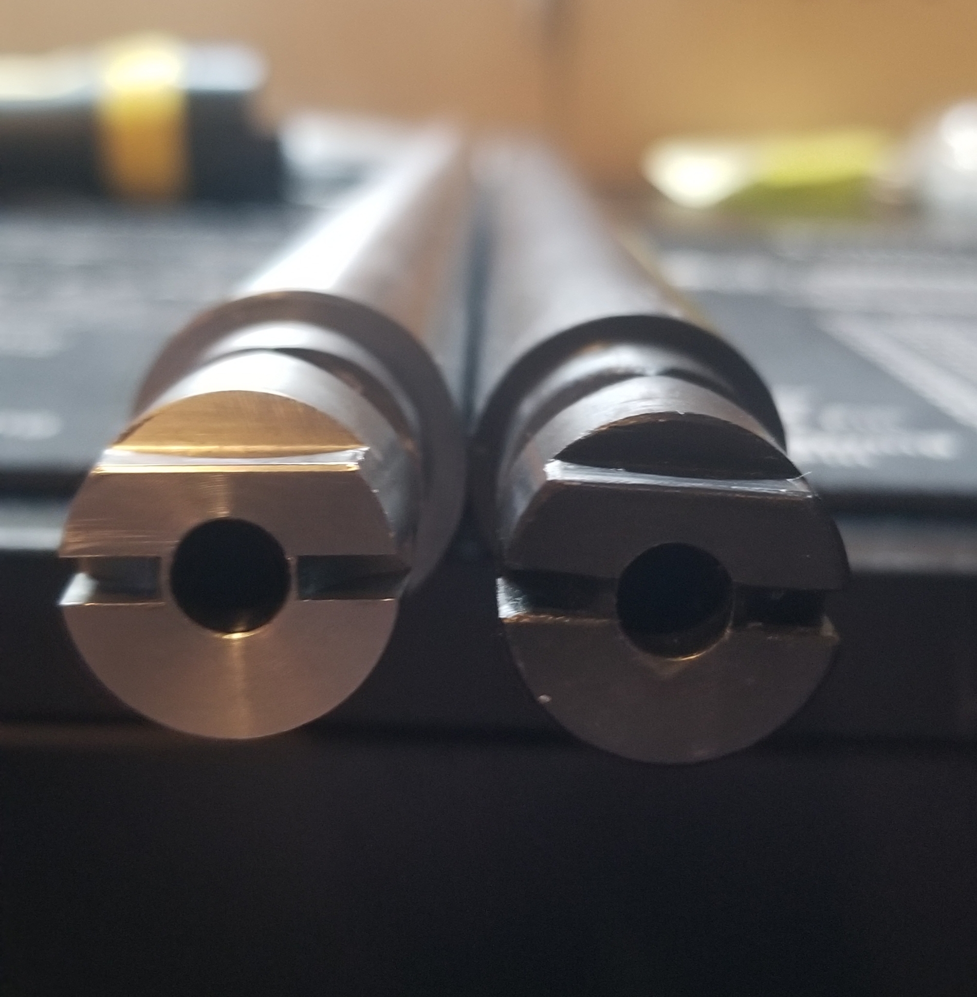

Ok.. had a little time this morning to check things out and compare the Lilja barrel to my stock CZ barrel..
Checked timing of the barrel and position in the receiver.. Looked good.. loosened slightly and was able to feel the barrel hit on both sides in receiver..
Made a small mark on the underside of the barrel and receiver where they met up.. loosened the barrel a bit and tightened and torqued to spec.. No movement
Extractor claws have no chips and the c-clip is gtg..
Small burr on the face of breach end.. removed it, no difference.. still would not eject a fired round
Removed the barrel and did a side by side comparison.. That's where I noticed a difference in the extractor cuts.. The stock CZ cuts are a lot closer to the chamber than the Lilja is.. *see photo
I emailed Carson @ Lilja on Friday and he said he was at Shot Show.. He said he would get back to me on Monday when he was back in the office to figure this out..
Hopefully the grooves are the issue.. I want this barrel to work.. if not, there is always Option #2
Maybe it's just my imagination, but it kinda looks like you can "see" where the extractor claws have been making contact with the inner edge of those slots. I'd imagine, given the ramp of the slots and the shape of the extractor claws, that contact would tend to push the extractor claws back from center and reduce engagement with the rim of the shell case.
Maybe relieving those ramps more, possibly even matching the factory barrel, would help?
Reactions: 1911Operator
That's probably going to be the plan of action.. I'm waiting to hear back from Lilja sometime Monday.. I'll show Carson the photo and hopefully they will take care of it.. I really don't want to do the job myself and screw it up, and I don't think I should have to pay a gunsmith to do it either

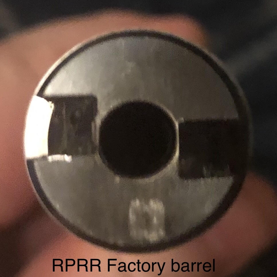

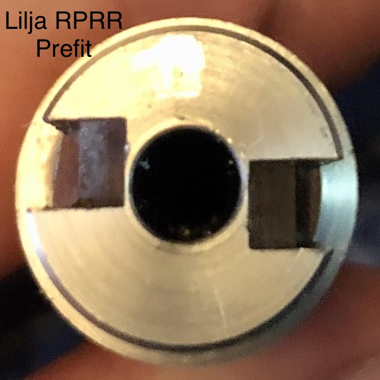

I have a similar issue with the Lilja Rbarrel for the Ruger Precision Rimfire. I'm also in a holding pattern with Lilja, since, like everyone else they've been at SHOT.
I'm hoping they make things right.. worst case I'll have to pay to get it done right or just send it back for a refund and get a Area 419 barrel.. luckily I have another .22 to shoot in the meantime
Appears to be bad QC from Lilja. I say this because it has happened twice and on different types of barrels. Think how many other times it has happened and never been mentioned on here. I'd bet money Lilja has a bunch of these barrels sitting on the shelf.
Me personally, I'd just throw rocks before I bought another Lilja barrel. But, good luck hope you guys get it fixed.

I got a Lilja drop in barrel today for my CZ 457.. Measure the depth on the receiver face to the bolt face.. It measured 1.237" .. subtracted the .043" for recommanded headspace, which equals 1.194".. the barrel shank is 1.2" .. which means I need a shim of .006".. Installed 1 .001" and a .005" shim and re-assembled and installed into the MPA chassis.. it now does not eject a unfired round or a empty shell .. put the stock barrel back in and it ejected both.. what's going on with the Lilja ??
It sounds more like your having an extraction problem vs an ejection issue. If the extractor claw fails to purchase the case rim then its either because the clearance slot is wrong, the HS is incorrect, or the Extractor has some sort of issue. The fact it works with the OEM barrel, but then fails on the Lilja suggests either a machining or installation issue.
Take all the tennon measuring/subtracting and throw it out the window. Install the barrel. Install a gauge. If the gauge goes, shim the face of it with something of known thickness until it prevents the bolt handle from dropping. If it is .041" +/- .001" your in the clear.
Now, look at the extractor slot feature. These are machined most often with a key type cutter. -Basically a little saw blade. Describing this is tough, so bear with me. Cutting the slot tangent to the radius of the tool is not the best approach because it leaves a very, very thin wall right at the breech face. Over time it will bulge outward and make extraction more difficult. The trick is to be "ahead" of the tangent point by some degree so that the tool is cutting "away" from the inner chamber wall. (I hope that makes sense) This can be an issue at times if the nose/outer portion of the extractor claw isn't factored into the shape. The nose can rub on the relief cut and prevent the actual claw from grabbing the case rim.
So, you have a few things to look at a little closer in order to get a better feel on how to proceed.
Last. If you guys get the punk on this, I can help. I'm very comfortable with rimfires. It won't be free, but it'll be done correctly.

Another evidence point, my buddy just got a new lilja barrel for his RPRR, and the extractor cuts are like yours 1911. They're way too thick on the wall of the chamber so there's not enough space for the claw to extract. I don't know why that's not obvious to them when it's like rimfire 101 on extractor cuts?
Lilja asked him to send the barrel AND the action to them... so he'll be w/o his rifle for a few weeks, or whoever knows how long.
The thing does shoot well though... it might not extract well, but when we do groups at 100 yards, they're .5 - .75" so it shoots very well. Too bad it doesn't extract which makes it pretty useless.
