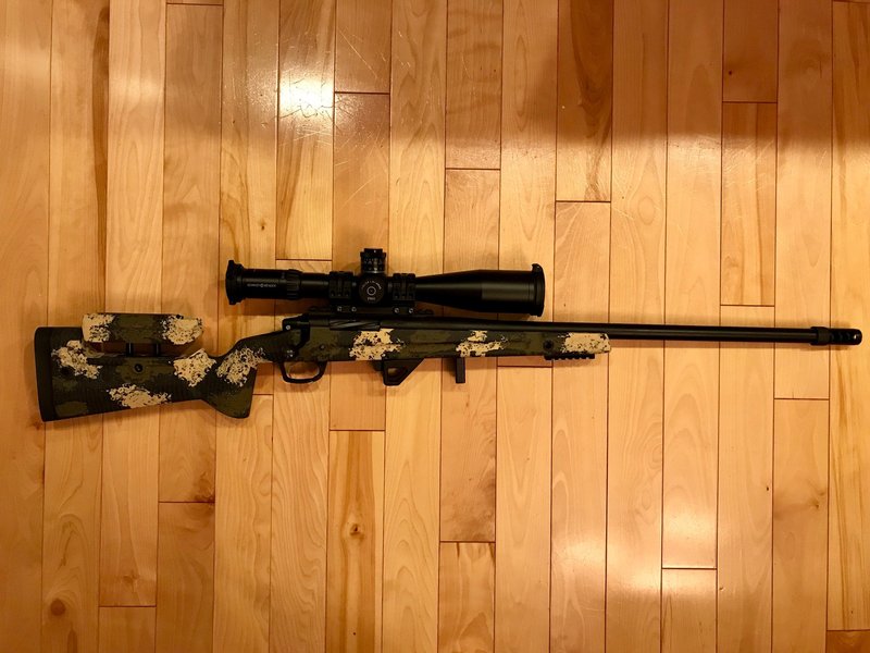

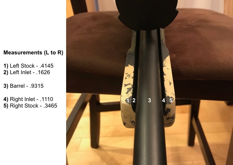

Hide Team,
I recieved an awesome certificate from the Rock Lake match last April, and used it on a new PRS 2 with Mini Chassis and MPA Barricade Rail with the Platinum Layup. I just recieved the stock, and tightened everything up, and noticed the barrel is not centered with the barrel channel. Action is a GAP Tempest, and barrel is currently a Bartlein Sendero contour. The inlet is for a GAP #6 contour, so I have plenty of room now. I'm concerned when I throw on the GAP #6 barrel if I'll have enough on the one side. I'm also concerned there may be something causing pressure pulling it to one side. There were quire a few burrs I had to clean up with the Mini Chassis, (action screw holes, and the two side chassis holes). I don't feel any burrs currently after filing those 3 holes burrs away. Front bolt is torqued to 65 in/lbs and rear is torqued to 48 in/lbs. I have taken it in and out many times trying to get it to center, but as soon as it locks up, it pulls the barrel to one side again. I thought about sanding one side down, but the thicker of the two sides is actually the side that has the larger gap, so if I sand anything down, it's going to be removing material from the already thinner side (material on each side is not equal after measuring). I love the feel and grip of this stock, but my OCD isn't going to let me enjoy it until I get this fixed up! This barreled action was in a KMW Sentinel stock prior to this with zero issues. Welcome any suggestions before I try reaching out to Manners (I hate bugging them about a small issue like this when it was a certificate from a match).

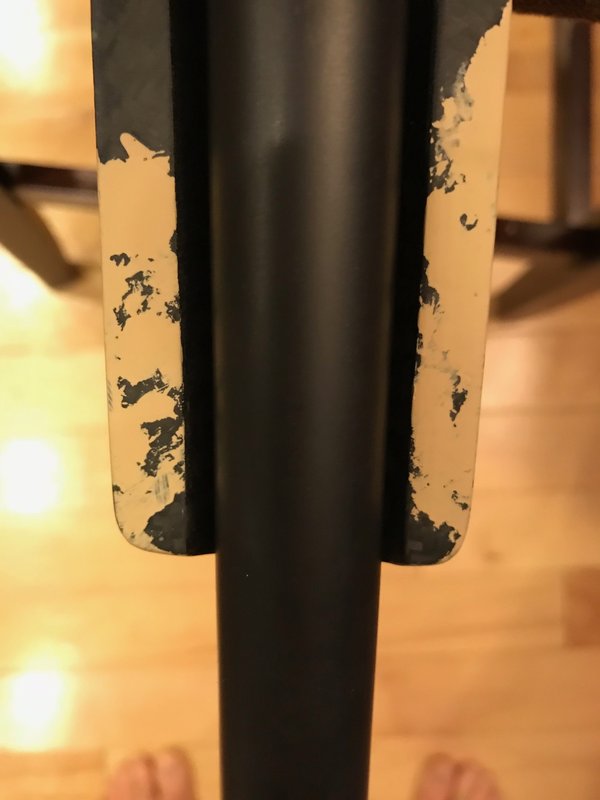

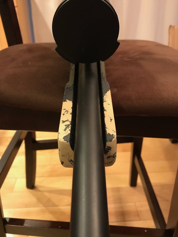

I assumed it wouldn't effect accuracy...just my OCD. Did you have to trim your AW or AICS mags? My AW mags won't seat. Looks like I'll have to take away the top of the feed lips to seat, or trim some material off the magazine latch.
Thanks for your info.
EDIT: magazine fit issue fixed. filed a tiny bit off the magazine where the latch catches and holds the mag.
That may be a standard feature for Manners. I have two Manners stocks and the inletting was poor on both of them. I was able to correct them with lots of sandpaper and epoxy. If mine had been Platinum layups with a mini chassis, I would have probably returned them.
I have another Manners EH1 (specs in sig) that is flawless, but it was bedded by my smith. This is my first Manners Mini Chassis. The IMB Chassis in my KMW Sentinel is a thing of beauty. The Manners Mini Chassis was definitely not as nice fit and finish wise as the KMW Sentinel IMB, that's for sure. Even if I didn't have to clean up 3 holes with metal burrs folded over into the Chassis.

Its not unusual for an inlet to be off or a mini chassis to be out of line. You can double check that the action has clearance from the stock. Sometimes paint/bondo can overhang the inlet. Also check that your trigger is not contacting the MC. I know Manners will take care of you if your not happy.
Thanks for all the info. I took some measurements and will get in touch with Manners to make sure there will be no future fitment issues. I appreciate all the help!

The channel is what it is, my comments on the "burrs" you found in the holes. first an explanation of things.
Take an M700 type action and look at it once. -closely. It's a pipe with an arrowhead shaped back end right? Now, look at the hole positions. Up front it's pretty straight forward. The back end is a little more interesting if we pay attention.
Bedding blocks, chassis, whatever, as made by most, are little more than a "V" shaped feature intended to capture an action along the sides and naturally align it parallel. -Self centering right? This works and has for over a decade now.
The issue however is the tang of the action. It narrows on a 700. The chassis flanks that contact the receiver lose their purchase because the tang narrows. This means the rear guard screw area hangs in space. The easy way to view this is take a board and put a brick in the back portion. Now stand on the board. Front lifts up right? Same thing applies with the action in the stock. It's why the fasteners are tightened up to different torque values. The rear one is basically along for the ride. Go too heavy and the receiver will distort right where the tang ceases to have tangent contact on the chassis flanks.
This was mini chassis 101 issue for years. Guys would bed them to solve it. I used to take them and machine a contoured brass pillar that threaded into the rear hole. Lots of ways to skin the cats here.
A solution was made a few years back where a thin ring like feature remained around the guard screws. The idea is as the action is snugged down this ring will distort slightly. Because AL isn't all that "springy" the material stays in that shape after you snug it up the first time. From there it behaves much like a pillar. It supports the tang portion of the receiver.
I only explain this in the hopes of conveying how you may have (through good intentions) shot yourself in the foot if you mistook the distorted rings as burrs and removed them. If you did its not the end of the world. The rifle will still likely shoot fine and if it should act a little fussy, just bed the tang and be done with it.
As for the barrel channel, it's not too far off, but it is off. Solving this is as complicated as a sanding block and a careful eye. Stocks are rarely drop ins. They almost always take a little work. One needs to remember the facts here. You have over 50 different "custom" action companies making "M700 clones" these days. You have 10 or so "custom" barrel companies making barrels. Now go through the rest of the parts and name all the companies.
NONE of these guys talk to one another. If I call 99.9% of these companies and request a CAD file model of a particular part, most will tell me to buzz off. They either don't have it or refuse to share it. Now compound this by knowing that most stock companies don't have and extensive CAD/CAM infrastructure to manage how the assemblies interact. This stuff is often done by hand worked molds that attempt to hit the broadest region possible. Molds are not cheap to make so the tools need to blanket as many applications as possible. It's just a fact of manufacturing.
It's worth knowing this so that one enters this game with a clear set of expectations. Unfortunately these things are not legos that just snap together. Fitting is part of the game.
