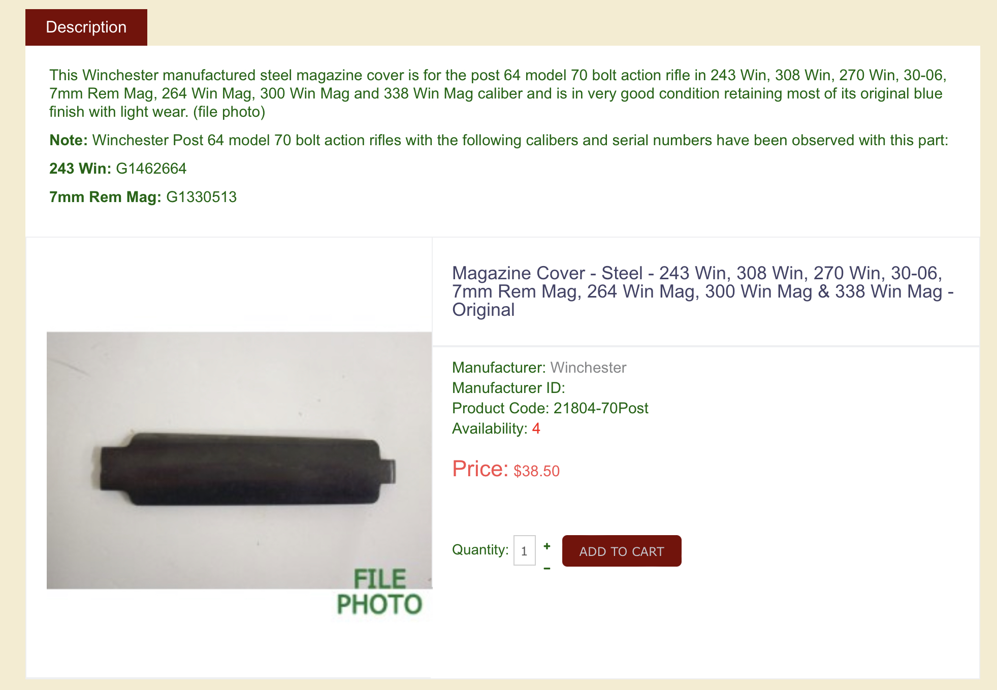

Wheres the best source for a bottom metal for one of these smear stocks?
If you want it spec you are looking for a Winchester Model 70 Post-64 Steel Trigger-guard and Winchester Model 70 Post-64 Steel Floor-plate. eBay has some once in a while (there is a correct floorplate listed now in steel and trigger guards in aluminum which technically would function), its possible LRI may make some sets after the scope mounts are produced but as of right now no one trustworthy is making new production.

We need to almost start a new thread and show how to do the modifications and also where we can order the correct hardware for the trigger guard.
I have a return smear I'm trying to mod the parts for and have seen some pics online and in books. But it would be nice to have a how-to tutorial where someone really shows this in detail. With all these Smears coming out, a lot of people will be needing help.
I guess if someone wanted to piece meal one together, this might be an option. He’s sold out of hinges, though. I don’t know if this is considered a reasonable price.

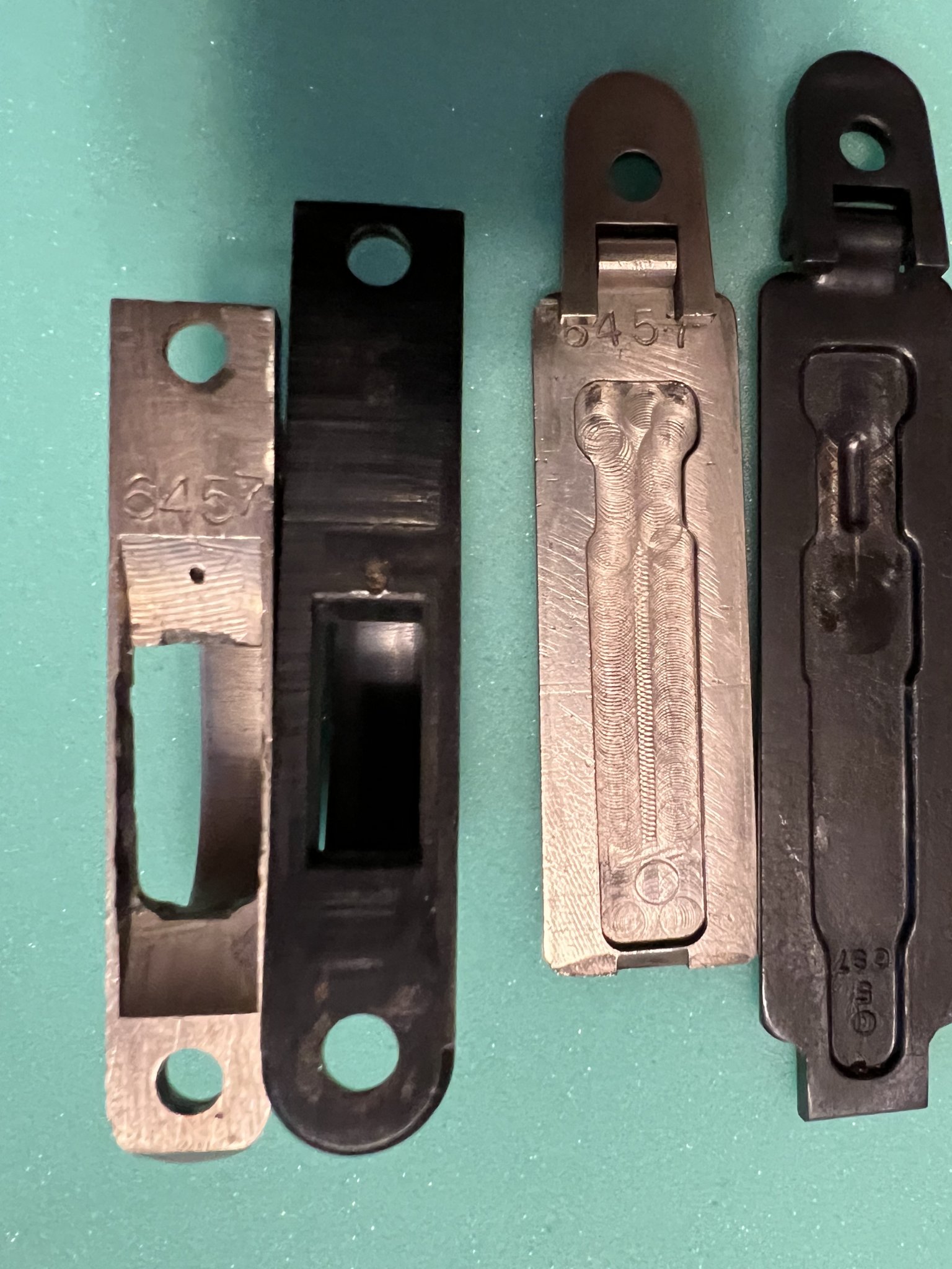

Didn't the 2112's have to shorten the plates and guards originally? Thats how I remember it described. I know the holes for the screws at the front of the trigger guard, under the plate when closed, can vary location a lot.
Shouldn't you be able to set them in place and see where mods need to happen? Unless it was modified after return, it should be set up for the modded Winchester metal.
Didn’t Williams used to sell two piece bottom metal for these?
I have an unmodified set around here somewhere. I’ll dig it out and post some dimensions.
Yes, the 2112 modified the trigger guards and floor plates. The stock were shipped to the Marines non-inletted, that was also done by the 2112's.

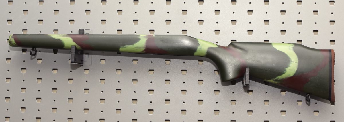

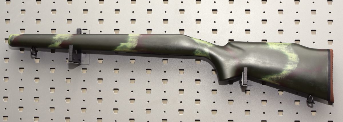

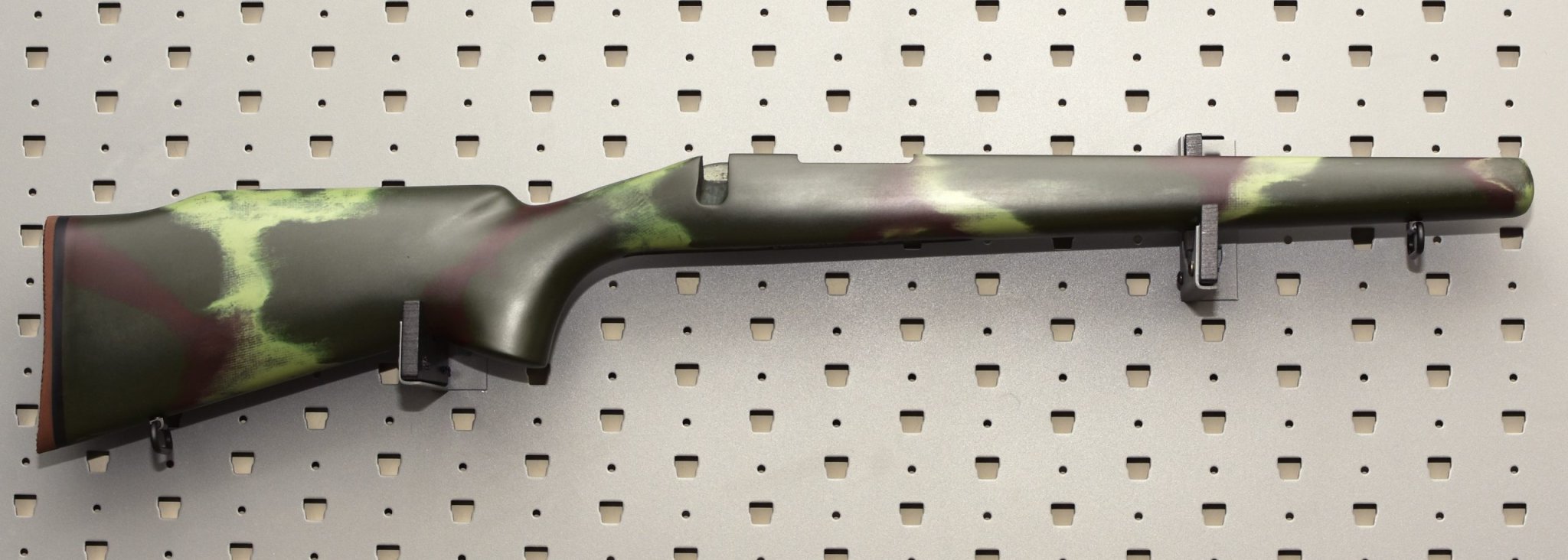

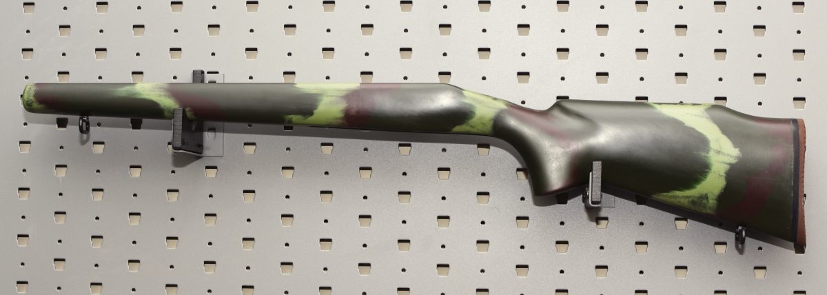

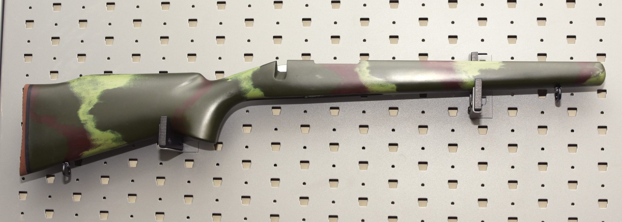

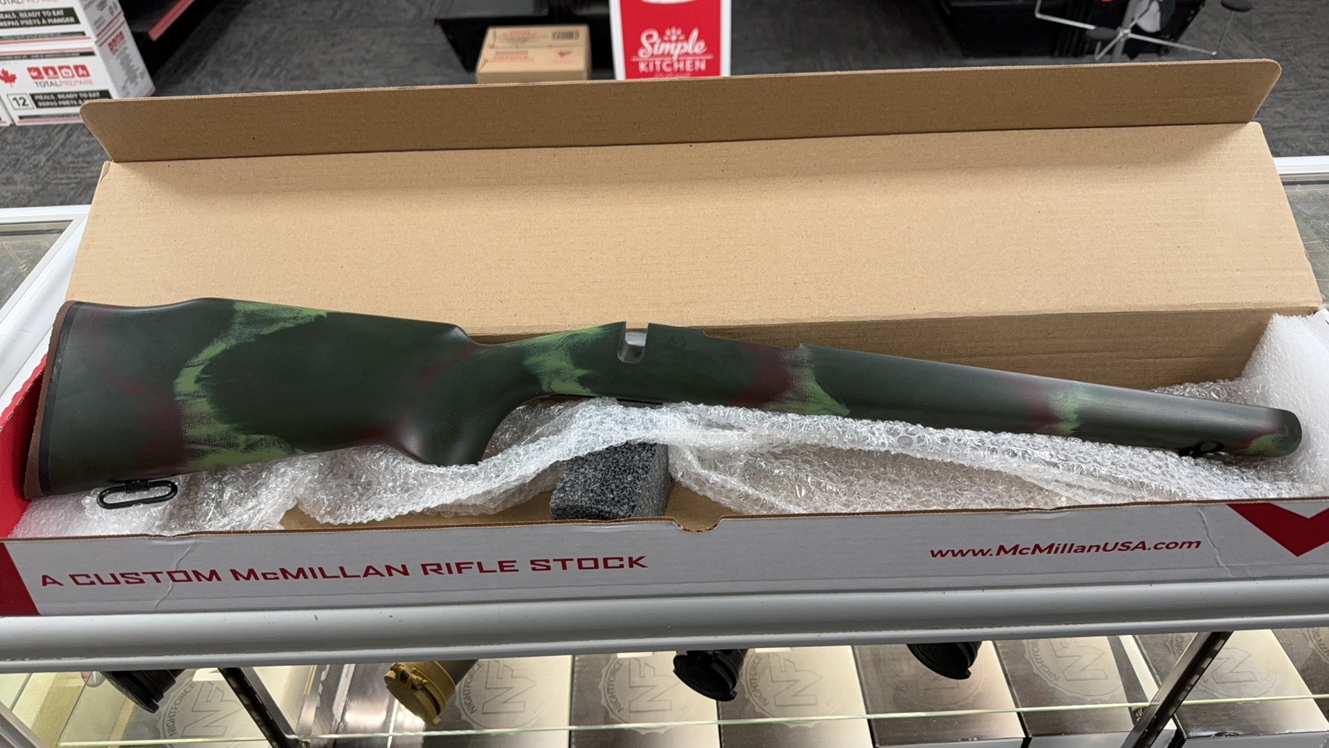

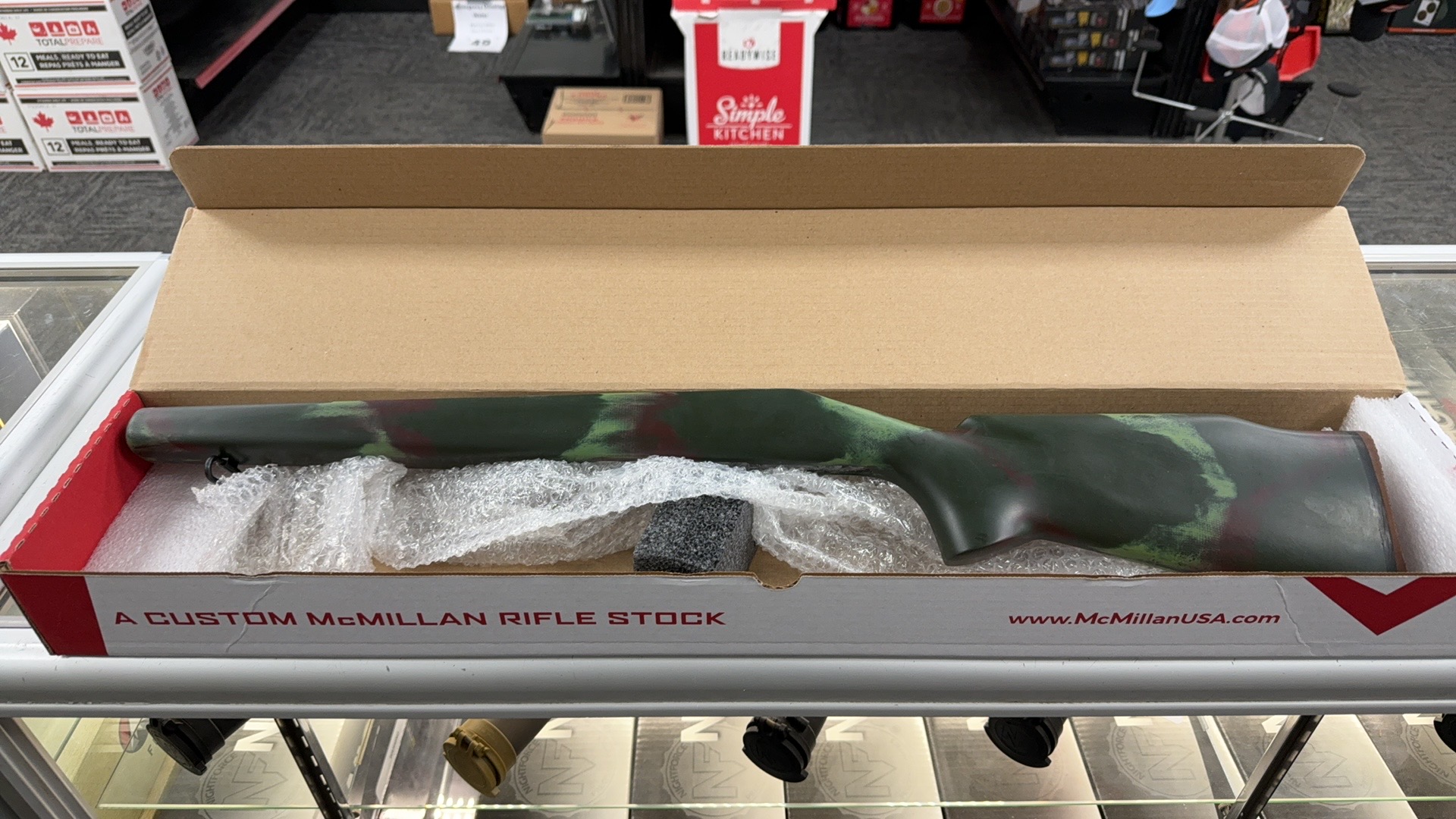

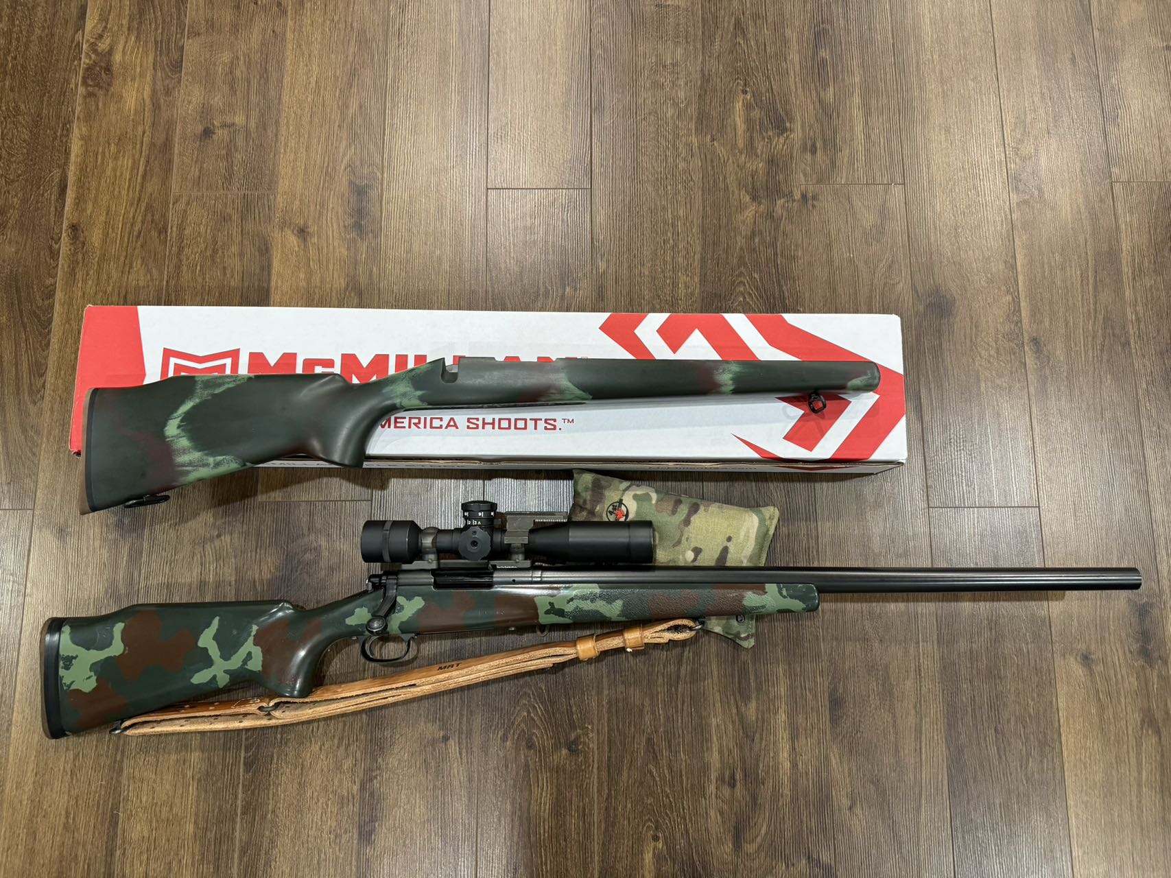

Finally received it today. It looks very different than the normal forest camo color. Snapped couple photos of it laying besides my not really "correct" A1 build.
Also a question for you guys. Is there anyway to time the sling swivel? The rear one is off to one side when fully tightened. The front swivel is perfect. Or should I just leave it as is?

The issued M40A1s had the Wichita sling loops screwed in all the way until the face of the base sat flush with the stock and were also bedded in place. The Marines were probably not worried about marring up the finish of the gel coat a bit to get them secured. Up to you, but I would not be too worried about either screwing the swivel into the gel coat a bit to get it lined up and secured properly, or use one of the small plastic crush spacers that come with sling studs to get it timed properly.

Just get a small washer. So you can "time" the swivel. If you go buy common sling swivel studs....they often come with white plastic washers.

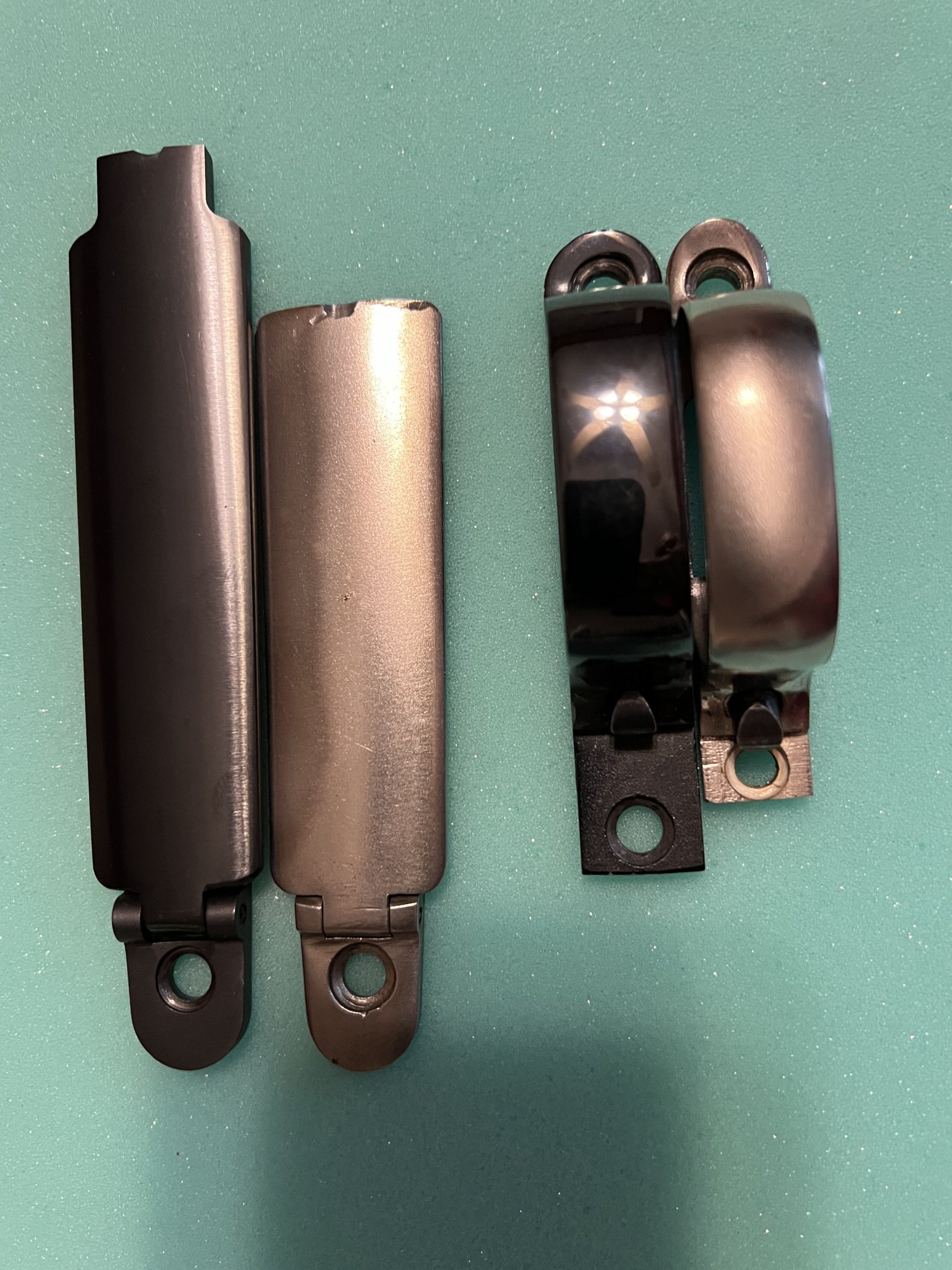

Here is one that I think has been modified. First pic shows the factory floor plate on the left with modified on the right. Second pic is the opposite with the modified trigger guard on the left. The modified trigger guard and floor plate are pre 64 and the factory guard and floor plate are post 64. Hope this helps to give you an idea of how much metal needs to be removed.

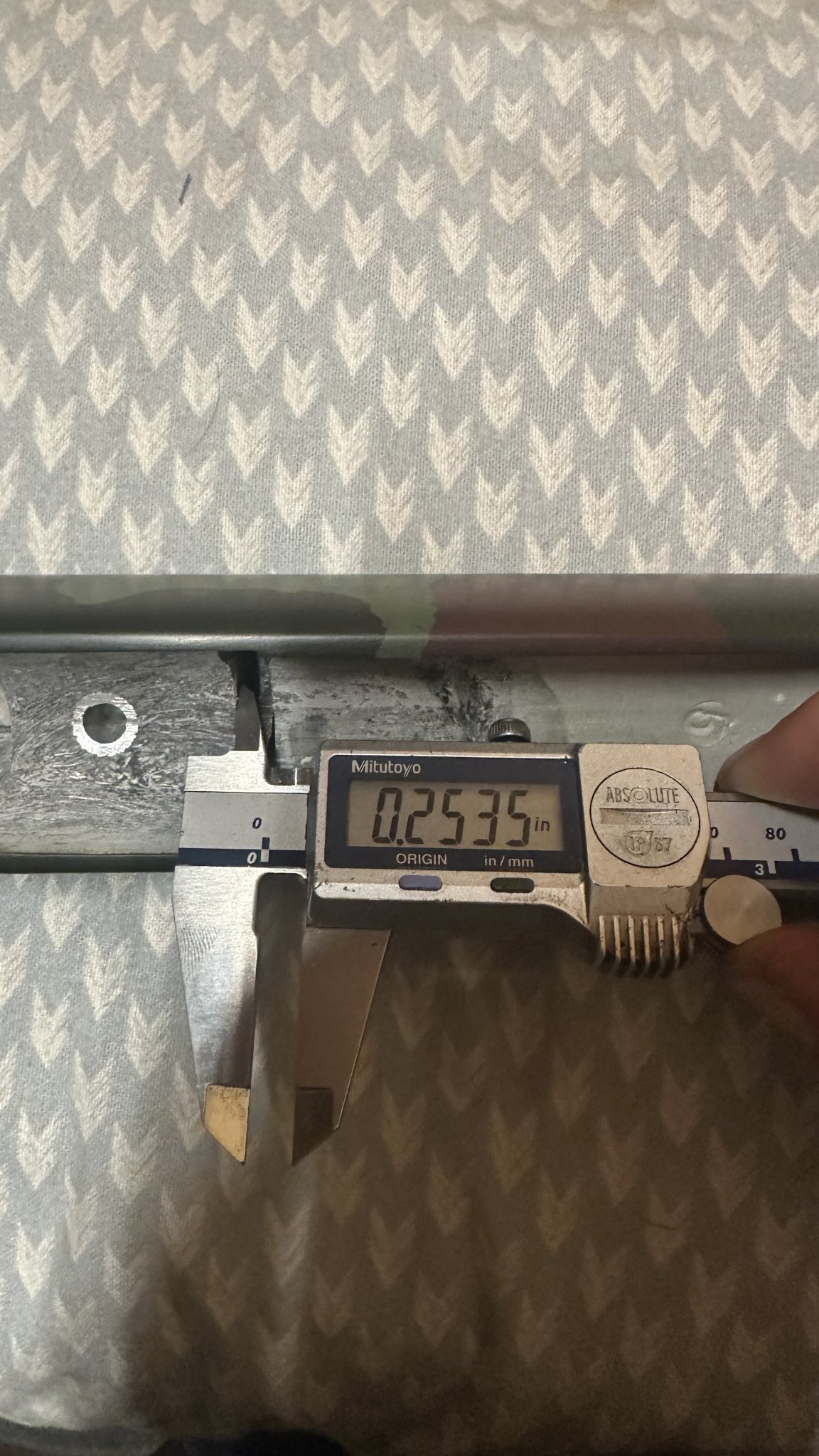

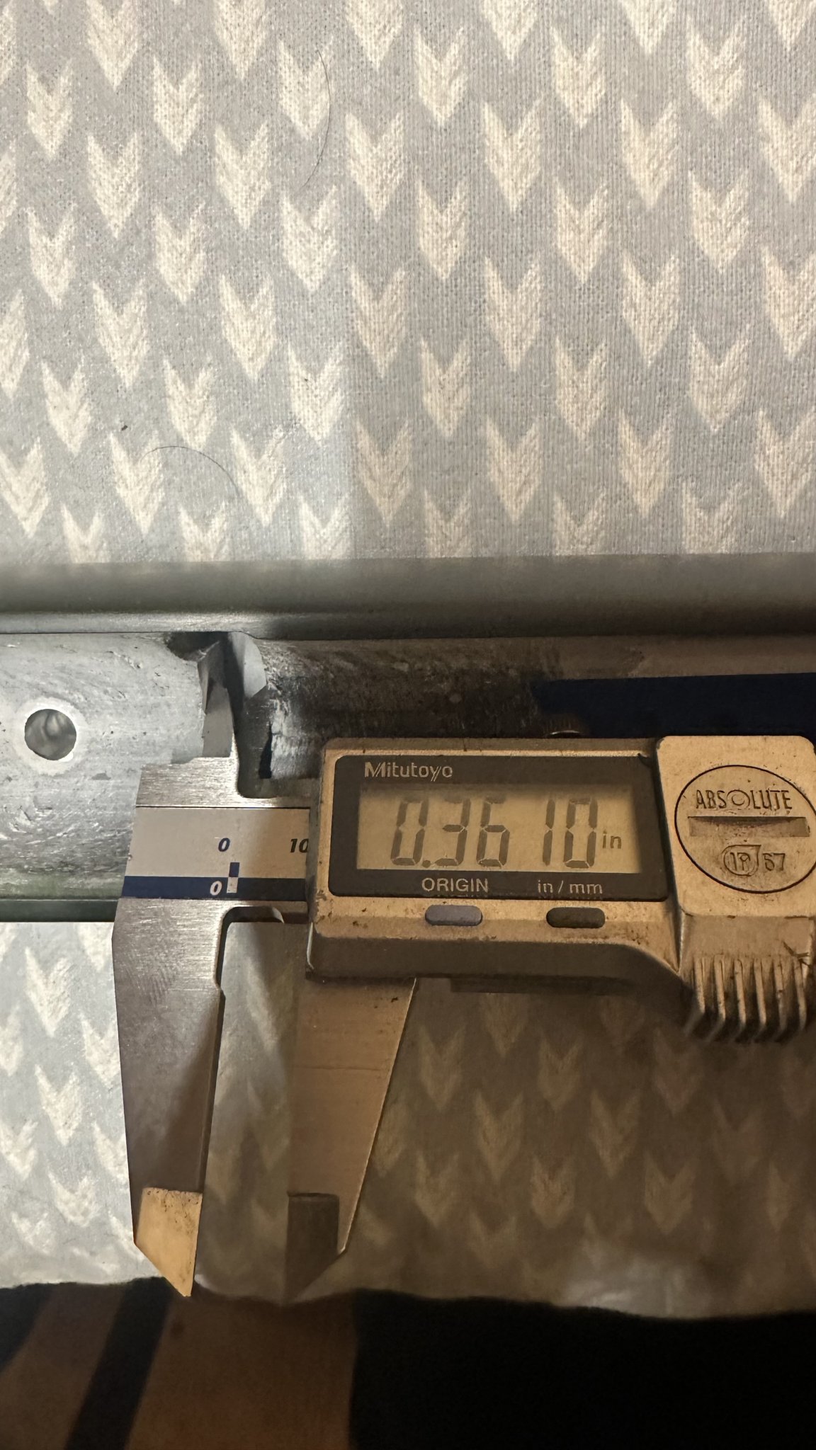

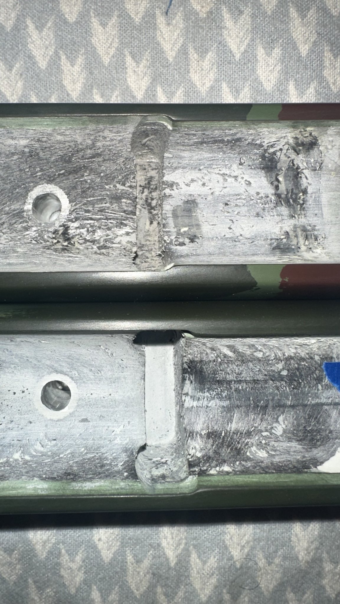

We have an ERROR in the new smears! So everybody stop what your doing and go fondle that beautiful new smear. If your not already 😉
Where’s the error and although it not an issue but it’s there. Standard recoil lug on the A1’s is 3/16th thick. The A3’s and later models had a 5/16th recoil lug.
This new smear has its recoil lug area cut for the 5/16th lug. So go check your stocks. 3/16th lug is cut at about 1/4” wide. The 3/16th is about 3/8 wide.
Below is a new smear compared to a spec molded in forest camo.

Mine Is .265 but it gets bedded in front of the lug with a pad so I don’t think anyone will notice once it’s full of your choice of epoxy.
Nope, doesn’t effect anything. Just not the norm and for those whose wish to use the a3 lug instead. It’s the peace of mind that you (your smith) isn’t cutting anything new into the stock. For the collector, it’s an oddball/error. I’m guess 99% of these stock will get built.

Since i got my cheap humor out of the way... I didn't think the returns were pillar bedded like has become standard in the last couple decades. Looks like the newer lug cuts are deeper as well. (Went back and reread noticing my error in that you were just comparing the new smear to a 'spec' molded woodland.)

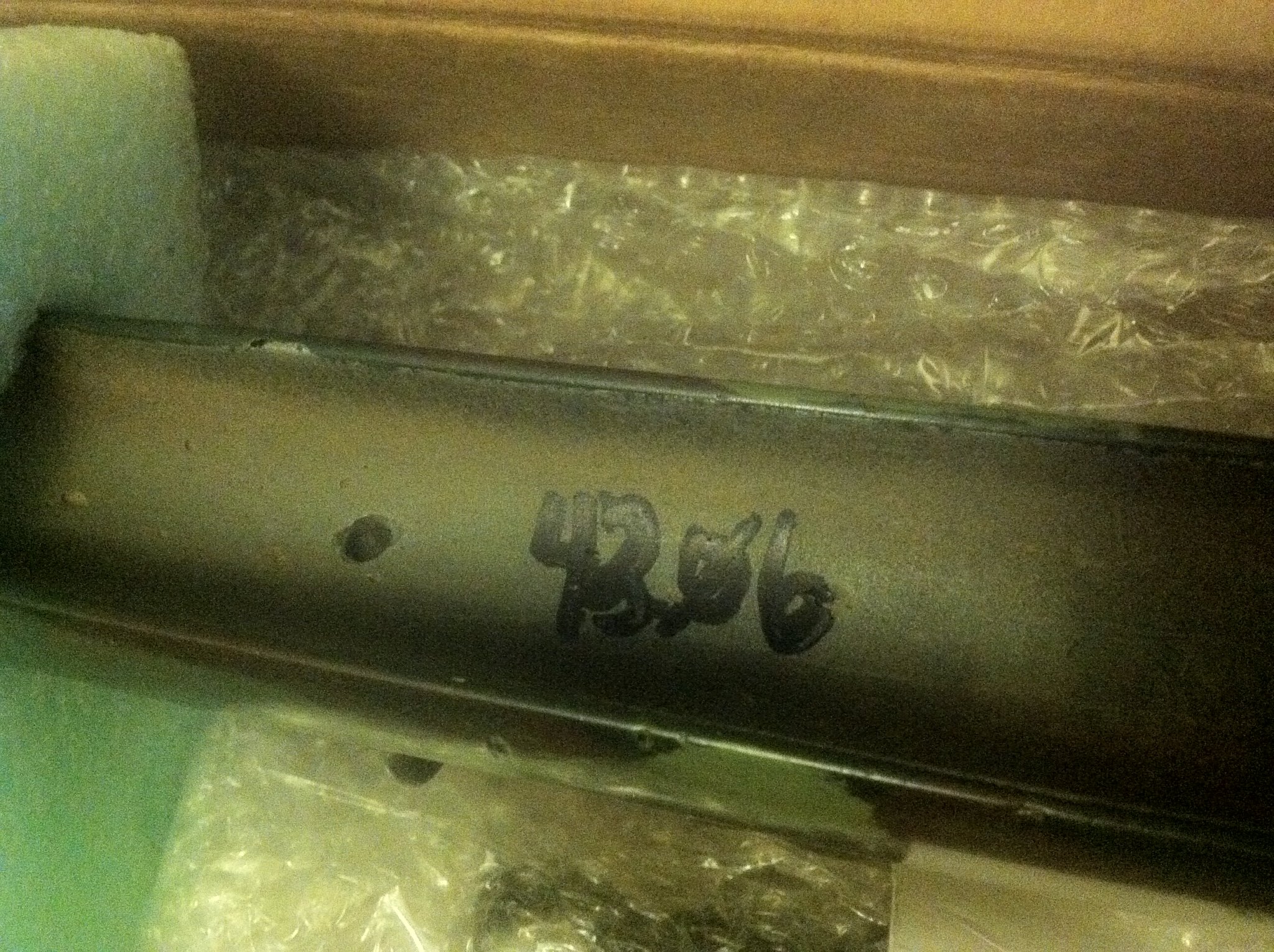

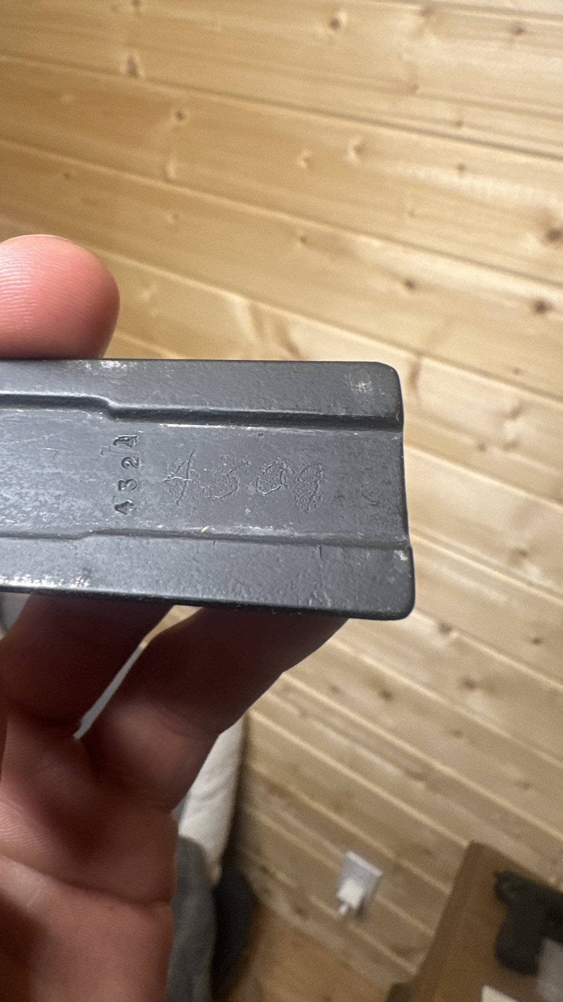

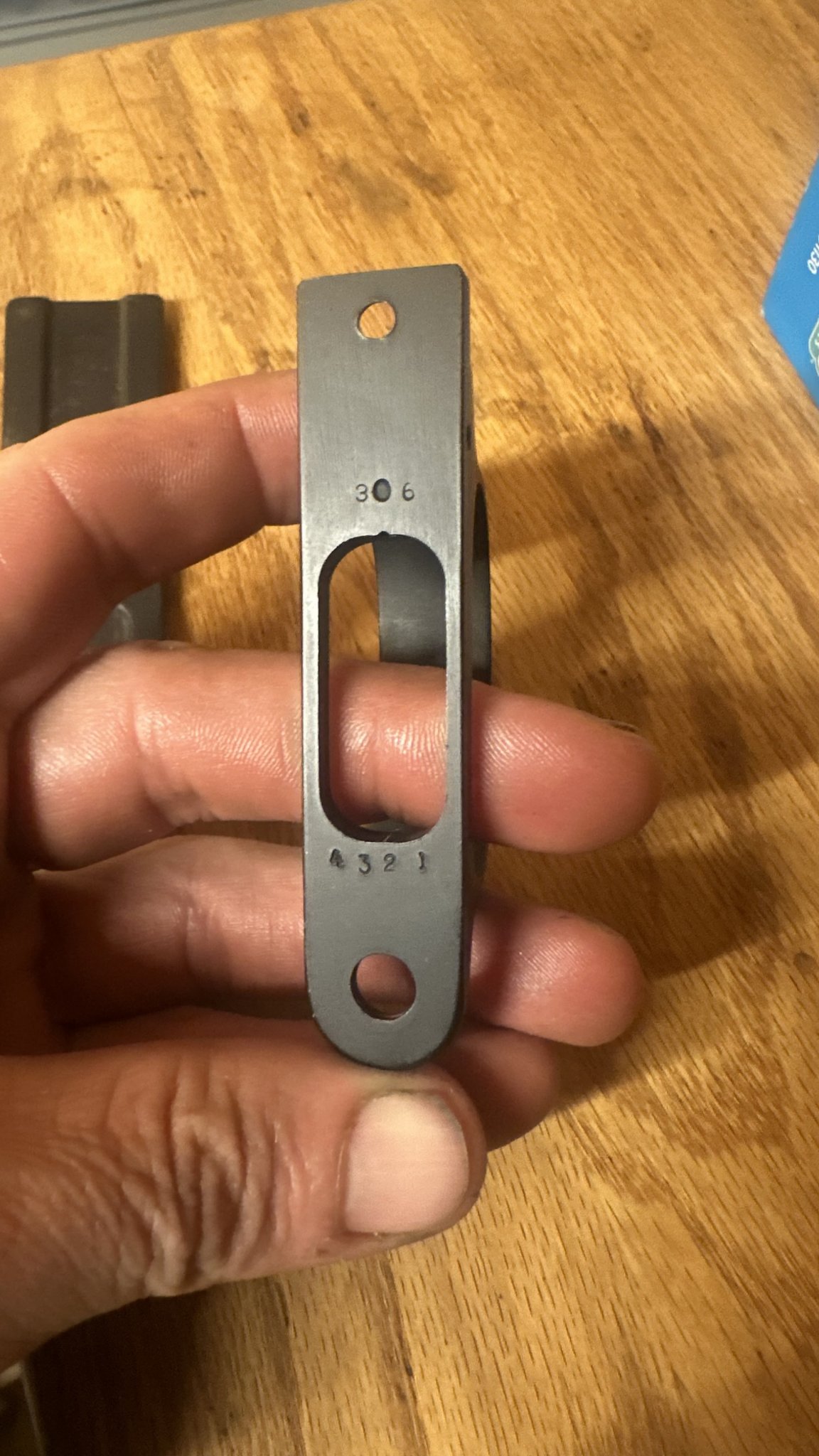

That is a great question and I love thinking of all the possible reason why/how it got switch out for another. Was 4309 damaged? Did a 2112 fuck it up and scrapped it? Did it accidentally get mixed up with another and they just left it? Did they have a brain fart when etching/stamping the number/writing the last 4 of sn? We will never know

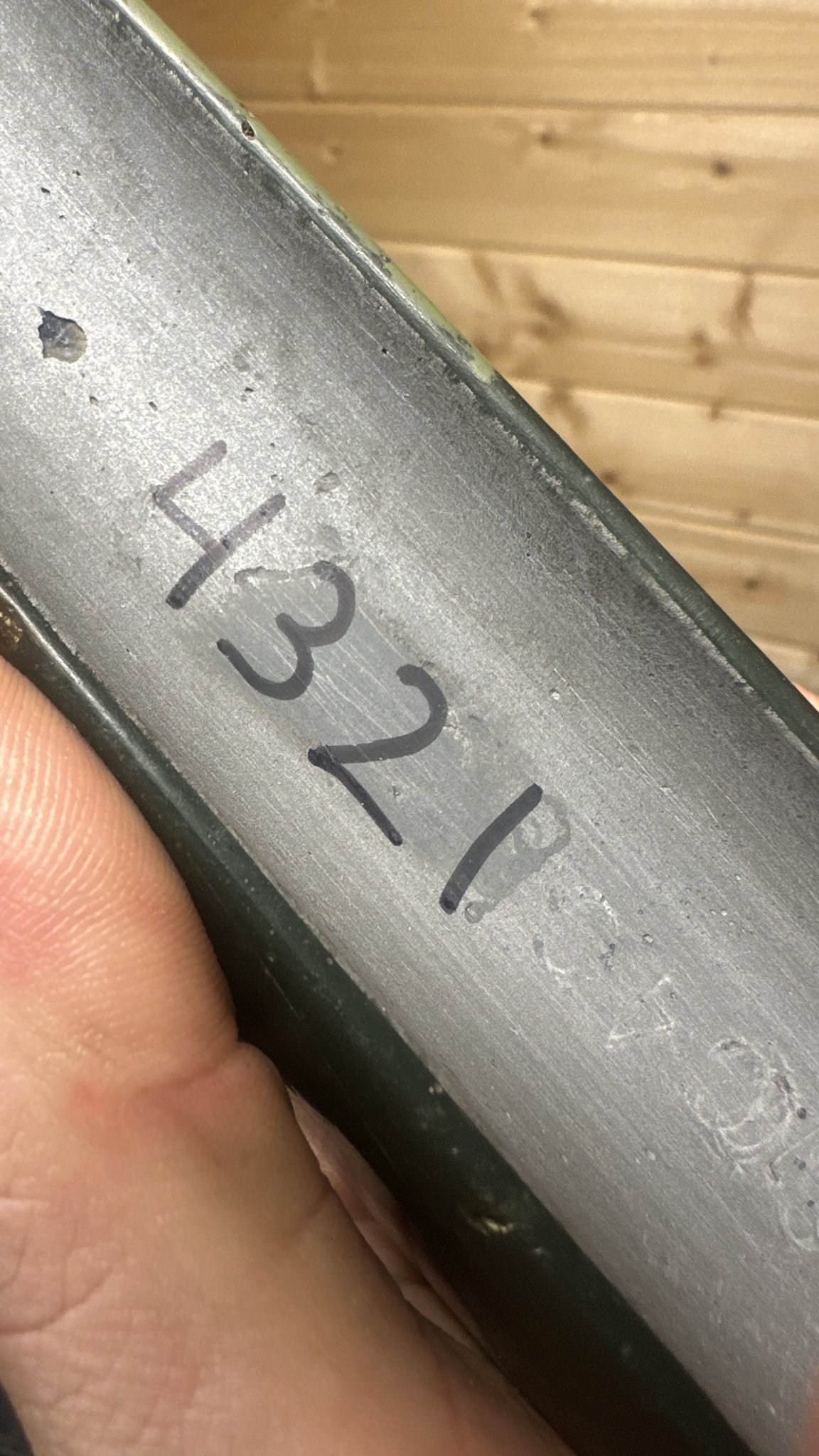

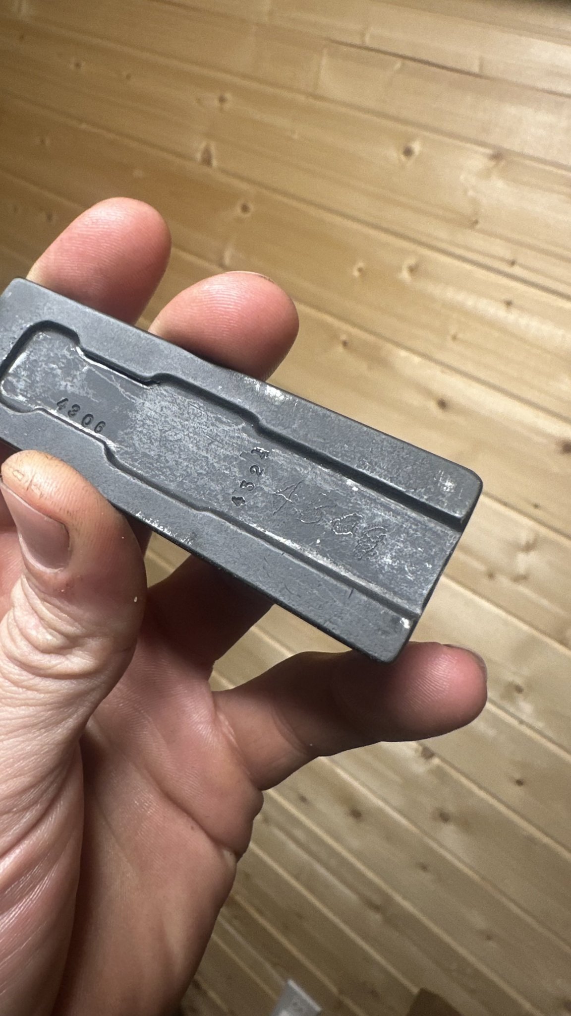

Who ever build my rifle at the end of 2012 at gap removed the original 4306 in the barrel channel. Also, the gunsmith there did not stamp my barreled action with their hallmark (as gap claims they do on every rifle they build).
4309 was etched in the barrel channel and bottom metal. 4306 was written in the channel and stamped on the bottom metal.
Hmm,
The first pic has 4306 and 4321 stamped but (electro penciled?) 4309. To me I was seeing it as an 8 but what if it was a 6 and then penciled over a 9 giving it the 8-ish look to me. Maybe a dyslexic moment? Originally penciled 4309 but meant to be 6 so tried to pencil 6 over it unsuccessfully then got out the stamps ? Then how it ended up 4321 is anyone's guess.
The second looks something ending in 40 scratched in in the fill/bedding upside down compared to the markered 4321.
Your guard is both 306 and 4321. Interesting condition. Maybe someday the Quantico log books will be generally known and it may give you answers as to when the changes happened.
I remember people talking about certain GAP builder's marks so they knew exactly who built it. Someone had a fire hydrant if I remember right. I forget any others.
It’s a 9. The 4321 is my 6 digit actions last 4. The fire plug is Eric Reid stamp. Gap does stamp all rifles. Have been since my first build with them in 2005. Somehow my A1 was not.

The ghost numbering as I like to call them. I just noticed them last weekend when I pulled the action after 10+ year of owning this stock. It’s either a 40 or 43 there
