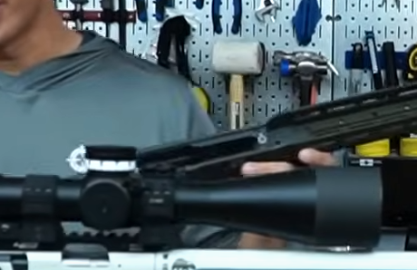

Just watched Impact Shooting's video on the new MDT ACC Premier Gen 2. When he's talking to Paige from MDT she mentions Rimfire in almost all the features. Seems like they really designed this with the Vudoo, RimX, and B14R (and other R700 Rimfire actions) in mind.
Key features mentioned:
  • Lower Price: $999.00 USD
  • Shorter Forend - I know a lot of people are running 24-25 inch barrels these days, but for those still running 20-22 inch it will definitely look and feel better.
  • Stiffer Forend vs ACC Premier Gen 1
  • Threaded Forend Holes - Can use the ACC Elite Mirage Shield and NV Bridge
  • Larger Barricade/Bag Stop
  • Uses same ACC Weights
  • Added Mag Well Dowels - for better fitment with Rimfire Mags (RimX & Vudoo mentioned)
  • Wider Thumb Shelf/Rest
I think this is a cool update to a great chassis. Not sure if I love that they shortened the forend by 3 inches, but it definitely makes it a little more appealing to those running "shorter" 20-22 inch barrels. The fact that the feature are so focused on Rimfire is great news for the rimfire community. I'm sure we'll see them come out with a CZ 457 version pretty quickly as well. I think this might actually be the chassis CZ is going to be offering in their new CZ 457 MDT they showed at Shot Show.
Edit: I originally thought they might already have it and showed it with the 457 in the CZ booth, but looked at the video and it's definitely the Gen 1 ACC there.

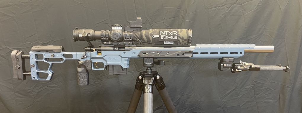

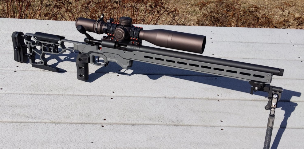

I own a Gen1 ACC Premier and it's a good chassis, but it definitely a bit more centerfire focused in terms of balance and the forend is definitely not as sturdy as I would like. That was one of the more noteworthy improvements on the Gen2. I think if you want to run a shorter 20-22 inch barrel then the Gen 2 makes a lot of sense. The ACC Elite and Gen1 Premier are really long and look a little funny with anything shorter than a 22 inch barrel (in my opinion).
ACC Premier Gen 1 with 20 inch barrel
ACC Premier Gen 1 with 22 inch barrel
I would completely rule out the Gen 1 ACC at this point. It just doesn't have the features or benefits of the Gen2 or Elite that would be good for Rimfire (Namely the forend rigidity/weight, magwell dowels, and larger barricade stop). The longer forend of the Elite would be nice if you're running a 22 inch barrel and still need weights for balance. Since you can get them further out, you won't need as many for balance (unless you want a 20lb rifle). I had my 24 inch 1.20 straight barreled Vudoo in a MPA Matrix Pro (similar weight as the ACC Elite) and it still required some weight out front to balance. Made the rifle a full 20 lbs. The ACC Elite does has a longer forend than the Matrix Pro (16 inches) and ACC Premier (gen 1 - 18 inches & gen 2 - 15 inches) at 19 inches. That extra length is just weight out front which is always good for balance.
So TL;DR - I would pick the ACC Elite for the best possible balance and largest feature set. Since you're not worried about the slight cost difference, $800 vs $500 with your 50% off. I would go with a 24 inch barrel. They're not that crazy to maneuver around vs a 22 inch IMO and you'll get much better balance out of it.

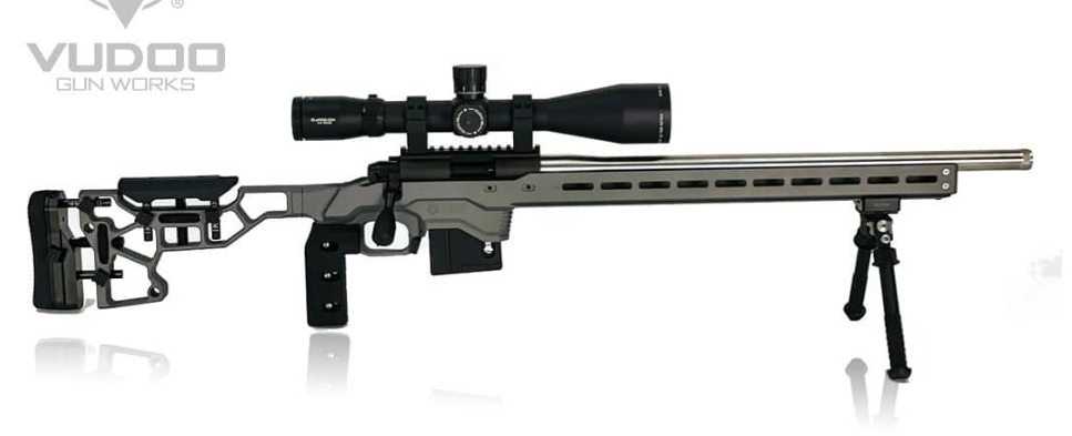

This is @J_D 's rifle (Vudoo 24 inch 1.20 or 1.25) in the ACC Elite. I think he said it balanced without any weights but I forget. Maybe he can chime in on the balance and weight.

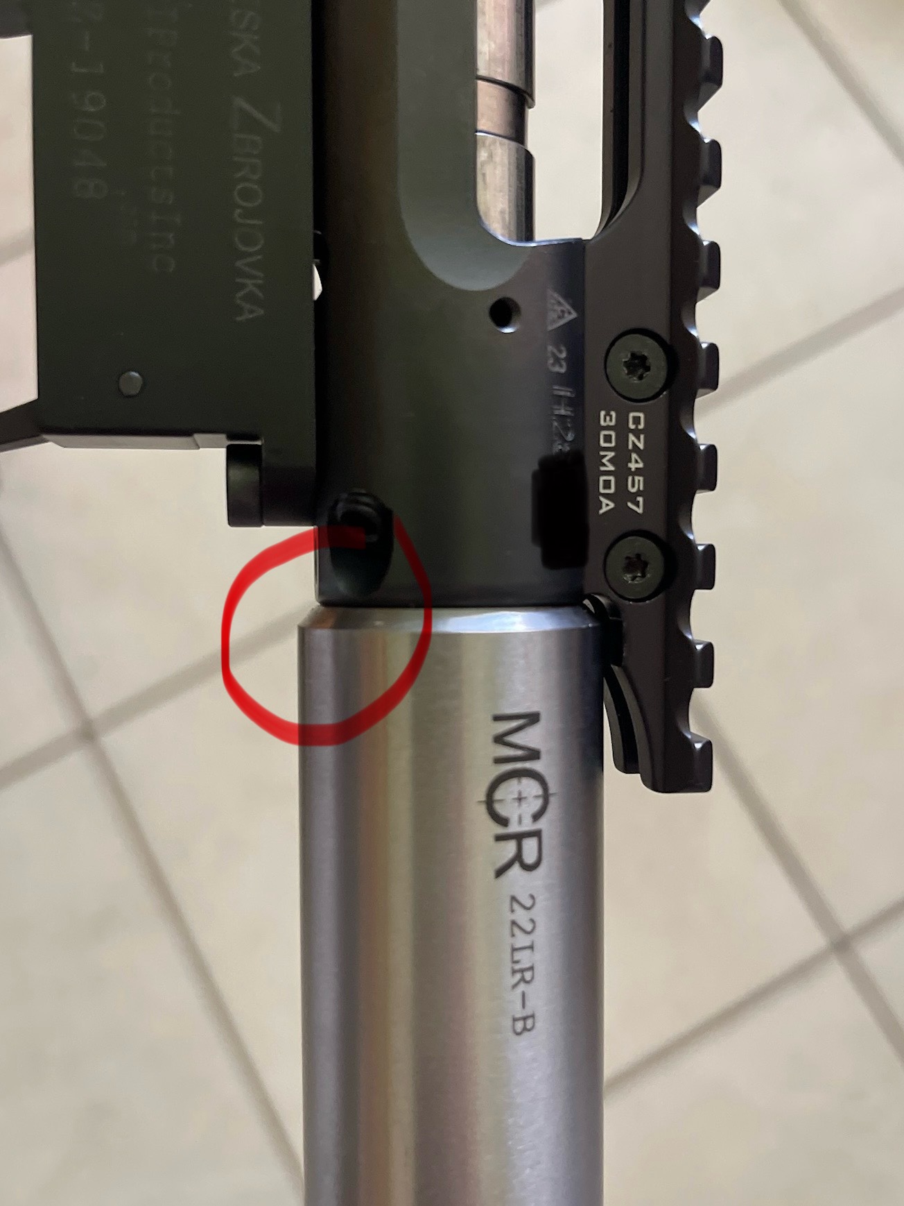

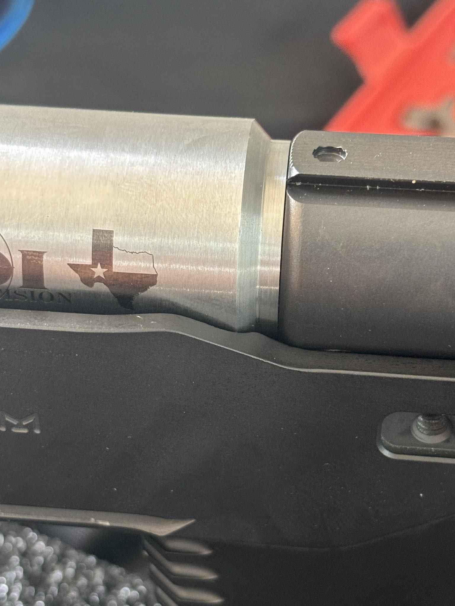

But what about the area of concern? Grey Birch told me the same. It can fit 1.25” but they didn’t account for the action area.
I can almost guarantee they thought of that. I'm almost 100% positive others have used a 1.25 on their Gen 1 ACCs and the inletting should be very similar. I can't find any good pictures but you can kind of see the inletting on Womfat's video where he's talking about his wife's new rifle.
You can see the V-Block ends right after the front action screw and drops down. So any oversized barrel wouldn't contact the chassis.

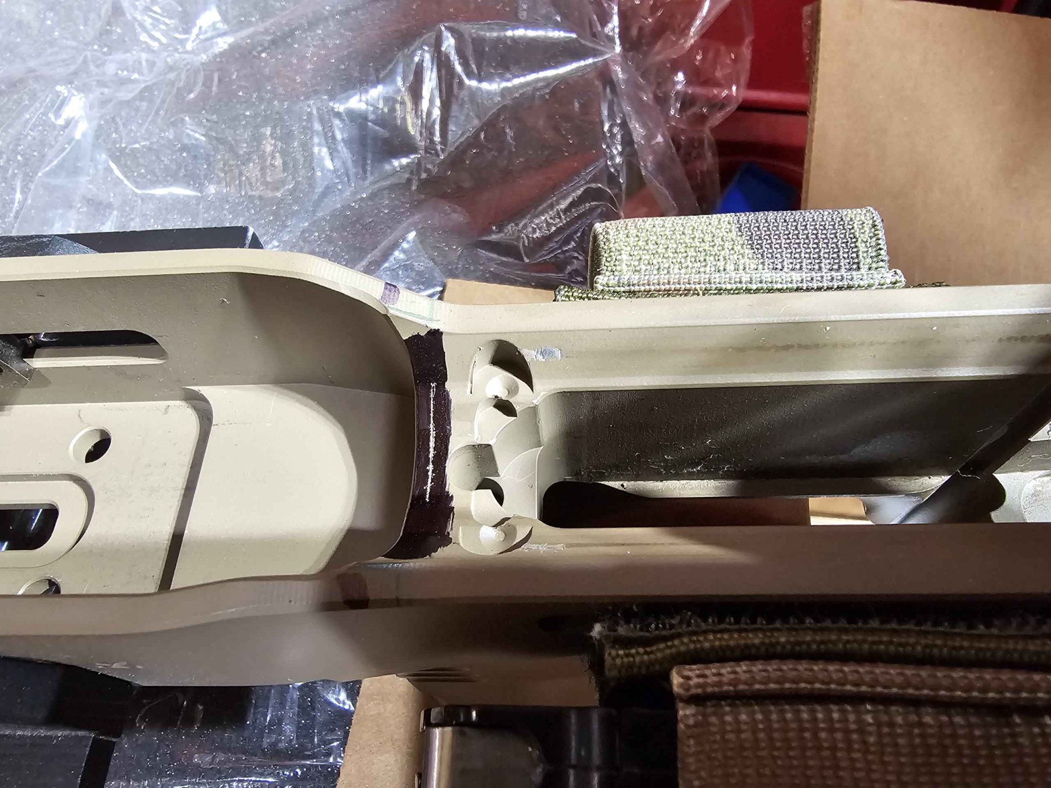

Apparently I was wrong. One of the guys who runs a 1.180 on the Gen 1 ACC said he had to clearance a small hit to get it to fit.
The area marked in sharpie had to be ground down a bit. However, Matt (Womfat) said on his channel when he was reviewing his wife's build was that MDT had to change the inlet because they hadn't contemplated the increased size of barrels for the CZ platform, so they were modifying the chassis to accept 1.25 barrels without modifications.
Reactions: 021411
Good to know. Yup CZ barrels are getting thicker now just like the others.
Talked to MDT again. It sounds like they've done their best to allow for a 1.25 barrel to fit without any modifications. However, they said it will really depend on how the barrel was machined where it joins to the action. I could only get so many details, but it sounds like ones that are chamfered at the shoulder will probably fit. Some barrel manufactures will do this which definitely clears:

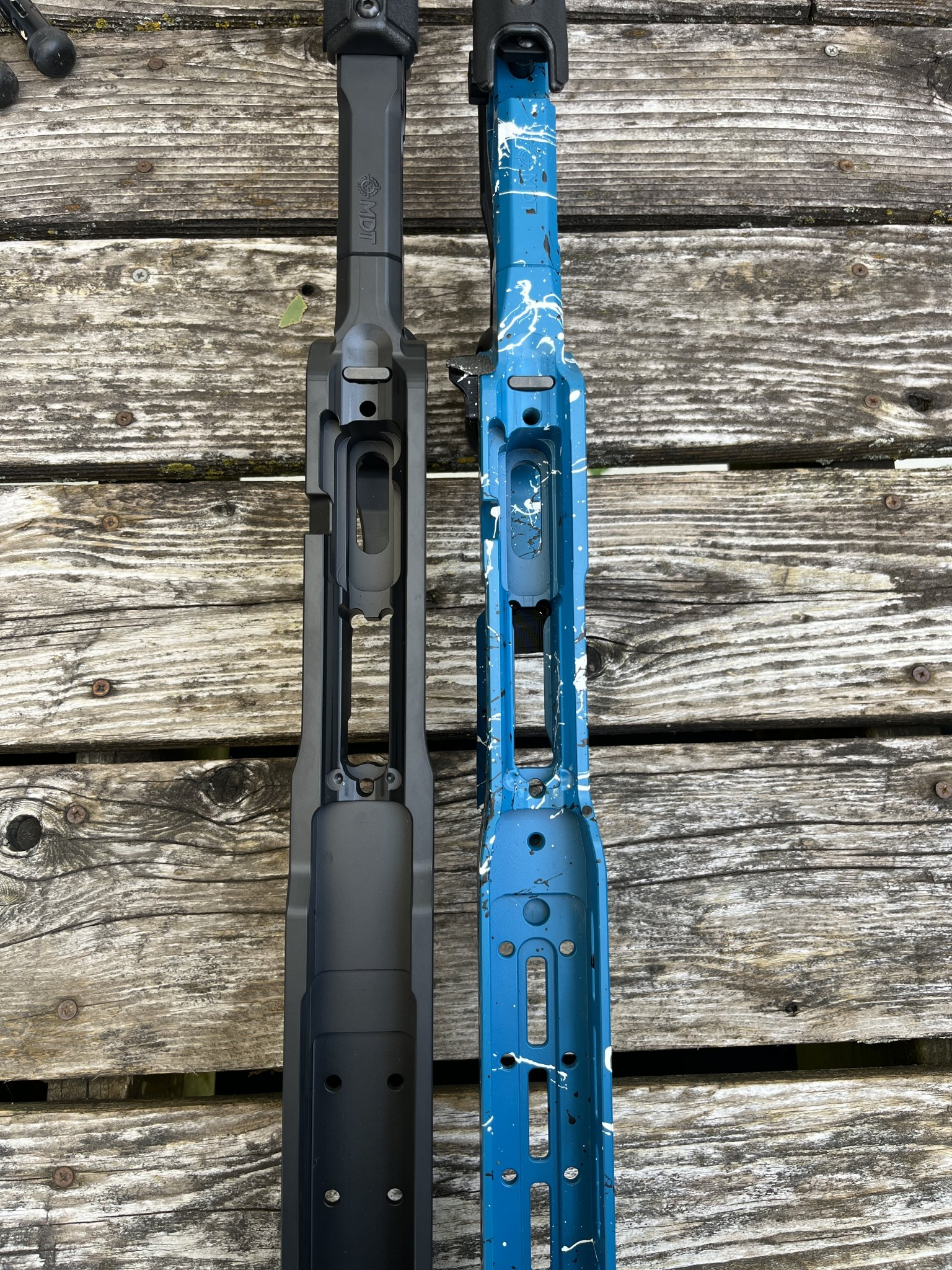

Do you know if the new CZ 457 Gen 2 will allow a 457 with a 1.25” barrel to bolt down into the chassis? Pictured is the area of concern. Life would be much easier if it did.
We have made a modification to our inlet to account for the new, threaded 1.250" diameter barrels coming out of some gunsmiths shops, however, that is not in production yet and the first run WILL NOT FIT WITHOUT MODIFICATION. We are just validating that our modification will work, then we will roll out the new revision such that all of you wanting to run larger than action diameter barrels will be able to without any machining, dremeling or otherwise required.
Side note; a 1.250" diameter barrel is not advise of you have not threaded your action as the two set screws are not adequate at holding that barrel into the action!
- Josh
@021411, @Fester47 just shared this image from @1911Shootist in a discord group that I totally missed. Gives a great view of the inletting on the new CZ 457. Given they're making some changes to the next batch, I would be pretty confident that you wouldn't need much if any modification to fit your barrel: Update: @MDT_Josh let me know that this is actually the updated inlet design. I can see how this new design gives a lot of clearance for larger barrels. We'll have to wait and see what different 1.250 barrel owner's experiences are with it down the line, but there's a good chance the 1.180 crowd won't have any issues.
MDT ACC Gen 2 for CZ 457 left (updated inlet) - MDT ACC Gen 1 for CZ 457 Right
Yeah, I was hesitant to post this in response to the question as I knew it is a pre-release chassis and these things are subject to change. MDT was generous enough to donate the chassis to NRL22 Nationals, I didn’t want to complicate things for them unnecessarily.
You're welcome and it's cool that we can find out where our first production chassis has ended up! That cutout in front of the bedding should be plenty large enough to clear 1.250" straight barrels without any additional inletting, and provide a spot to bed the front of the receiver/barrel if you so choose as well.
