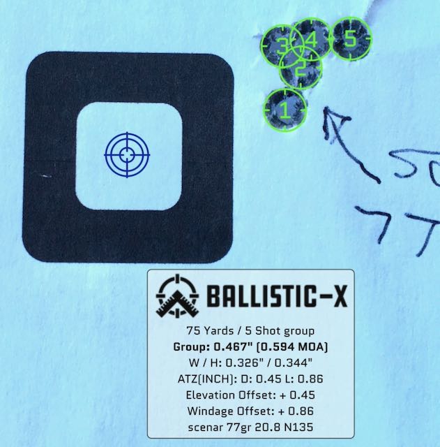

So I'm shooting .223 Remington for the first year, as I have reload components, a Tikka T3X CTR, Vortex Viper PST GenII 5-25x, and Harris bipod.
Not having much luck with Hornady 75 grain ELD Match projectiles; I can get the SD into the single digits, but they just don't group as I had hoped. Now experimenting with some 77 & 69 grain projectiles. I'm hoping to pick up some gems of wisdom from the Hide members. I have been impressed with the podcasts.
Have you played around with the seating depth? This will reduce the bullet jump and you should find a node where the groups are very tight. Have you measured the distance to the lands? The experts (i.e. Erik Cortina) recommend starting 0.020" short of the lands and then make cartridges that are seated in 0.003" increments shorter than that. Shoot groups and you should see that some groups are far tighter than others. What you're doing is altering the bullet jump distance between the brass and the lands. This is not a situation where the shortest distance is best. It's about finding a dimension that results in a harmonic node where the barrel's deviation is as close to zero when the bullet exits the barrel.
As an example, I measured my bolt action 6.5 CM rifle and found that the lands dimension represents a COAL of 2.847" compared to the Hornady 140 gr ELD-Match factory ammo at 2.800". I then subtract 0.020" so the longest cartridges I make have a COAL of 2.827". I continue reloading cartridges with various seating depths that represent COAL dimensions of 2.827", 2.824", 2.821", 2.818" and 2.815". (as a side note, even the 2.827" cartridges fit in my AICS magazine) With IMR 4350, my rifle's sweet spot is a COAL of 2.824". With H4350, it's 2.821".
When you finally are able to buy a bullet seating die, spend the extra and get one with a micrometer adjustment. I love my RCBS Matchmaster seater die. You dial in the seating depth and then drop the bullet into the die through a window instead of placing the bullet on the case.
I haven't done much with seating depth yet. I have determined distance to lands, I tested most loads at .030 less than that. I have also tried some factory loads of Match ammo which all are way shorter. I'm not getting significant differences, but will experiment with seating once I find a projectile the rifle likes. Magazine length is not an issue as the CTR las a long mag capable of feeding any length ammo.
Well my CTR in .223 Remington may not like Hornady 75 gr ELD Match projectiles, but it does like Lapua Scenar 77 gr. Tried some test loads about ⅔ way up the load range and it grouped just over ½ MOA. I'll do a formal load ladder, and then play with seating. Still a mystery why it doesn't like the 75 ELD's.
