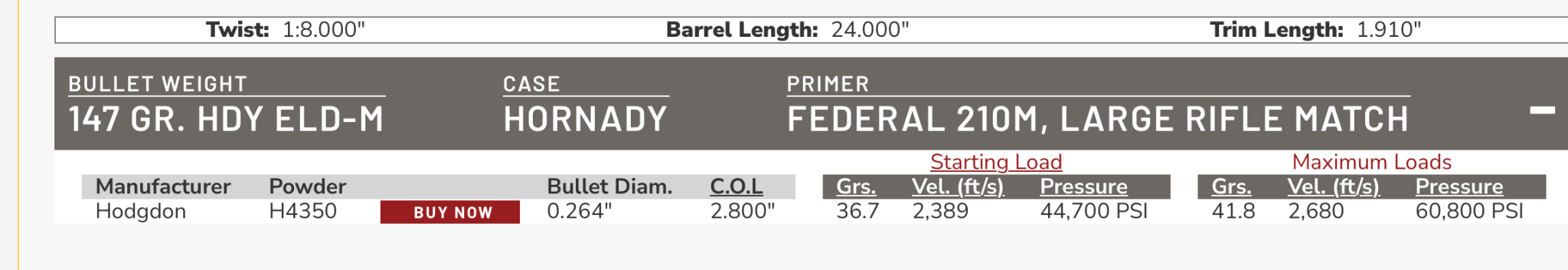

Speaking of chasing velocity, I feel like I'm not blindly chasing the speed here. All I was wanting was a load at least 2600+fps, granted it's kind of on the higher end. Do you think that's too high for 147gr? I'm really hoping that might next range session shows repeated good results to allow be to settle on a final charge weight.
Here's some of Hodgdon's load data, likely conservative like most publish load data.
LOL I guess my thought on loading for the 147gr bullet was to give it SOME gas, though not too much, so that the end result wouldn't be equivalent to lobbing a brick.
