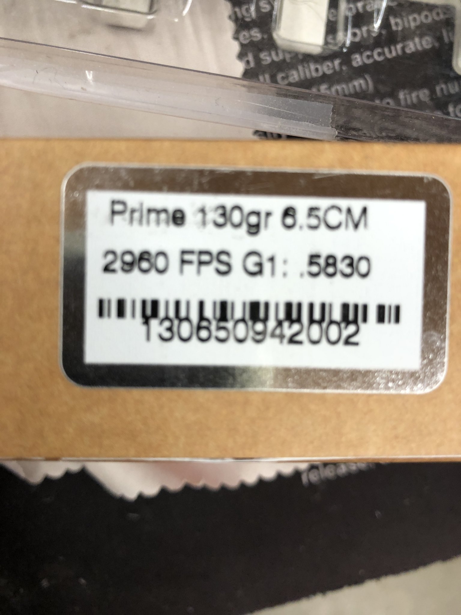

    I got a couple cases of Prime 6.5 CM and zeroed my rifle in. Shoots great, I had set my ballistics App up last year from the data on the box, 130 grain bullet at 2850 fps.
    Box has a sticker on the side with lot number and 2930 fps, Web site says using 140 grain Berger bullet. I just want to know which numbers to use. (I don't have a chrono to check velocity myself) Sorry if this the wrong forum to ask this in, but if anyone knows the answer I would appreciate it.

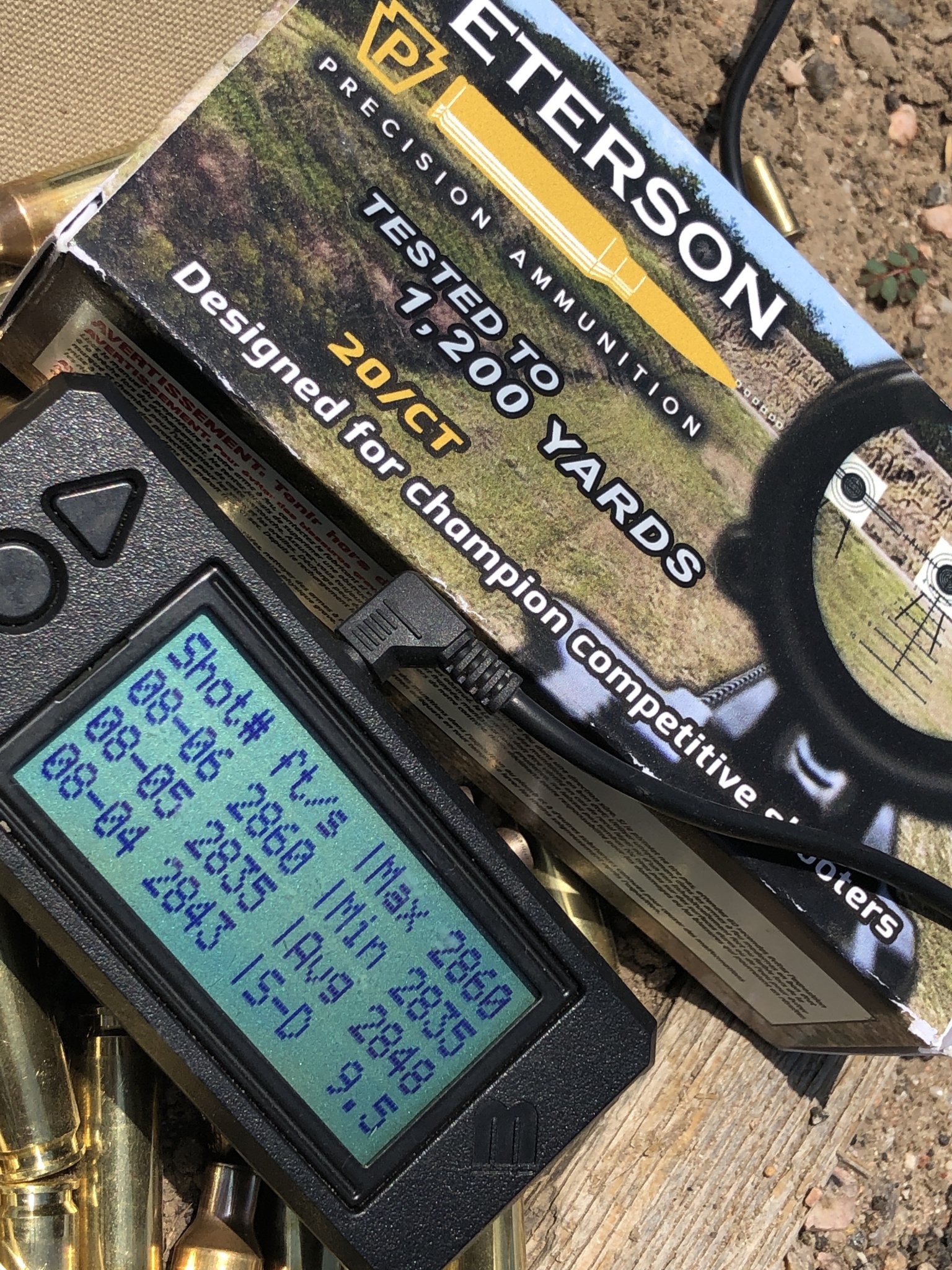

    There was a Peterson / Spark load Prime was looking at with the 140s that was over 2800fps

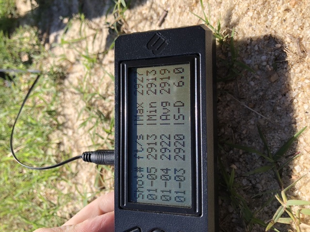

    The 130s would be in the 2900s but there is a 140gr load going close to 2850

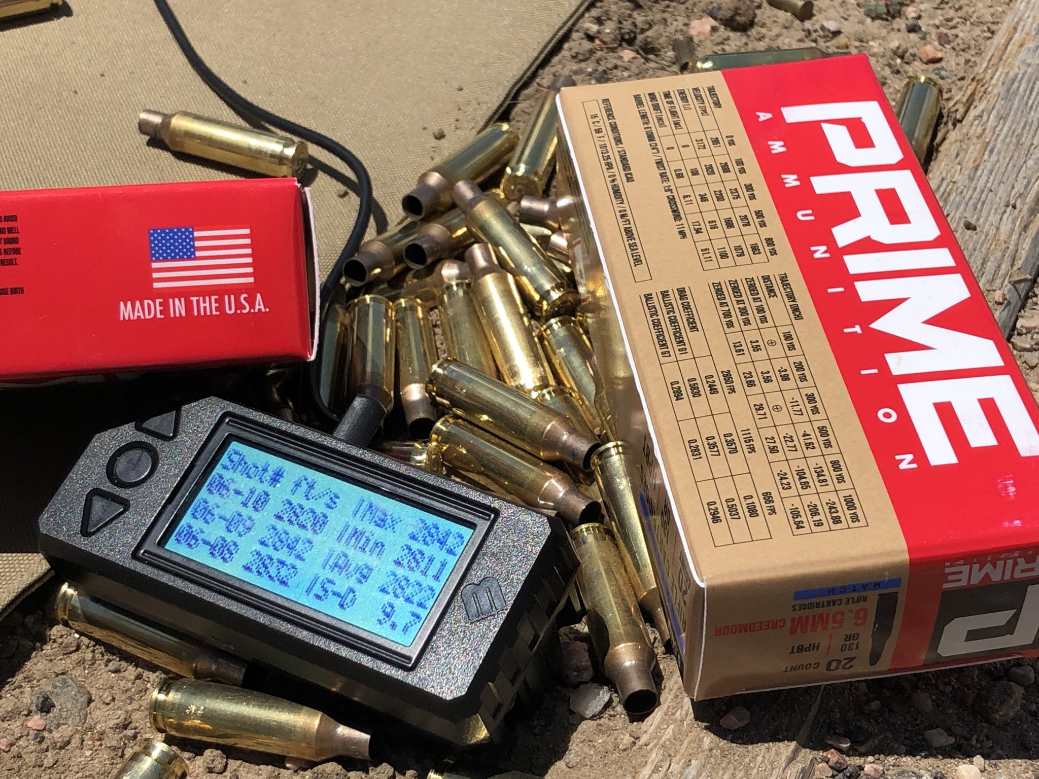

    The Prime Box is the 130,
    Then in testing we had a 140gr load going similar speeds
    But 2900 is the 130gr velocity in a lot of rifles

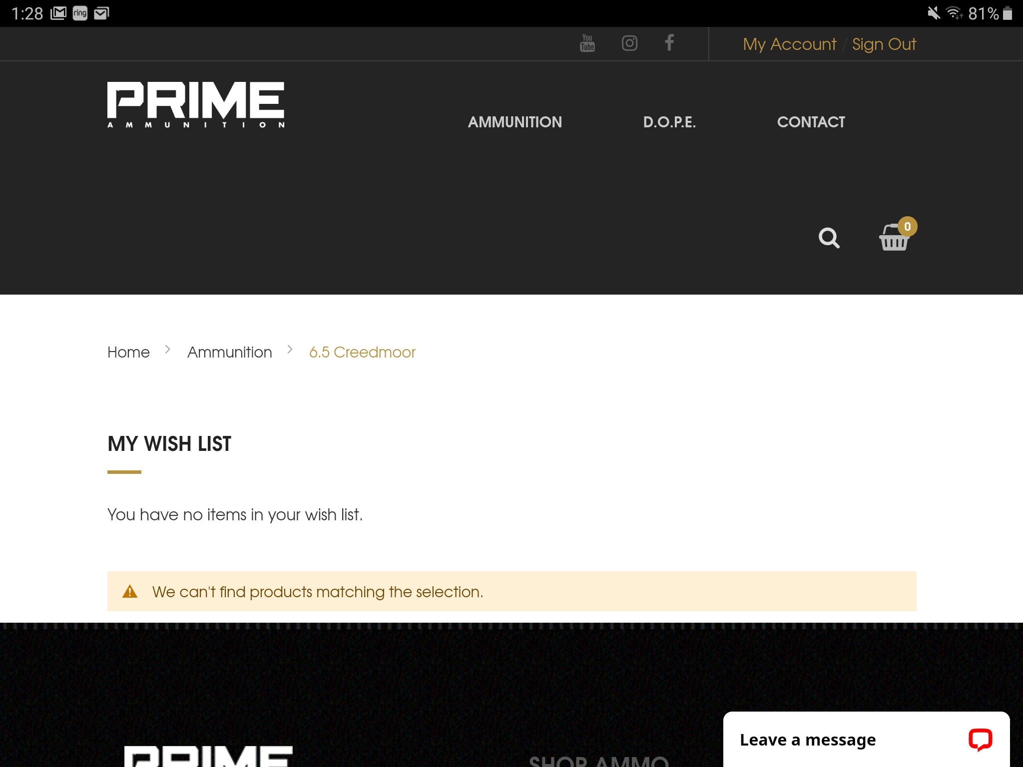

    I was looking on the site, seems like all the 6.5CM stuff is gone? What bullet is in the 6.5CM new usa recipe, I thought the SMK?
