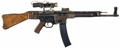

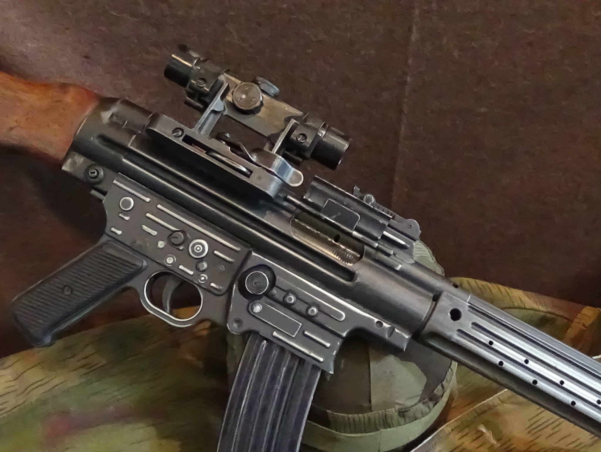

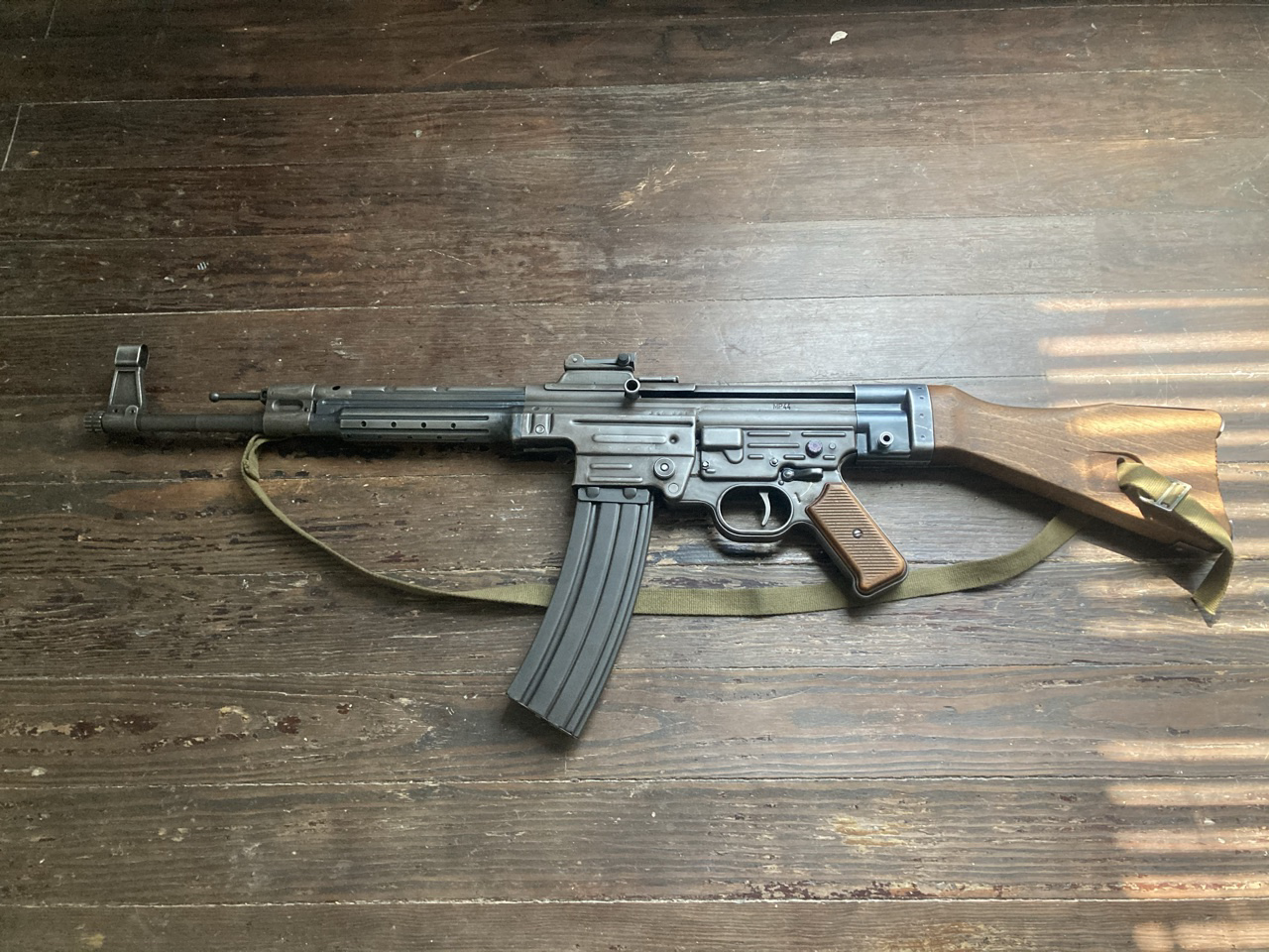

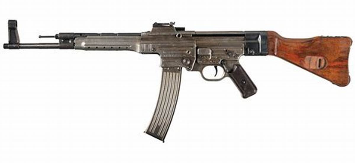

    My next project, an MP44 in 5.56

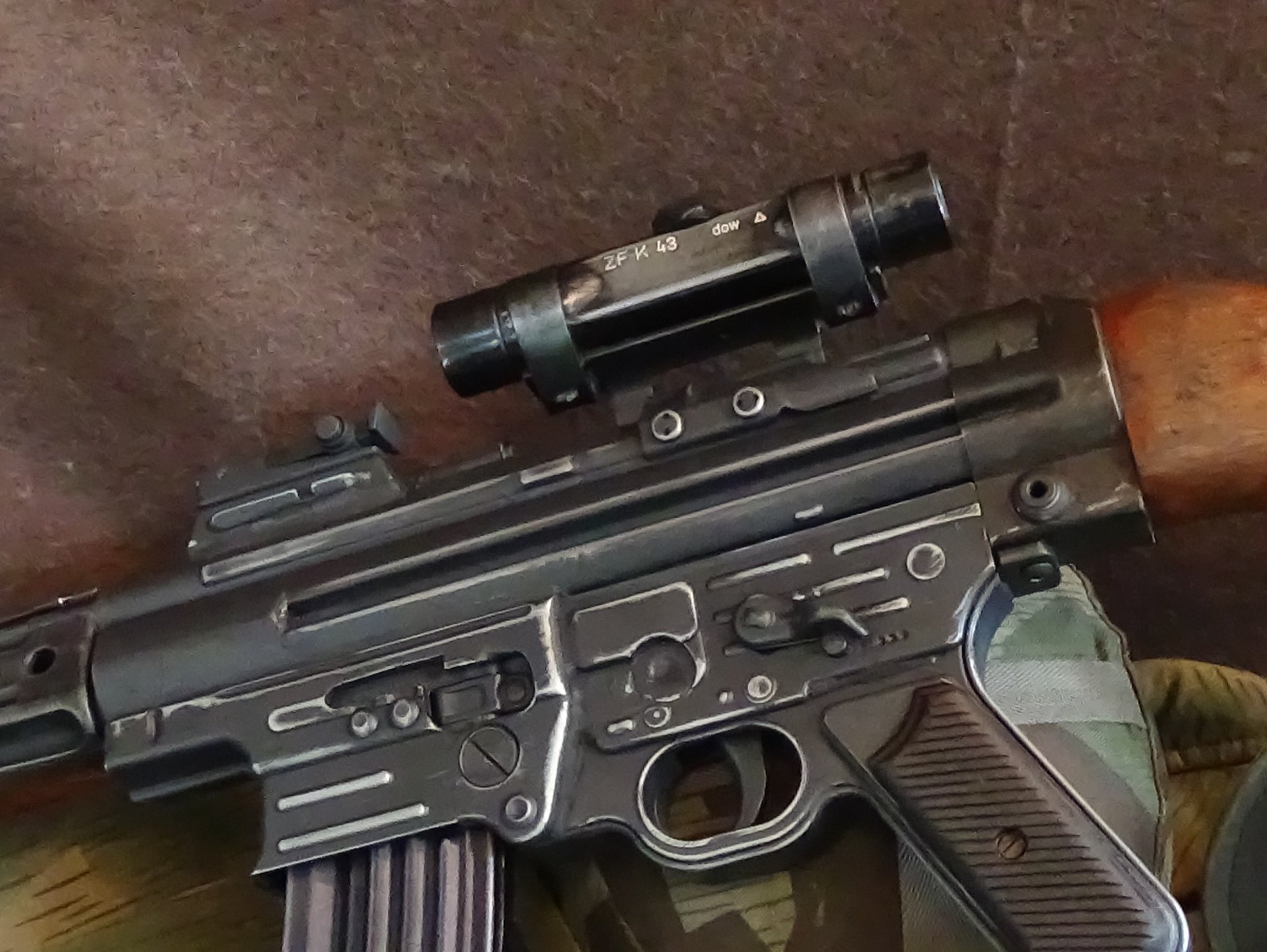

    And I'll put one of these scopes on it

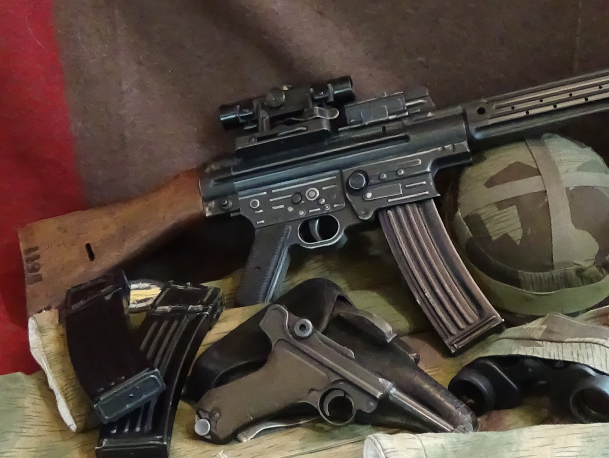

    I even have a Vampir night scope for it.
    Probably the most famous MP44 pic

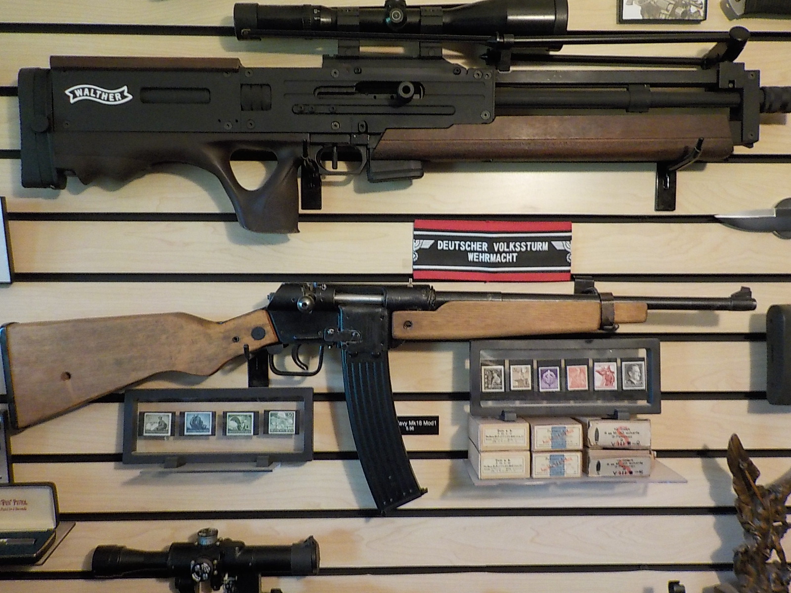

    And the Volkssturm
    and an interesting note, Volkssturm with the VG1-5
    My VG1-5 in 9mm
    And a nice pic of Volkssturm with the MG-15. I have a deactivated MG-15 that I might turn into a semi-auto.

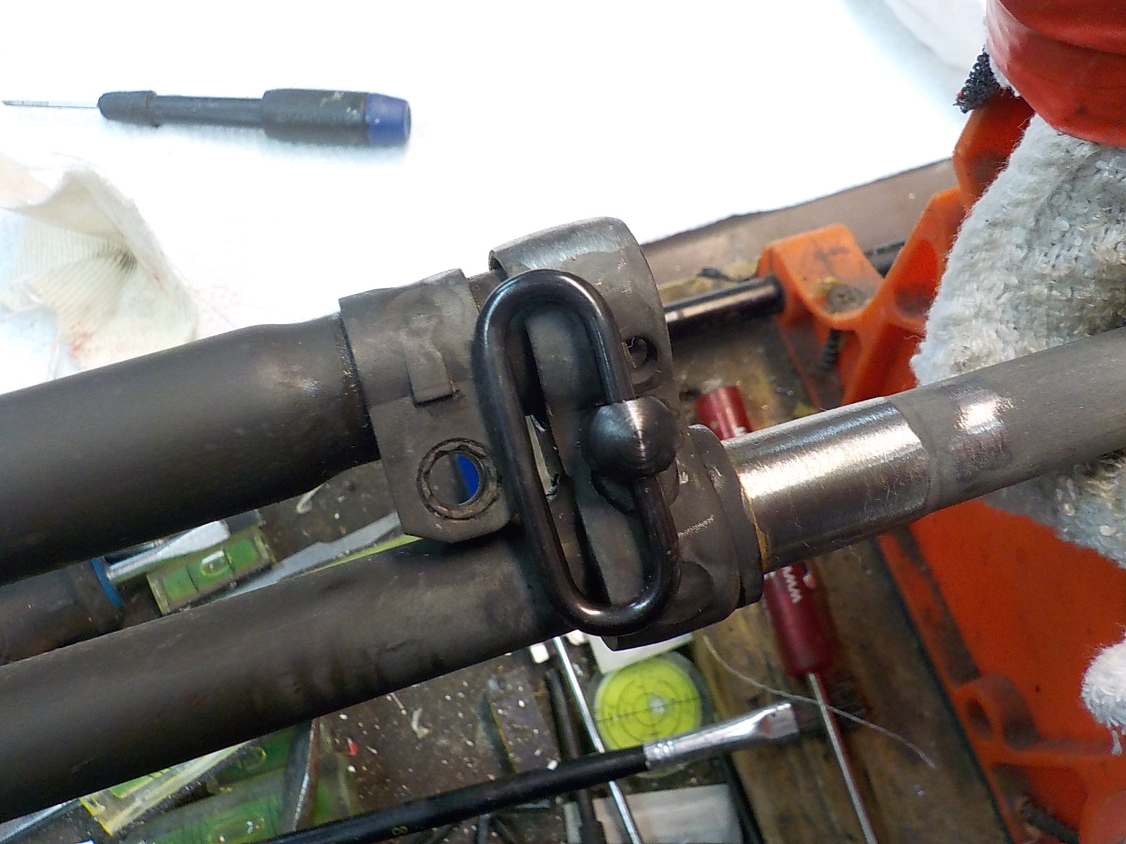

    I've been inside this genuine MG15 tripod. I'll see if I can scan a couple of old photoes I took on the inside.
    View attachment 8144585View attachment 8144586

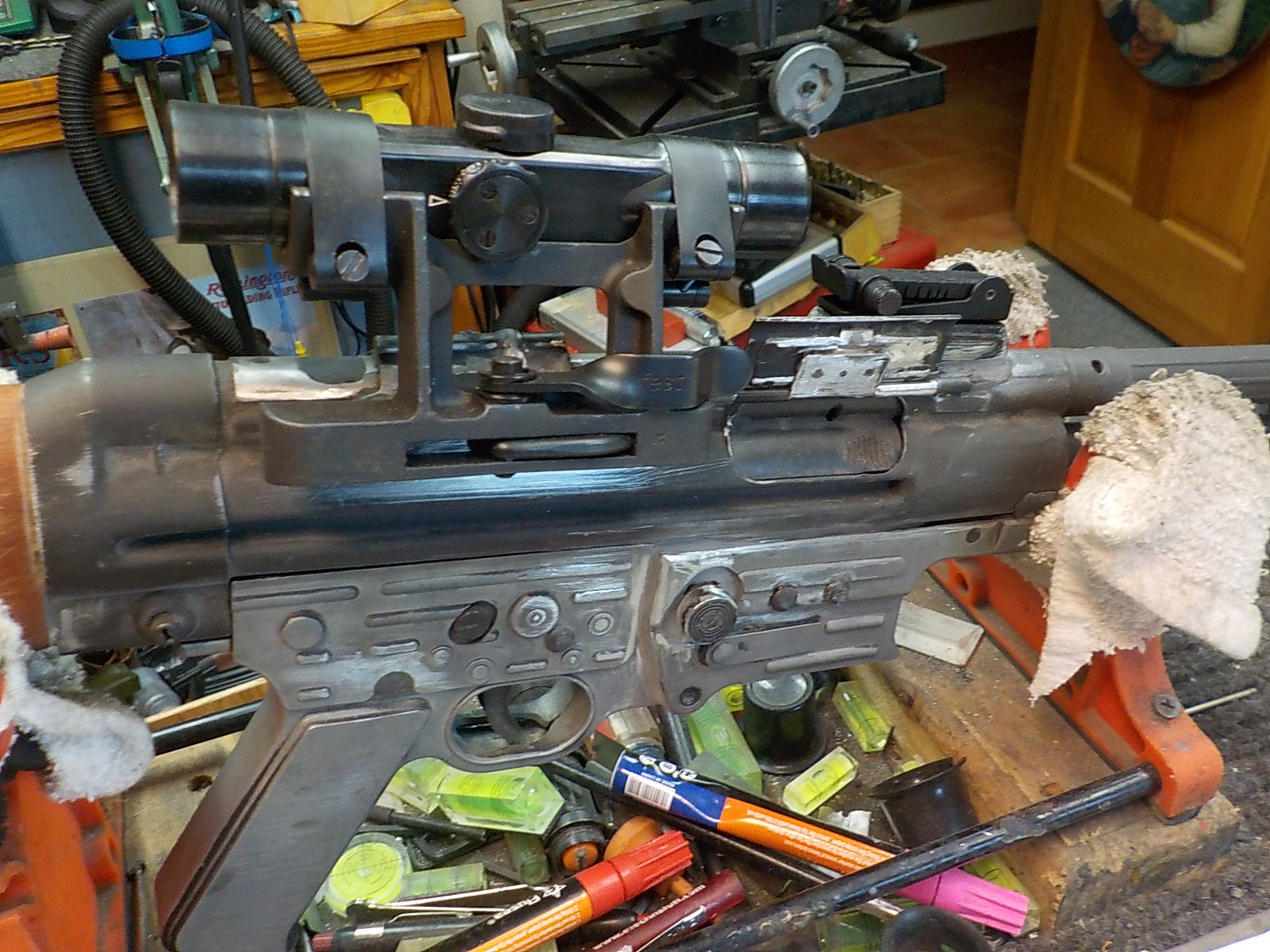

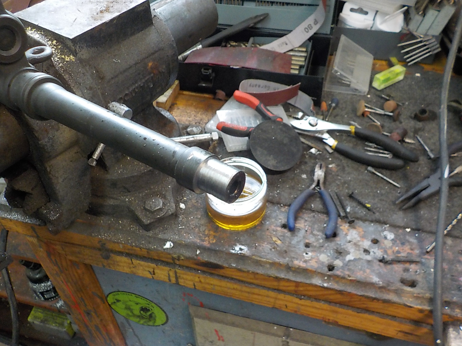

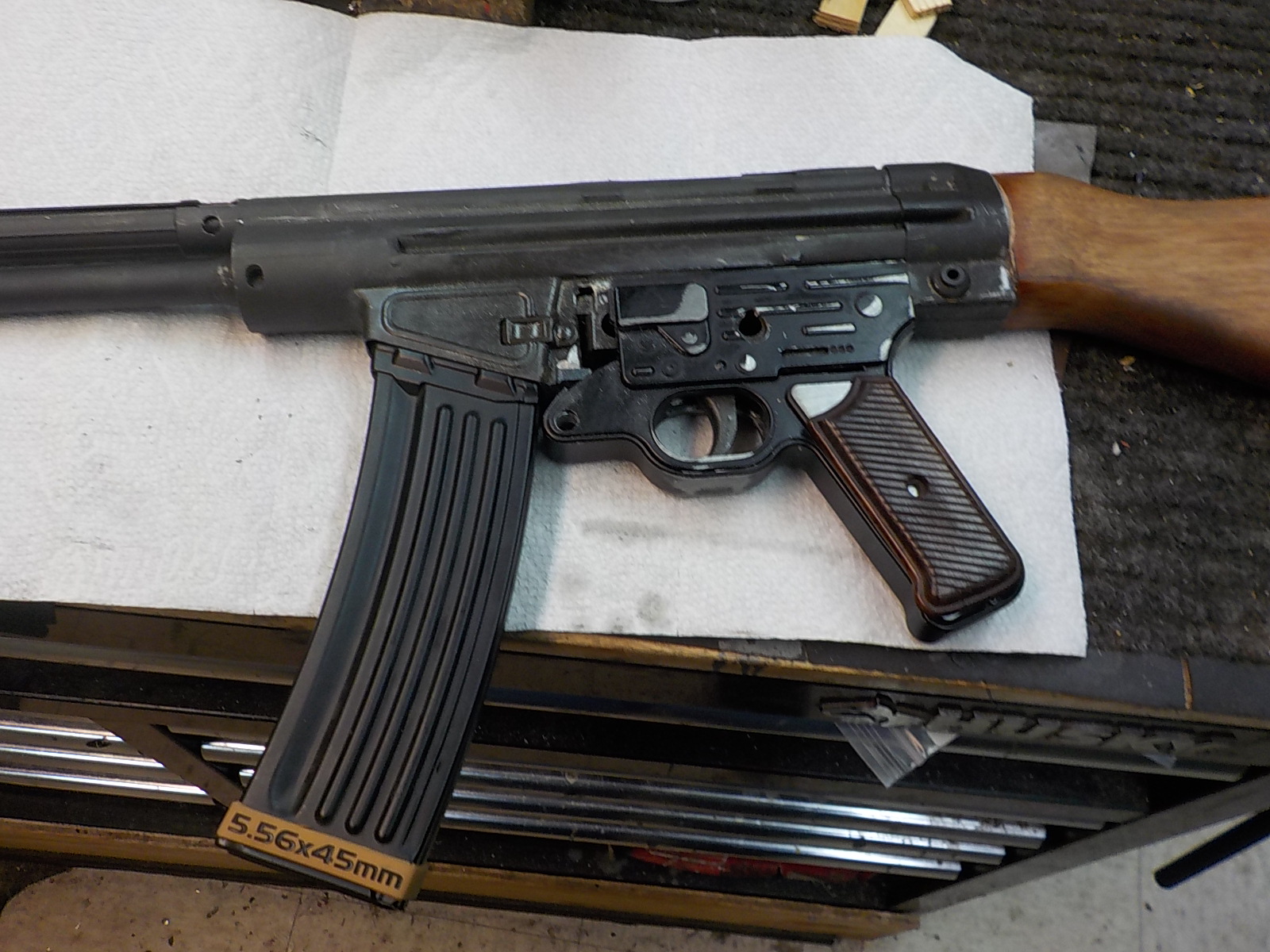

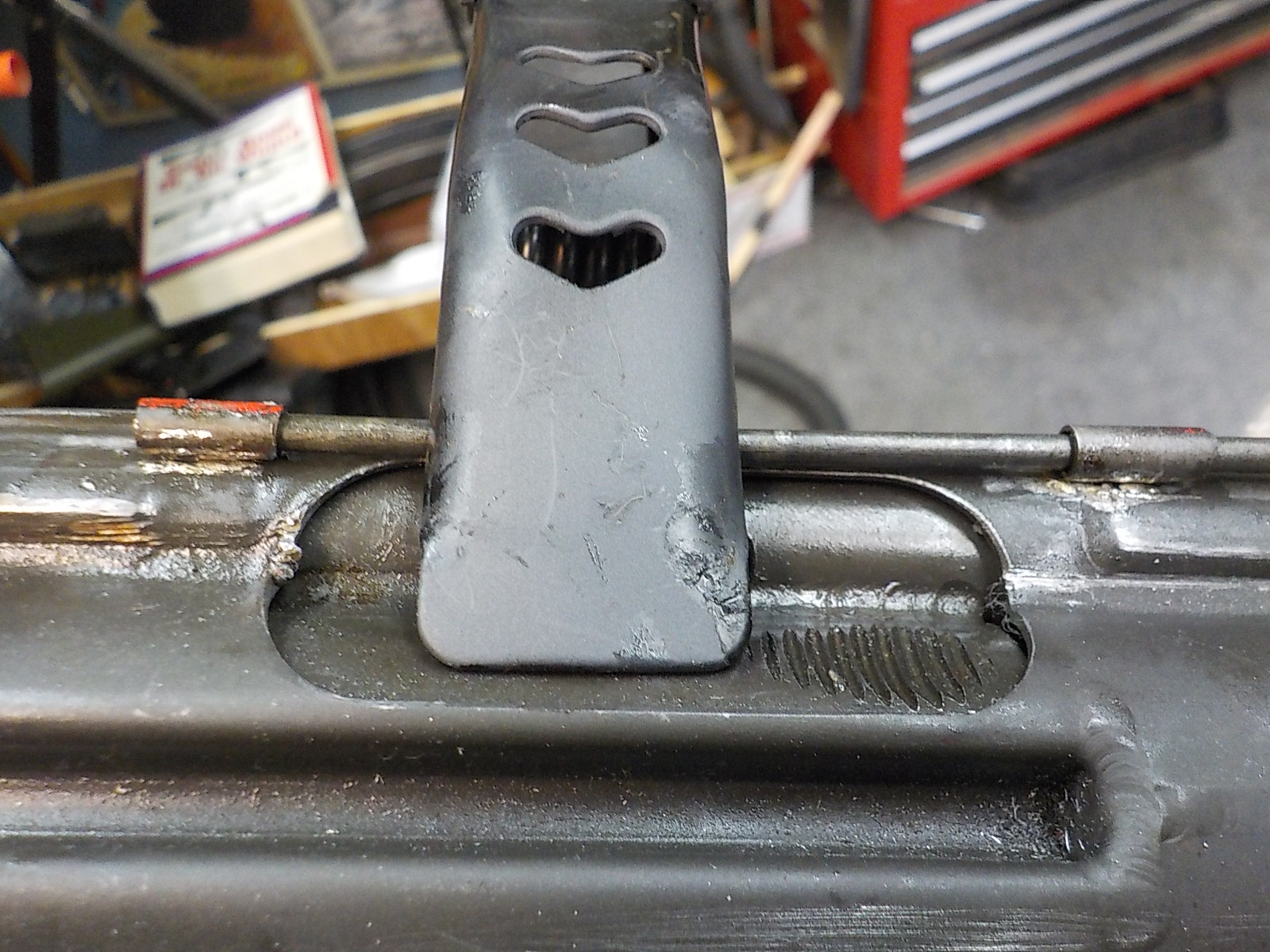

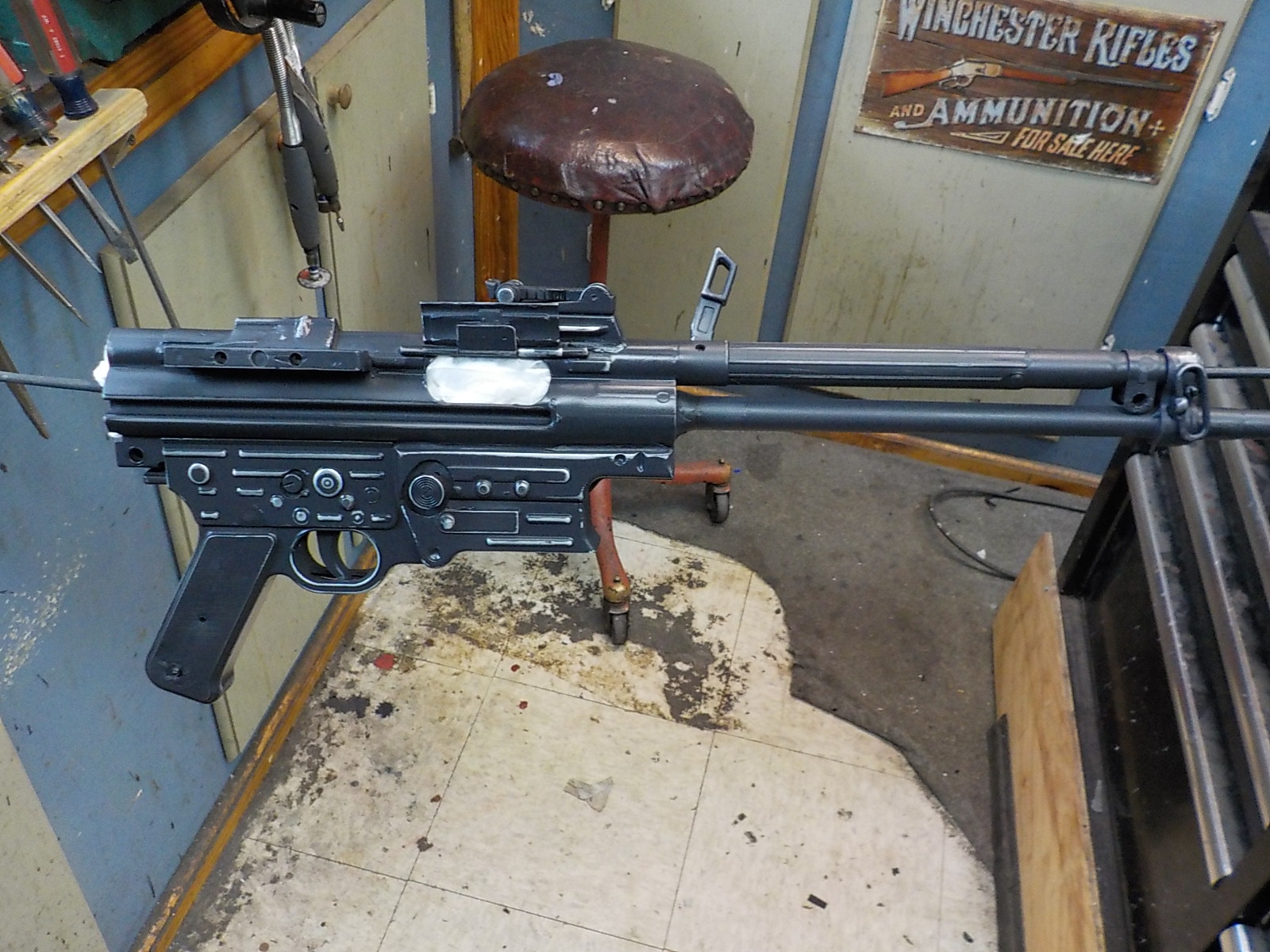

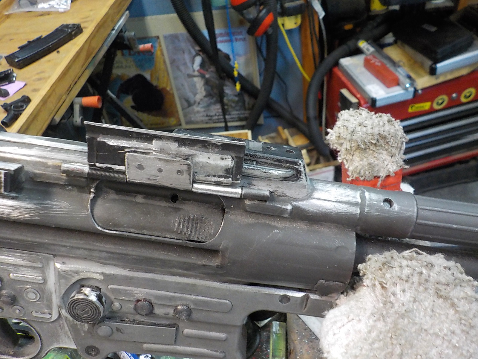

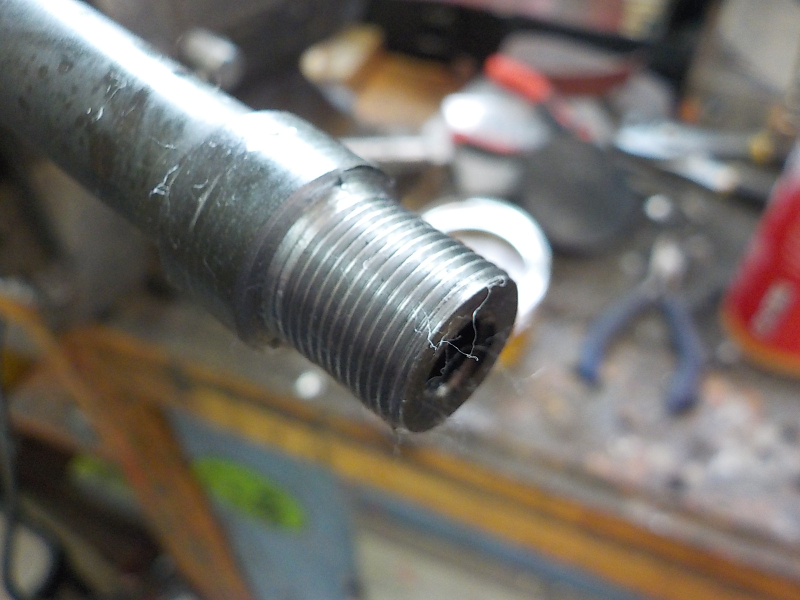

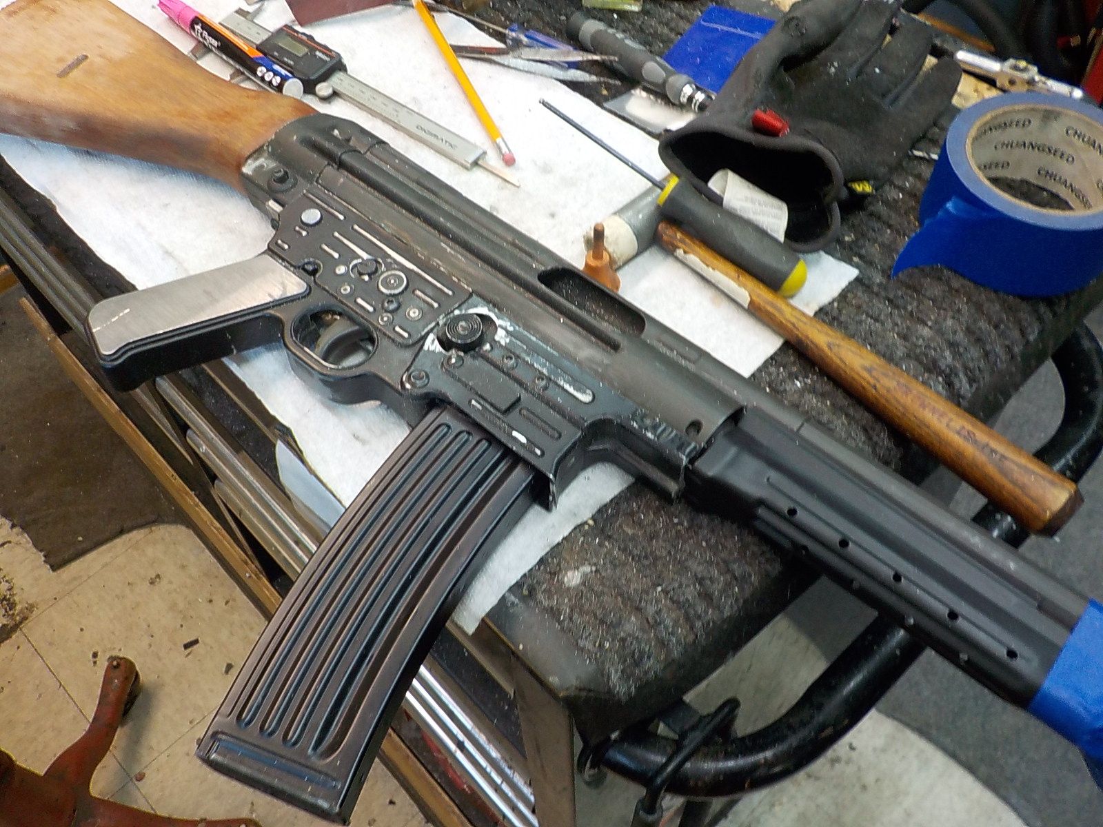

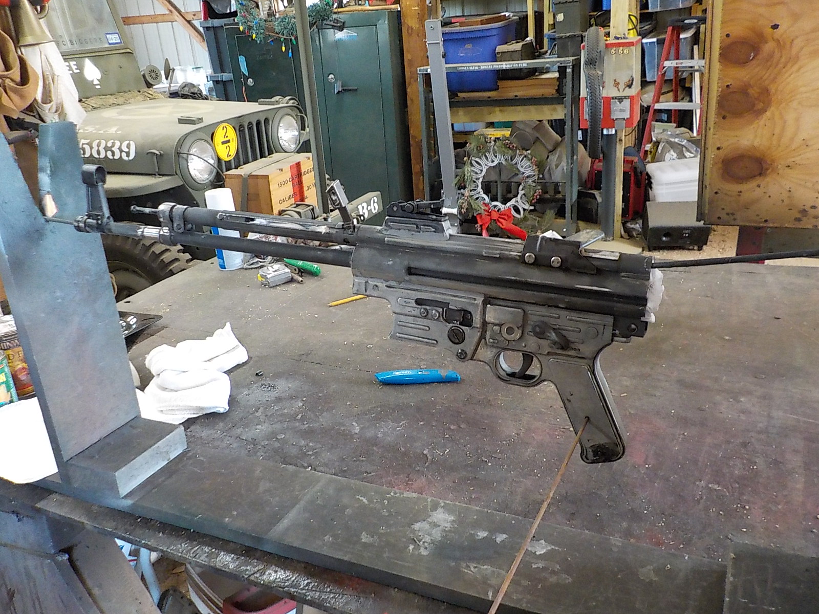

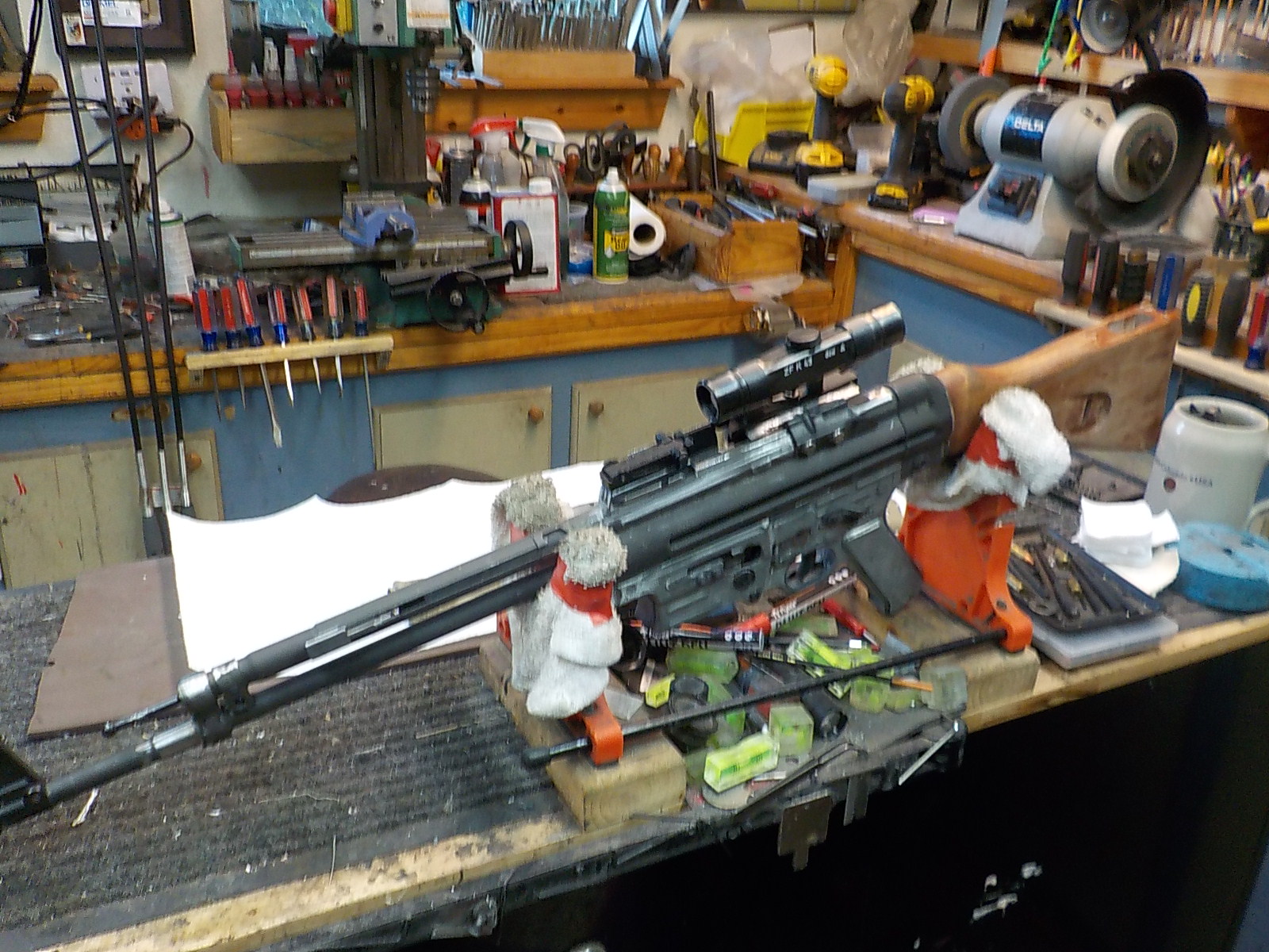

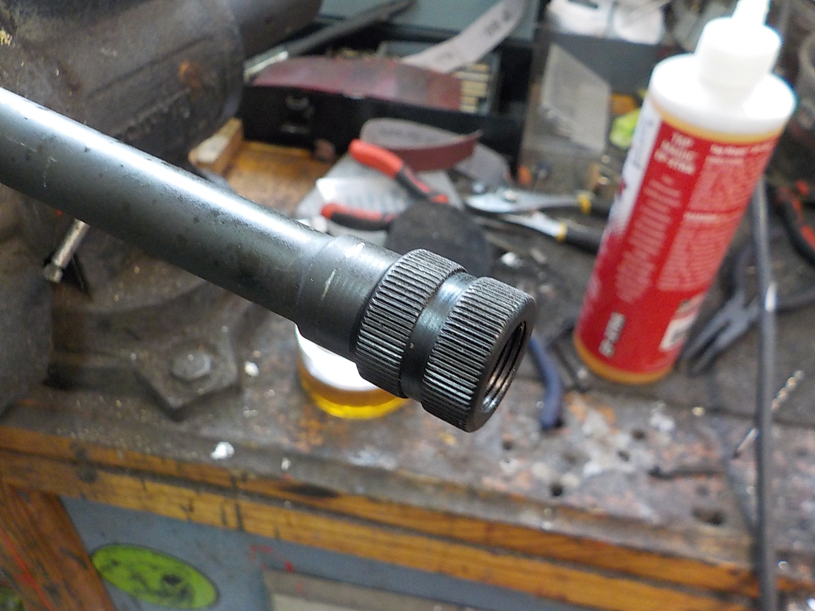

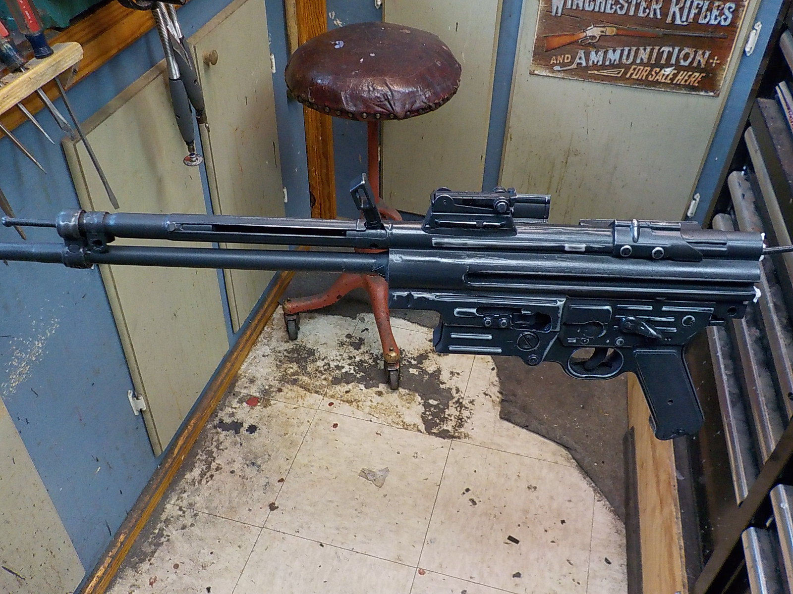

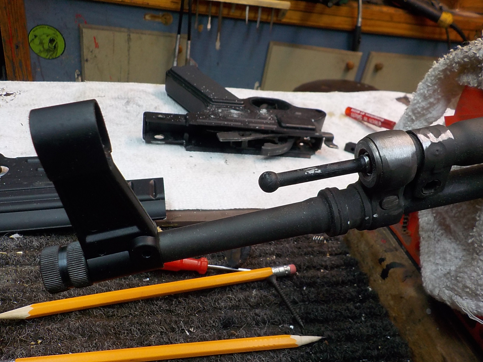

    Gas tube, front sight and barrel nut. This is going far too well and too fast. Got to start thinking about a new project.
    Reassess before it goes too far and find a way to make it calibre-convertable between 5.56, 7.62 Soviet, .300 BLK, and 8mm Kurz?
    In other words, get ahead of the PSA/HMG game before their vaporware rifle even starts production!

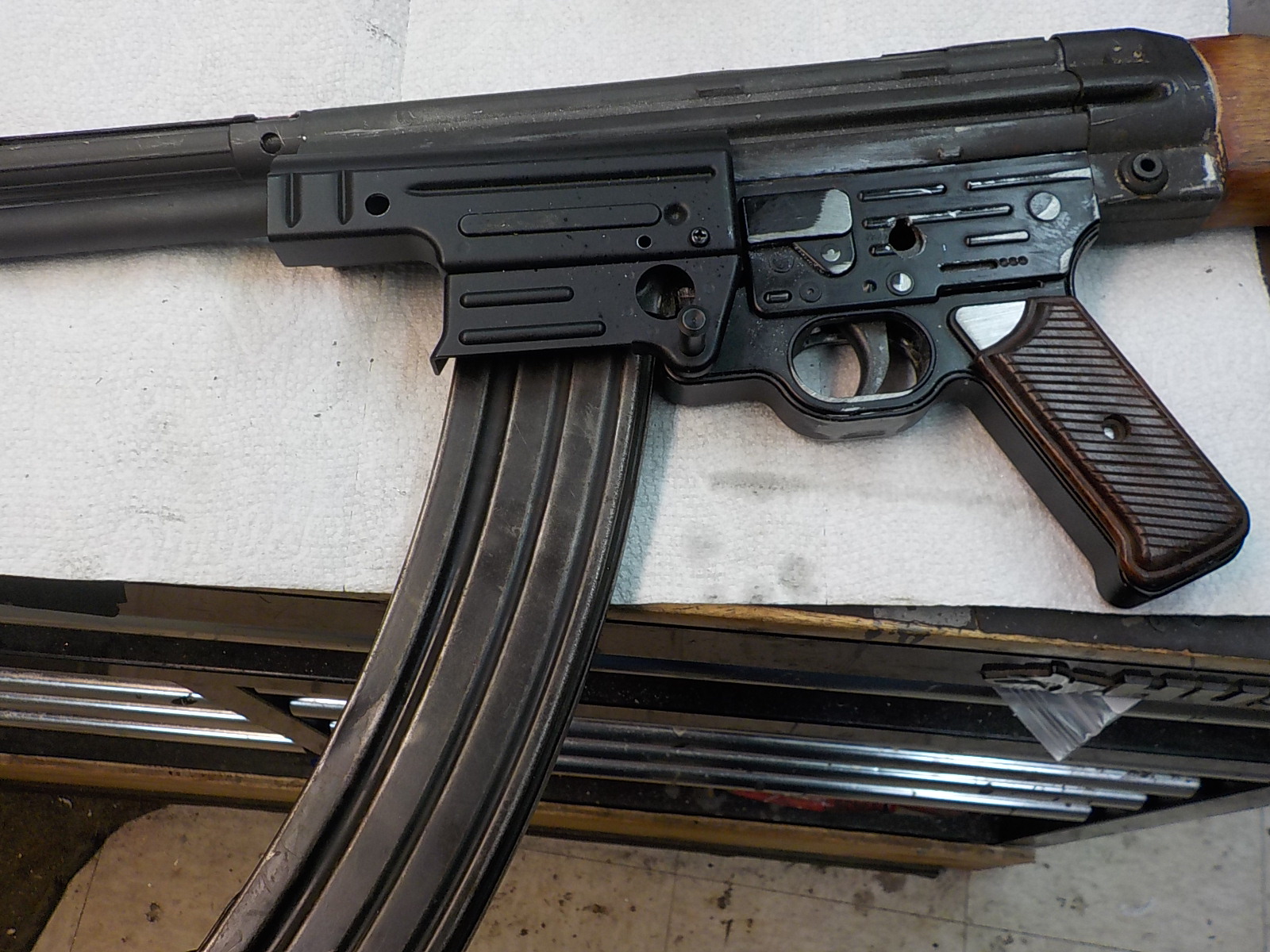

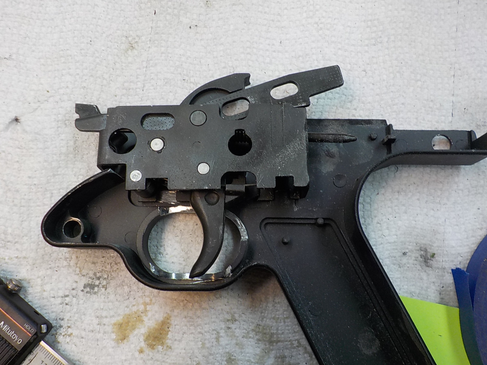

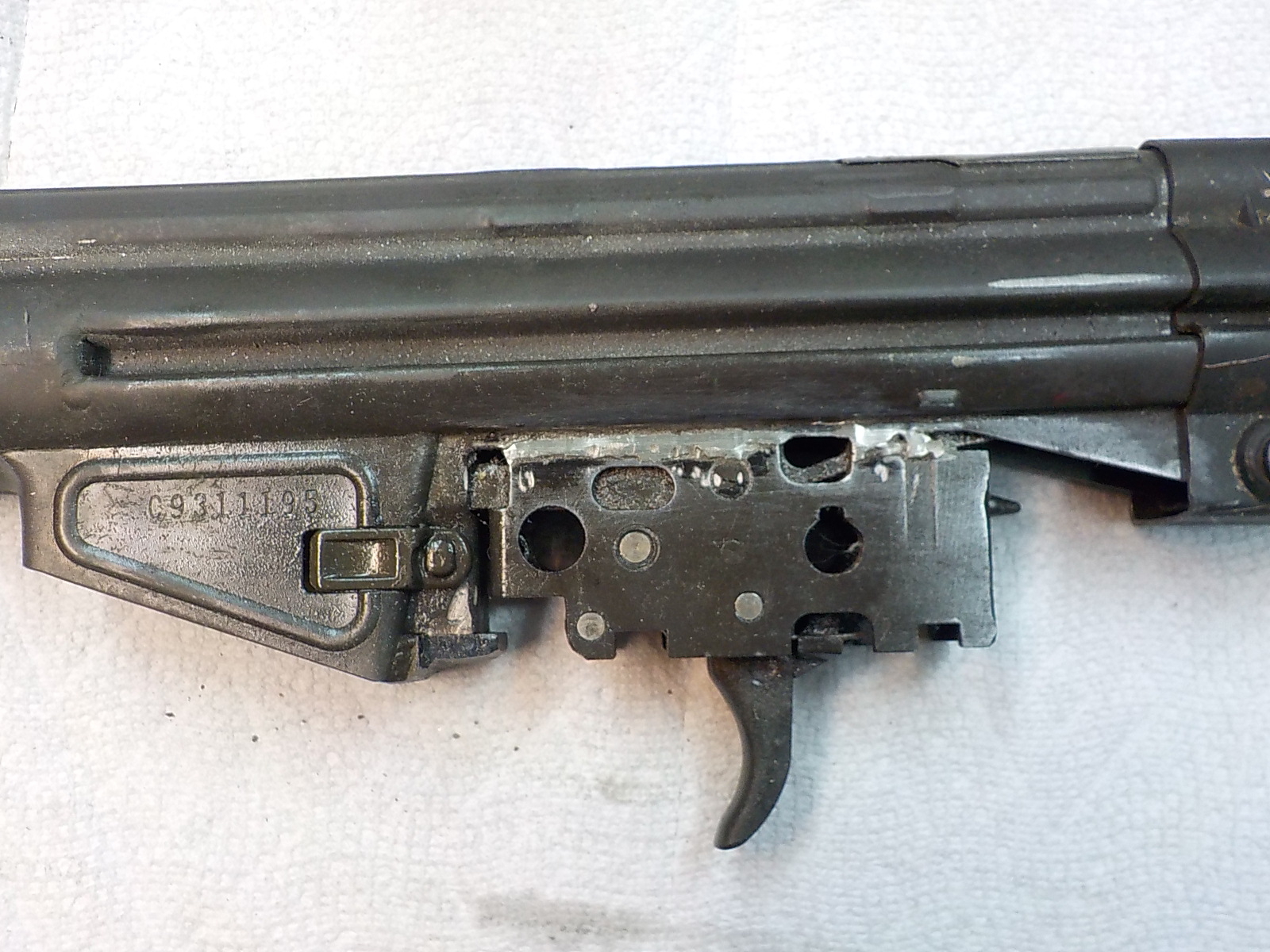

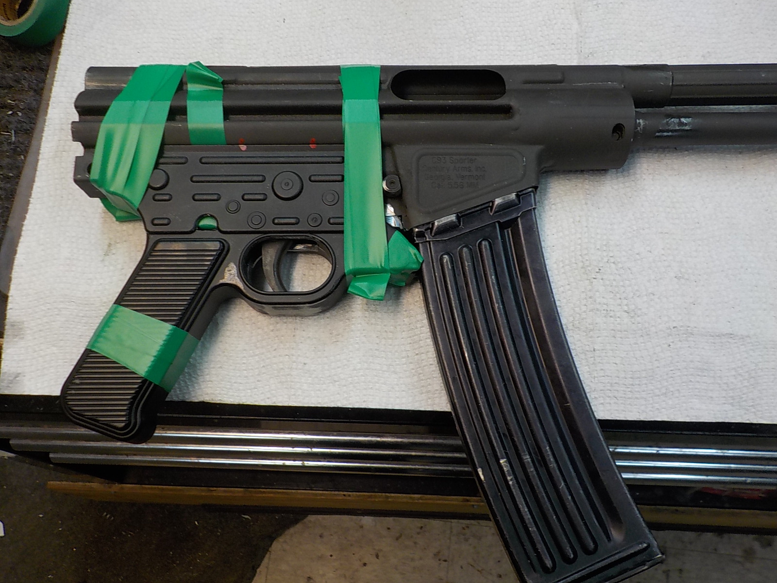

    Trigger pack silver soldered to receiver. Test fired and works great. The trigger guard/pistol grip will secure through the trigger pack by the safety just like the HK lower. Then the whole thing will secure to the receiver by a couple of screws/HK pins.
    Trigger guard/grip. Need to adjust the location of the safety clearance hole. This is because it took two iterations to get the gun to work. First iteration the ejector was not rising high enough to catch the base of the case resulting in failure to eject. I could have probably built up the back of the ejector to cause it to rise higher but I don't like to alter fire control groups if at all possible.
    Thinking of altering a 50 round Galil magazine to work because it gives a better representation of the huge original.
    But the HK mags look fine.

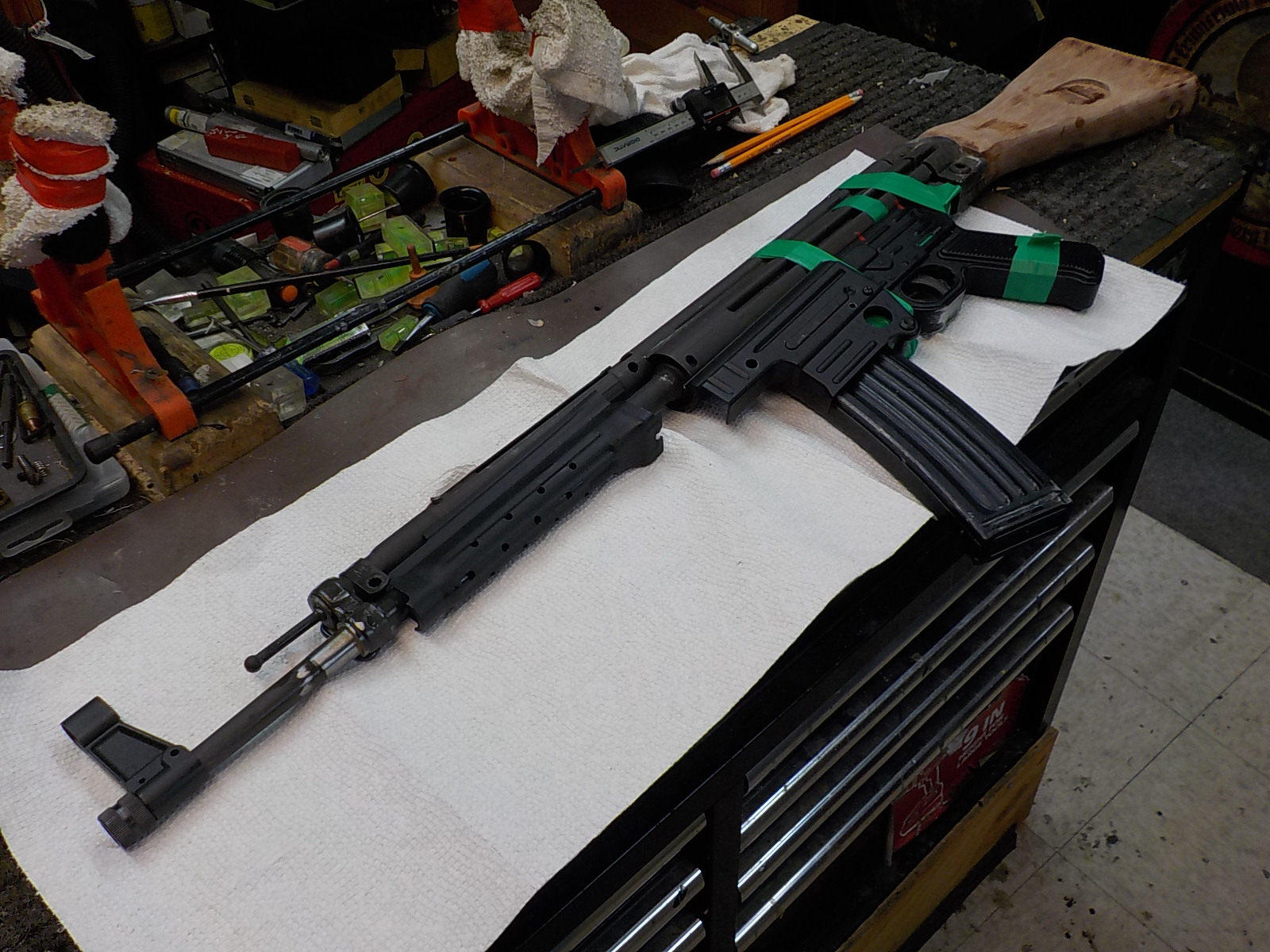

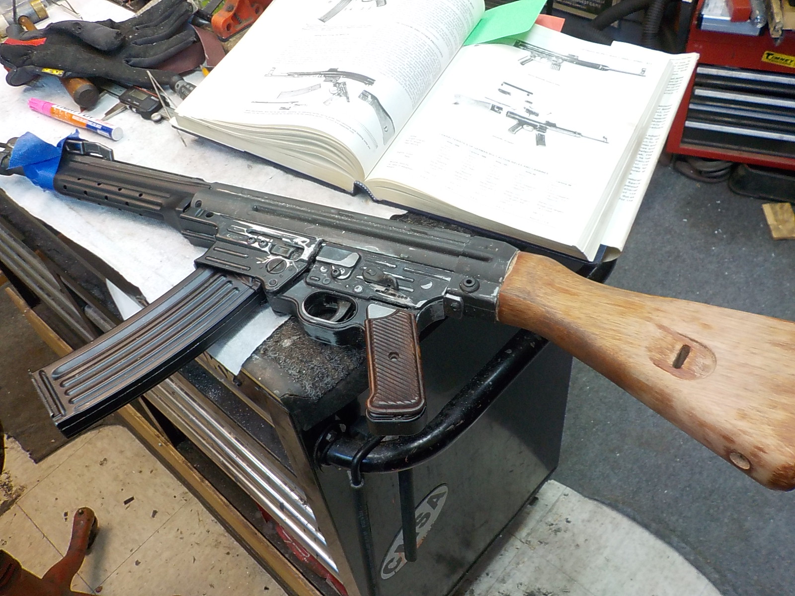

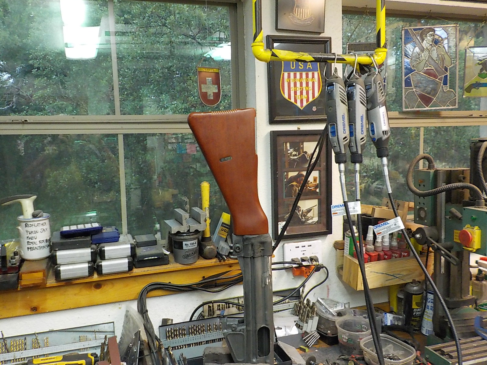

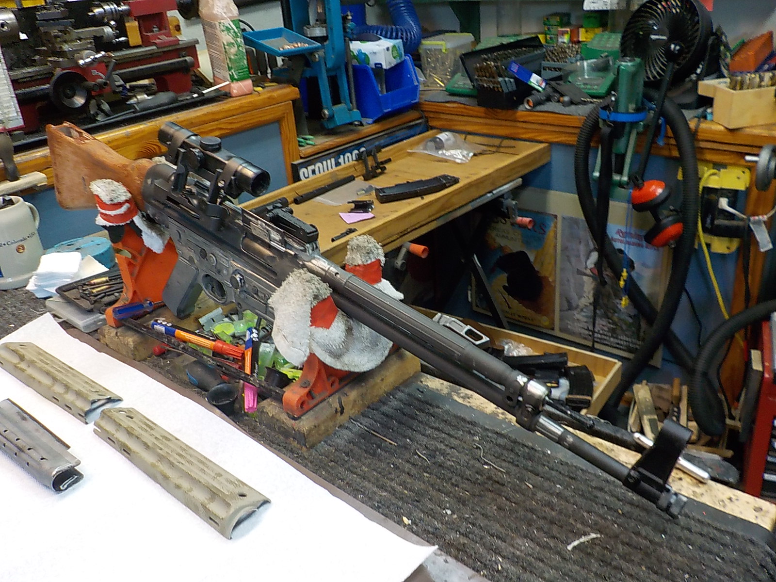

    Getting close to being done. Do the battleworn finish on the wood, fabricate a new handguard, apply battleworn Cerakote finish and that's all.

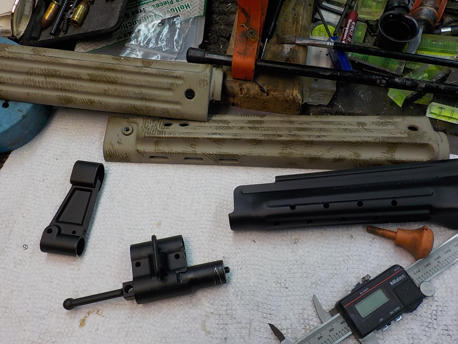

    Completed dust cover

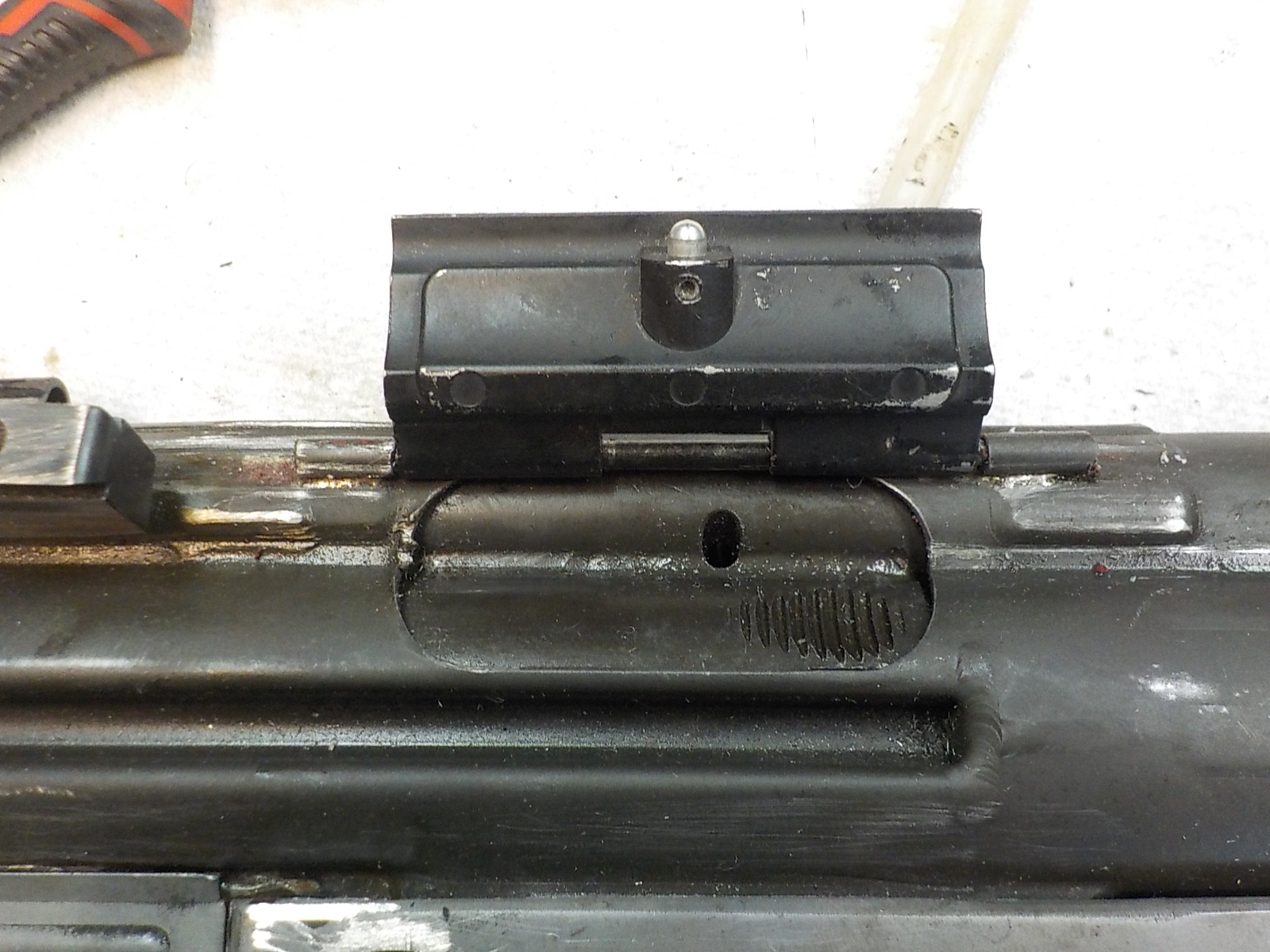

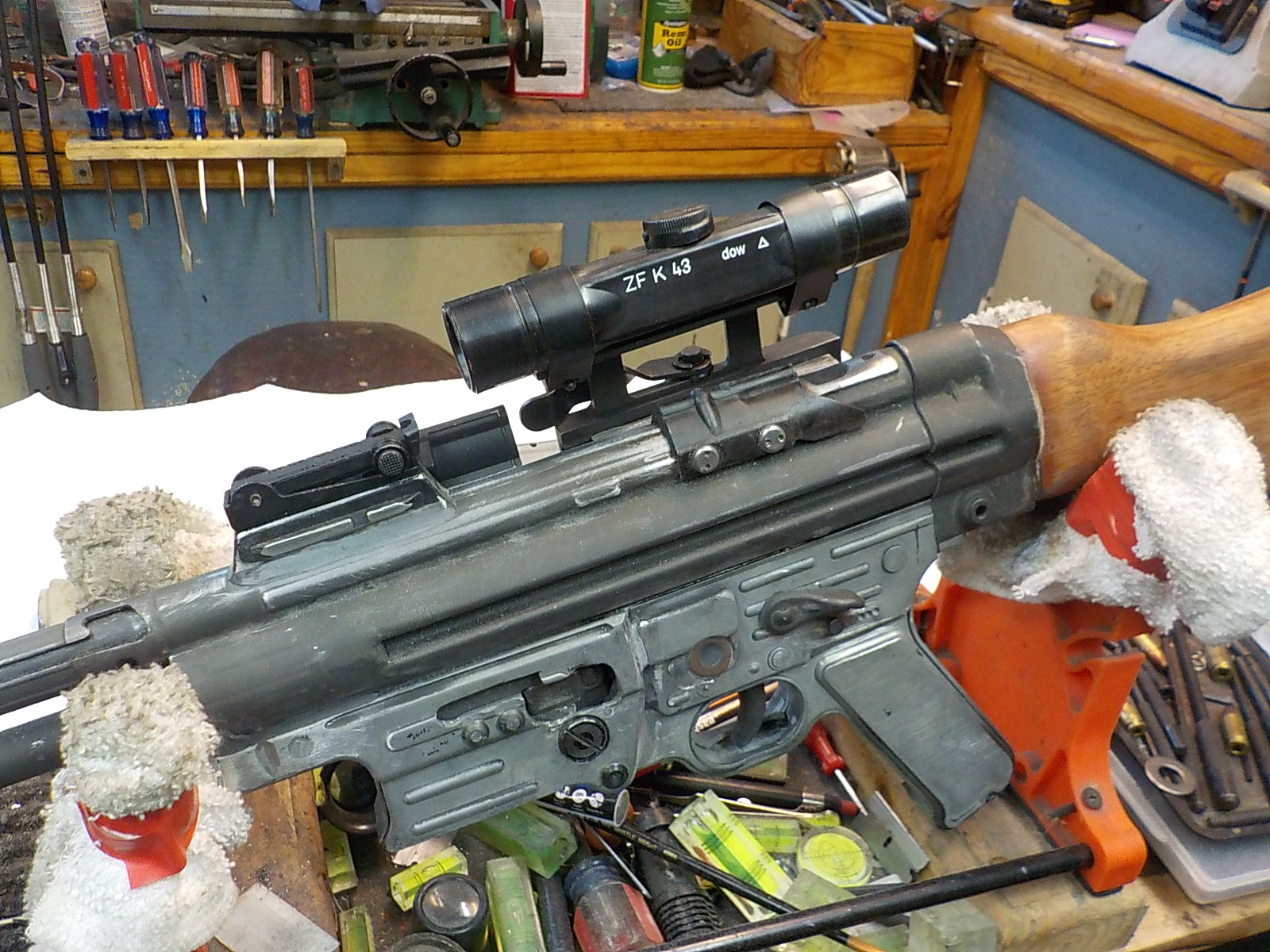

    Completed scope mount, Decided to go with the ZF-4.

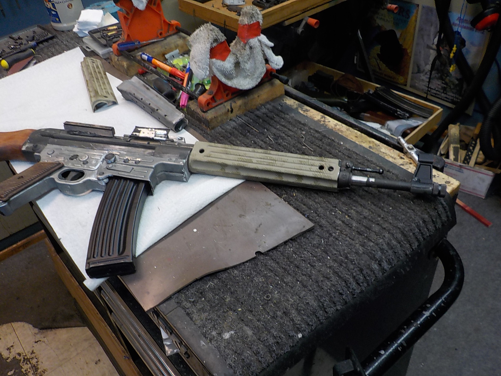

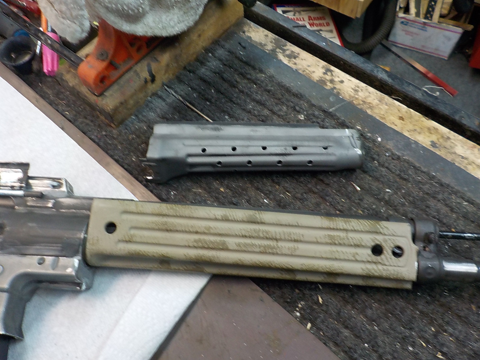

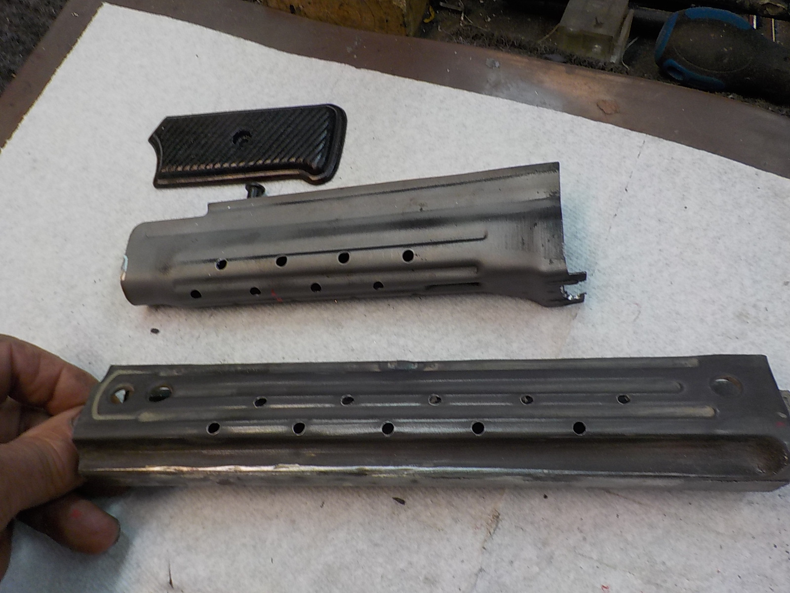

    Decided on going with an old STG 58 handguard that I will cut, weld, drill, and adapt.

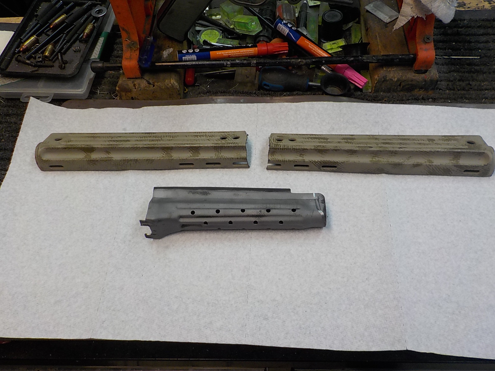

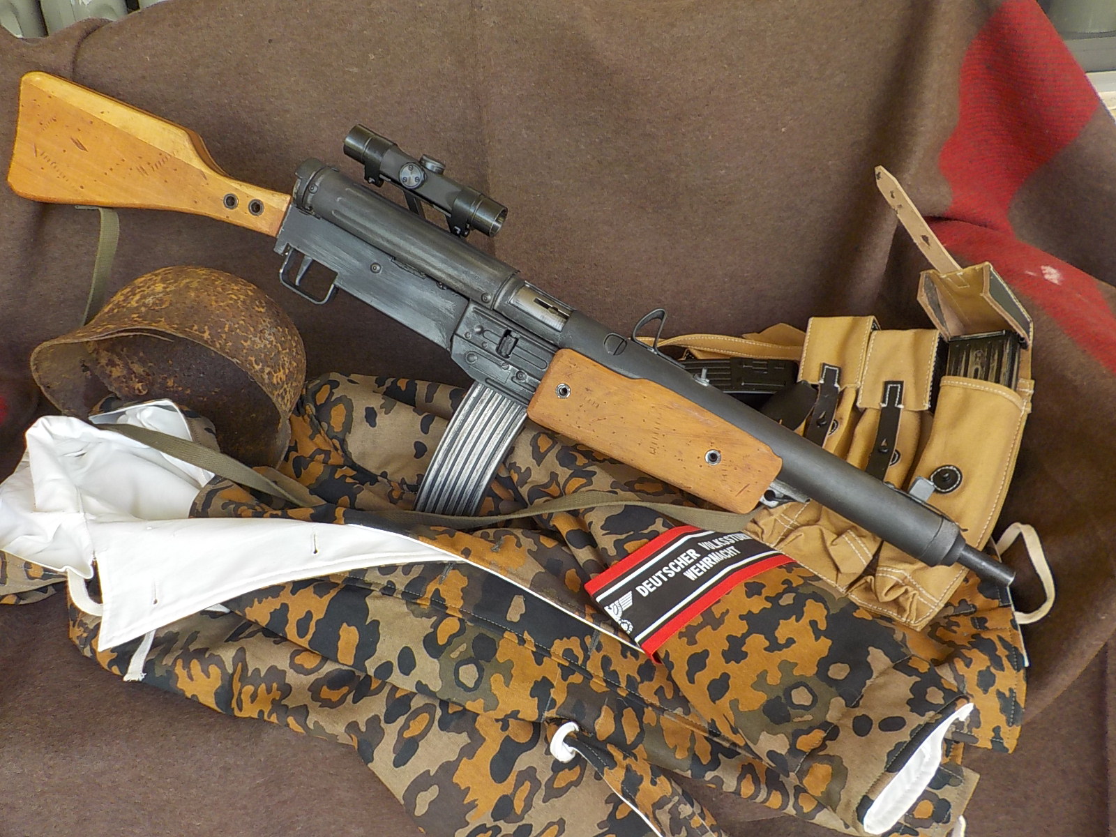

    Finished the handguard...
    Came out better than I hoped. I came up with what I feel to be an elegant solution. I took an old STG 58 metal handguard and cut a section out of each bottom half to fit the the STG 44. Then I welded a reinforcing piece of steel to the inside and tack welded it all together. It really looks like it belongs and after I drill the appropriate cooling holes, should be a very good representation of a STG 44 handguard, if nothing more than in spirit. It is a nice friction fit around the top tube and will fasten with two small screws to the barrel band.

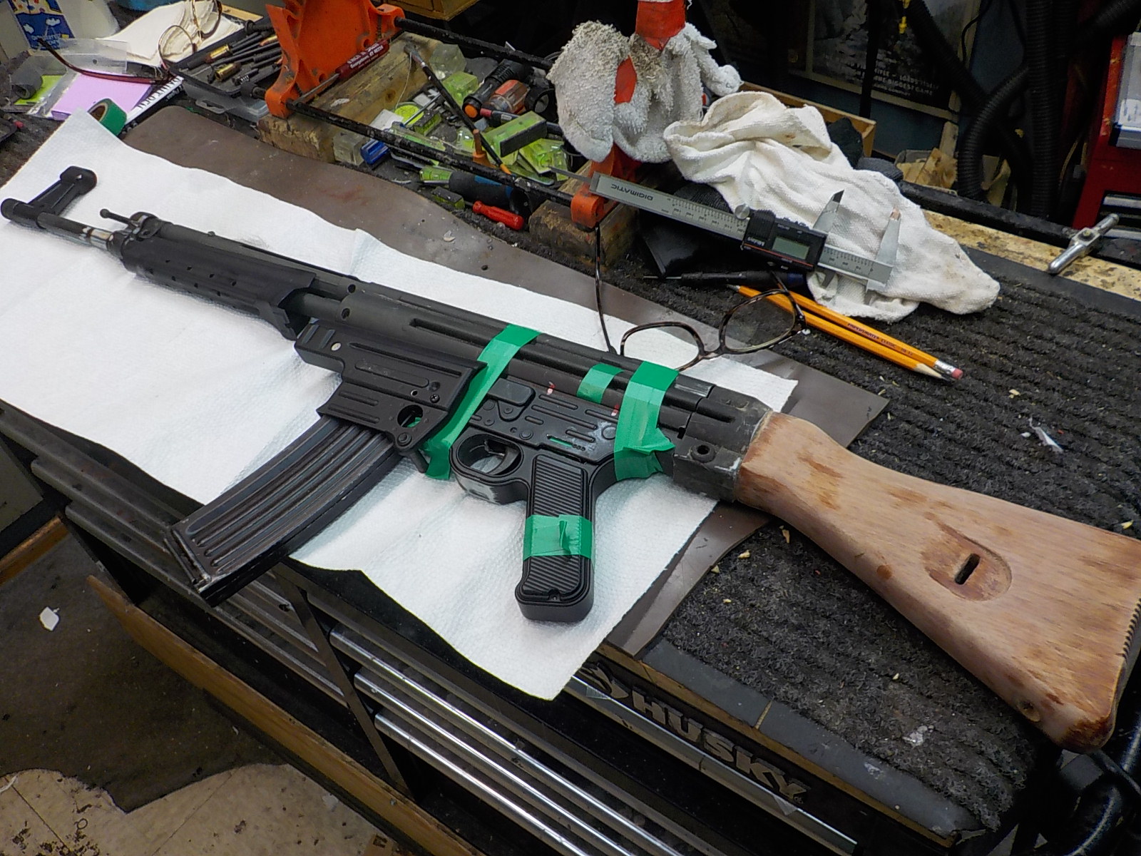

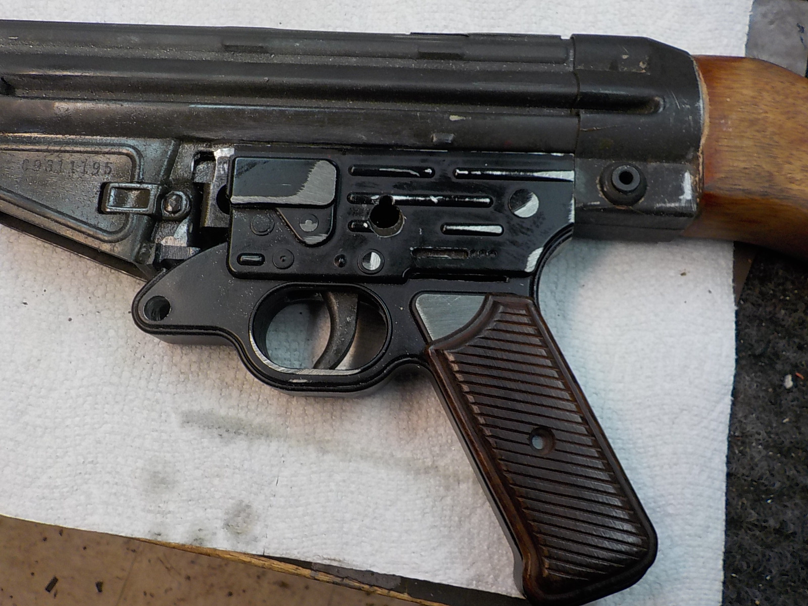

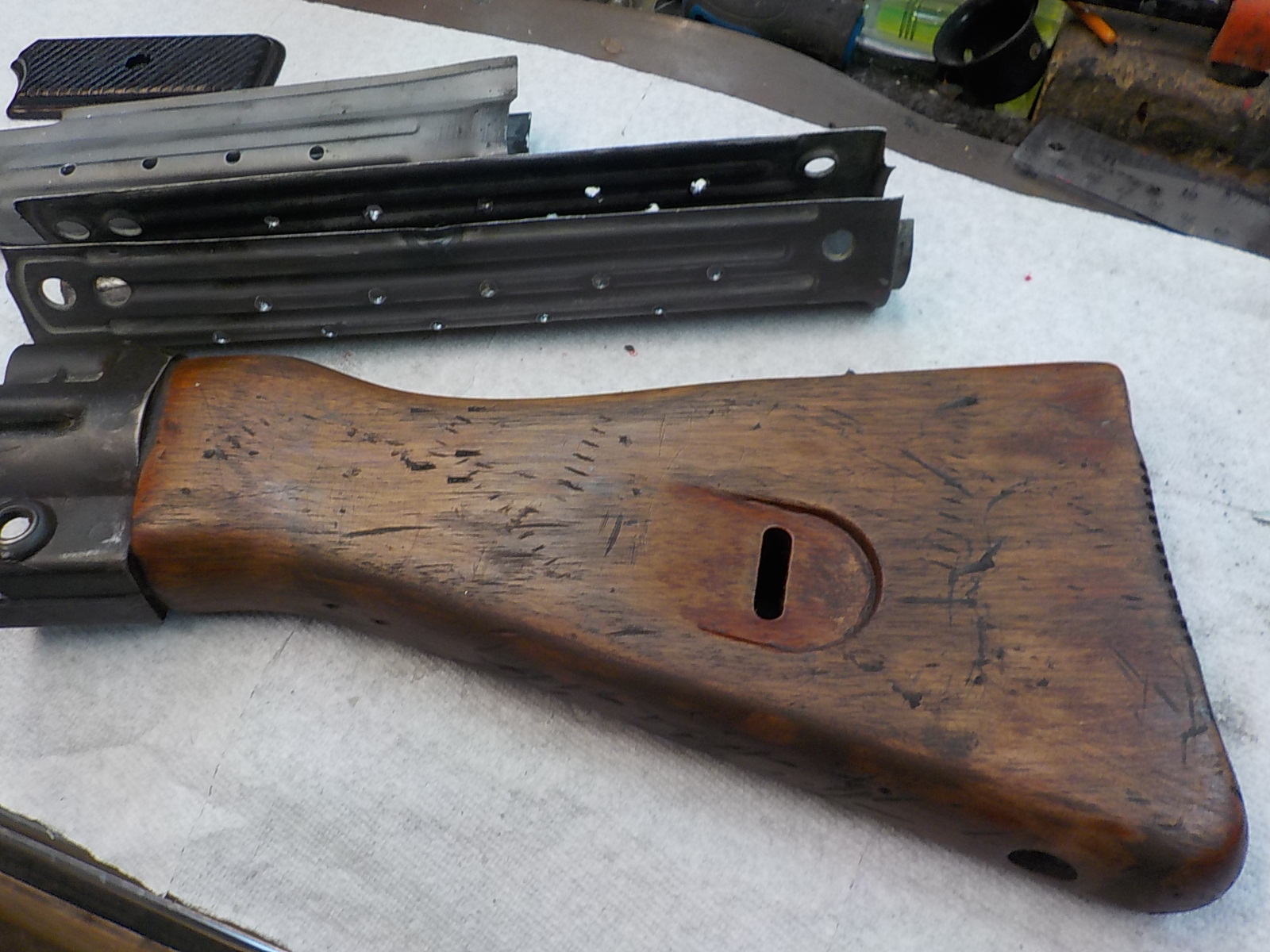

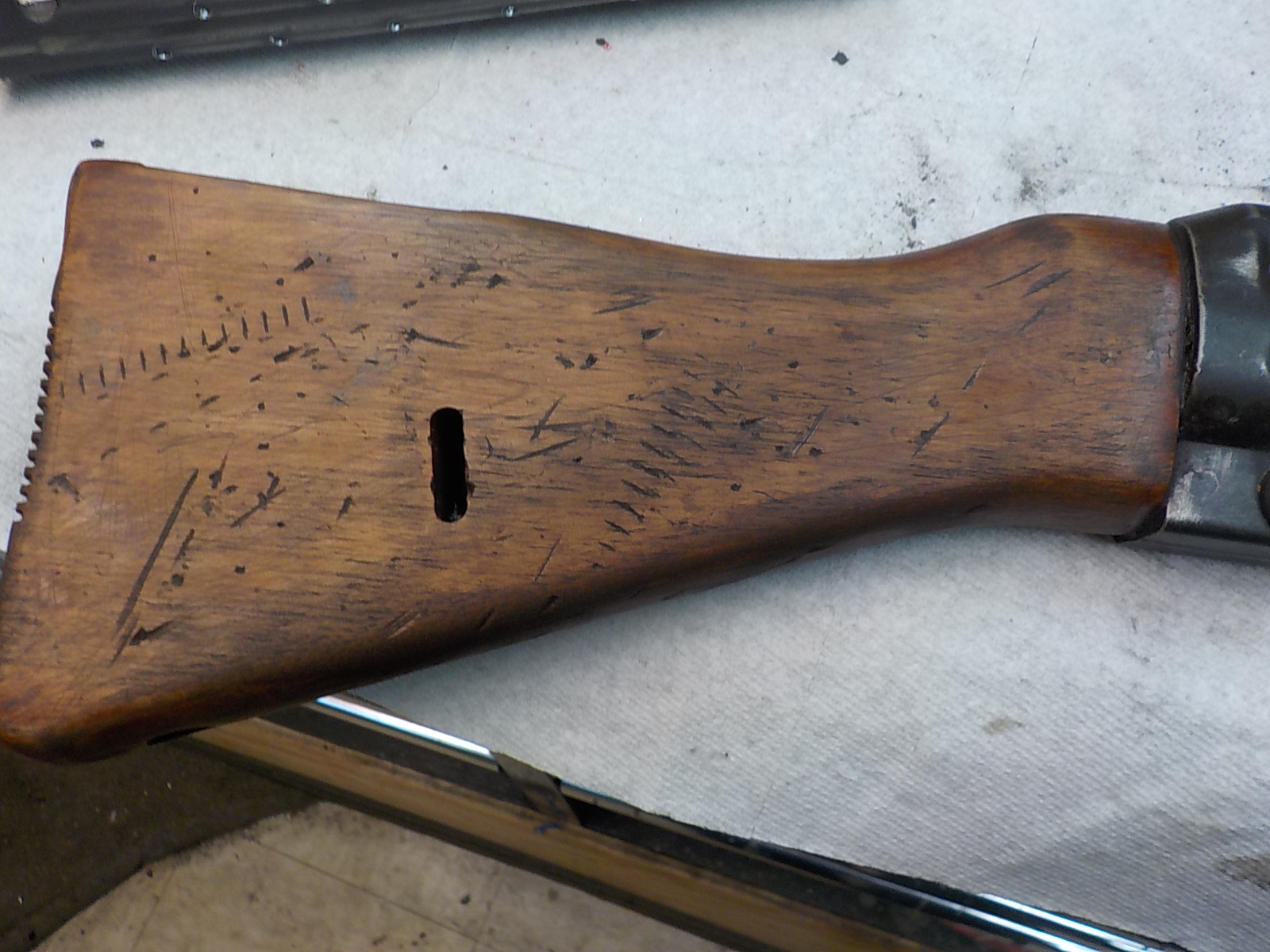

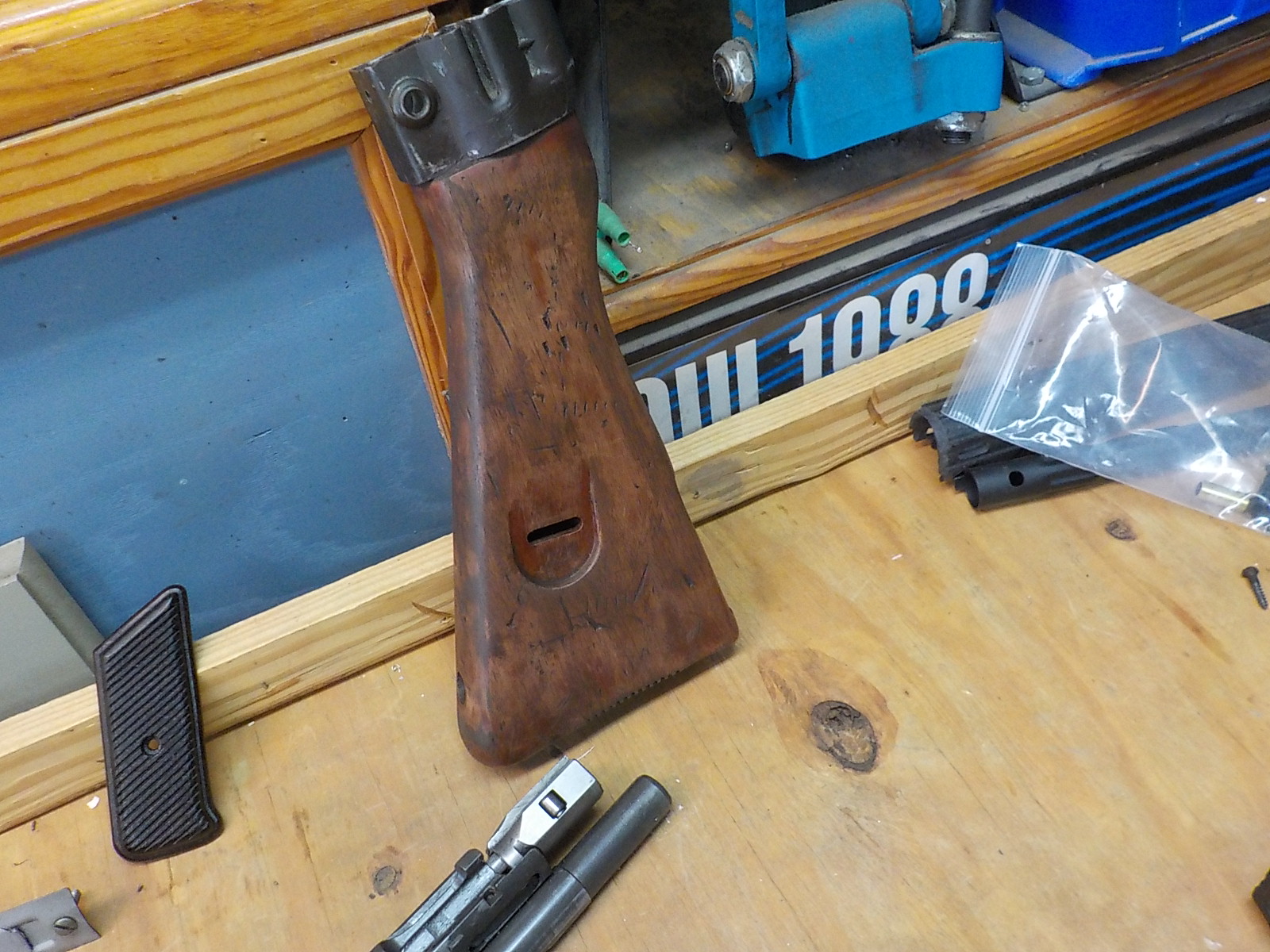

    Getting close to the finish. I finished battle damaging the stock and applied the stain. Tomorrow I'll give it an oil finish. I'll attach the grip panels tonight. Then it's disassembly, final cleaning and prep for Cerakote. I'll probably Cerakote Saturday and that will be it. I'll probably do a video and some accuracy testing Sunday. 9 days from conception to video. Seems fast, but that's a solid 8 hours a day...start at 9am quit at 10 pm and take out 5 hours for food, exercise, and ranch stuff. If you consider how much this gun would cost based on billable hours, you would get 72 hours at $100 an hour for $7,200 for labor alone. Add in another $2000 for parts, and expendable items like Cerakote, mill bits, drill bits, grind stones (a huge expense SirH!), etc. Is the gun worth $9k...Hell No. Thats why I'm not a gunsmith.
