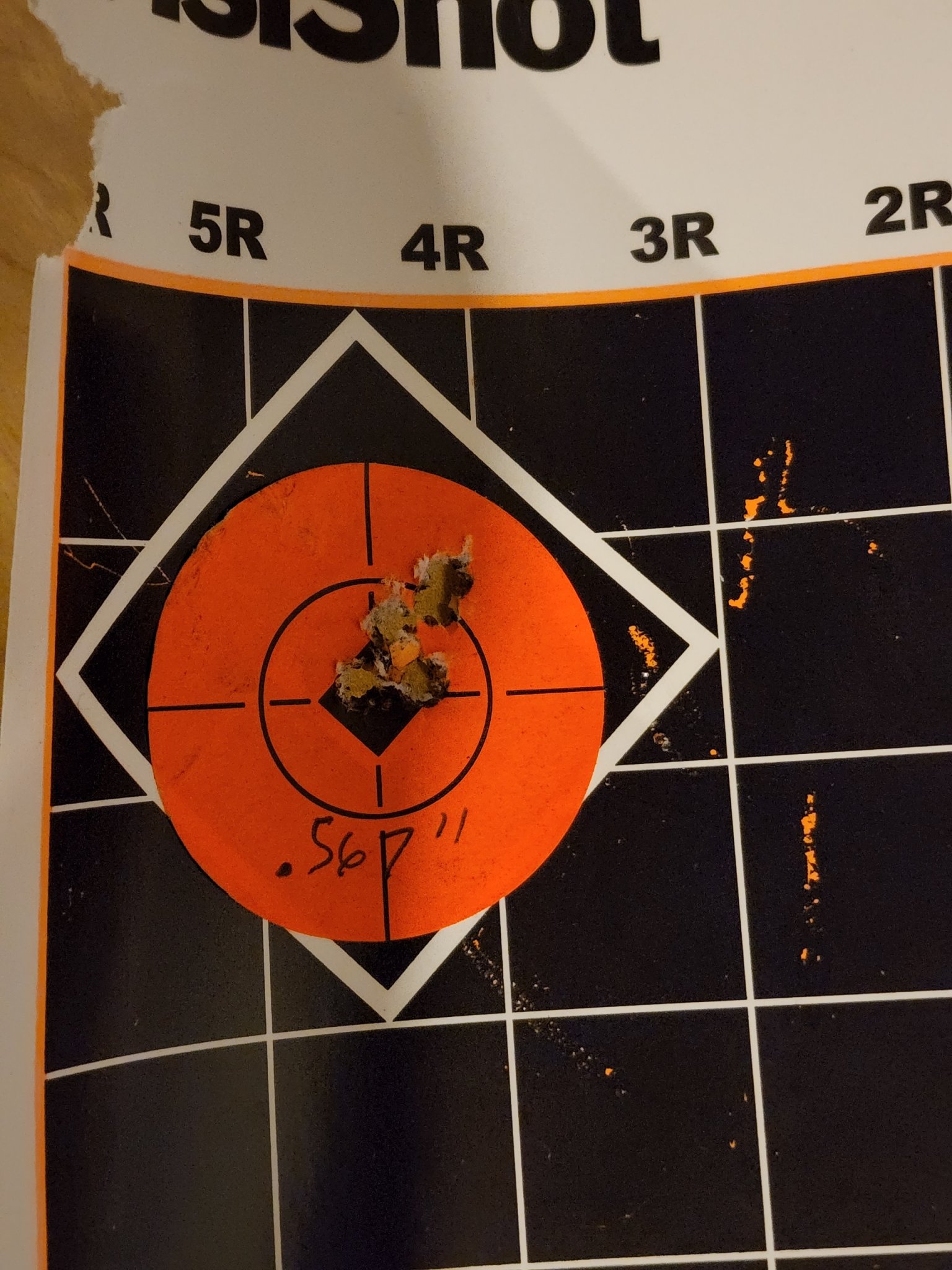

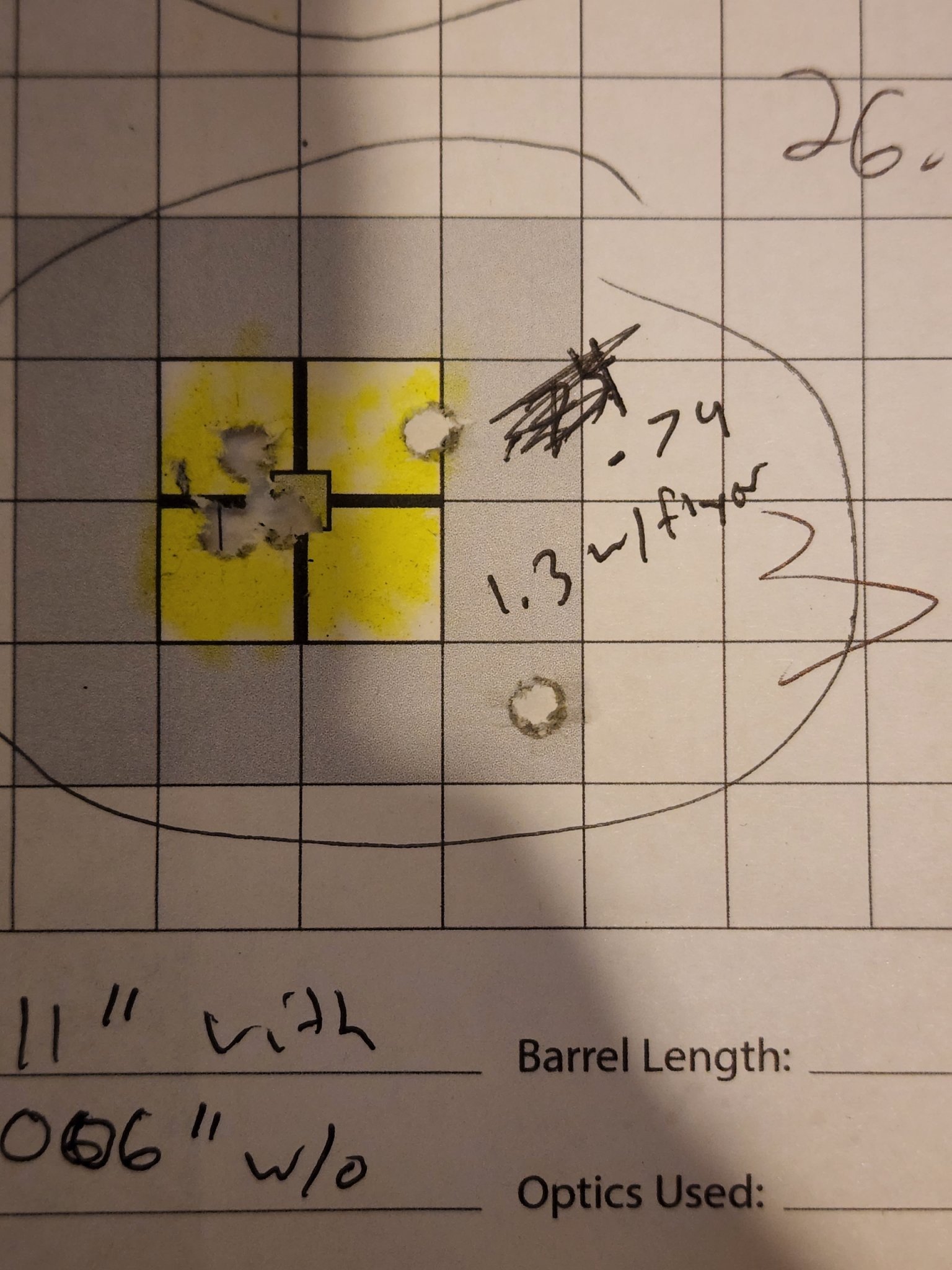

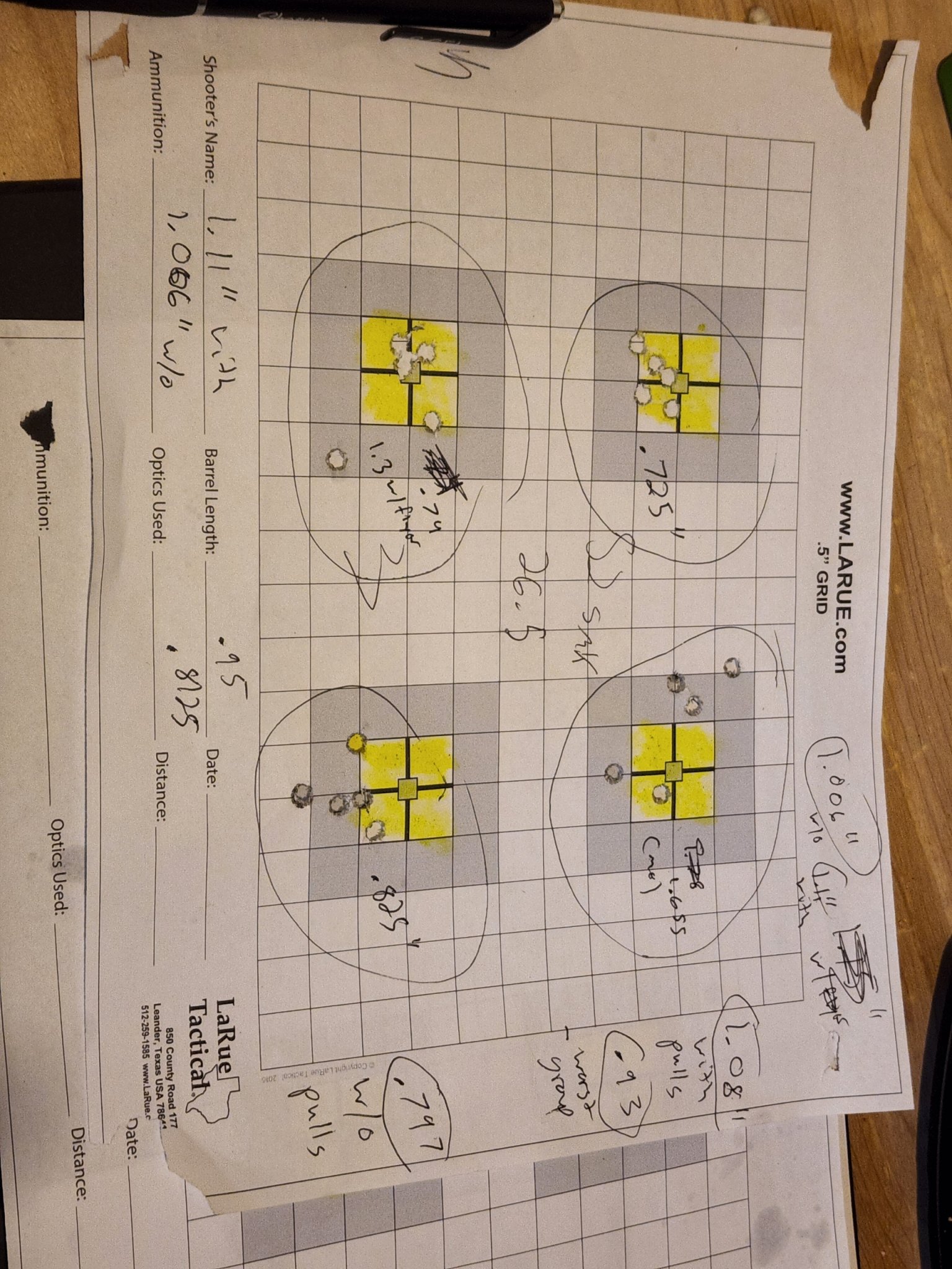

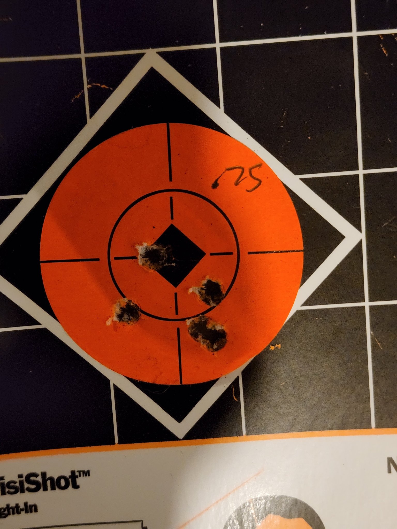

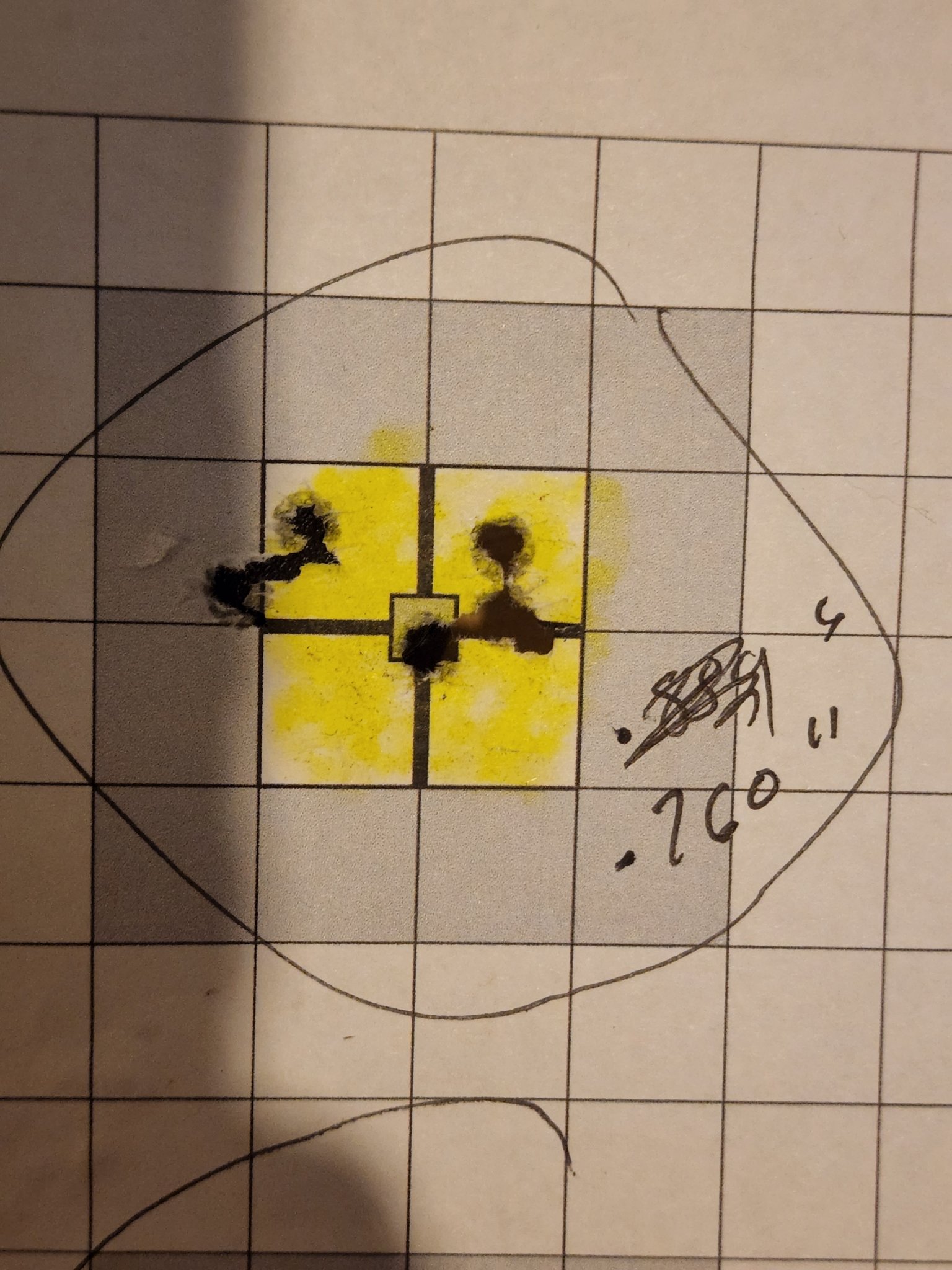

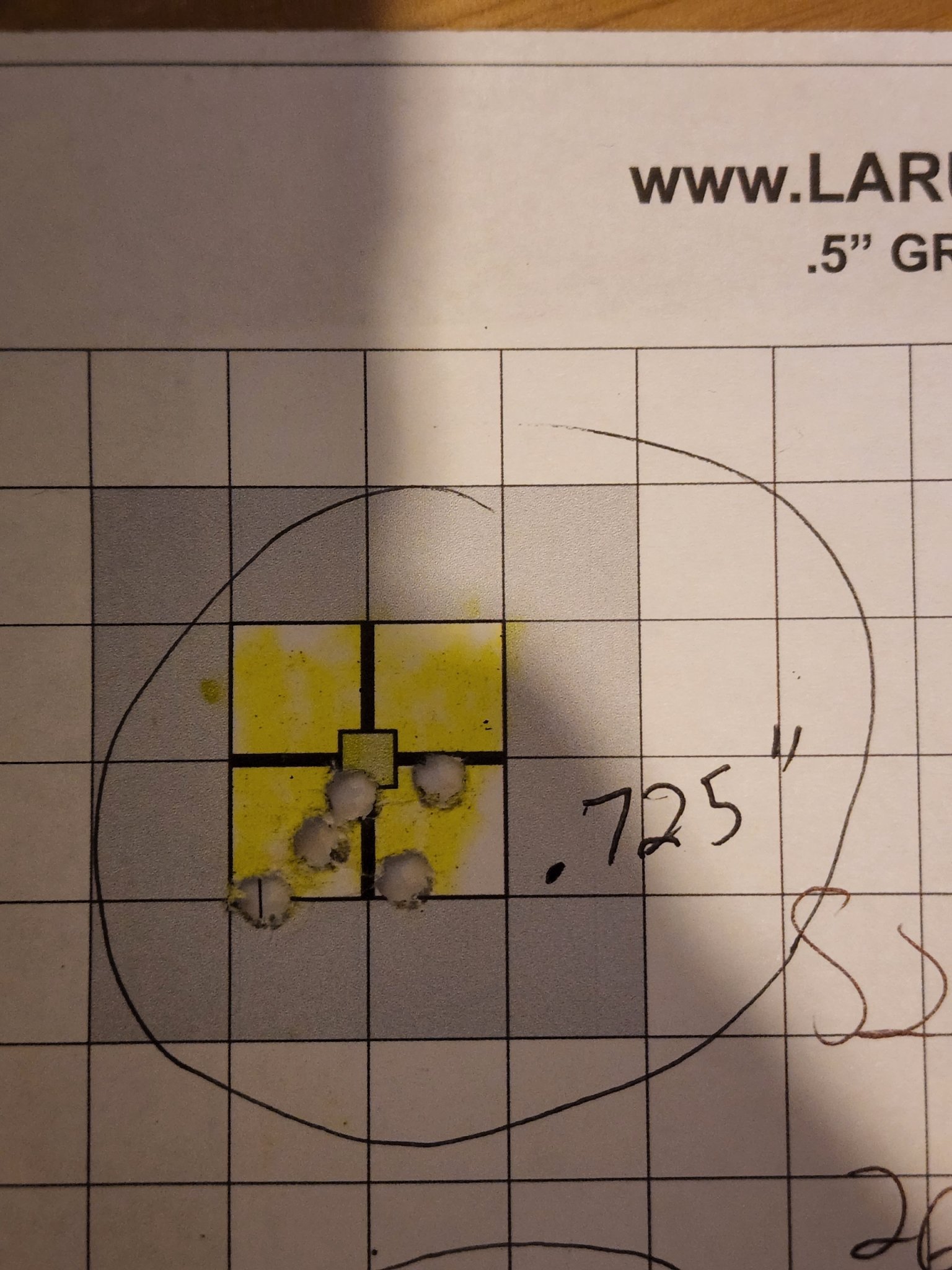

I just moved off hard bench to prone and my groups shrunk in half, using rear bag and magpul bipod still..... I'm getting sub moa averages now with the 77smk and 52 smk. 77smks are on 24.1 grains of varget
The 52s on orange bulls Are on 27.1 grains of 748, and the 52s on white targets are 26.5 grains of 748.......overall for a thousand dollar stock ar, I'm pretty happy with these results. If do get a criterion or krieger barrel I think I can keep everything around a .65 moa average...... As of now all the groups tallied average around .78 to .8 moa..... So I'd call that "sub moa"..... No way it will get worse with match trigger and barrel right?

How do these groups look to you pros? Keep in mind I've only been seriously shooting for about a year.... First ar15 and I've only reloaded for about a month now..... I can drum up more excuses too if need be lol. I came to this forum to learn from the best so any help or advice is greatly appreciated

This is an expensive little endeavor friend.... it's a lot of fun though! Yeah, 1moa ( or 1" group at 100yds) is thought to be pretty decent consistent groups with an AR unless it's a "precision ar".
I have a CLE AR 223 that will do 1/2" no problem, but again that's a very good barrel and an AR built for precision.
Since u were a part of this endeavor n gave me a bunch of tips I thought I'd reply to show u the improvements some of ur suggestions made...... There is pics of groups a fewposts up...... Went from 1.5 to .75....... I appreciate your help my friend
