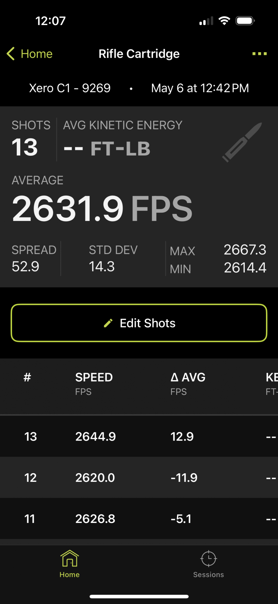

261 rounds through the gun
Im wondering if that ES is ok. My next too PRS matches are at ranges that go to a 1000
That ES is perfectly fine for PRS matches.
ES is not a great predictor of MV anyways. SD is. And an SD of 7.7 is good ammo.

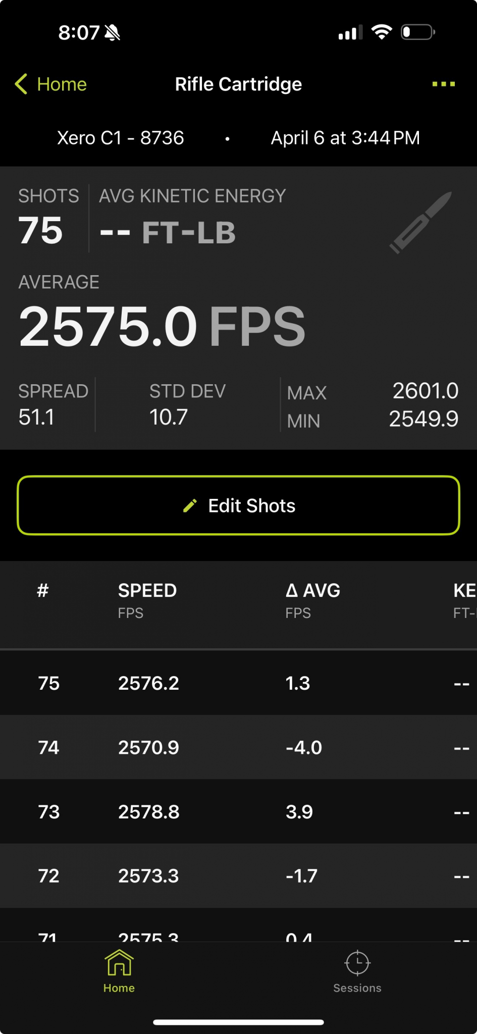

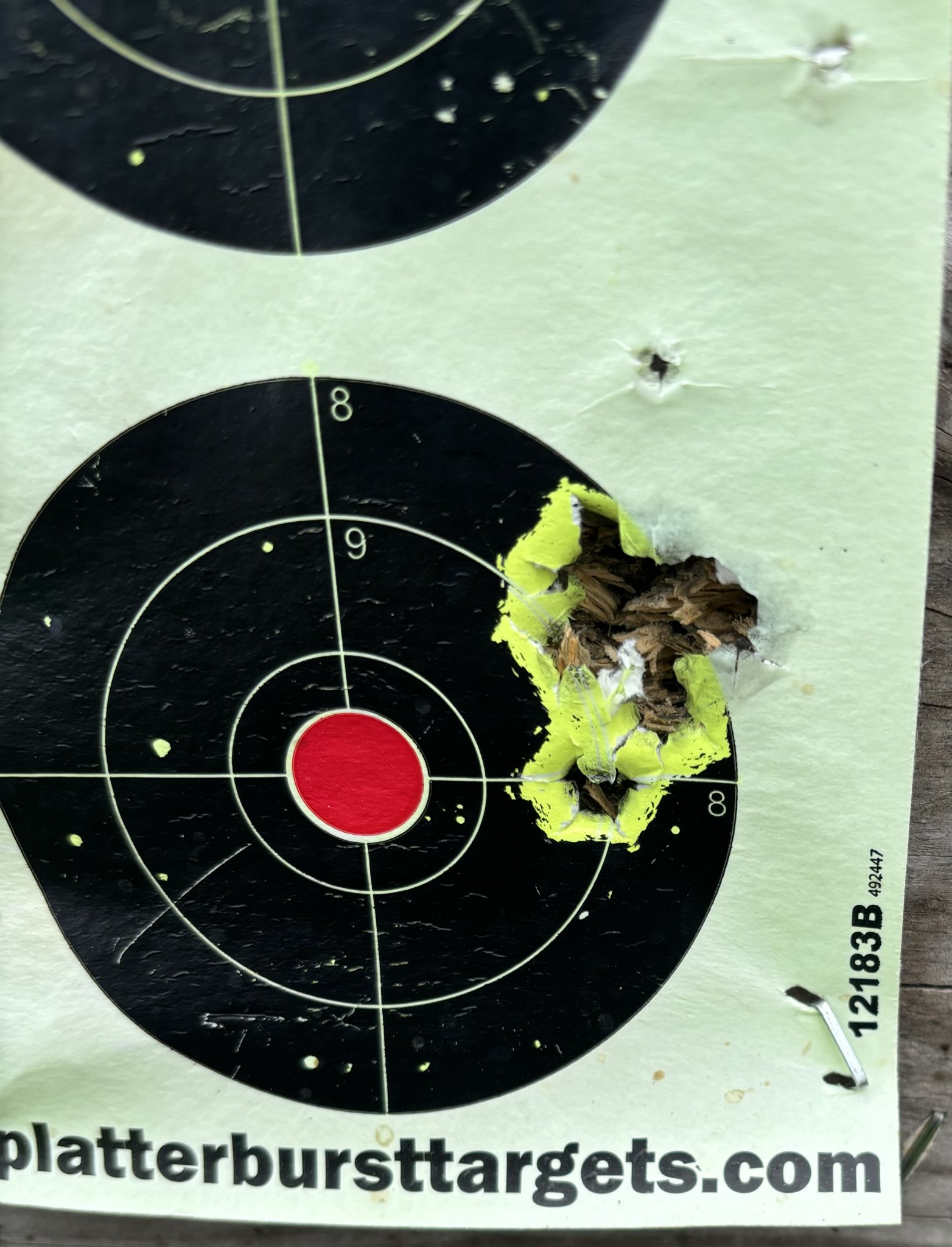

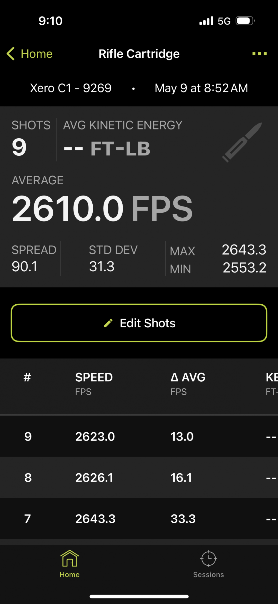

Dont know if it was the temperature or now that i jumped thoses rounds .064 but way worse.
52 degrees. I thought varget wasnt temp sensitive as well? accuracy is awesome those if you don’t count that flyer 8 shots under half moa
