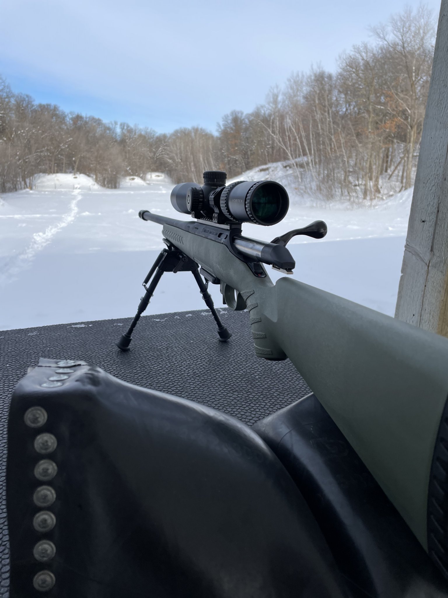

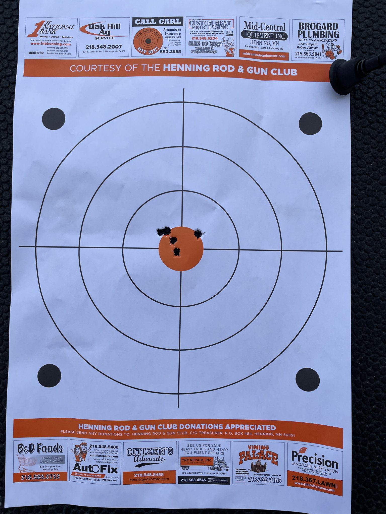

So last night I took everything completely apart and re torqued every single bolt. It’s a bit warmer today so I hit the range with the same ammo and my first group was right at MOA. I got it zeroed and she’s ready to hunt. That’s good enough for what it is. Thanks guys!View attachment 8066749View attachment 8066751
That is great to hear! Was it action screw torque?

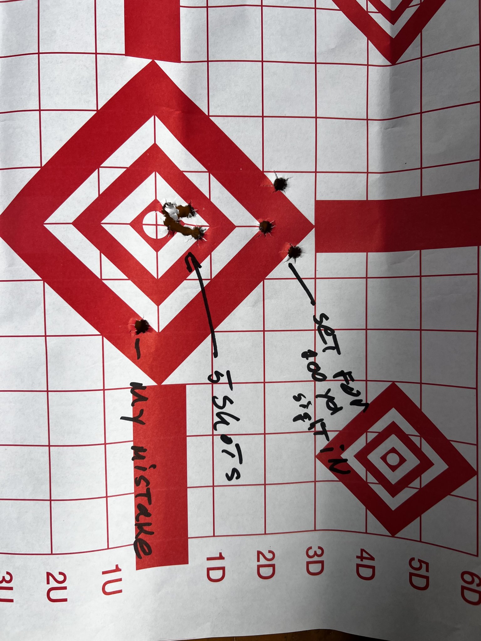

I have the predator in 6.5 creedmoor on a magpul stock. It is very accurate but shooting the same bullet, ELDX 143 gr, at 100 yds, at 2700 fps, from a rest, I got groups from 1.2 mos to .4 moa. I loaded the rounds using the same cases-Hornady ,cci lr primers. I tried IMR 4350, Staball 6.5, and RL 17. The tRL 17 gave me a 5 shot group you could cover with a dime. I was amazed at the difference just a different powder could make. I guess that every rifle likes different loads and because I was handloading, I could tune the load. Hell, that’s half the fun! The high shots are where I reset the scope for 200 yd zero. As a side , I also have the same rifle in .243 and had 2 one shot kills on pronghorns at 180 and 240 yds after playing with the various different components. Reloading is very satisfying.
