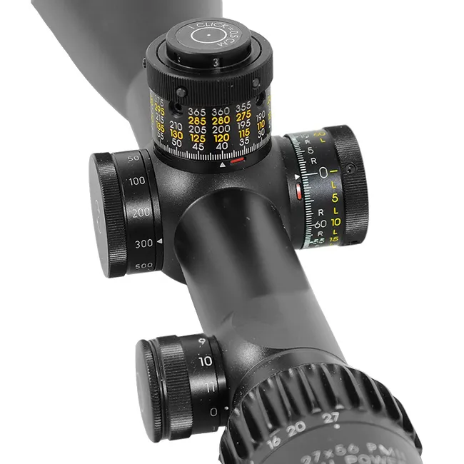

    Just released earlier this week.
    I just inked up on one of these new S&B DT II+/MT II offerings - got to say I am looking forward to it.
    39 MILs total elevation travel, .05 MIL increments. That's right, 39 MILs of mechanical travel in this beast. 27x will make that LRR-MIL reticle really shine at distance I believe. This is going on an AW50, so mechanical travel is welcomed.
    According to Jason at EuroOptic, this will be standard on MT II turrets along with an elevated travel range from some over existing DT models.
    Getting accustom to dialing .05 is going to take a bit of work when behind this optic initially, but I don't see that as a problem long-term of course.

    So 40.00-40.05-41.00-41.05-42.00-42.05-43.00-43.05-44.00-44.05-45.00, wow this will lead to many to alzheimer's like symptoms while spinning that dial.
    Oh it's way more clicky than that... It's .05 MIL "per click"!
    ...40.00, 40.05, 40.10, 40.15, 40.20, 40.25, 40.30, 40.35, 40.40, 40.45..........
    Can someone please explain that turret? Wtf
    Let me preface that I hate talking in clicks but it's a necessary evil in this case to convey how it functions.
    It's not too bad... Just a lot of spinning. Finding what you need to end up on isn't terrible. Look at the top of the elevation turret. It's .05 CM/100 Meters.
    Basically you just put a decimal one place the left to make it easier to comprehend. If you wanted to dial 9.8 MILs you'd end up on 90.8. The only thing to remember that is each click is not .1 MILs like is common - it's half of that - .05.
    To dial 1 MIL, you need to input 20 "clicks".
    The benefit, double the resolution. Example: At 2500 yards you would have 4.5" per-click of resolution instead of 9" per-click.
    Reactions: Pbgt and TSean

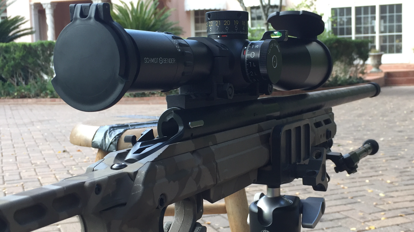

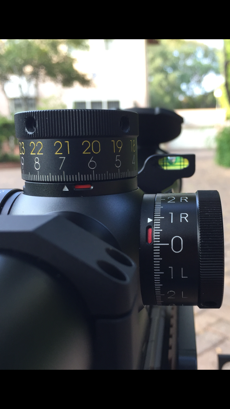

    Hey Huskydriver,
    They have good pics on the EuroOptic site (go to Schmidt and Bender —> PM2 —> 5-25x56 —> 5-25 MTC LT Black. Then it’s at the bottom, the one with the MSR2 reticle).
    A couple pics of mine attached. (assuming the attachments work). Just a great turret size as well.
    Hope that helps bud. Have a good one!
    -TSean

    Hey Huskydriver,
    -TSean
    Those turrets look nice... What is the red slot?

    Hi Long Range 338,
    Husky driver is correct on what that little window shows. For a more detailed explanation: You can't see it in the picture, but there is a three position slide lock at the base of the elevation turret (also on the windage turret although that one is 2 position locked/unlocked with no MTC except for on "0"...I am pretty sure anyways).
    Lets say that we are behind the gun normally viewing the turret from 6 o'clock (where the mark indicating what click you are on is). When the turret is locked (red in the window), the slide-lock is at 12 o'clock. If you move it one position counter clockwise to about 10 o'clock , then the window shows green and the turret is unlocked with MTC on. If you move it one more position CCW (fully to one side or around 8:30), then the window shows black and the turret is unlocked with MTC off.
    Hope that makes sense. It is easy to use in practice, even if a bit "new". Don't quote me on the exact position of each position of the slide-lock, but that should be pretty close ha!
    -TSean

    I believe it's
    Red = turret locked
    Black= turret unlocked with mtc disabled
    Green= turret unlocked with mtc on
    If that's correct, that's awesome. Being able to have locking, standard clicks, and MTC clicks in the same turret is really nice.
    In the pic Tsean posted I also like how S&B rotated the zero mark for the windage turret upwards so you can easily see it from the top and verify your windage is at zero without having to scoot your head over to look around the scope ring.
    Reactions: M8541Reaper
    Hey Huskydriver,
    -TSean
    Those turrets look really nice, I like that they marked every .1 on the windage. I think the DT turrets are only marked for every .2. Looks like slightly more spacing in the turrets too.
