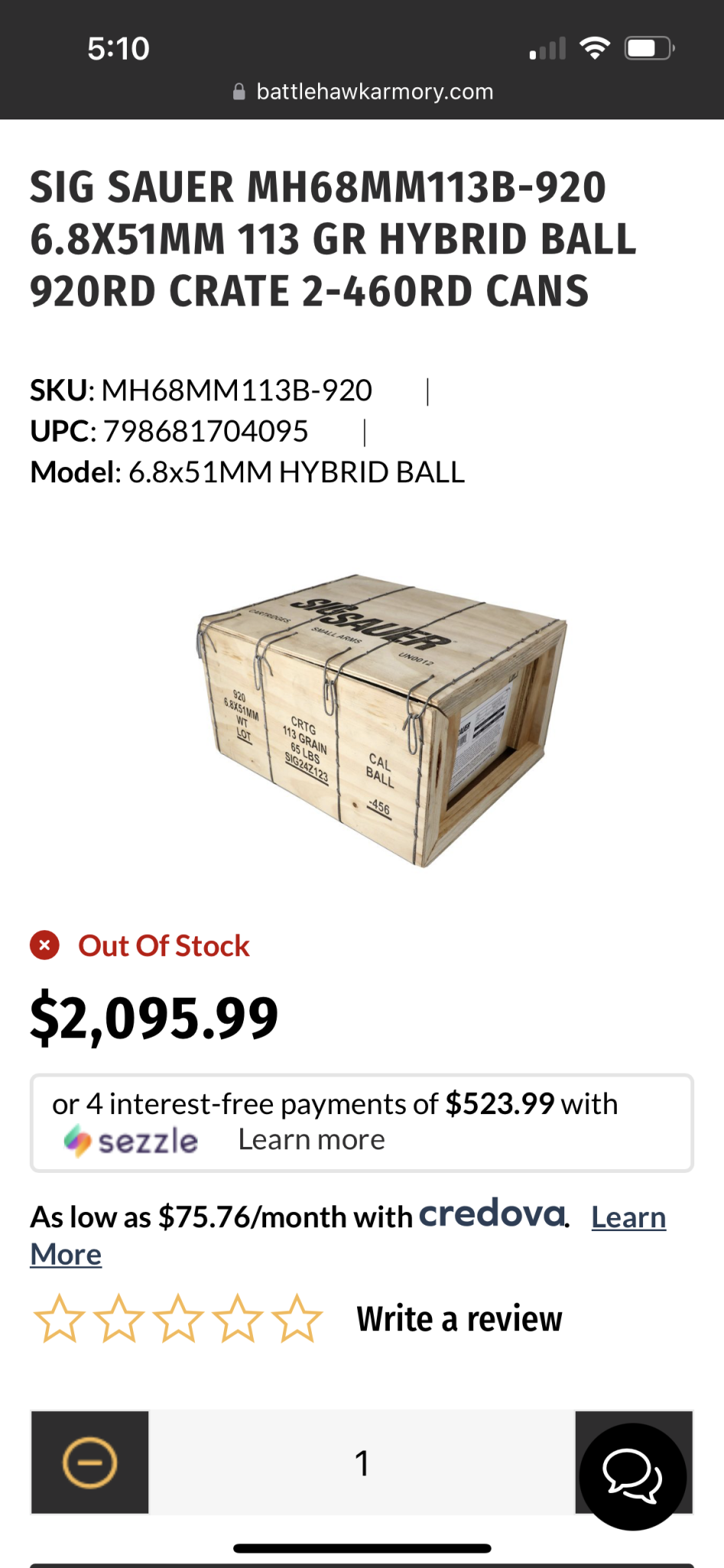

Ok, I did a bit of digging and found 460 rounds of 6.8x51 in a metal ammo crate listed at just over $1200. I’ve also seen two military ammo boxes, bundled together, listed as a “case.” 920 rounds plus 2 ammo boxes for $2400 is pricey, but not ludicrous. At least, not when 6.5 creedmoor can be found at $40+ per 20.
This isn’t even the 6.8mm 130gr military super bullet NGSW was based around - it’s 113gr practice ammo. Also by emphasizing practice rounds I’m not even certain they are loaded to the same pressures as the god stuff despite the hybrid case.
Also here: https://ammoseek.com/ammo/6.5mm-creedmoor?ikw=Eld-m
120gr ELD-M 6.5 creedmoor for about $1.28 a round. Not the best BC but better than a 113gr 6.8mm with unknown velocities for practice.
Of all the Sig Next announcements this one has me scratching my head the most; and they also released a 4.3” barreled P365 “Fuse” at this event for context.
~$2/round isn’t great, but is way better than “$2400 per case” would suggest…

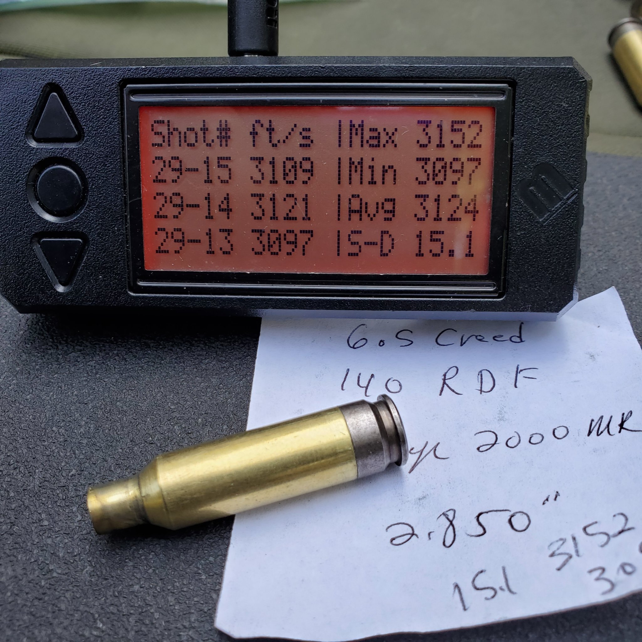

Powders are limited in what is available to the public ...here is a 6.5 CM with 140 gr bullet with a top velocity of 3152 fps....with a 24" barrel factory RPR. The wrong powder is written on tbe paper...by the way.
I do not know what it will do in a 13" barrel, cause I ain't gonna shorten it.
I have no use for an SBR and have eliminated all AR pistols. Being a rifleman, 16" is as short as I'll ever go....I like 18" ARs, & maybe even a 20". Short barrels leave too much on the table for my shooting endeavors.

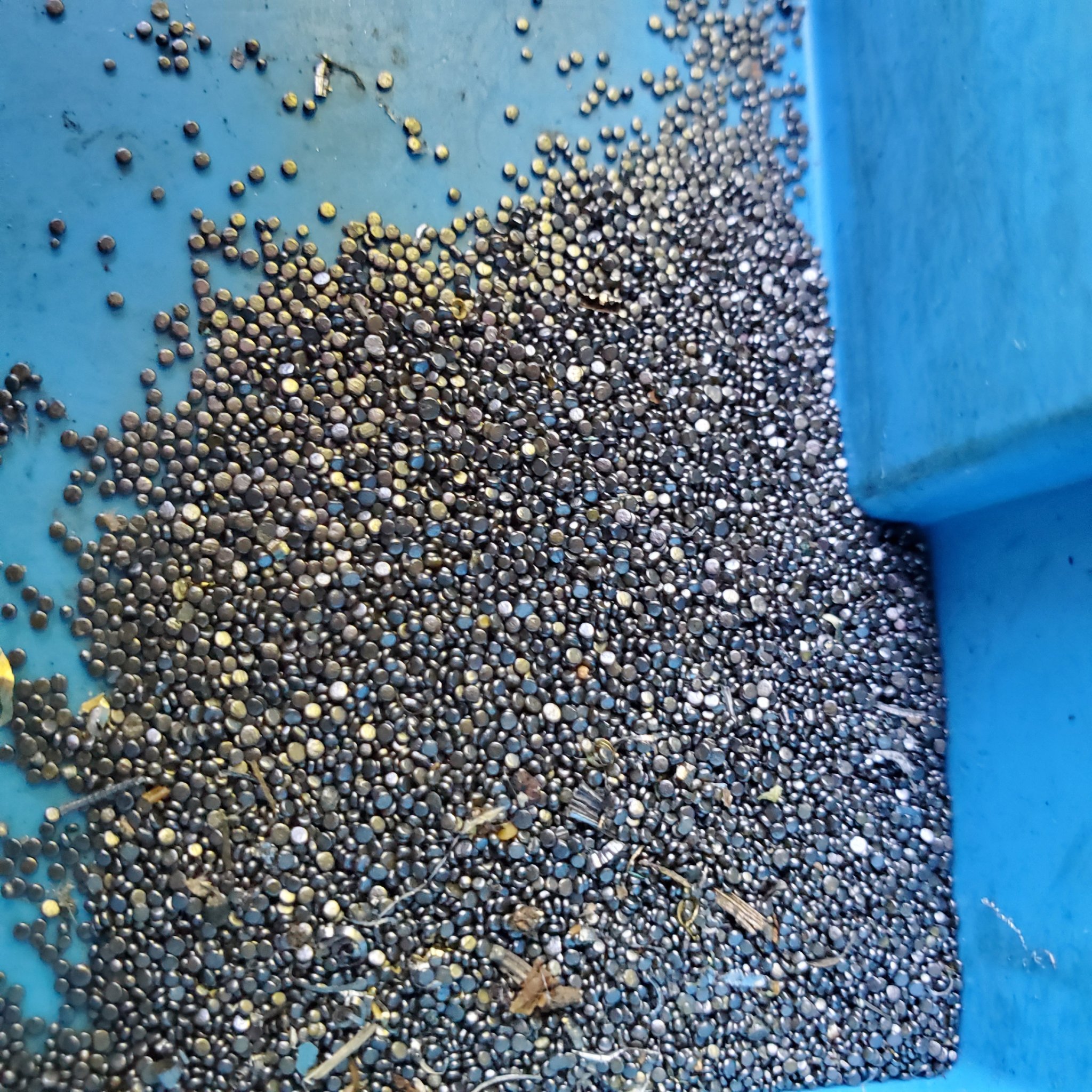

This is the magic fairy dust used in the military cases.
A special flattened fine grain ball powder, is used in the 6.8×51, 80,000 psi cases.
Suitable for burning...no I ain't gonna try it out.

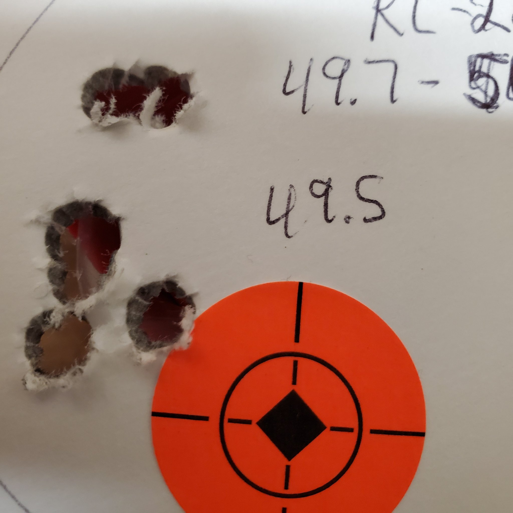

I have a bunch of Lapua SR palma cases but in this test with sected powder they were absolutely the worst in accuracy, standard deviation, and 40 fps lower velocity.
