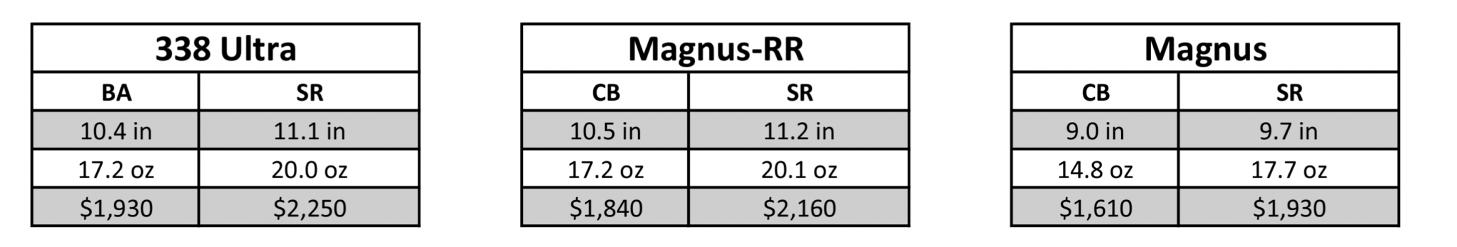

We finally got the Ultra50 out the door. It's unbelievably awesome
We expanded the Magnus line to be 3 different lengths (K, S, and full length); each length is available in .30, .338, or .375 caliber), and each of those is available as a normal can, or with our new RR (reduced recoil / race ready) brake like the 50 has. Recoil reduction on 300WM as an example exceeds 60%.
These are available with four different mount options, some are restricted by caliber applicability, CB, BA, HUB, SR.
I know you can't read the above table-- there is a PDF linked from the link at the top of this post.
We also added the RR option to the 338 Ultra,
Recoil reduction on 338LM is 54% where the normal can is 32%.

It's interesting to see how the respective RR version is roughly only 1 dB louder than their regular counterparts. What's the unit of measurement for your sled energy method? Looks like percentage less than complete distance of the measured bare muzzle.

Sorry, missed that, recoil % is percent of recoil energy reduction.

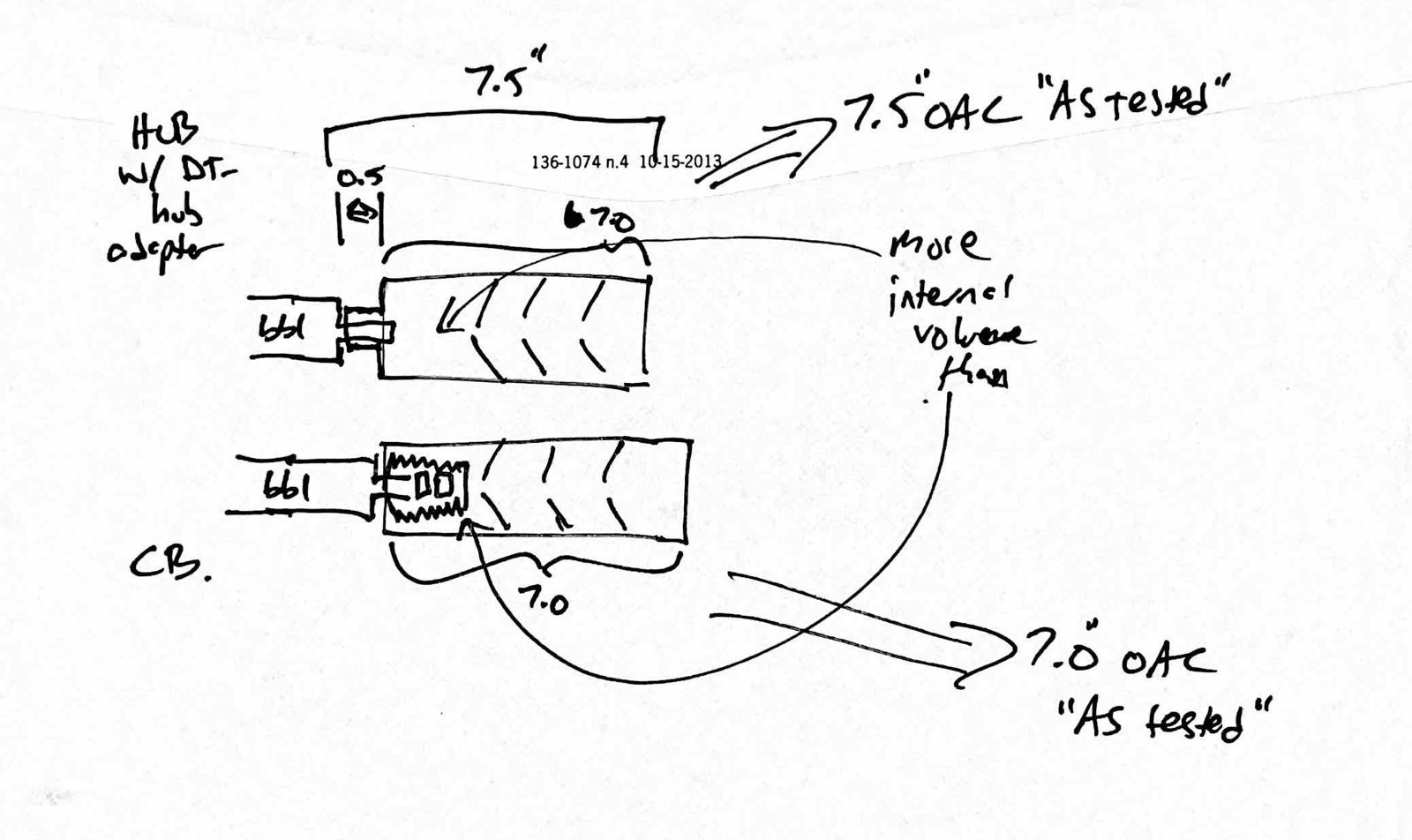

Looking at the summit data vs. this data, the Hydrogen S, they are within 1 dBA at SE and have the same Leq(10ms) dBA at SE. The H-S at the summit was 7.47" long as tested, not sure what that was, that was how it was handed to the test queue.
When comparing the Hydro-S 308 data from the summit and your Magnus-S 308 numbers. The Hydro-S was 142.61 ML-DB vs Magnus-S 144.57 ML-DB. The Hydro-S 135.08 ML-DBA vs Magnus-S 137.37 ML-DBA. The Hydro-S 131.25 SE-DB vs The Magnus-S 133.43 SE-DB. The Hydro-S 125.35 SE-DBA vs The Magnus-S 128.02 SE-DBA. Seems the Hydro is about 2db quieter all around. I'm honestly surprised you guys didn't beat it or at least match it. The numbers on the braked cans are pretty impressive considering.
Maybe next time we're out we can test them back to back to see if that changes anything.
ETA--
Actually, thinking about it, the tested length of H-S was 7.47", which included a DT to HUB adapter. This would use up almost no internal volume forward of the rear of the can, compared to the M-S, which as tested was just 6.9", which includes the mount itself already taking up volume inside the can. I'll see if we can configure a HUB version in an identical way and then test both. I think that will make a mesaureable difference.

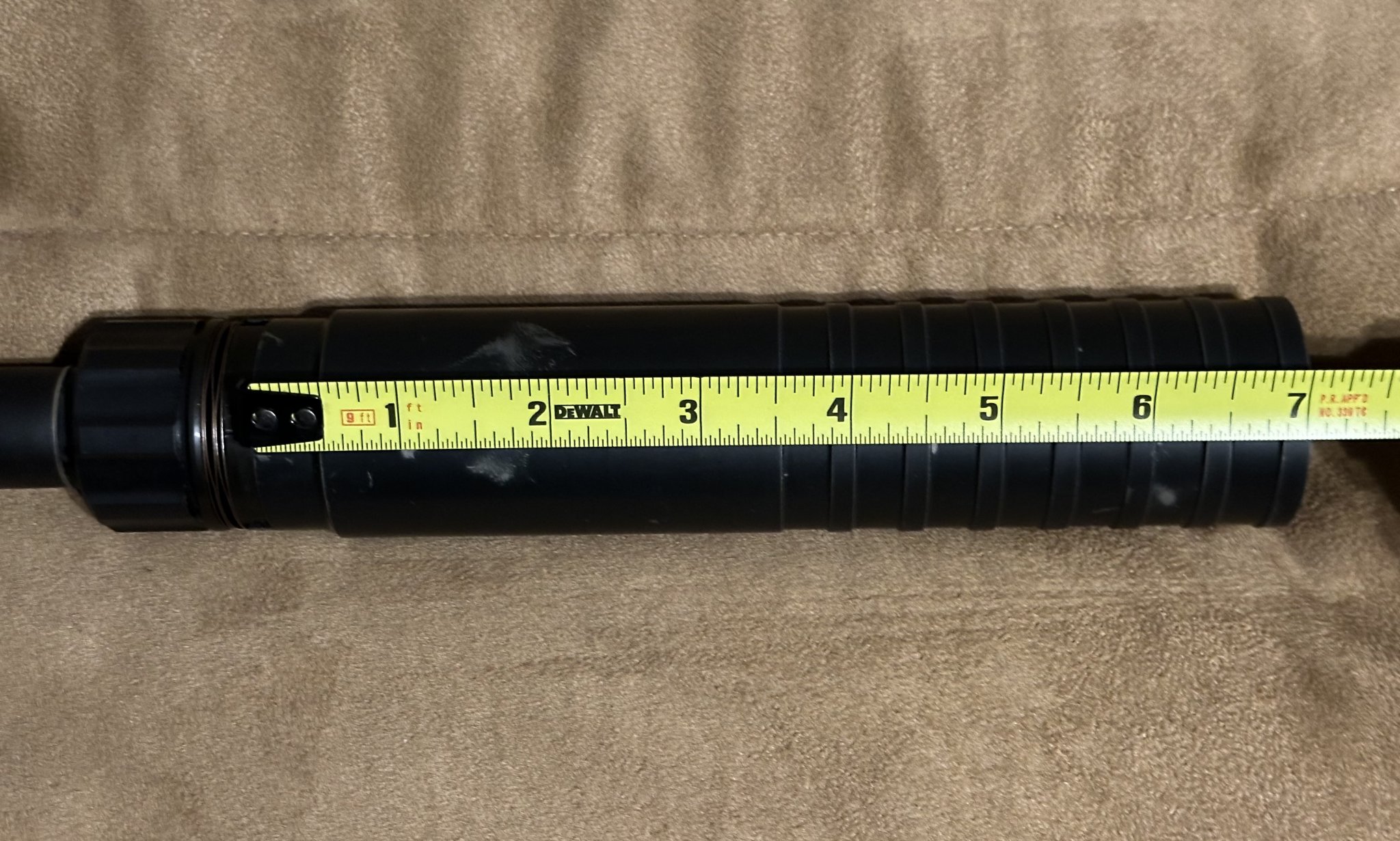

That’s odd the one y’all tested was 7.47”. Just measured mine from the back of the HUB (where the KeyMo butts-up against it) to the muzzle end. Right at 7”. This is Hydro-S serial number 1, for reference. Not sure if something changed down the line, or if that included some sort of weird 1/2” long mount.
*** Edit *** Just saw your next post about the DT to HUB mount. That makes sense.

Before your edit I drew this diagram, so I'm still gonna post it, LOL.
Top is a HUB can with a DT/HUB adapter. Bottom is a CB. Bottom setup takes up more space inside. Top setup has a longer effective length. For Summit testing, we recorded the length "as tested". In your case we would have included the approx extra inch the Keymo adds.
