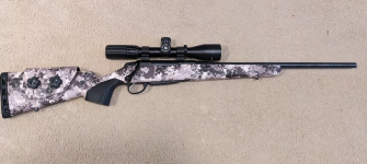

I have a couple of the razor rest ones off eBay. if you don't want to drill the Bradley cheek rest or triad stock pack also would work but a little more expensive. I have a couple of the Bradley's too. This is the razor rest with a wrap on it. on a compact 223
Sharp looking stick there. I like the wrap.
I could, and have, installed that type of adjustable rest, but my strong preference is for something that doesn’t snag like those knobs will. The OEM cheek riser would be ideal, but I have stock packs on two other rifles, so may go that route. Still exploring my options with this…
