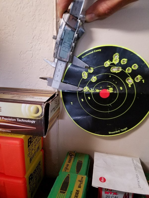

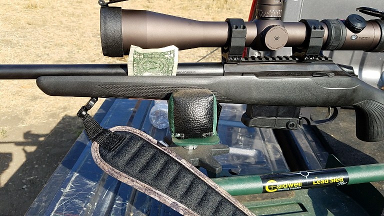

Got excited to finally shoot my new 6.5 Creedmoor after the 10 day waiting period (yes Cali). In hindsight, I wish I could've used those 10 days to talk with Tikka regarding their 1" moa "garauntee".
Set up: Tikka t3x ctr 6.5 creedmoor, Vortex HD 5x20, Seekins Precision rings.
First 5 shots I got the rifle within 10" of the quarter sized target. Next 3 shots I walked towards the target. Thats when I noticed something was up. I stopped. Let the barrel cool completely. Shot a 3 shot group. 2 of the shots were low 4" and 2" right of target (and 1.5" apart from each other). 3rd shot was high 3" dead center of target.
I rechecked all screws on scope,rings,mount. Good to go. Next I checked the screws on the stock. Good to go. Next I got a dollar bill and checked the free float of the barrel. After multiple attempts, the bill would stop 3.25" from the reciever. Meaning the bill was wedged tight and was about to rip.
First break in shots were with Hornady 120gr GMX Full Boar. This next group I tried after the free floating experiment. Was Hornady 120gmx Superformance. 3 shot group. A almost perfect 3" triangle. 2 holes were 3" apart, the 3rd was 2.75" from the other 2. I loaded things up and headed home after. Gun has 13 shots thru it only.
Any guesses?

Ive never owned a Tikka before. But my barrel does not appear to be free floating. Unless thats the way they are. Tikka owners chime in.

I had to do it to my T3X. Barrel made contact with stock 3" out from the receiver. Took some time with a dremel but it's solid now.
I don't see this being just from the barrel not floating. A lot of times a rifle will actually shoot great with pressure points and even when they don't it's not as much of a difference as you're experiencing.
It could be a combination of pressure points and ammo and/or something else. That Hornady Superformance ammo is absolutely terrible, I've never had a rifle to like any of that stuff and it's usually over pressured.
I I know you checked your mounts but did you verify with another optic? I'd check that too.
There's something amiss with this statement. Five shots just to get within 10 in. of zero, and another three to "walk it in"? Once you have one shot on paper, the very next shot should be on zero if everything is working right. I've not seen many guns shoot that badly. I'd suspect scope, ammo (not really, but I have no experience with lead free stuff, so maybe), or shooter (no offense, but since we don't really know you...). Swap a scope off one of your other rigs that you trust. First thing I'd do (no question) right along with one of the match loads from Hornady (140, 147 ELD). If still no good, have a PROVEN shooter give it a go. Betcha one of the three fixes it. Otherwise, it needs to go back to Beretta because there would have to be something REALLY wrong with it.
Oh, and get it out of that freaking Lead Sled! If you're an experienced shooter, what are you using that thing for? It will not shoot as well in there as it will off a bipod and rear bag with proper technique.

3. The lead sled is for holding up my rifles while I clean/check screws etc. I had found some rifles like them,some dont in the past. All shots with this rifle were with bags front and rear.Letting the rifles harmonics do its natural thing.No bipod due to weight.

I think most people are trying to tell you the gun is the least likely to be at fault. Am I misunderstanding, or are you just wanting to dump the gun without any attempt to find out? That's fine if that's what you want, but it only takes like five minutes to unbolt a scope in the rings from one rail from one of your other guns and torque it on another, then two shots to re zero. Also, go to Ammo Seek and you can find Hornady 140 eldm for about 22.00/box. Doesn't matter if you can't hunt with it. You just want to find out if your rifle is defective. (It just occurred to me that maybe you can't order ammo in CA?). Anyway, it makes no sense to send a rifle down the road when the ammo is the issue, because you'll still have the problem with the next one. There's just way too many CTRs shooting incredible groups out there to suspect it as the problem. Possible yes, but definitely least-likely. The Barnes ammo would seem to be a possible upgrade over the other non-tox loads, but again I don't have experience.

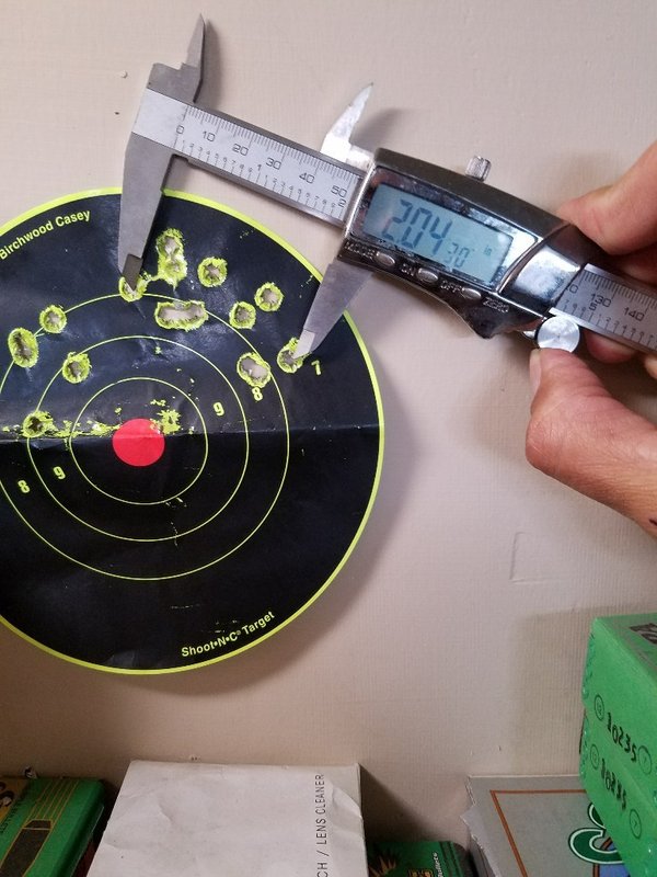

I appreciate everyones helpful advice and comments/opinions. I drove outve town and found a box of the Hornady 143's and 147's.
-5 shots,left grouping) The 143's grouped 2 touching holes. Then have three, 1.5" average spread flyers.
-12 shots,right grouping) The 147's would group 1 to 2 shots. Then have 2" to "3" flyers.
Cleaned the barrel. Fired a few rounds. Then tried grouping again. (Note: in the pic, not once did I change the windage or elevation on the scope from yesterday. Aiming center orange.)
Its a Catch 22. Its sounds counter productive to keep pouring ammo down range if its not shooting well correct? But... I had to know what different ammo would do? 4 different Hornady bullets have thus far,not been efficient in this rifle. So after the price of the rifle + the price of the scope + rings = basically 3 grand. Including over $60 in ammo down the barrel. I unfortunately do not have a rifle to use for deer hunting. Which starts in 3 weeks.
I realize its easier to discredit the shooter. Than it is to discredit the rifle/ammunition/optics. BUT. We all know nothing is made 100% perfect ...ever. Hence the reason for warranty and returns. Now do I try sanding the stock/sending it to a gun smith/letting another shooter take it out/switch out scopes (and waste time and ammo re-zeroing those rifles after)? Buy brass/different powders/different bullets reloading and go out multiple times shooting?In hopes it does fix any issues? Or,send it back and cut my losses on the ammo now...
My mindset going into this rifle was an easy 1" moa out of the box hunting rifle. I planned on using my OCD resources elsewhere,and not on a rifle for once haha.Trust me, Im bummed. I even threw away the rifle box because I had that much faith in the reviews and good things regarding this rifle. I appreciate everyones thoughtful and helpful advice. Which does work in most problematic applications.You guys have a wealth of knowledge. My responses arent intended to argue. Its more of me thinking outloud and sharing my view point as well. But we all know, sometimes a person just gets that "one" rifle. And we've all been down that road.
On a side note, I was really wanting a Bergara B14 HMR. But availability was a negative before season.So I got this Tikka.
