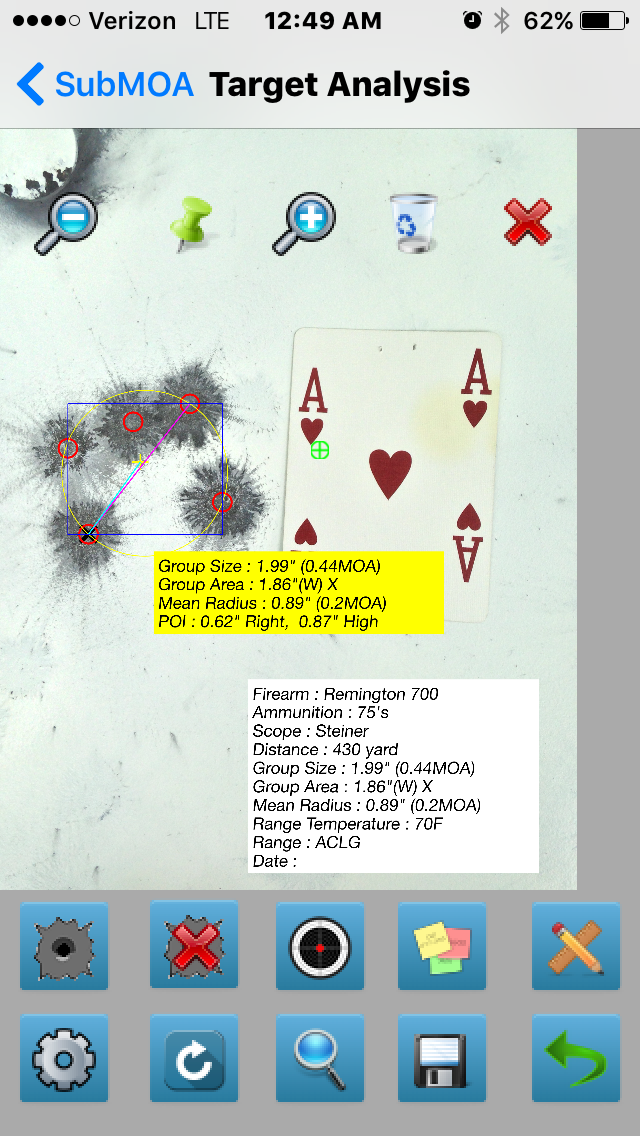

I have a Savage Stealth Evolution in 223 - also 20" and 1:9 twist. Shoots 75 ELD-M's beautifully out to 1K. If no wind, it will put 5 in a row on 6" steel @ 940. In the wind, tough to get 3 in a row on 10" steel. I have some 80 eld-m's loaded but haven't had a chance to try them yet for stability.
edited to 75 eld-m's - thanks to MarinePMI
I didn't know Hornady made a 77gr ELDM bullet...
Sorry, meant 75 eld-m. Went to my notes for detail... my load is 23.7 grains N140 @ 20 off. The 80's I loaded are with 203b and are 15 off, which is 2.396 in my rifle, but unsure if they will stabilize in my 20" 9 twist. The 75 eld-m does shoot better than either the 69 or 77 smk's for me.
