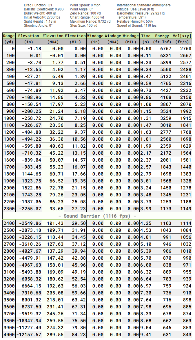

Your scope has 36.1 Mil of elevation adjustment. If both your rail and mount added nothing to the equation, then you'd be looking through the center of the scope and would be able to adjust up and down equally (36.1 Mil/2 = 18,05 Mil each way).
As it so happens, this would probably be about what you'd be dialing at 2000 yards - not exactly sure because I have no idea what bullet/powder/velocity you're going to be at.
Now, your current rail is 40 MOA, which is 11.63 Mil, meaning you could now dial 18.05 Mil + 11.63 Mil = 29.68 Mil of elevation. Again, I don't know exactly what you're shooting, but that would be getting you probably close to 3000-3300 yards.
You could conceivably get another 6 Mil and change and still zero at 100, but you'd be just short of adding a 20 MOA mount. You could add a 10 MOA mount and still not be looking through the edge of the glass - not sure it's worth it until you work your way up to those ranges.

Based on my current ammo, and how I sighted it in (0 mil mount and 40 mil rail), I can barely go past the 100 yard zero. I can dial up (which moves my crosshairs down) a little over 3 full rotations. Which with my scope is ten mil each rotation, or 30 mils of total travel. Based on this chart, I should be good for roughly 2400 yards. Would you agree with that?

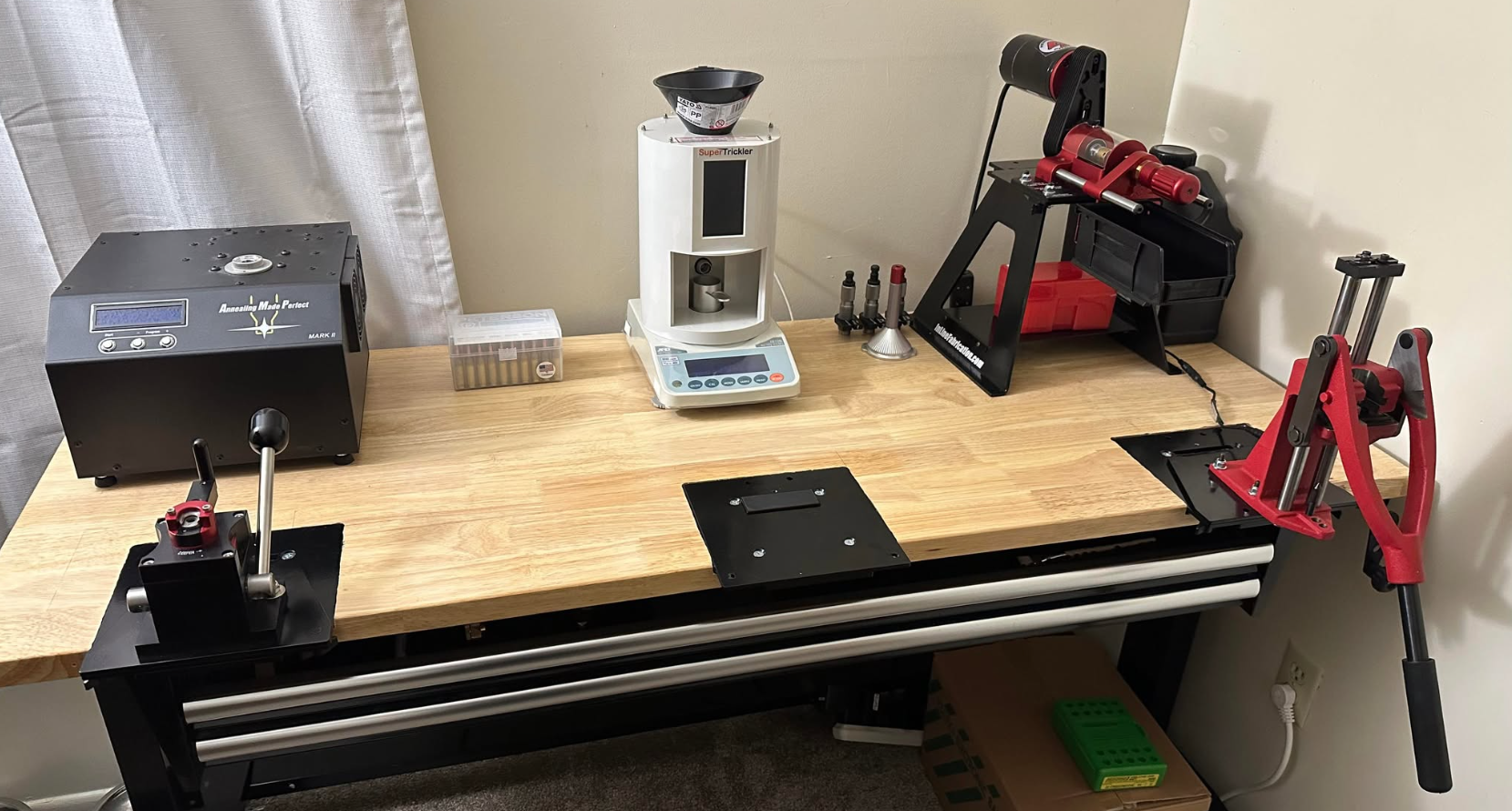

As you can see below, I'm all about "buy once cry once"... I just want to make sure I get the best tool for the job. I'll start researching the PraziPress. @A5scott have you used both the Forster Co-Ax XL and the PraziPress?
