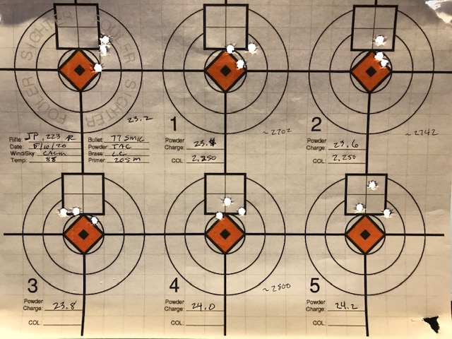

    I tried a Round Robin OCW test yesterday on a new load for my .223 JP AR-15. I already have a good load for it now with XBR and 77 SMKs. But I wanted to work up a Varget and TAC load as I'm running out of XBR and it seems unobtanium at the moment, but I've got lots of Varget and TAC on hand. I'm not new to reloading, but I wanted to try the OCW method that is all the rage. I read Dan Newburry's page and followed the instructions to the letter to determine the powder starting charge and the increments. So here are the results.
    Varget load w/ 77SMKs with 5 steps
    TAC loac w/ 77 SMKs with 6 steps. I had to use the fouler target. But I did shoot a set of foulers on another target with TAC to get the barrel reset to the new powder.
    These were all shot in a round robin style just as the OCW instructions suggested.
    My previous method of finding the "node" was to shoot 5 shots groups @ 100yds of each powder step over a chrono and compare group size and ES/SD and then go back and reshoot the ones that looked to shoot well adjusting the seating depth up and down. It always seemed to work well for me in the past. I understand that the OCW method uses neither chrono data or group size to decide on the OCW, so I'm totally confused as to which of these groups the OCW camp would choose and more specifically WHY?
    Thanks in advance.
    23.4-23.8 of varget are all impacting in the same relative area at the top of the diamond in relation to the point of aim. So if it gets hot or cold or you throw powder a tad high or low it wont change where the rifle is actually aimed and the bullet is going to go.
    So I would take that 23.6 right in the middle of the range and work on the seating depths to try and time the bullets exit from the barrel to get it to group small.
    For the TAC loads Im seeing that 23.8-24.2 are all about the same position as one another so I would look into that area with seating depth as well.

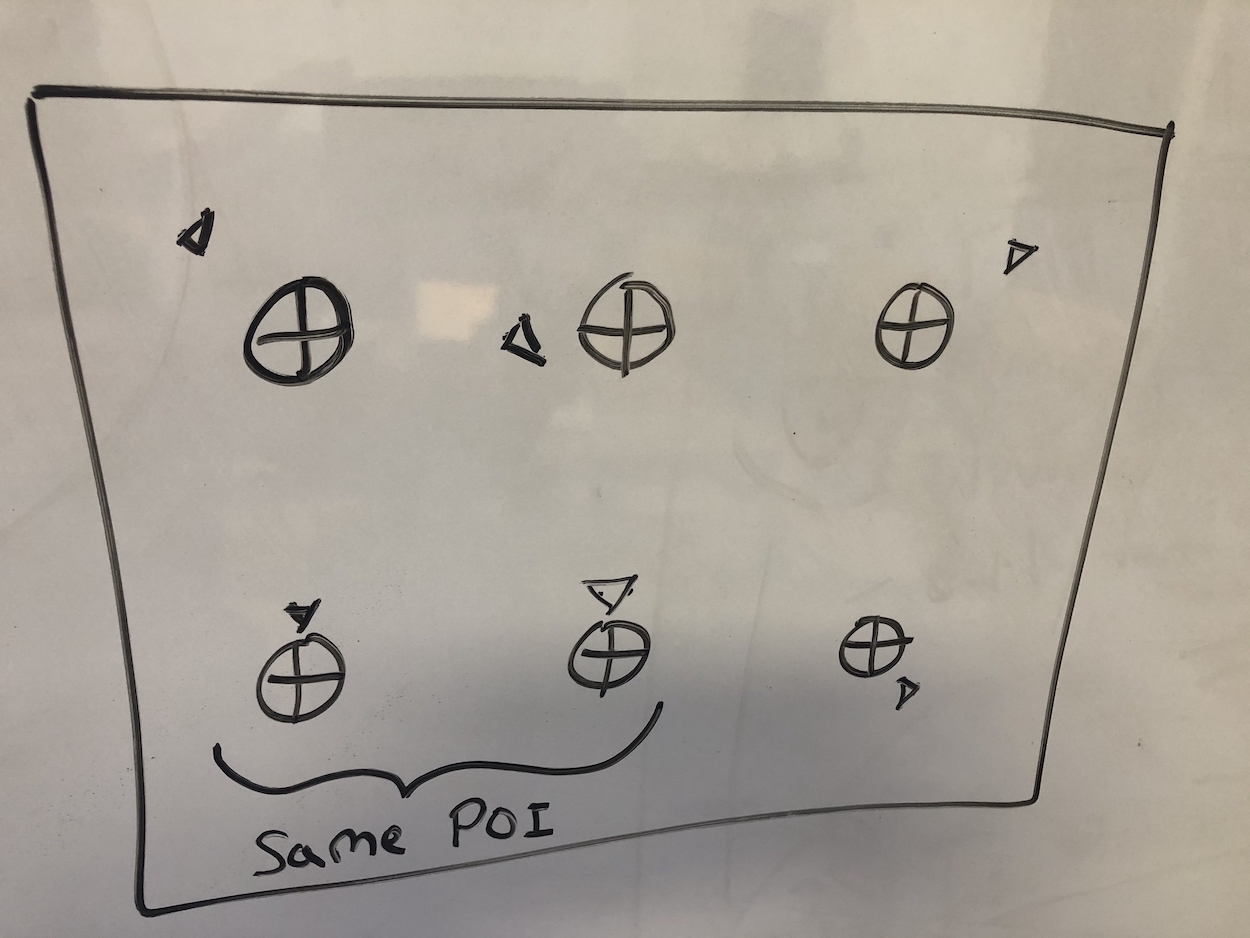

    Its all based on POI... If two different charge weights, lets call them 30gr and 30.5gr, impact at the same POI, that means that even though theres a difference in charge weight, the bullets still hit the same spot. That translates to distance as well... and allows a charge weight to be more forgiving because a mild change in powder/velocity doesn't change the POI as much, resulting in better precision between shots.
    Heres a diagram.... The little triangles are the 3 shot groups. See how each target has a different POI, but then two targets in a row are the same.... Those two charges would be your NODE (30-30.5gr)... the OPTIMAL charge would most likely be in the middle, lets say 30.2-30.3gr.
    Ahhhhh, Ok that's actually making sense now. So it about where different charge weights impact relative to the POA rather than the group size itself. That was my initial observation on the Varget string above, was that they all wanted to impact at the 12 o'clock tip of the diamond. I think my issue was I wasn't seeing as much of a "scatter" as your drawing above shows, but that makes sense now. Huge thanks.
    Cool, thank you! I will get working on those. I was initially disappointed in the TAC performance, but it has worked well in previous precision AR's, so I'm sure with some tweaking it will come down.
    Presumably with OCW, it will in theory account for Hot and cold changes throughout the year if a given powder is sensitive to temps (for instance TAC)? Correct?
    Unfortunately its never as easy as the diagram I drew LOL... I wish it was.
    It's one of the downsides and criticisms to the OCW method is that it's often hard to interpret. Also, if you throw a flyer and aren't experienced enough to know you threw it, then it affects the center of that group.
