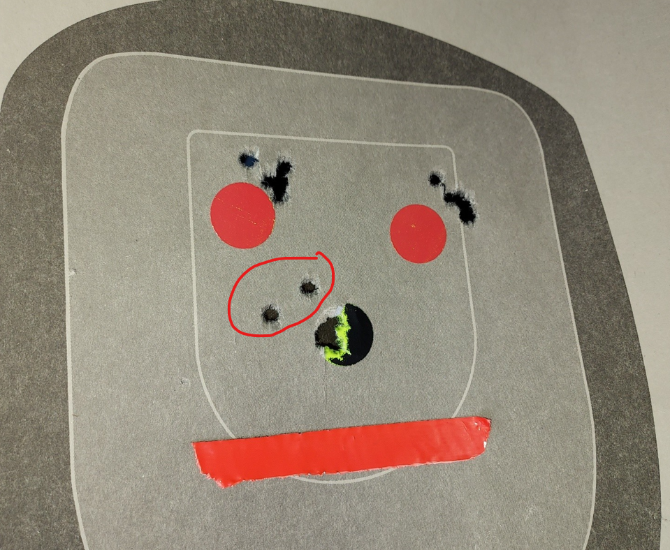

I just took a first crack at developing two inital loads for a friend who has a Ruger RPR in 6.5 CM. The top two eyeball shots were with the 147 ELDM's and the nose shots were with the 140 match burners:
My son was not taking his time and had the two flyers. These are at 100 yards. Loads are:
Burner BT Match140gr2.770H4350
41.50​
RPRSimilar POI to the 147's. Good load.
Hornady ELD M147gr2.800H4350
41.00​
RPRyesCurrent go-to load. 41.5 or 41.6 would be the next test.
From what I read here on the Hide, 41.5 ish is the shit. I did not measure velocity or SD/ES as this was just a favor to a PITA friend. Maybe it will give you a good place to start.
My son was not taking his time and had the two nose flyers. These are at 100 yards. Loads are:
41.50​
41.00​

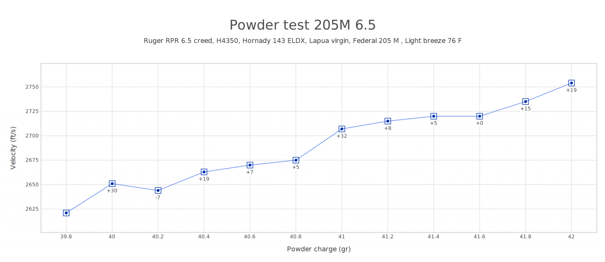

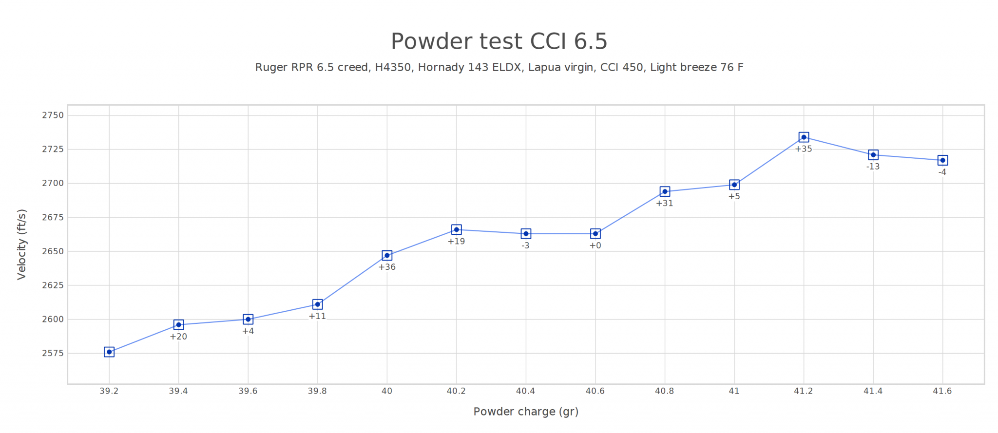

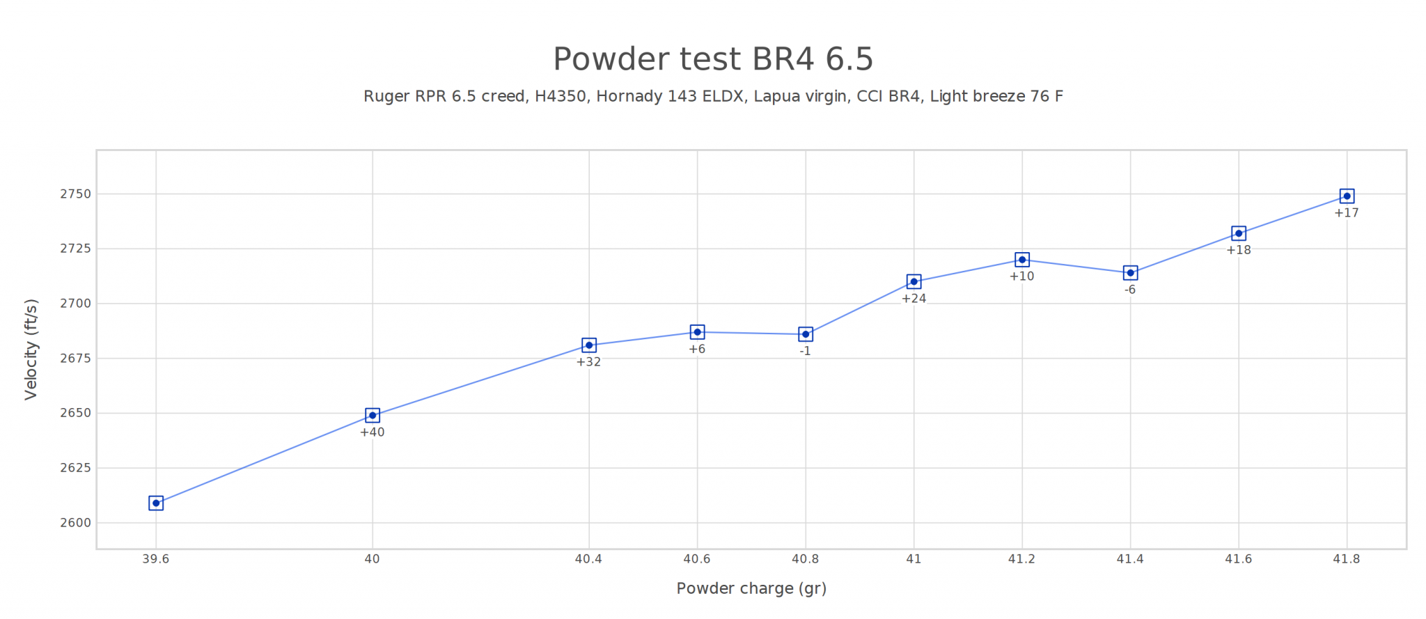

Im just developing a load for my Stock RPR and this is what works well in my rifle. Probably going to do seating depth test at 41.5. Havent pushed it much but there may be another node in the 42 gn range. These are based of a single shot. 205m seems to be the best for my rifle.
View attachment 8237650View attachment 8237655View attachment 8237652
Sorry to say that one shot velocity ladders are a waist of time as they really tell nothing. Repeatability is really what it's all about and if you repeat those loads (exactly as loaded) you'll find you can't repeat what you see here. The more shots you take for each load results in a pretty liner line with no "flat spots". Better to shoot 3 shot minimum per load and let the target tell you what's working best.
They give you an idea of pressure and an idea of the velocity range you will be in. I usually shoot them when i can't find load data. Or when looking for the top end of what an OCW test will be. If if a guy shot 30 per charge in a "velocity ladder" a flat spot would still be an anomaly.
Reactions: straightshooter1
Yup, it's a good way to pressure test and see where the limit might be . . .
. . . even when there's load data available. ;)
