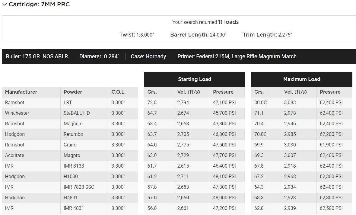

With powder being $60+ a pound Whats a good powder and load for the 7mm PRC with a 175 ELDX or 180 Berger? I have on hand some 7977, 8133, RL22 ,RL23. All apparently all unicorn dust now a days. I do not have any H1000
IMR 7977 will be your best powder for that cartridge and bullet.With powder being $60+ a pound Whats a good powder and load for the 7mm PRC with a 175 ELDX or 180 Berger? I have on hand some 7977, 8133, RL22 ,RL23. All apparently all unicorn dust now a days. I do not have any H1000

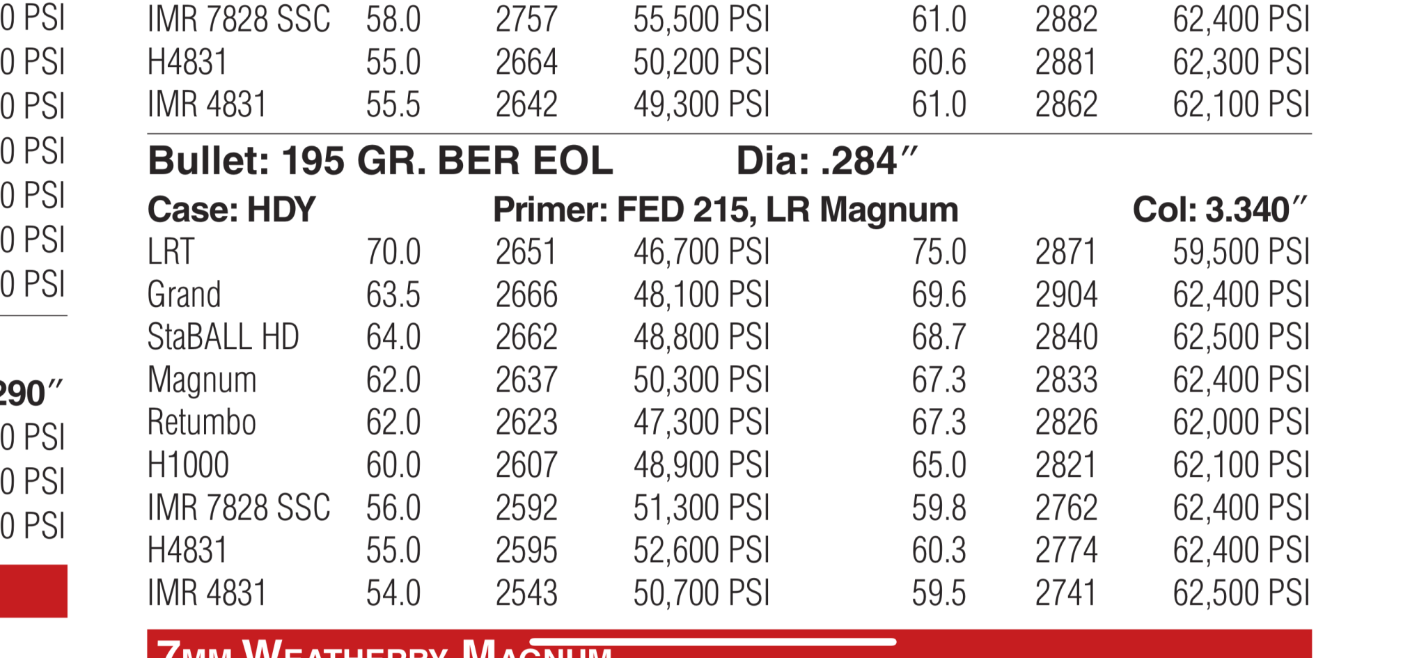

Well, I’ve been testing some 197 SMKs with StaBall HD and so far the speed numbers aren’t just super impressive. Only getting about 2675 FPS the SD is in the single digits, but the speed is not there.
What barrel length?That the same exact book and data I’m using. I went and shot some H 1000 with those 197 just a few minutes ago and the speed is dismal in my opinion but I keep telling myself that’s almost a 200 grain bullet.
Because it hasn't even been out a year yet.I see Grand listed with good FPS, but I never see anyone trying it, is there a reason why?
I wasn't aware of that. It's one of the cheapest powders at Scheels, that would be great if it works well in the 7Because it hasn't even been out a year yet.
That's rough. I really would have expected performance closer to book than that. I get pretty much bang on what you'd expect based on that data. 168 LRX running around 2815-2830 from a 20" barrel on 70.8gn StaballHD. According to Barnes, I could even go up to 71.2 and maybe push 2900.
