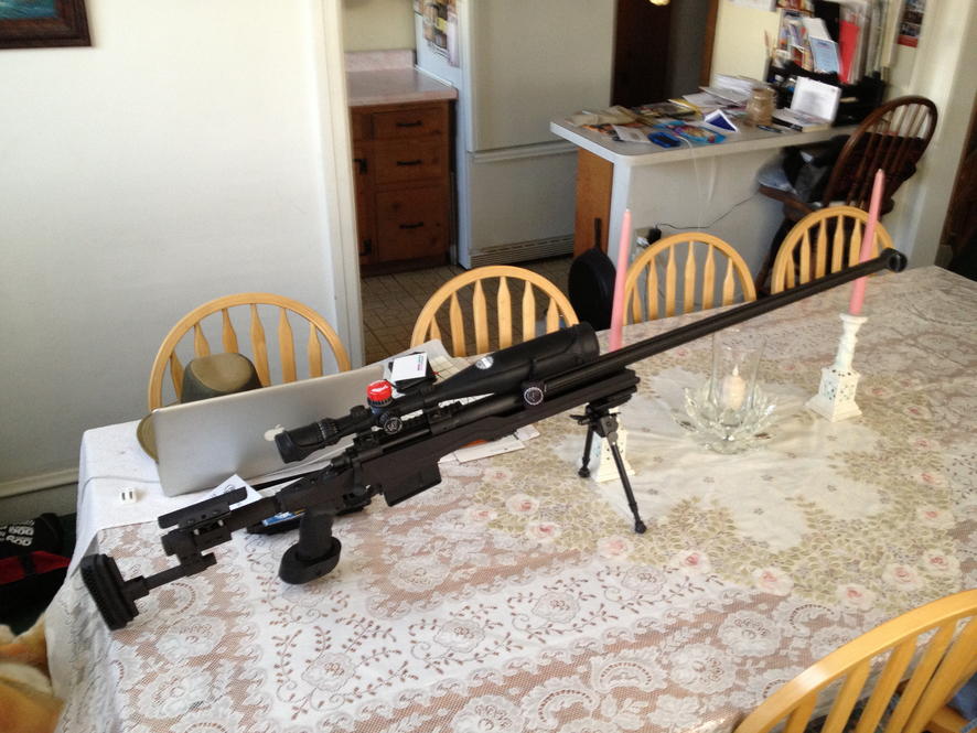

Thanks for the info. I have the info I need to work it up. Do you have any pics of that rifle on here?

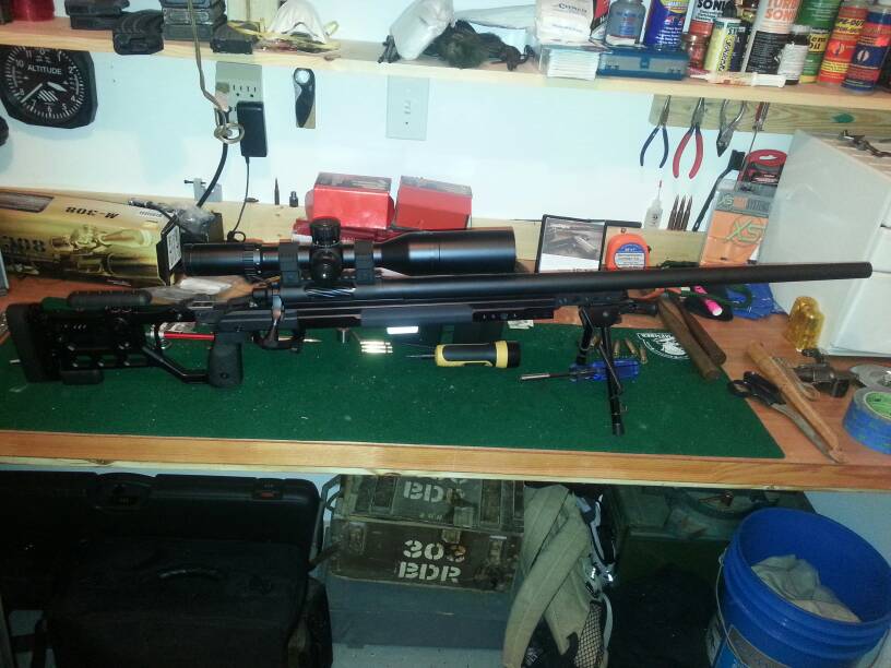

I decided I am going to leave it at 28" for the time being. If I find it is too ridiculous then I will get it cut down, but it appears it will work for my purposes. I never mentioned that it is being built by Greg Young at bugholes.com It is good to see positive reviews of him on here. He said it would be a couple of months, so maybe sometime in February I will have the barreled action and I will throw up some photos. The more I look at the Whiskey 3 the more I like it, but I have not gotten any responses from KRG when I have tried to contact them about it.
Very nice!!! Now go out and shoot it!! We want pictures of your targets next.
Thank you for sharing and if you need help, just ask us. We enjoy getting people on the right track, as you are now.

I will slow down the posts in my own thread after this, but I want to put a couple of thanks somewhere in the public domain to recognize some folks:
KRG - Dealing with the guys there has been great, and they went above and beyond in terms of service with me changing my chassis order up the day it was to ship and still getting it out the same day. I did not do my full due diligence and I thought I could eventually switch a fixed version to a folder, but found this was not the case and switched to the folder. They were more than accommodating and I would recommend them to anyone.
Southern Precision Rifles / bugholes.com / Greg Young - Greg spent more time with me on the phone answering questions and educating me due to my novice knowledge than I would ever expect someone to. Everything he told me in terms of delivery dates, etc. was spot on and I could have taken that information to the bank. He built a sub 1/4 MOA barreled action for me for less money and in shorter time than any other smith I could find. Thanks Greg! I know from reading on this forum a lot of people just use him to buy components, but he is good to go for builds!
