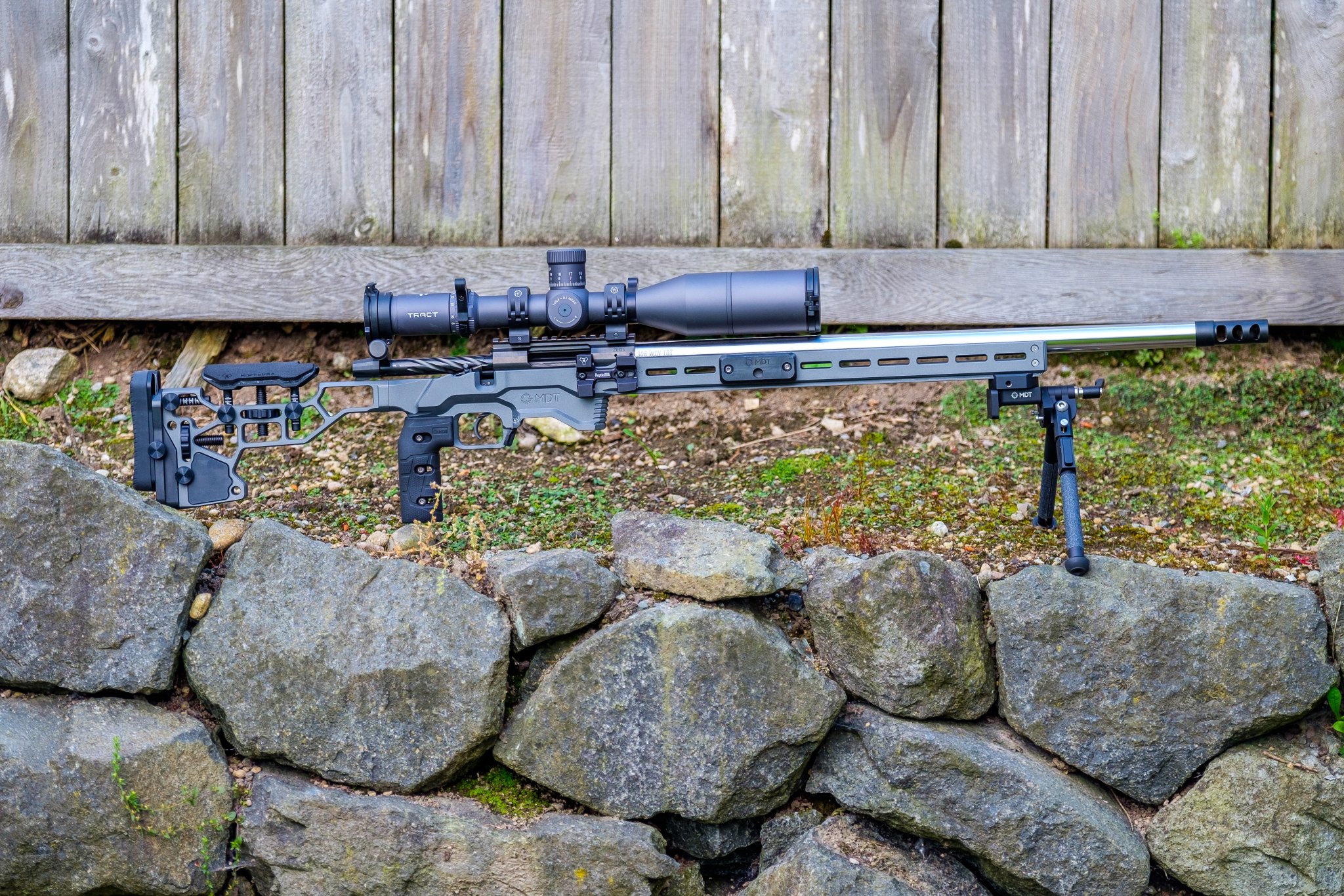

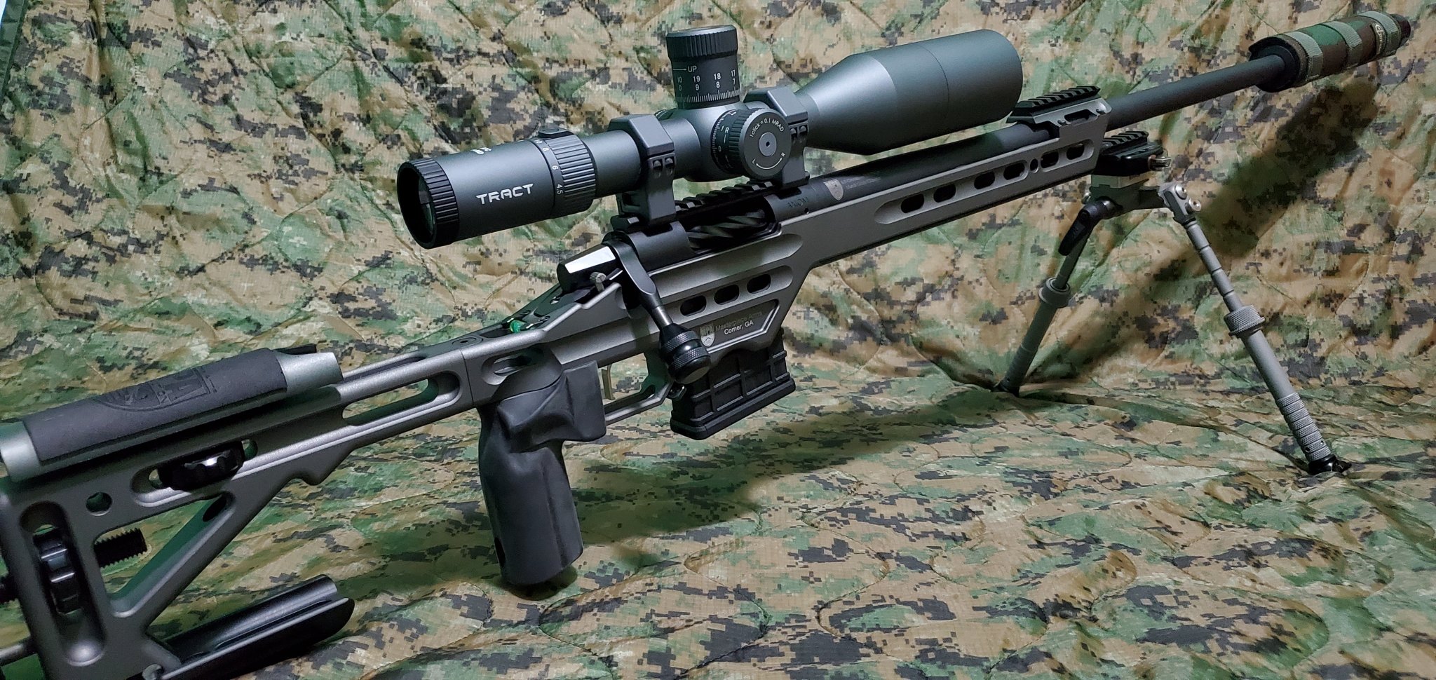

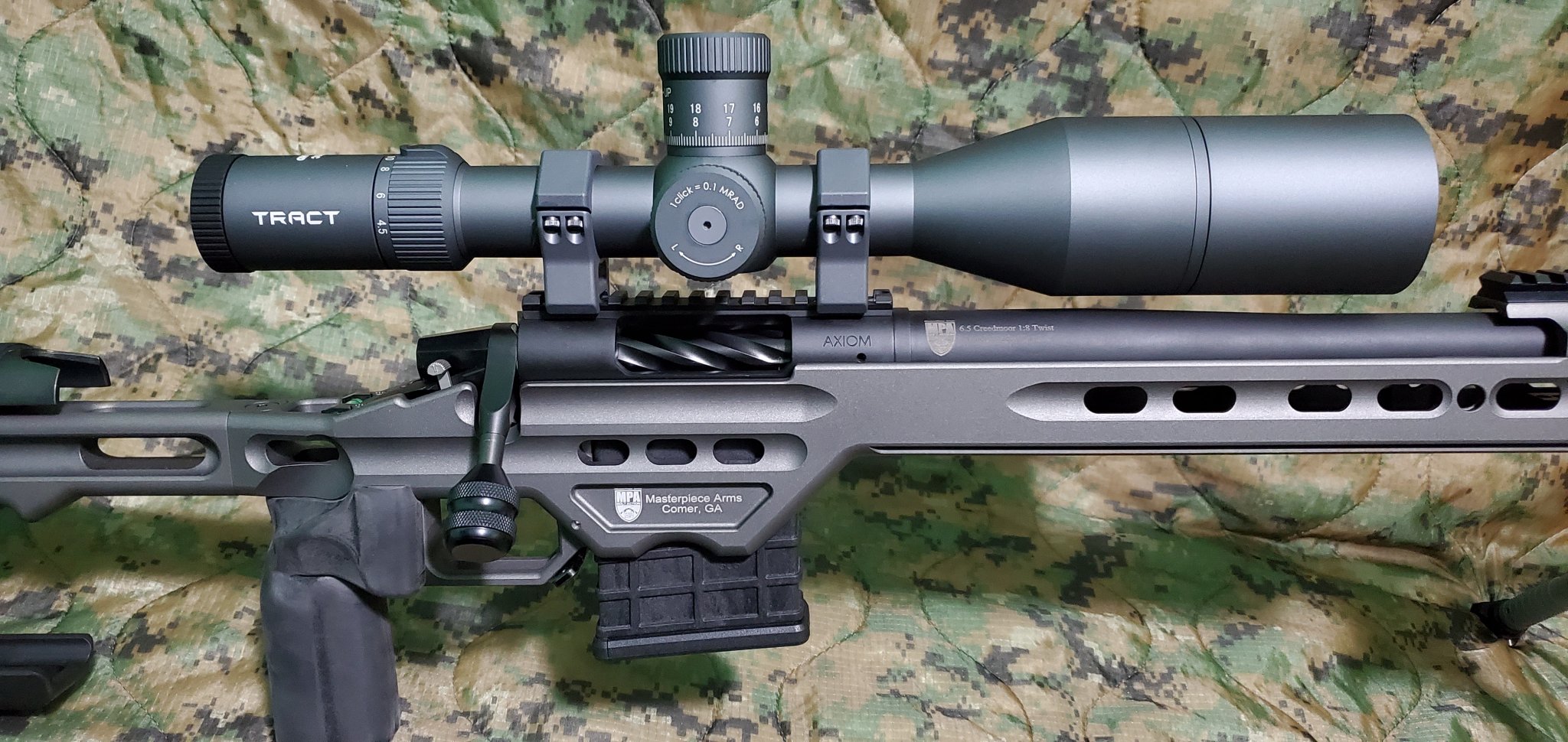

Yea.. mine came in today also.. Temporarily on this PRC until my XTR 3 gets back from RMA.
Some of my thoughts so far. Just my opinion..
Build quality seems outstanding. I'm impressed.. Magnification and paralax knobs are smooth from end to end. The paralax knob is pretty comparable to my XRS 2. They seem to be just right and good enough to zoom in and out easily without a throw lever but not too easily turned when bumped.
The turrets on this scope are not as crisp as I'd like them to be. They are somewhere between a PST gen 2 and a Razor Gen 1. My midas tac, Arken and Ares ETR are definitely more aggressive and crisp. I do love the ability to lock them on this toric. The zero stop was easy to set. It it very audible when you hit the stop and does not get stiff as you get closer to the zero stop like some other scopes.
The illumination of the reticle is nice and bright on max and so dim on low setting that I couldnt even tell it was on.
The glass looks very nice. I have not used it at far distances yet because I already mounted it and don't want to freak the neighbors out. Looking through the window, it is very good. I will bring it out to the range this weekend and try to give more of my input soon.
It seems like a solid scope at the price point. I didn't get any instructions with the scope, so I'm not sure how the zero stop needs to be adjusted.
In the box is a zero stop ring. After you zero your rifle, remove the elevation turret and insert the ring in the elevation stem and turn it clockwise until it contacts the stop and won't turn anymore. When it stops, tighten the 4 hex screws on the zero stop ring. Install the elevation turret and you should be all set.

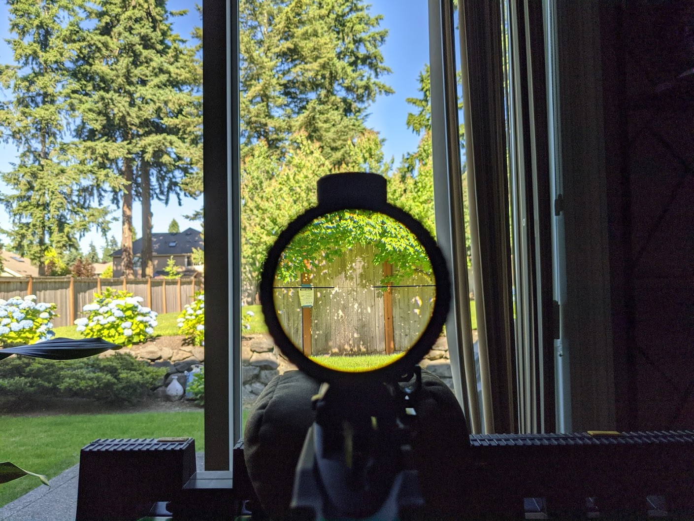

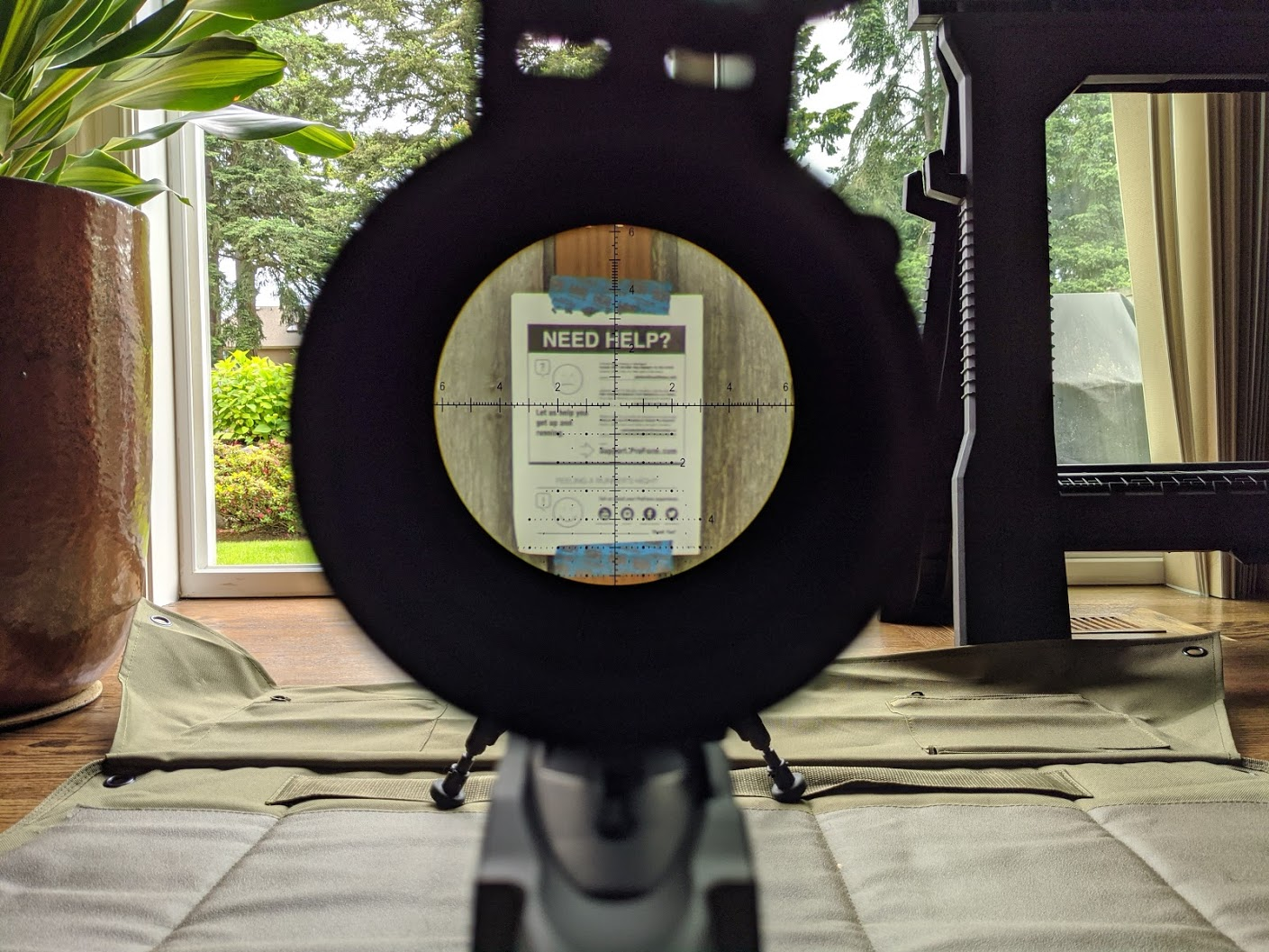

Took it out today, 100-600 yards. Comparison scope is my Athlon Ares ETR, which in my opinion the glass has held up very comparable in terms of clarity with decently high end scopes.
Originally spent a lot of time comparing quality at a closer distance, 35 yards in my backyard - This is at 30x.
Comparing to my Ares ETR @ 30x -
At 35 yards, the ETR is a tinge sharper/crisper. Dialing down the scope to 20-25x, the clarity on the Tract gets a lot better. This is just for 30x at 35 yards.
I spoke with Tract and they mentioned the scope was meant for longer range distances and to try it out further. Took it out to 100 around the house, and couldn't tell the difference between the Tract/ETR.
FOV @ 30x are identical between the Tract and the ETR. FOV @ 4.5x on the Tract is larger.
Went out today to 600 yards. Had a few people behind both scopes, they all liked Tract's thinner reticle. They couldn't tell the difference between the glass and didn't have a good winner. Now the ETR is very good glass - I've run it against AMG's and NF's and I think it holds well in terms of just comparing the clarity.
In terms of getting behind the glass, parallax, eyebox. Winner to Tract. It's hard to measure and judge eyebox, but I know different people found it easier to get behind the scope not hunt.
Parallax, super smooth. Can adjust it so easily and be so precise with it. I never liked the parallax on the ETR and found it way too finicky. Winner to Tract.
Turrets - locking turrets felt great. The hashmarks lined up perfectly, which is a definite pet peeve of mine and my ETR is a teensy off which annoys me. The clicks though are soft. The ETR clicks are much crisper and more pronounced. I don't think there's anything wrong with the clicks, just used to a bit harder and more aggressive. The locking mechanism is smooth. One thing though is the turrets on the Tract elevation is super tall, might get in the way of things.
Overall build quality is really nice. I do like from aesthetics the shorter body of the Tract. The craftsmanship is pretty top notch. Packaging materials were great - minus no instruction manual. I did find the same YouTube video above to set zero stop so no big deal.

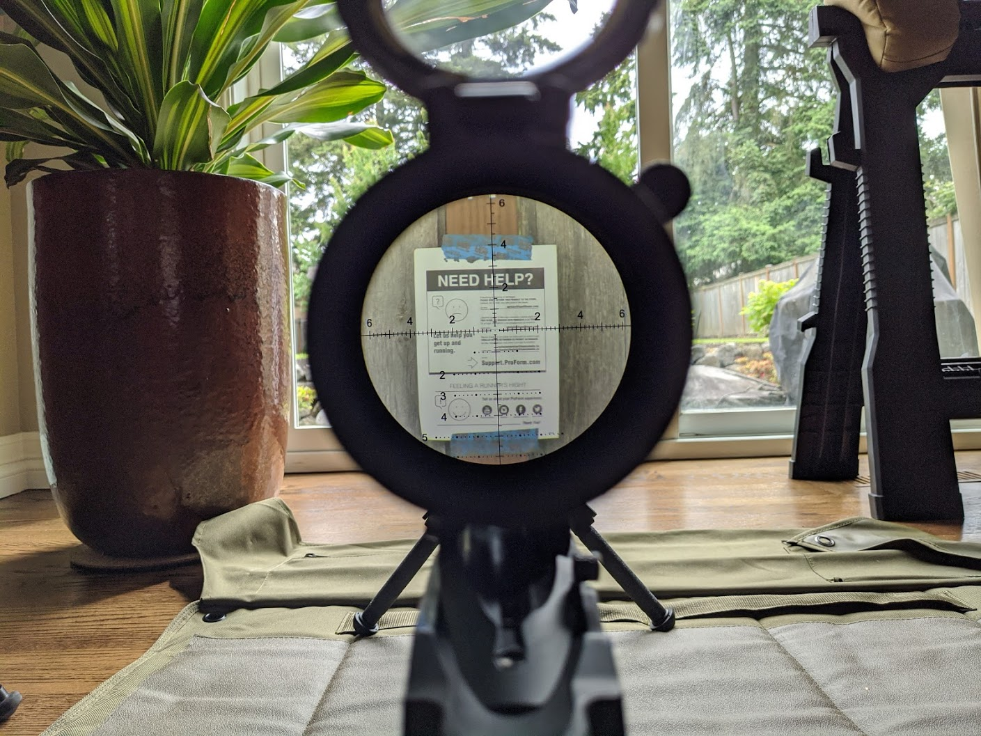

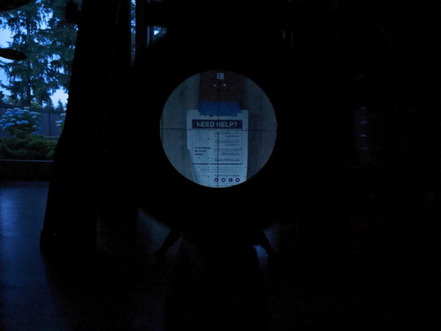

My only issue so far, with comparison is 30x, @ 35 yards as shown in the reticle pictures above. The text is visibly clearer on my ETR @ 30x @ 35 yards. When I zoom out the Tract down to 20-25x, the clarity becomes better.
When comparing out to distance though I see no discernible difference at 30x. I shot 30x at 100, 200, and 600 yards yesterday and did not notice that the Tract was lacking. I also didn't notice that it was significantly better than the ETR either. Maybe I just have a really fantastic piece of ETR. Now seeing 30cal holes on paper at 100/200 isn't that hard. I'll shoot my rimfire today or tomorrow at 100/200 which I know is the edge of me seeing my groups with my ETR. It's a bit overcast and rainy today, so I'll compare it with the Tract. I'll try to snap some photo comparisons of 30x at 100/200y if I get it all setup.
I will see if my friends with an ATACR and S&B will be around this weekend to also do some comparisons.

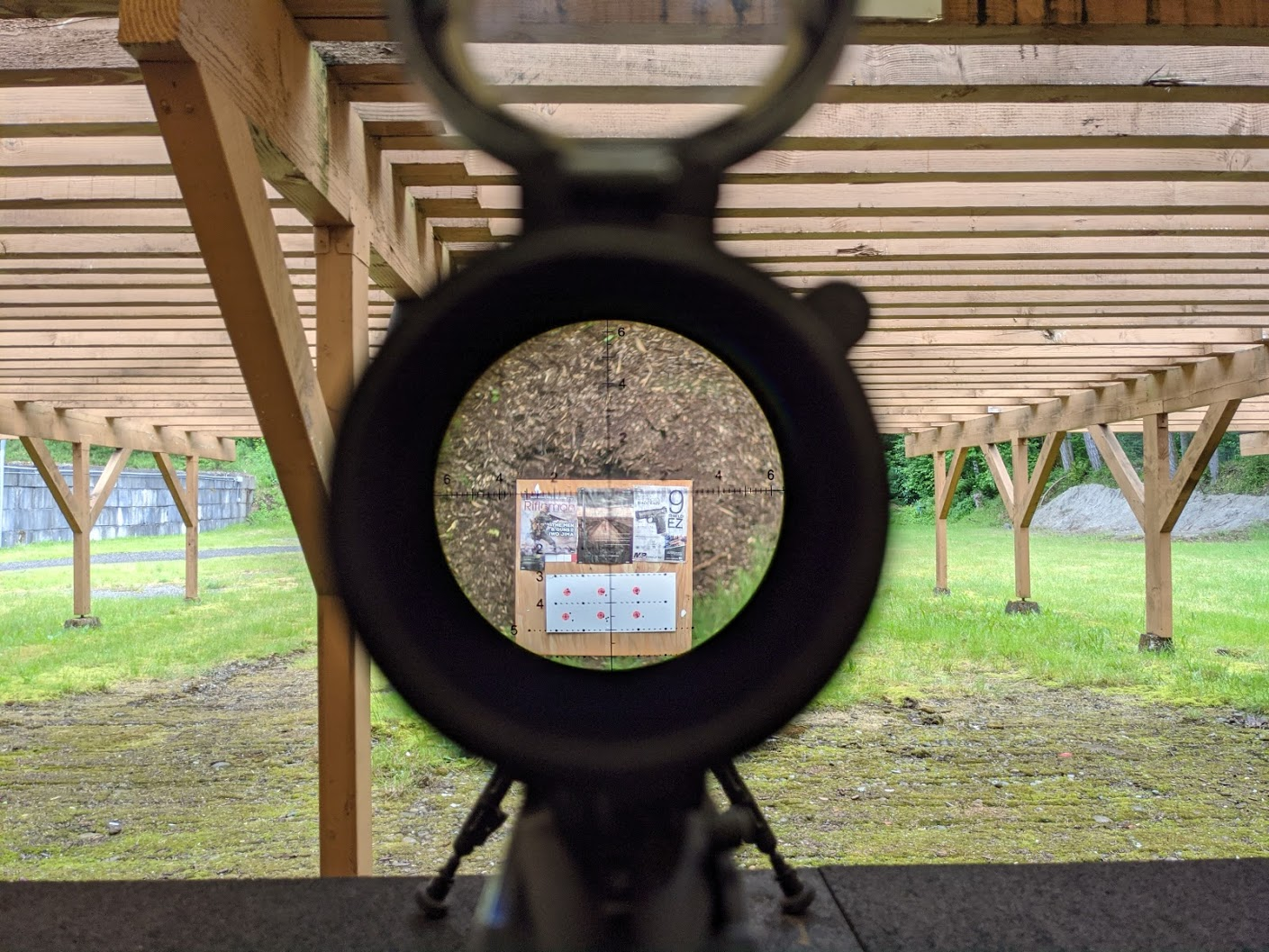

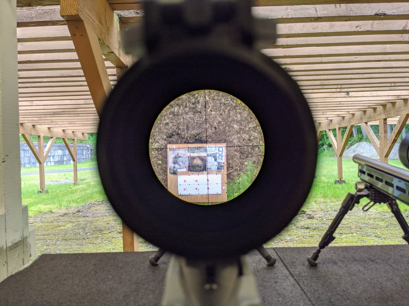

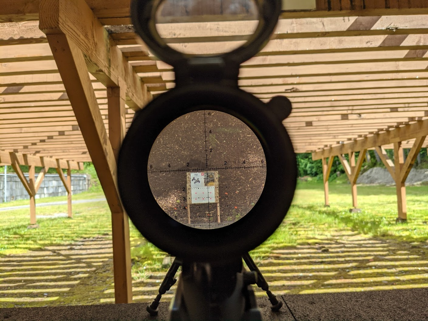

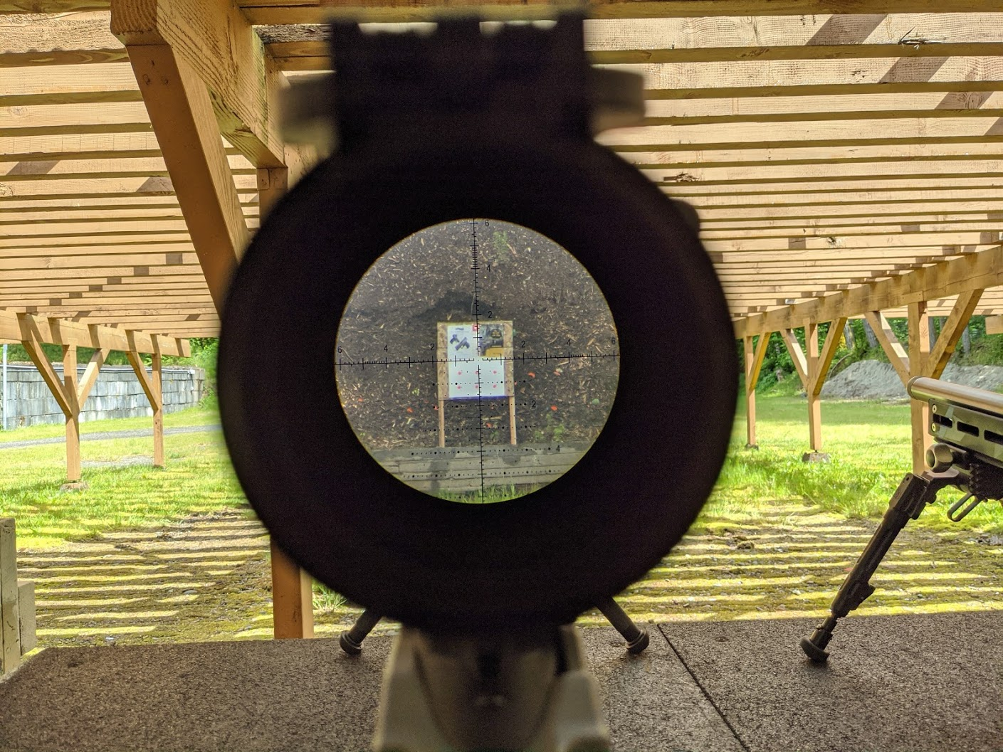

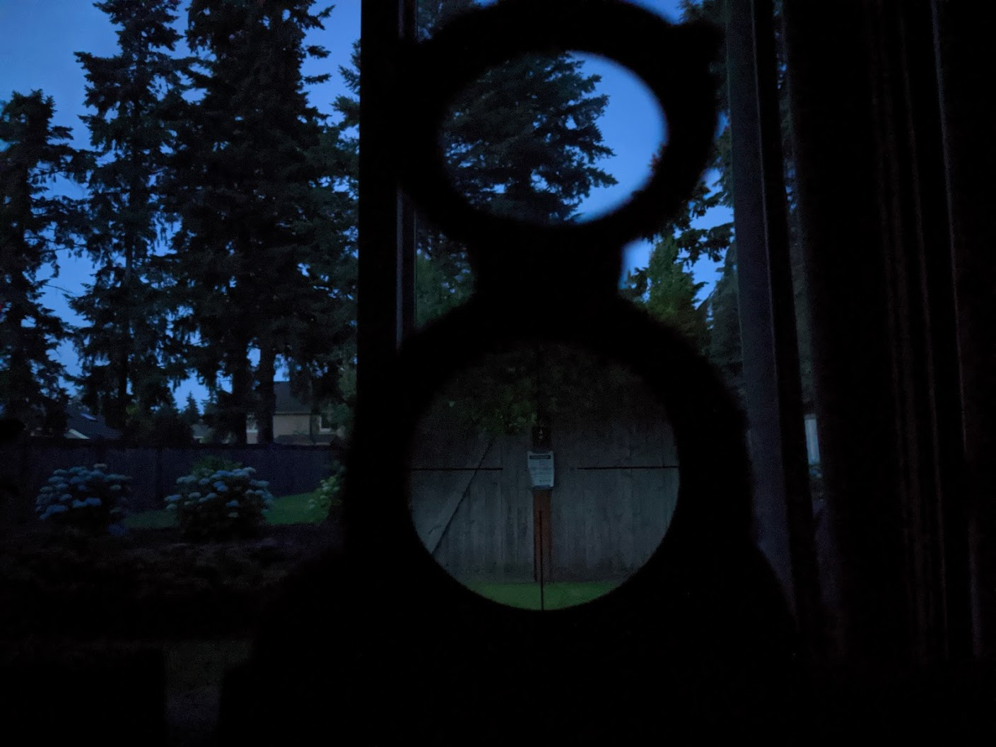

Alright more testing today, unfired rifles, went purely to look at image clarity, ran them at 30x. 100y, 200y.
100 yards - Athlon Ares @ 30x
100y, Tract @ 30x
200y, Ares ETR @ 30x
200y, Tract @ 30x
That's about as much optical clarity testing as I'm going to do.
Regarding the scope shadow type look between the two scopes in my pictures, it's due to the tenebraex caps on the Tract that sits out further from the ocular lens. My cheap butler creep caps are much thinner and sit pretty flush against the ocular whereas the Tenebraex extend out a good 2/3cm or so. That adds that black ring. Though in actually shooting the scopes I see no difference in practical sense.

I see that the tract @200 yards has a purple line at bottom, is that CA ?
I don't see a purple line in the picture. I haven't noticed much CA.

4. I don't really know what tunneling is, let me know how I could test for it.
Also 30 day return policy if you don't like it. So take advantage of it!
This is 4.5x @ 35 yards. That little piece of paper is a standard 8.5x11

I have one on the way. I got it because I like nice glass on my guns. And I like my guns. The Thor I just bought to go on a Texas Hog hunt looks like it's on hold so looks like just the normal shooting and hunting for this year. I'm a little old for the PRS shooting at 57 years. But PRS has done a lot in the way I look at guns and gear.
