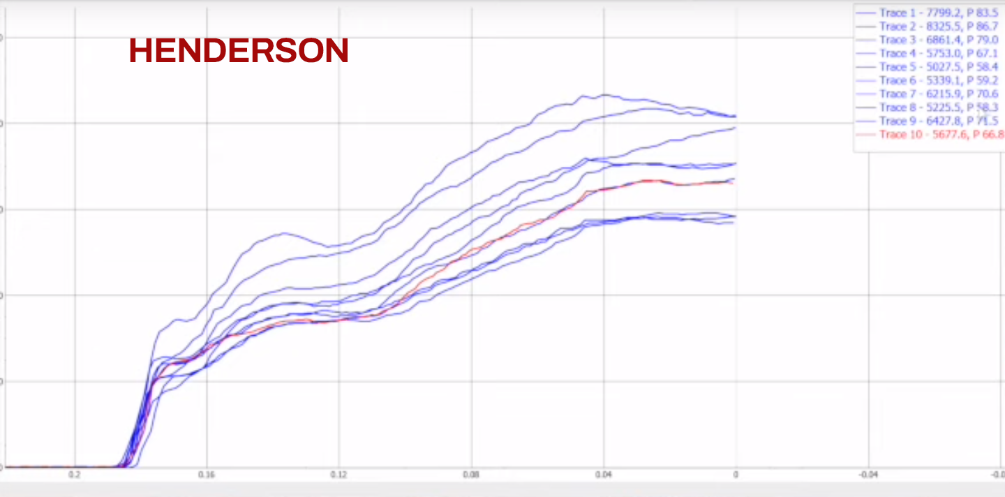

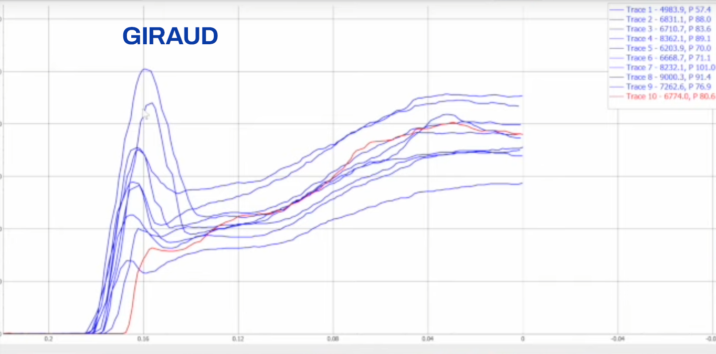

Here are screen grabs from the video showing the AMP Press plots:
Unfortunately, the Y axis units are cut off in the video, but it's clear that the Henderson offers a more consistent seating force. If you just measure the magnitude (in pixels) its 155 for the Henderson vs 178 for the Giraud. That's 15% more consistency over spread for the Henderson.
The other thing, and it's mentioned in the video, is that initial bump that's present on the Giraud cases. This is indicative of something interfering at the very beginning of the seating process, leading me to believe there is something up on the inside chamfer. What is the impact of this? Unknown. But I would prefer not to have that issue.
Overall, for me, I made the assessment that I would rather trim off overall length, and the noise difference and the Henderson hard stop were both factors. The time difference isn't a big issue for me because I seldom trim more than a couple hundred pieces at a time - an extra couple minutes difference there was not enough to make up for the other advantages the Henderson brings.

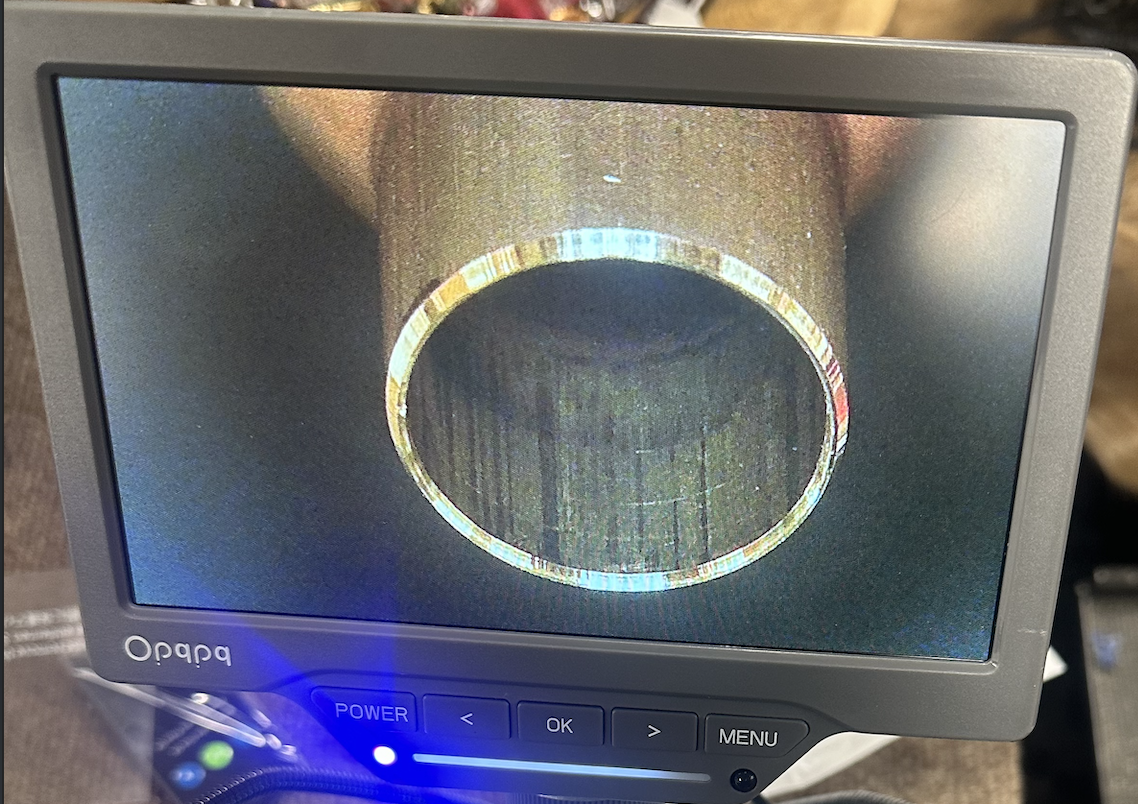

With your Henderson, have you noticed the need to burnish/clean the pilots occasionally? From time to time I'll notice that it's scratching the neck. Only once have I seen it really impact the AMP seating graphs significantly. Usually its just some mild variation in the graph. And I haven't tested anything on paper, though I'm assuming it will make no difference.
I've used extensively and have neither of these.
Same. Most uneven issues I've seen myself or with others is not being careful to make sure the base of the cast is in the collet correctly. Or not allowing it to cut long enough to square the neck. Though I'd think there's some point where if there's enough runout in the neck in reference to the base of case that it could cut uneven.
This is what mine look like when run properly through Henderson. Looks the same around the entire neck if you rotate it.
You can see some of the rings inside the neck I mentioned above though.
Do you lube prior to mandrel/trim? I end up doing two applications of moly - once before those two functions, and once after.
EDIT: I didn't answer the question. I have not run into the need to clean the pilots other than to wipe off residual lube after I'm done.
p.s. We need to start a thread to share plots from the AMP Press. Would be beneficial to see what others are getting with similar calibers and how they're getting them.
Man your inside and outside chamfer is practically making a knife’s edge, interesting. I do not chamfer that aggressively. I do just a touch both inside and out. Obviously both ways work but interesting how sharp an edge you cut to. We all have our ways don’t we!
It's just magnified a ton. You can see the mouth is flat and not a knife edge.
Also, this is the way Henderson sends them if you opt for them to be setup prior to shipping.
