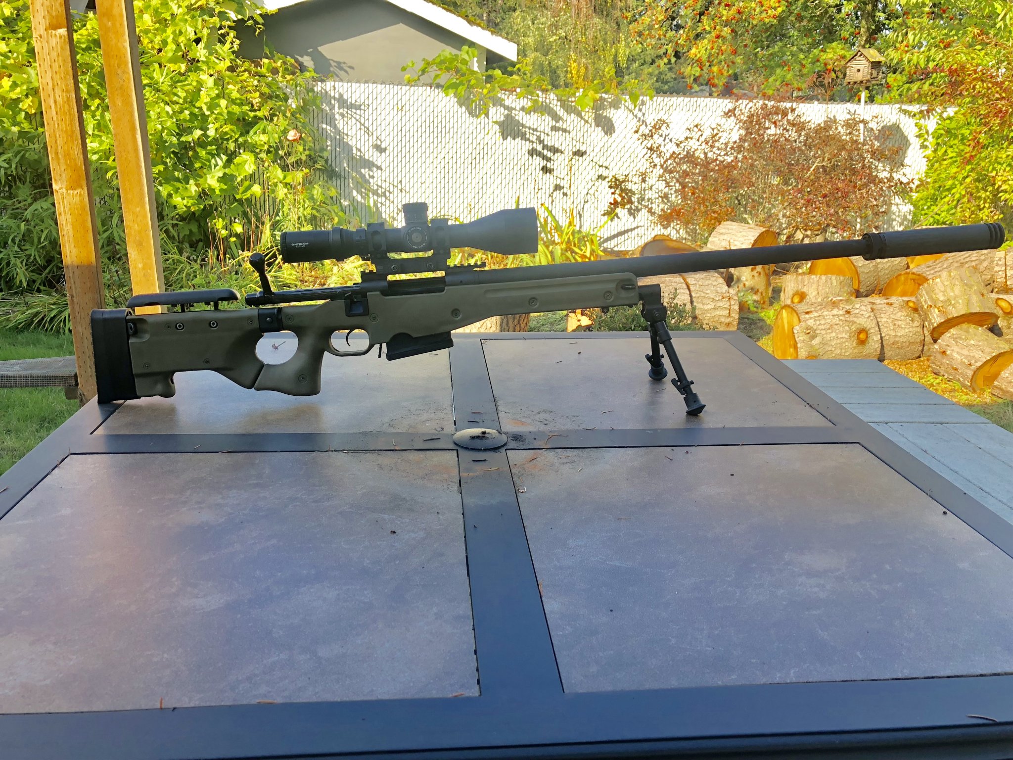

Finally got around to getting a 300 wm built, a Krieger MTU 26 5r hanging off a Stiller TAC 300. This has been an informative thread. I have a couple thousand 190 smk's and a thousand 220 CC pills but my brass is mil once fired, cant find new brass to buy, leaning towards Norma right now which is scarce. I went back and forth between the 338 and the 300, this thread convinced me to go with the 300 WM. Again thanks gents.
Chad Dixon LRI doing the work, Bugholes provided the barrel and action.

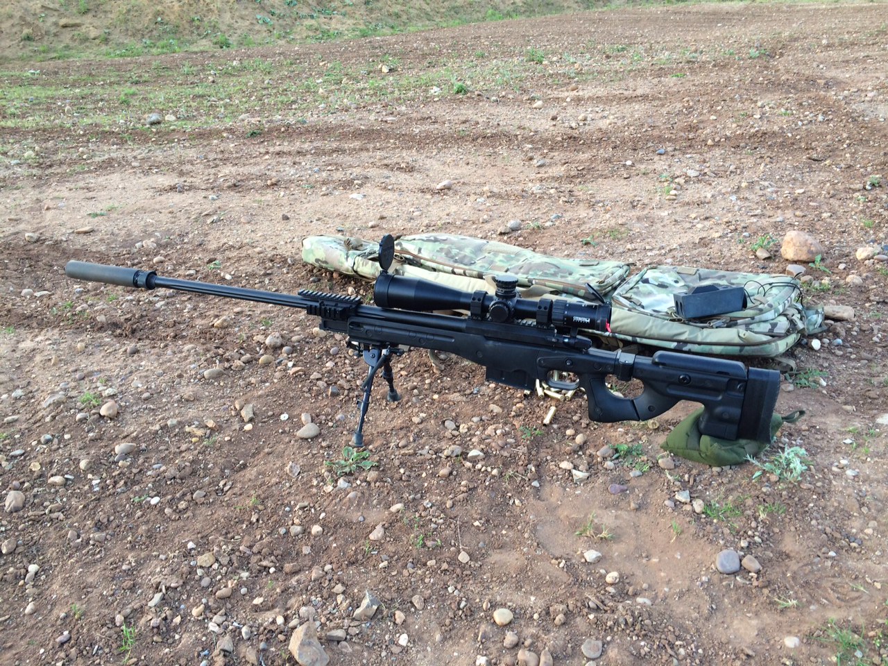

SPECTRE 004.JPGRecent build on Stiller Spectre Action, LW poly barrel. Shoots 1/4 MOA with Berger 190 VLD. Built by Mike Norris at "Brock & Norris".
Reactions: Vargmat
