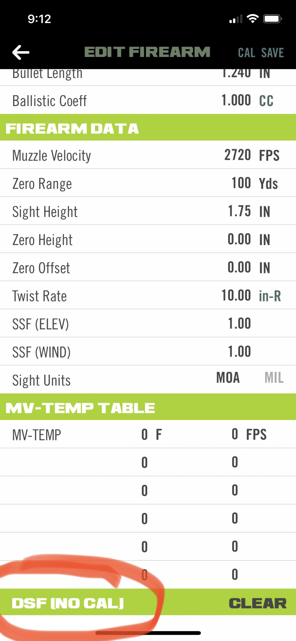

I received mine today. I paired it to the app, Garmin Tactix and the Kestrel. One thing I don't see in the manuals (both Fury and Ballistics) is why it shows the word MOA in the binos when ranging. I don't recall it in the videos either but, now that they're in hand, I should watch them again.
How do you feel is the performance so far? I've got a set on the way for hunting and have to say, I have high hopes to streamline my hunting kit with these.
All right, here’s my take so far.
Connecting to the tactix was quick and easy. It has two settings. Both use the tactix/kestrel for environmentals when connected. One setting uses the tactix/kestrel for AB calculations and shows that result on both. The other setting uses each to calculate their own solution and display it on each device. Both modes work with the tactix.
I can connect the Kestrel via the app using the PC connect mode. The instructions say to use device mode which I’ve done. I can see the wind update in the binos when I range. Never does it show the distance or solution on the kestrel. I removed all connections and started over. When I did that I wasn’t able to reconnect the app to the binos and the screen in the binos seem to loup. I had to pull the battery to reset them. After all set up again still the same using the kestrel. I’ll call vortex and see if I can get the kestrel working the way I expected.
It would have been nice to have it working at the match. I realized I’d used the dsf on the kestrel and needed that dope and not the bino solution.
I like the wind capture mode. I do wish it was useable when connected to the watch. It’s much easier to use to set wind direction and speed than the watch. The kestrel should be much better than the binos.
The match had two metal roof buildings and they messed with the compass so I was not able to use the wind capture mode effectively.
Incidentally, the spring on the battery door fell off the cap and is loose.
My buddy has a set of these, we were able to change the display from MOA to Mils using the app on his phone in the settings. I don't have a ton of time behind them yet, but they seem very nice. We'll be using them at the Vortex Extreme Sniper Challenge in February.
The MOA thing worked itself out somehow. I’m not sure what I did.
I do wish I could download the profiles from the binos to another device. I set them up on my phone and wanted to sync the binos to my iPad but it doesn’t seem to work that way.

The kestrel not reading was due to ranging under 25 yards which it mentions in the manual but also says you'll get a message if it's too close. No message but it works just fine beyond 25 yards.
