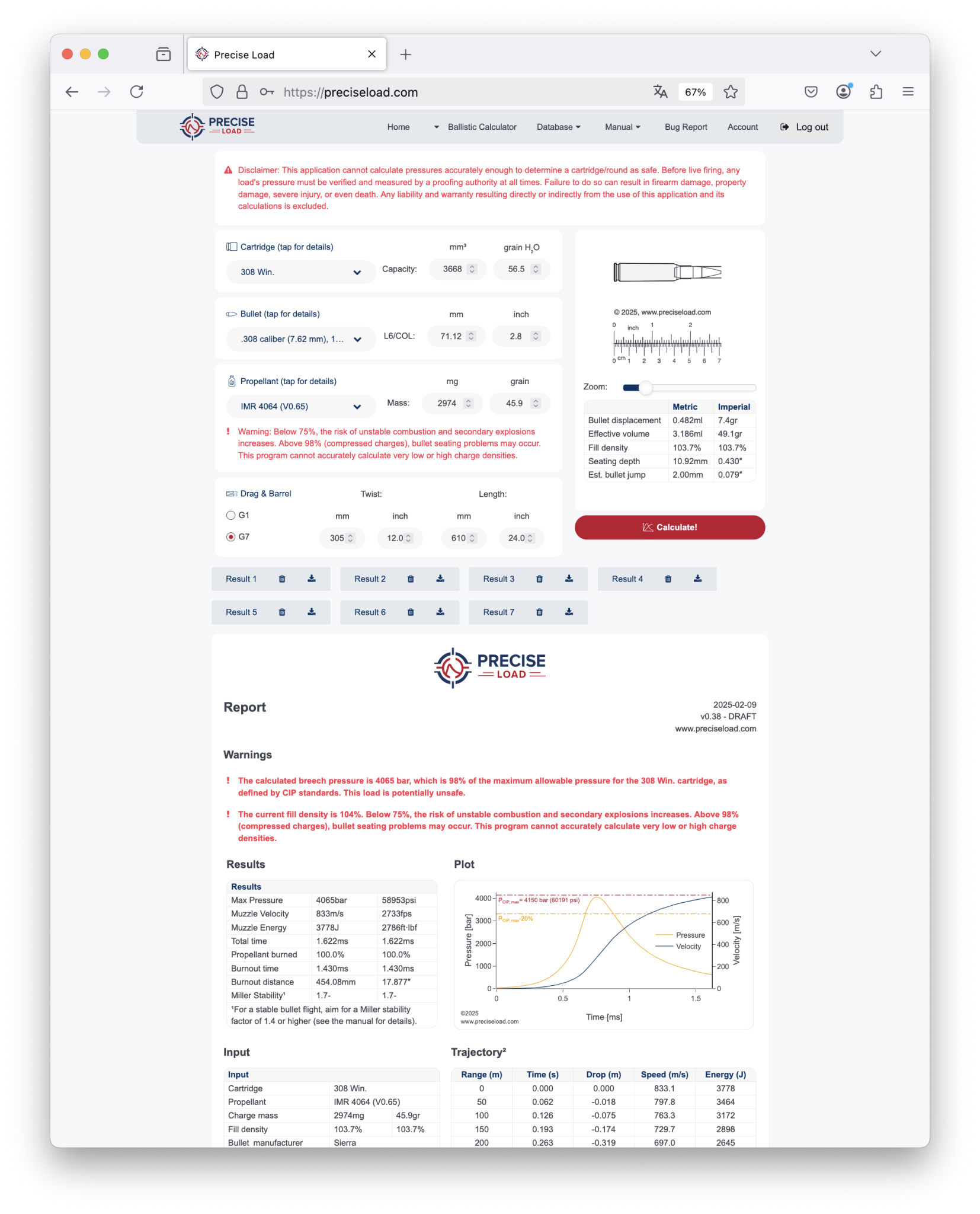

Hey everyone,
I’m Benedikt, a reloader from Germany, and over the past 1.5 years, I’ve been developing https://preciseload.com as a spare-time project. Precise Load is a web-based interior ballistics calculator, similar to QuickLOAD and GRT, but it runs directly in your browser—no installation needed.
Thanks to Lowlight’s approval, I’m excited to introduce Precise Load here and get feedback from the community.
Key Features:
  • More Accurate Simulations – On average, Precise Load predicts pressure and velocity levels more accurately than QuickLOAD and GRT.
  • No Installation Required – Any device with a browser works—I recommend using something with a larger screen for a better experience.
  • Public Bullet Database – Add and share bullets using Precise Load’s simple bullet measurement tool.
You can try it out here: https://preciseload.com (registration required).
I’d love to hear what you think—especially regarding usability, accuracy, and any improvements you’d like to see.
Looking forward to your feedback!
Benedikt
