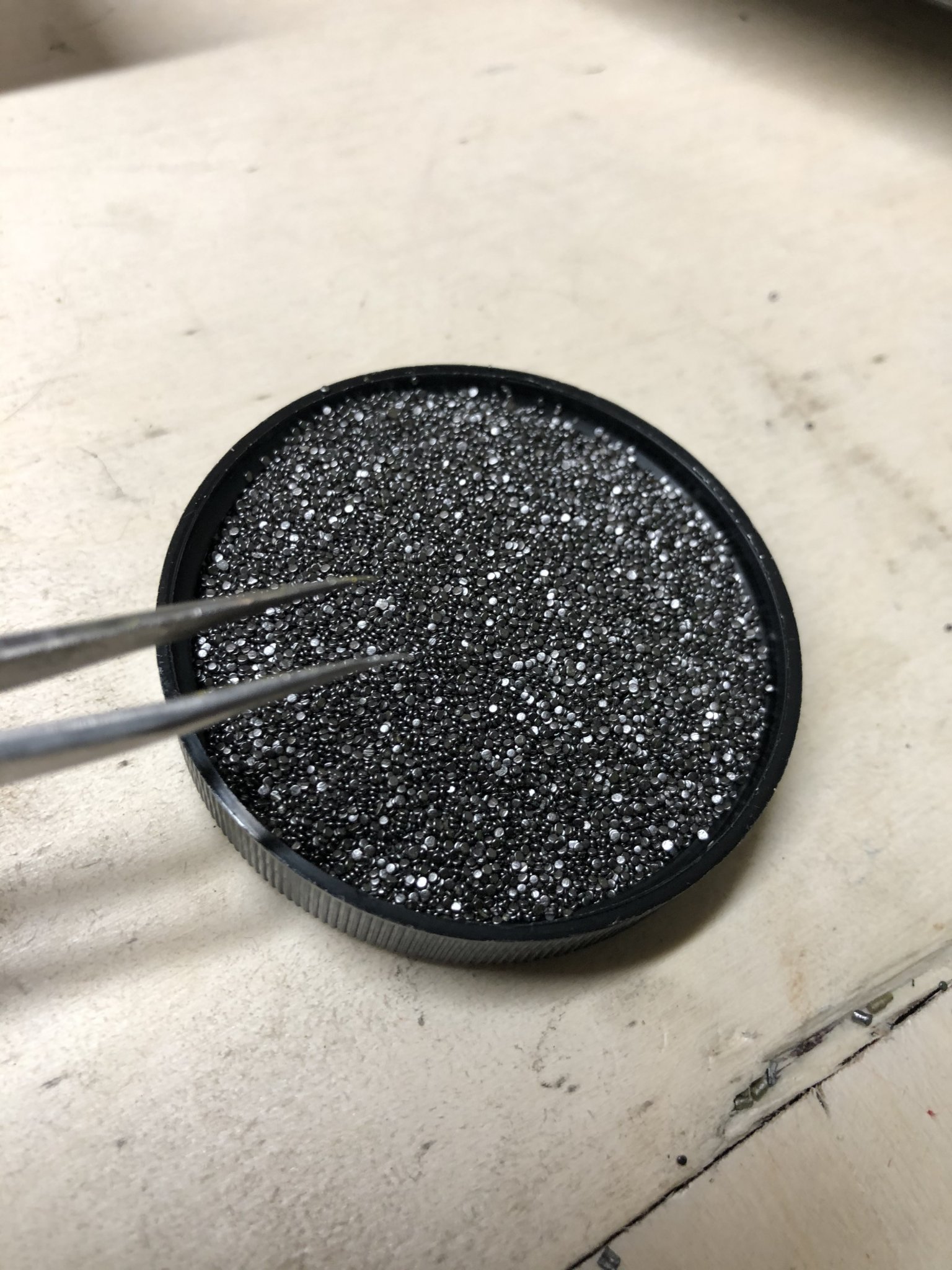

    It’s definitely a small spherical ball powder, nothing different here.
